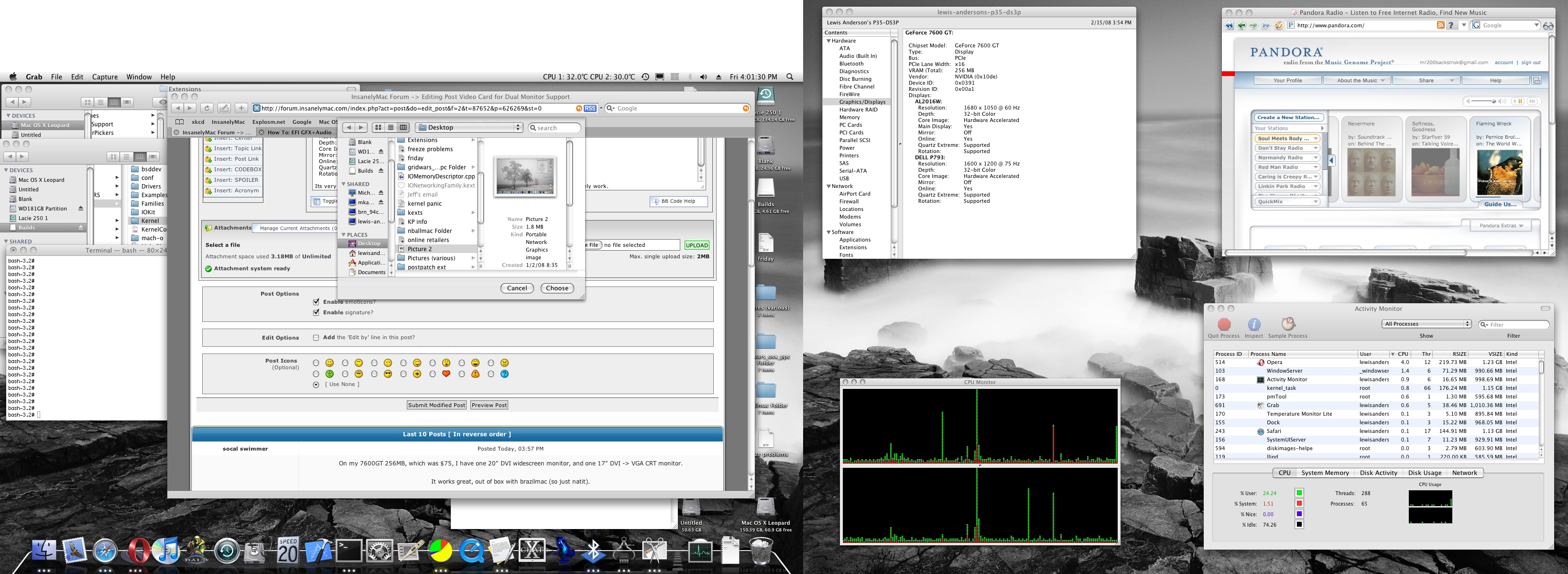

socal swimmer Posted February 15, 2008 Share Posted February 15, 2008 On my 7600GT 256MB, which was $75, I have one 20" DVI widescreen monitor, and one 17" DVI -> VGA CRT monitor. It works great, out of box with brazilmac (so just natit). system profiler: GeForce 7600 GT: Chipset Model: GeForce 7600 GT Type: Display Bus: PCIe PCIe Lane Width: x16 VRAM (Total): 256 MB Vendor: NVIDIA (0x10de) Device ID: 0x0391 Revision ID: 0x00a1 Displays: AL2016W: Resolution: 1680 x 1050 @ 60 Hz Depth: 32-bit Color Core Image: Hardware Accelerated Main Display: Yes Mirror: Off Online: Yes Quartz Extreme: Supported Rotation: Supported DELL P793: Resolution: 1600 x 1200 @ 75 Hz Depth: 32-bit Color Core Image: Hardware Accelerated Mirror: Off Online: Yes Quartz Extreme: Supported Rotation: Supported Its very nice. I've never tried another DVI monitor, cause I don't have one. But it should definitely work. Link to comment https://www.insanelymac.com/forum/topic/87652-video-card-for-dual-monitor-support/#findComment-626269 Share on other sites More sharing options...
