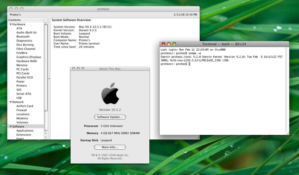

Proteo Posted February 12, 2008 Share Posted February 12, 2008 Right, I guess this is just my imagination Link to comment https://www.insanelymac.com/forum/topic/87106-updating-to-1052-breaks-install-do-not-update/#findComment-619116 Share on other sites More sharing options...

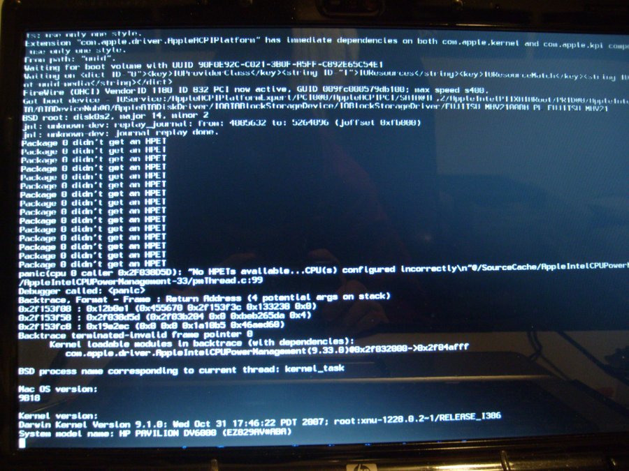

Caboose Posted February 12, 2008 Share Posted February 12, 2008 Well, I'm using PC_EFI from Kalyway disk. I ran the update, it crashed about 30% in with a kernel panic, and I get the nice happy kernel panic message at boot, so I booted with -v and got this. Link to comment https://www.insanelymac.com/forum/topic/87106-updating-to-1052-breaks-install-do-not-update/#findComment-619242 Share on other sites More sharing options...
bidyut Posted February 12, 2008 Share Posted February 12, 2008 You can fix the HPET but booting with an installation CD and then removing the following: /Volumes/{drive name}/System/Libraries/Extensions/AppleIntelCPUPower*.kext Though that didn't really bring the Hackintosh back. Just it just sits at the Apple logo. Link to comment https://www.insanelymac.com/forum/topic/87106-updating-to-1052-breaks-install-do-not-update/#findComment-619254 Share on other sites More sharing options...
Hara-Tiri Posted February 12, 2008 Share Posted February 12, 2008 I have the same problem. I believe that the trick is to use the AppleIntelCPUPowerManagement.kext from a working OSx86 installation. The computer won't boot without it, and will do kernel panics with one from a real Mac... My problem right now is that I have no working installation of OSx86 from which to boot EXCEPT the Install DVD, which does have a working Intel CPU Management extension somewhere but I have absolutely no friggin' idea how to install it from the terminal or Windows... So until I figure that out, I think I'm stuck. Link to comment https://www.insanelymac.com/forum/topic/87106-updating-to-1052-breaks-install-do-not-update/#findComment-619314 Share on other sites More sharing options...
Zauberfalke Posted February 12, 2008 Share Posted February 12, 2008 It looks like not only AppleIntelCPUPowerManagment.kext but also AppleEFIRuntime.kext can break the system. At least on my system after removing both reboot and installation of GraphicsUpdate afterwards without any problem. Link to comment https://www.insanelymac.com/forum/topic/87106-updating-to-1052-breaks-install-do-not-update/#findComment-619392 Share on other sites More sharing options...
mitch_de Posted February 12, 2008 Share Posted February 12, 2008 Well, I'm using PC_EFI from Kalyway disk. I ran the update, it crashed about 30% in with a kernel panic, and I get the nice happy kernel panic message at boot, so I booted with -v and got this. I have exact the same kernel panic (AppleACPI...). Pentium D 825, EFI MBR I found a new (not in 10.5.1) .kext: ApplePlatformEnabler.kext ! Link to comment https://www.insanelymac.com/forum/topic/87106-updating-to-1052-breaks-install-do-not-update/#findComment-620227 Share on other sites More sharing options...
