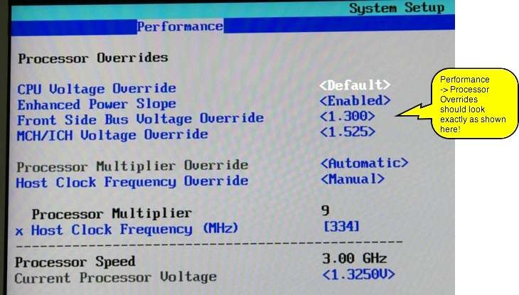

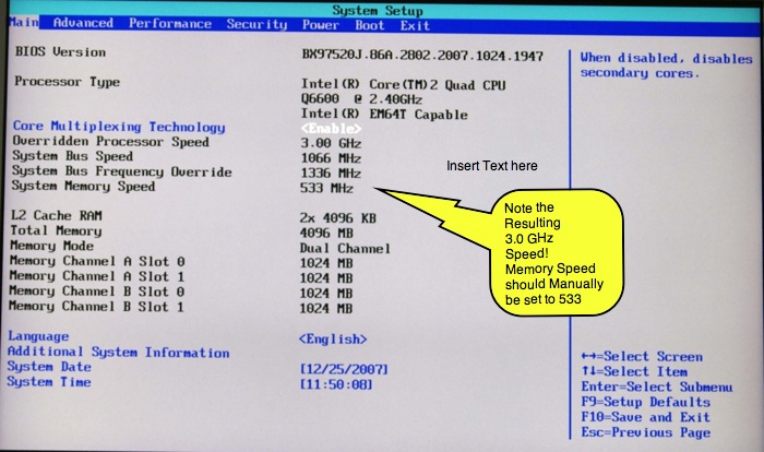

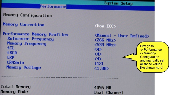

OK, so you really want your INTEL D975XBX2 with Q6600 Quad CPU perform at 3.0 GHz insteed of the 2,4 GHz Stock-Configuration? Then read on!
Foreword: I'm in no sense an overclocking expert, i consider me an absoute overclocking beginner, i have build several PCs and modded several macs and have programming experience, thats my technical background. There are tons of people here on this board and elsewhere who have more overclocking experience, i would really like comments of the experts, refinements of my settings and i hope to get further explanations on how to go to around 3,4 GHz. So anybody feel free to comment on this post.
  • Make sure you have the D975XBX2 Motherboard with the latest Firmware installed
  • You have at least 2 GB of RAM installed, (look for the fast modules...)
  • You have a G0-Stepping Q6600 (Marked SLACR on the Case)
    i don't know how to check these without taking the cooler from the installed processor, i don't even know if there are Q6600's out there without "G0"-Stepping...
  • you have a decent CPU-Cooler (Stock-Cooler is not recommended!)
    mine is an Zalman 9500 (around 40 Euros)
  • You have a decent PSU that can handle the needed current, i would recommend a quality PSU with at least 500 Watts
Make sure to note your current settings before you make any new adjustments so that you can go back if you get the "BIOS has attempted unsuccessful POST attempts..." Message after reboot with the new settings.
I included 3 Attachments to this Post:
  • BIOS Startscreen after Modification
  • Memory-Settings to make for OC'ing to 3.0GHz
  • CPU-Adjustments to make for OC'ing to 3.0 GHz
Overclocking these Configuration of Motherboard/Processor to 3 GHz seems a rather conservative approach (with heavy cooling some have reached nearly 4 GHz with this Configuration!!), so it should be feasible without too much risk. Could you damage your processor with these settings? I can't give any guarantees for your configuration, but mine works since nearly 30 Hours without any problems or even smallest signs of overload (i haven't stressed the CPU that much...). Ideally you should have a Windows or Linux installed where you can check temperature of the CPU and/or make some stress-tests. I tried to look with VISTA under parallels but core temp seems not to work under emulation... and i don't know of any tools for OS X for checking thermals of the processor.
If you don't want to make all adjustments in one step then go first for the memory-adjustments. If you could start with these new settings and after successful restart go on to the CPU-Settings and make adjustments like seen here in my pictures. If you can restart with that too: Congratiulation! You succeeded! Now look at you're temperatures, try some programs and look if your system is stable.
Recommended Reading 1
Recommended Reading 2
Happy Overclocking! :(
Comments? Suggestions? Corrections?
