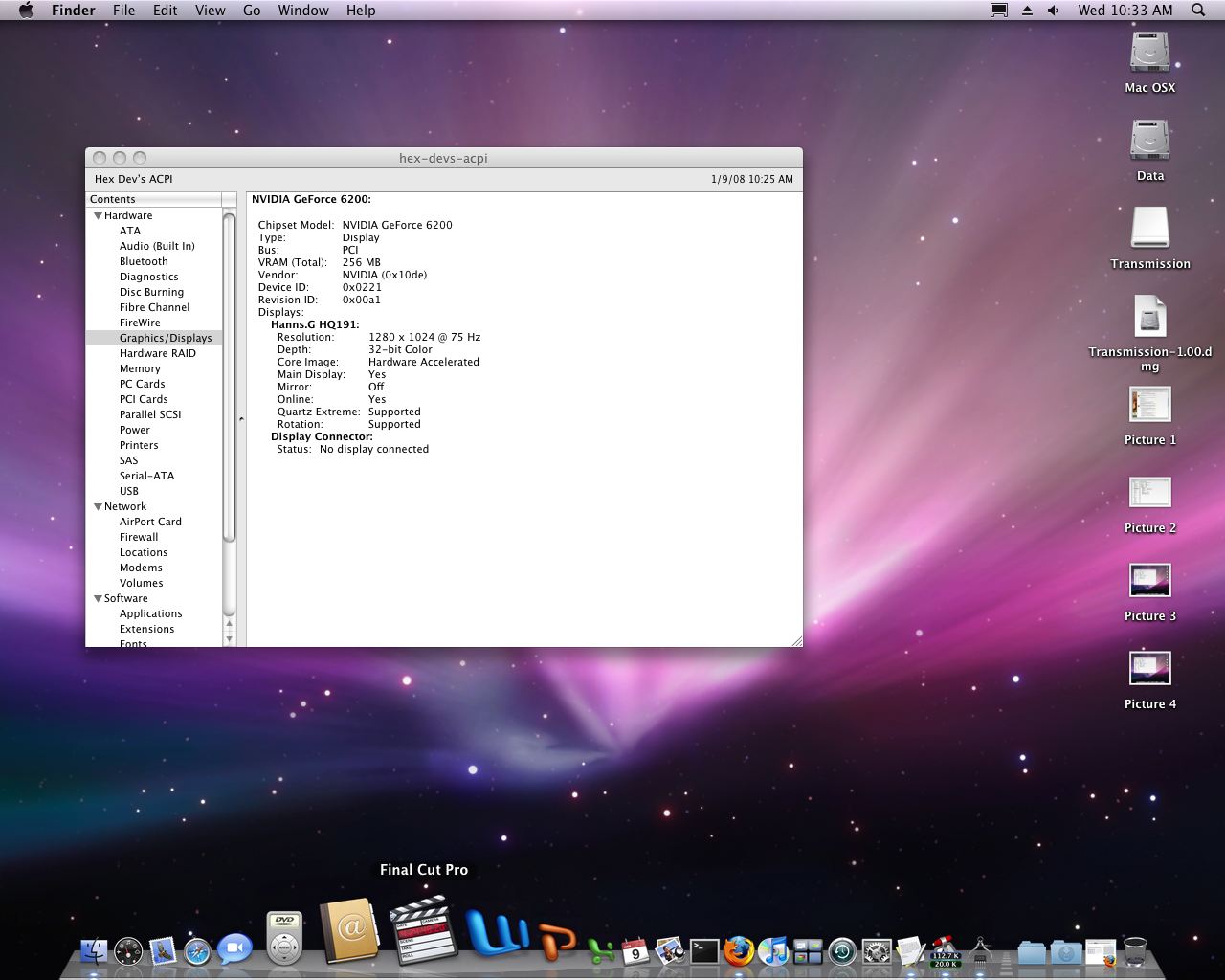

Fortran Posted January 9, 2008 Share Posted January 9, 2008 Perfect Install i dont know if im supposed to post any screen captures or not but i have everything working no patching, just 3 measly kexts applied Mobo: ECS P4M800-PRO (rev 1.1) CPU: Intel Pentium 4 (socket 775) @ 2.66 (Works) RAM: 2x512 Generic DDR 333 GFX: eVga 6200 (Works) - titan kext LAN: Onboard VIA (Works) - ViaRhine kext USB: Onboard 2.0 - (Works) Keyboard PS2 : (Works) Mouse PS2 : (Works) Sound: Onboard Sound (Works) - AppleAC97Audio kext FireWire : 3 Port Generic Card (Works) DVD Burner : Samsung WriteMaster SH-S182D (Perfect) OS : MacOS x86 10.5 Toh Loaded and sucessfully installed FCP 6 (video was glitchy at the begining) Link to comment https://www.insanelymac.com/forum/topic/72493-leopard-perfect-install/page/30/#findComment-572714 Share on other sites More sharing options...
