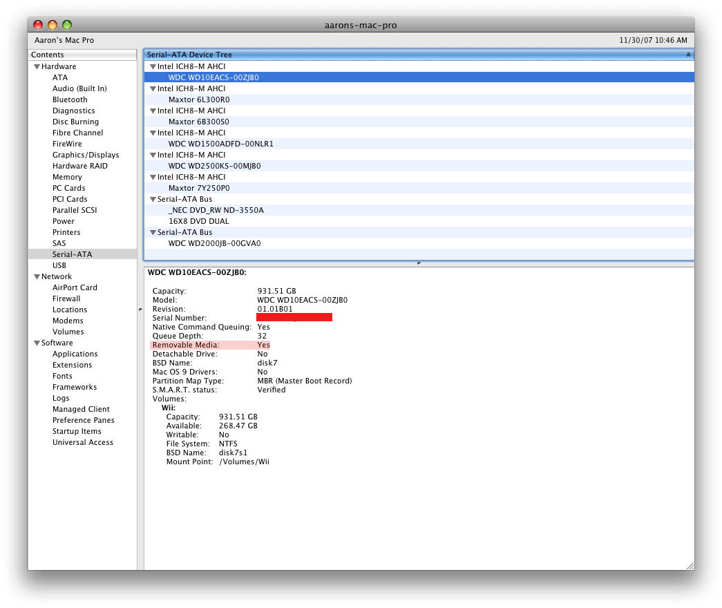

Memphis2k Posted November 27, 2007 Share Posted November 27, 2007 My hard-drives are coming up as External & removable on the ICH8R chipset Basically all my HDD's on orange external icons desktop. Is there anyway I can set these to INTERNAL? ---------------------------------------------------------------------------------------- Ok, here's my rig -10.5.1 Vanilla on BrazilMac & EFI 5.2 patch -Asus P5B Deluxe -ICH8R 6 SATA ports ---------------------- Editted -JMicron JMB363 now works since I set it to IDE in the BIOS. The drives come up as Internal & non-removable. ---------------------- In my BIOS, I have ICH8R set to Enhanced - AHCI I installed "ICH8R Patch Mistico v1.1" Got all my ports working but everything was Unknown in System Profile until I until Mistiso patch & changed the Device ID I even set it as Enhanced - IDE and no drives showed up at all. I almost gotta have AHCI for ICH8R because thats how WinXP is setup <key>ICH8MAHCI</key> <dict> <key>CFBundleIdentifier</key> <string>com.apple.driver.AppleAHCIPort</string> <key>Chipset Name</key> <string>ICH8-M AHCI</string> <key>IOClass</key> <string>AppleAHCI</string> <key>IOPCIPrimaryMatch</key> <string>0x28218086</string> <key>IOProbeScore</key> <integer>2000</integer> <key>IOProviderClass</key> <string>IOPCIDevice</string> <key>Vendor Name</key> <string>Intel</string> </dict> After Mistro's patch, they would come up as Unknown and now that is corrected but everything is "external" Any ideas how I make it internal instead of external for ICH8R The Pic is on the ICH8R. Help & Thanks! Link to comment https://www.insanelymac.com/forum/topic/63305-ich8-sata-driver-installer-for-asus-p5b/#findComment-519878 Share on other sites More sharing options...

Trauma! Posted November 27, 2007 Author Share Posted November 27, 2007 Hy Menphis2K, P5B motherboard don't use this device ID's. P5B Deluxe have an ICH8R chipset and it's better recognized in OS X. I now can use ALL my ports in Leopard, there was another kext loading instead of mine for the ICH8. I'm looking after HFBT informations, in order to recreat it in the installation process... For people who are planning to install BrazilMac release juste replace the AppleHACI.kext and VIAATA.kext by those into my installer before running the postpatch script from Brazilmac. Link to comment https://www.insanelymac.com/forum/topic/63305-ich8-sata-driver-installer-for-asus-p5b/#findComment-520632 Share on other sites More sharing options...
