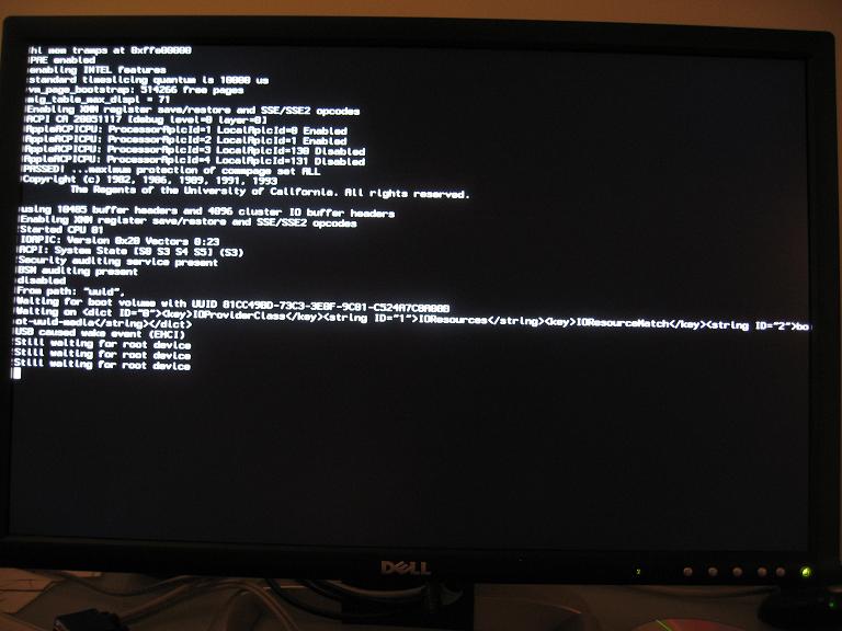

midimid Posted August 21, 2007 Share Posted August 21, 2007 You had mentioned using uphuck 1.3, but does -v -s really work with that as well? Just trying to get to the installation screen here... Here's where I'm at: uphuck 1.4i r3 (i've looked at the readme from the DVD so I know its OK) P5K Deluxe E6300 @ 3.1ghz 2GB ram 8600GT 1x 250GB Samsung on red sata port1 (I actually have four drives, one with WinXP SP2, but I've pulled them all except for this one) 1x NEC DVDRW on the red sata port below it (using a Serillel SATA->IDE adapter) ICH9's mode = AHCI All onboard stuff is disabled (both lans, jmicron, audio, wireless, firewire, and serial) USB is all Enabled (except for the emu setting) Wireless Logitech LX700 keyboard/mouse attached to USB only The HD has two partitions: - front partition of 10gb formatted as FAT32 (I've also tried it as unallocated and as non-formatted) - 100GB of unallocated space - 130GB NTFS partition at the end of the drive (has data on it that I need) AND that front FAT32 partition is set to Active using Windows Disk Management When I boot up, I get the following: I've tried -v, -v -x, and -v -s, but they all get the same result: HELP!! WOW!!!!FINALLY got it working! what a treat... only need ethernet and sound, which can wait til the morning. runs smooth and fast and is utterly beautiful! this procedure solved the issue of hanging on first reboot (i actually used uphuck v1.3 but this works as well)...thanks to OSX86tester for this one: try rebooting then if you have the JAS dvd in. press f8 then type -v -s . then some text flies by. then type fdisk -e /dev/rdisk0 then you should see a fdisk: 1> then type PRINT, you will then see like partitiond and numbers. You will then select the partition IE im using partition 1. So you will Type flag 1 . then it should say partition 1 marked active. then you can quit then type reboot. then darwin should load. Link to comment Share on other sites More sharing options...

midimid Posted August 24, 2007 Share Posted August 24, 2007 OK - a little bit closer now (see my post two up)... I bought a USB2 external DVD drive and can now boot into the uphuck 1.4i r3 installer. However - the Disk Utility is not seeing my HD. uphuck 1.2 DOES see my HD. Any thoughts? Link to comment Share on other sites More sharing options...
asap18 Posted August 24, 2007 Share Posted August 24, 2007 I had to make a custom extensions.mkext for r3, 1.2 is solid for us ICH9r people. Basically use mkextunpack and kextcache to make a new one, edit the dvd and replace the old Extensions.mkext with it. It is difficult if you are new. otherwise use 1.2. AND yes my script works with the p5k-dlx/prem Link to comment Share on other sites More sharing options...
