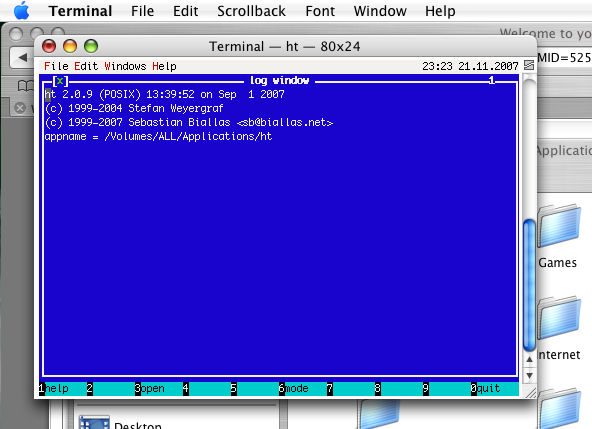

Slice Posted November 21, 2007 Share Posted November 21, 2007 EDIT: I've found that at one point "Callisto build 001 Alpha" drivers were doing the rounds? does anyone have them? the main site is down. Forget! this disassembler is very strange. in disasm mode just converts everything it finds to intel x86 assembly, doesn't look for .code segment, doesn't handle relocations and sagment base addresses, just treats whole file as a binary executable code. i've found Machonist, which also can edit assembly code and create patches, but can also display jumppoints, function calls and some other info Machonist is PowerPC only, as well as HexEdit. The HT is only i386 dissass. (&IDA pro) And both in terminal modes Is there anybody going my way? Link to comment https://www.insanelymac.com/forum/topic/47944-radeon-xpress-200m/page/4/#findComment-514102 Share on other sites More sharing options...

Slice Posted November 29, 2007 Share Posted November 29, 2007 Slice, does what you need somebody to do require serious programming skills? I'm well-versed in the realm of computers, but not in code. And what happened to the guy that was working with you before? Hrm. I propose that he would be a man who can easy make Hex-patch and can find how a command like mov eax,[ecx+148] will be in hex looking. No programmer skill, no XCode. jonny disappeared ole2 is very busy Who else? You can download HT disassembler here http://applelife.ru/index.php?act=attach&a...ost&id=1215 Link to comment https://www.insanelymac.com/forum/topic/47944-radeon-xpress-200m/page/4/#findComment-522387 Share on other sites More sharing options...
JoNNy Posted November 29, 2007 Share Posted November 29, 2007 I propose that he would be a man who can easy make Hex-patch and can find how a command likemov eax,[ecx+148] will be in hex looking. No programmer skill, no XCode. if IDA pro handles relative jump changes and relative calls after reassembly we can just use bindiff and a script to do that.jonny disappearedole2 is very busy Who else? sorry, i'm back, i had deadline at work and just couldn't be around. Slice, on whitch kext versions are You working? i'm getting familiar with ida pro interface, but it's very strange for editing code Link to comment https://www.insanelymac.com/forum/topic/47944-radeon-xpress-200m/page/4/#findComment-522457 Share on other sites More sharing options...
Slice Posted November 29, 2007 Share Posted November 29, 2007 if IDA pro handles relative jump changes and relative calls after reassembly we can just use bindiff and a script to do that.sorry, i'm back, i had deadline at work and just couldn't be around. Slice, on whitch kext versions are You working? i'm getting familiar with ida pro interface, but it's very strange for editing code Glad to see you again! I prefer version 1.4.40 from 10.4.8 because it works in any system version, while 1.4.52 from 10.4.9 - no. Yes, IDA pro is very strange, I use it only to get asm text. For editing I prefer hte.sf.net where I see hex and asm at the same line. I am not sure that we can assemble IDAPro output back. Link to comment https://www.insanelymac.com/forum/topic/47944-radeon-xpress-200m/page/4/#findComment-523024 Share on other sites More sharing options...

ole2 Posted December 4, 2007 Share Posted December 4, 2007 I propose that he would be a man who can easy make Hex-patch and can find how a command likemov eax,[ecx+148] will be in hex looking. No programmer skill, no XCode. jonny disappeared ole2 is very busy Who else? You can download HT disassembler here http://applelife.ru/index.php?act=attach&a...ost&id=1215 I'm still here and now investigating registers mapping difference installed Xcode 2.5, found remote debugging capability (over FireWire) I'm sure, only device ID hack will not be enough but registers remapping fix will be obligatory also we need RS480 (aka 200M) registers map to find out first as well as R300 (integrated into 9700) in order to do comparison and remapping it's very important (and will be very helpful for further investigation) ole2 Link to comment https://www.insanelymac.com/forum/topic/47944-radeon-xpress-200m/page/4/#findComment-527980 Share on other sites More sharing options...
