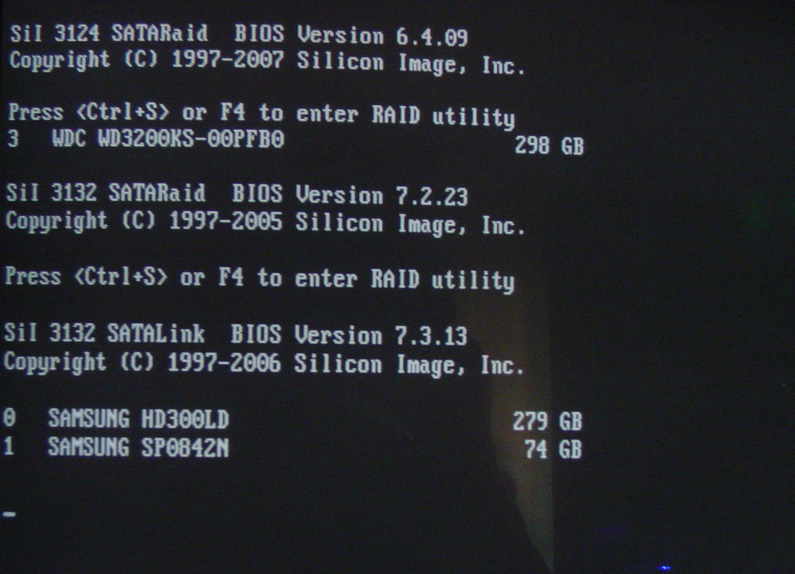

waters Posted April 27, 2007 Share Posted April 27, 2007 I guess I will just pick up one of these SATA PCI Express cards and try booting it with my SATA drive.*Crosses Fingers* good luck! it must be a SataLink one , not SataRaid! (u may change em if u have a flashable bios...) down is a picture; first one; sil 3124, it is SataRaid (it doesnt matter on this one, mac can see raid or link...) 1 hdd is connected; 3 WD... other 3 ports are empty... second one is a sil 3132 , a SataRaid (Yours must not be this, as mac cant see and boot from this one), no hdd s connected, as it only accepts two hdds connected in raid set... third one is the true one; (onboard sil3132 Link bios)/ or pci card, it can boot macos... 2 hdd s on it... after u flash the sil 3124 bios to 6.4.09, it integrates into mainboard bios, controllable and bootable from mb... i got surprised as you may see, scsi-0 wdc 320 was not there before, it simply integrated to mb. after the bios update so, asus and sil, somehow made it! Link to comment https://www.insanelymac.com/forum/topic/46667-uh-sata-hds-on-nforce-590-sli/#findComment-354518 Share on other sites More sharing options...
Gipo Posted April 27, 2007 Share Posted April 27, 2007 You are great!!! thanks in advance. Next days i'll receive my new external Sata box and i'll try all.. no news about audio integrated.. only output with this soundmax 1988b...? Link to comment https://www.insanelymac.com/forum/topic/46667-uh-sata-hds-on-nforce-590-sli/#findComment-354646 Share on other sites More sharing options...
Gipo Posted April 29, 2007 Share Posted April 29, 2007 YES!!! my Sata onboard n590 is working now!!! thanx very much waters!!! Link to comment https://www.insanelymac.com/forum/topic/46667-uh-sata-hds-on-nforce-590-sli/#findComment-355817 Share on other sites More sharing options...
