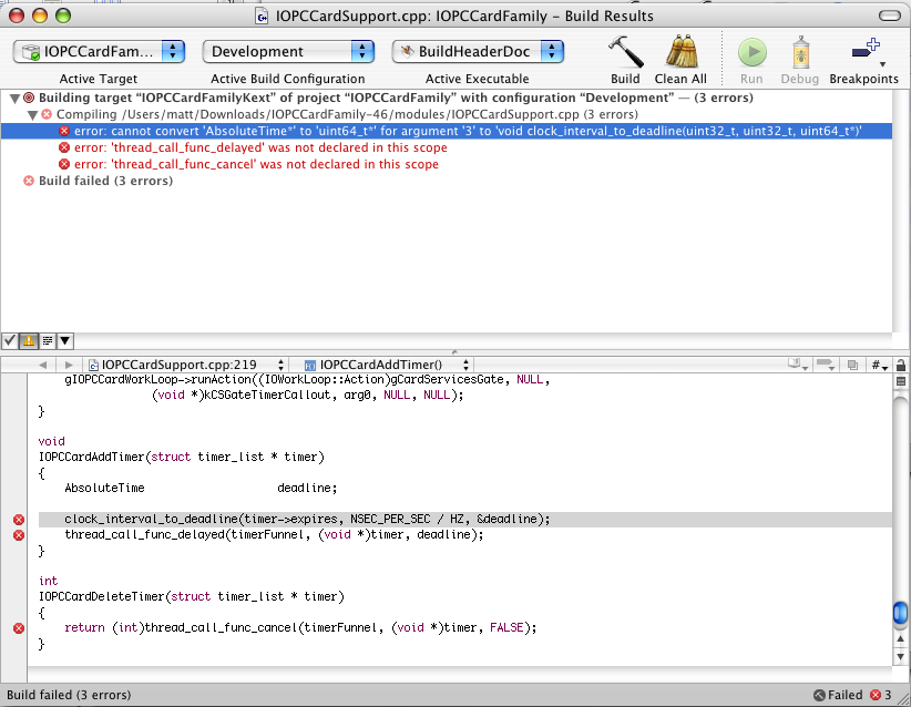

ergosteur Posted February 25, 2007 Author Share Posted February 25, 2007 (edited) bump! by the way, i noticed i didn't include a screenshot. i get 3 build errors, something to do with a timer not being defined. has anyone compiled the iopccardfamily before? Edited February 25, 2007 by matt-hieu ergosteur Link to comment https://www.insanelymac.com/forum/topic/42721-solved-ene-cb1410-building-iopccardfamilykext-or-porting-pcmcia-cs-help/#findComment-310732 Share on other sites More sharing options...

ergosteur Posted March 1, 2007 Author Share Posted March 1, 2007 bump! by the way, i noticed i didn't include a screenshot. i get 3 build errors, something to do with a timer not being defined. has anyone compiled the iopccardfamily before? the build errors screenshot: hi!have you made any progress on the ene 1410? i have got one too... if you need any help drop me a private message, maybe i can help.. i'd surely like to so as I said in my PM, you could help by trying to build Apple's driver from the URL in the first post. I don't know if you might have more experience in C or Xcode or maybe just better luck so please try it and see if you get the same errors. Ill try and build the driver on my friend's macbook, incase it won't build because of the modified kernel. Link to comment https://www.insanelymac.com/forum/topic/42721-solved-ene-cb1410-building-iopccardfamilykext-or-porting-pcmcia-cs-help/#findComment-313842 Share on other sites More sharing options...

gogetta Posted March 23, 2007 Share Posted March 23, 2007 Hi I succed compiled IPCCard to try make my O2Micro cardBus working So here are my modifications: void IOPCCardAddTimer(struct timer_list * timer) { uint64_t deadline; clock_interval_to_deadline(timer->expires, NSEC_PER_SEC / HZ, &deadline); //thread_call_func_delayed(timerFunnel, (void *)timer, deadline); thread_call_enter1_delayed(thread_call_allocate((thread_call_func_t)timerFunnel, thread_call_param_t)NULL), (void *)timer, deadline); } int IOPCCardDeleteTimer(struct timer_list * timer) { return (int)thread_call_cancel(thread_call_allocate((thread_call_func_t)timerFunnel,(th ead_call_param_t)NULL)); } with this, it compile but my O2micro donc work anymore.. Link to comment https://www.insanelymac.com/forum/topic/42721-solved-ene-cb1410-building-iopccardfamilykext-or-porting-pcmcia-cs-help/#findComment-330539 Share on other sites More sharing options...
ergosteur Posted March 25, 2007 Author Share Posted March 25, 2007 (edited) Hi I succed compiled IPCCard to try make my O2Micro cardBus working Doesn't O2micro work natively in OSX 10.4.8 without modifications? if you look at the IOPCCardFamily source, there is already a o2micro module (http://www.opensource.apple.com/darwinsource/10.4.8.x86/IOPCCardFamily-46/modules/o2micro.h). For those of us with ENE, however, there is no ene.c module. (there is an ene.c in pcmcia-cs source). Would anyone know how to add that one extra module to the IOPCCardFamily driver? also one odd thing i found: the version of o2micro.h in IOPCCardfamily is * o2micro.h 1.17 2000/06/12 21:29:37 in the last pcmcia-cs, it is * o2micro.h 1.20 2002/03/03 14:16:57 the ene.h version in pcmcia-cs is: * ene.h 1.2 2001/08/24 12:15:33 and as for ti113x.h it's: * ti113x.h 1.32 2003/02/13 06:28:09 in BOTH IOPCCardFamily and pcmcia-cs so Apple deliberately put in an old version of o2micro.h, and deliberately removed the ene.h. why? gogetta, maybe you could try replacing the o2micro.h from IOPCCardFamily with the one from pcmcia-cs, then building the kext. if you try it, please tell us if it works Edited March 25, 2007 by matt-hieu ergosteur Link to comment https://www.insanelymac.com/forum/topic/42721-solved-ene-cb1410-building-iopccardfamilykext-or-porting-pcmcia-cs-help/#findComment-331758 Share on other sites More sharing options...

0xdeadbeef Posted May 28, 2007 Share Posted May 28, 2007 Hi I succed compiled IPCCard to try make my O2Micro cardBus working So here are my modifications: void IOPCCardAddTimer(struct timer_list * timer) { uint64_t deadline; clock_interval_to_deadline(timer->expires, NSEC_PER_SEC / HZ, &deadline); //thread_call_func_delayed(timerFunnel, (void *)timer, deadline); thread_call_enter1_delayed(thread_call_allocate((thread_call_func_t)timerFunnel, thread_call_param_t)NULL), (void *)timer, deadline); } int IOPCCardDeleteTimer(struct timer_list * timer) { return (int)thread_call_cancel(thread_call_allocate((thread_call_func_t)timerFunnel,(th ead_call_param_t)NULL)); } with this, it compile but my O2micro donc work anymore.. Have you tried perhaps, void IOPCCardAddTimer(struct timer_list * timer) { uint64_t deadline; clock_interval_to_deadline(timer->expires, NSEC_PER_SEC / HZ, &deadline); thread_call_enter1_delayed(thread_call_allocate((thread_call_func_t)timerFunnel,(thread_call_param_t)timer),NULL, deadline); } int IOPCCardDeleteTimer(struct timer_list * timer) { return (int)thread_call_cancel(thread_call_allocate((thread_call_func_t)timerFunnel,(thread_call_param_t)timer)); } the thread entry function timerFunnel() takes two parameters, but only uses the first. Link to comment https://www.insanelymac.com/forum/topic/42721-solved-ene-cb1410-building-iopccardfamilykext-or-porting-pcmcia-cs-help/#findComment-373638 Share on other sites More sharing options...
