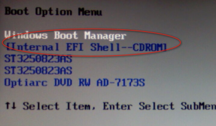

Almost all modern Intel Motherboards, not only Bad Axe 2 has EFI support and not only in custom bioses:). Here is the pic of my Intel DP35DP's boot options screen:
And it works!
And it works!
All this shows is that the boot option menu recognizes the windows boot manager and that you have a CD with some kind of efi shell on it.
The shell is not on an HD since it is reported to be on a CD-ROM and you show nothing that a shell or boot manager is bootable from the GPT/GUID EFI partition, only that it appears in your boot option menu.
What would be worth examining is the CD-ROM that contains the EFI shell if it actually boots to the EFI shell.
