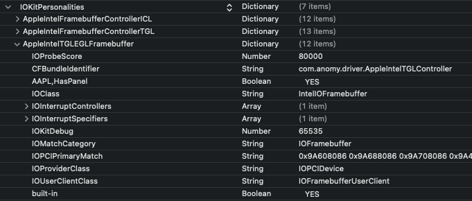

careful using com.xxxxx.driver.AppleIntelTGLGraphics that is old patch i've done. the original com.apple.driver.AppleIntelTGLGraphics is signed and maybe make os x happy.
if AppleIntelTGLGraphics loads in /L/E and the metal plugin gets load maybe it can work otherwise only path is /S/L/E
gonna try explain better why u might need revert ngreen
this patch in ngreen lacks a var fix
done on nblue
this is just a sample idk how long ai wil take to see this and other stuff

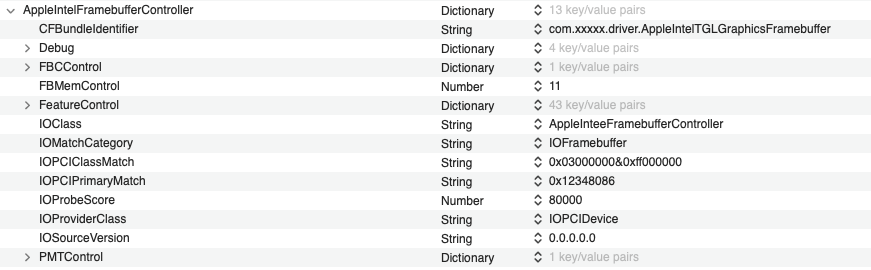

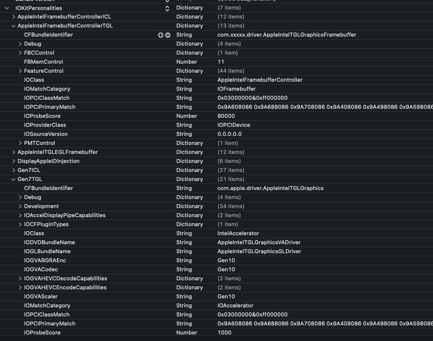

the info.plist of ngreen lacks all the properties that the kexts need. e.g
in ngreen
in nblue and nred logic u use the base kext properties, change as need  and just add pci ids in iopciprimarymatch if u want osx to load at boot
in /L/E u change iopciprimarymatch to 0x12345678 so it doesnt auto load
But you always told me to use only one IOPCIPrimaryMatch and it's conceptually wrong....
ah i see hmm sec ive removed the ids in current mblue
so this is original frambe that is instaled to /L/E and the pcimatch does nothing
if u copy this block to ngreen and change iopciprimarymatcg to your card id ngeen codo will load it
extra bonus: u can change also featurecontrol properties
same logic for com.apple.driver.AppleIntelTGLGraphics but u can try with the unsigned version u got in ngreen if works in /L/E
Edited by jalavoui

i just remenbered why i made the com.xxxxx.driver.AppleIntelTGLGraphics dam im happy you are testing it - idea at that time was force load in /L/E
if u do this in ngreen it will load both kexts (replace com.apple.driver.AppleIntelTGLGraphics with com.xxxxx.driver.AppleIntelTGLGraphics)
i know cause this is nred logic and also cause i'm testing both this way
found ids on old release of nblue
0x9A608086 0x9A688086 0x9A708086 0x9A408086 0x9A498086 0x9A598086 0x9A788086 0x9AC08086 0x9AC98086 0x9AD98086 0x9AF88086 0x46808086 0x46828086 0x46888086 0x468A8086 0x468B8086 0x46908086 0x46928086 0x46938086 0x46A08086 0x46A18086 0x46A28086 0x46A38086 0x46A68086 0x46A88086 0x46AA8086 0x462A8086 0x46268086 0x46288086 0x46B08086 0x46B18086 0x46B28086 0x46B38086 0x46C08086 0x46C18086 0x46C28086 0x46C38086 0x46D08086 0x46D18086 0x46D28086 0x46D38086 0x46D48086 0xff058086 0x8A708086 0x8A718086 0x8A518086 0x8A5C8086 0x8A5D8086 0x8A528086 0x8A538086 0x8A5A8086 0x8A5B8086 0x4C808086 0x4C8A8086 0x4C8B8086 0x4C8C8086 0x4C908086 0x4C9A8086 0xA7808086 0xA7818086 0xA7828086 0xA7838086 0xA7888086 0xA7898086 0xA78A8086 0xA78B8086 0xA7218086 0xA7A18086 0xA7A98086 0xA7AC8086 0xA7AD8086 0xA7208086 0xA7A08086 0xA7A88086 0xA7AA8086 0xA7AB8086
but adding ids to both frame and acelerator will hang if u dont have them instaled
btw somewhere in code there is a functions that also setups some of this parameters
lol i posted wrong picture of my tests in loading another projet AppleIntelTGLEGLFramebuffer but it also works
https://github.com/pawan295/Appleinteltgldriver.kext
heres the nblue conf if any1 wanna test it - same logic add 0x12345667 to original file before install in /L/E
i just realized i updated tigerlake thread with old nblue source code
fixed you can get latest from there
my bad
Edited by jalavoui

try this also this - ngreen from github without junk
for framebufer only boot remove ids from IOPCIPrimaryMatch in Gen7TGL info.plist
logic is gpu drivers + bundles in /S/L/E  for /L/E refactor info.plist and DYLDPatches
Arquivo.zipNootedGreen-main.zip
masta this is from github so i think old parameters u guys testing will still work. altough i removed some
btw i think u also have some nice patches so carefull with what u choose
Edited by jalavoui
