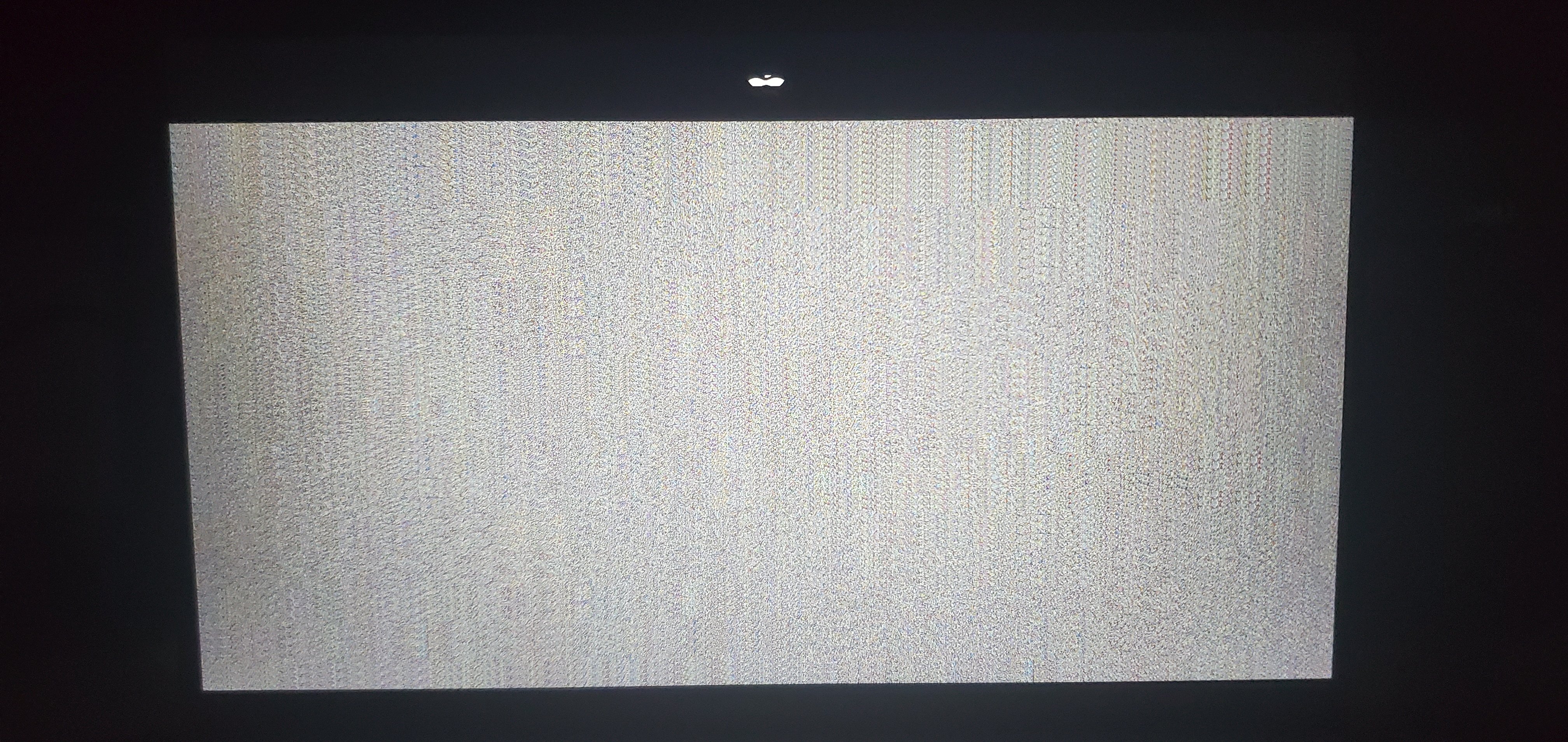

When you say not booting, you mean KP or freeze at window server, can you VNC, does it start the iGPU in verbose mode allowing visuals via VNC, I get a KP with NootedGreen, BatGPT is working on fixing it right now.

Share those kexts you built in a zip, my boot does not give that. You can get logs by running dmesg, however you will need to truncate it so it's not overload with irellevevant info, you can also use hackintool and go to the logs section and parse the system logs.
Also do you have SSDT-PNLF enabled? Should be disabled for now, also AppleIntelFramebufferController should have personalities published, similar to Nblues way of publishing the personality upfront
Current error in Metal pipeline creation.
Translated Report (Full Report Below)

Upon Boot, currently at the frozen screen, no vnc options, the client gets stuck at downloading first frame.

15 hours ago, jkbuha said:
I've managed to patch your Lilu fork to compile and load on Sequoia, compile NootedGreen and HookCase, force load both TGL kexts with a launchdaemon. Screen boots up without acceleration, but still on 8MB VRAM.
Here's what's working
NootedGreen V58 Release+Debug: loads, patches both TGL kexts
Patched Lilu 1.7.3 with loadKinfoPlaceholder: loads, Release build on EFI
HookCase 8.0.1: loads from /Library/Extensions
TGL FB + TGL HW: both load (via launch daemons), both in auxiliary KC
V58 real-TGL detection works: "Real TGL — native topology"
IOAccelF2 patches: OK
Not working so far:
All Intel classes at 0 instances (AppleIntelFramebufferController, IntelAccelerator, IGAccelDevice, IGHardwareGuC, IntelTGLMemoryManager)
NDRV still owns IGPU — no TGL framebuffer matched
VRAM 8MB, "No Kext Loaded" in System Profiler
No dmesg/log output on Sequoia (buffer rolls over before capture, unified log empty)
Let me know how to produce debug/logfiles and I'll attach them here.
Need these below and your lilu dump at /var/log :
log show --style syslog --predicate 'processID == 0' --last 15m --info --debug  > /tmp/x.log
Boot fast after with an empty nooted blue and without liludump and give me these
Edited by Stezza88
NG.zipx.log
Here you go. Compiled kexts on Sequoia and boot x.log
Interesting side-effect. Without WEG, and using these kexts, display eGPU thunderbolt hotplug works. I can plug in my Radeon RX6950 via thunderbolt on this XPS 9310 (i7-1185g7) and the GPU is automatically detected and display automatically extends. Still without hardware acceleration, but eGPU hotplug never worked on the previous XPS 9300 Ice Lake machine.
Edited by jkbuha
