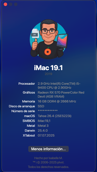

kaoskinkae Posted February 24 Share Posted February 24 On all three of my systems, as you can see in the system description, everything was perfect. However, on all three, the first thing you see when you log in is the toolbar of your most used applications, which you can choose to show or hide. It only becomes visible when you hover over it. But with this beta version, when you first log in, it's hidden and not visible. This is the first time this has happened to me with all the Tahoe updates. Once I restart, it becomes fully visible. 3 Link to comment https://www.insanelymac.com/forum/topic/362386-pre-release-macos-tahoe-264/page/4/#findComment-2847721 Share on other sites More sharing options...

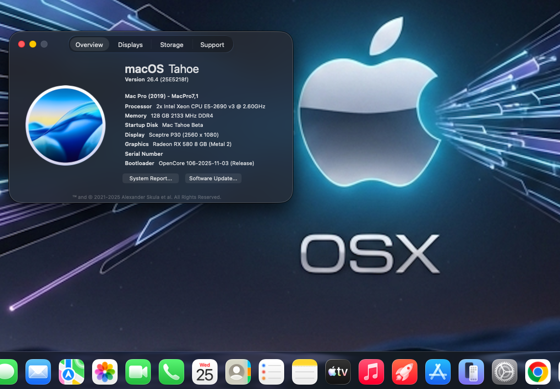

sok5 Posted February 25 Share Posted February 25 no issues with my HP Z840 4 Link to comment https://www.insanelymac.com/forum/topic/362386-pre-release-macos-tahoe-264/page/4/#findComment-2847752 Share on other sites More sharing options...

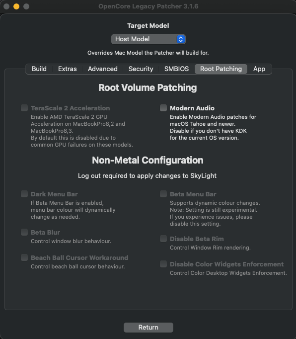

arsradu Posted February 25 Share Posted February 25 (edited) On 2/21/2026 at 11:20 PM, MakAsrock said: If you dare, use the 3.1.6 Tahoe patchset. You might be able to boot and get Wi-Fi. I can't promise more, but be careful: 1. Insert the boot argument amfi=0x80 2. Disable the Modern Audio patch for AppleHDA restoration in settings. I did try it out. Thank you! Unfortunately, and for some weird reason, I can't boot with it after patching (only WiFi). Not sure why. Didn't have the time to see what's going on. It works fine with OCLP-Mod 3.1.5 though. But again, only the WiFi patch. For analog audio, if I got this right, we need KDK 26.4 which is still pending from Apple. Edited February 25 by arsradu 3 Link to comment https://www.insanelymac.com/forum/topic/362386-pre-release-macos-tahoe-264/page/4/#findComment-2847760 Share on other sites More sharing options...

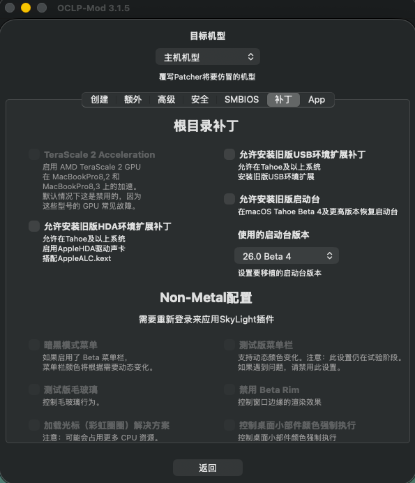

kgp Posted February 25 Share Posted February 25 (edited) 46 minutes ago, arsradu said: I did try it out. Thank you! Unfortunately, and for some weird reason, I can't boot with it after patching (only WiFi). Not sure why. Didn't have the time to see what's going on. It works fine with OCLP-Mod 3.1.5 though. But again, only the WiFi patch. For analog audio, if I got this right, we need KDK 26.4 which is still pending from Apple. @arsradu, my friend! Did you use boot-arg amfi=0x80 with OCLP Nightly 3.1.6? It is deemed necessary. Edited February 25 by KGP-iMacPro 3 Link to comment https://www.insanelymac.com/forum/topic/362386-pre-release-macos-tahoe-264/page/4/#findComment-2847761 Share on other sites More sharing options...
arsradu Posted February 25 Share Posted February 25 24 minutes ago, KGP-iMacPro said: @arsradu, my friend! Did you use boot-arg amfi=0x80 with OCLP Nightly 3.1.6? It is deemed necessary. I am using -amfipassbeta. I thought that would have the same effect as amfi=0x80…? But I could be wrong. 3 Link to comment https://www.insanelymac.com/forum/topic/362386-pre-release-macos-tahoe-264/page/4/#findComment-2847763 Share on other sites More sharing options...
kgp Posted February 26 Share Posted February 26 (edited) On 2/25/2026 at 8:12 PM, arsradu said: I am using -amfipassbeta. I thought that would have the same effect as amfi=0x80…? But I could be wrong. Only OCLP-Mod 3.1.5 works with AMFIPass.kext and -amfipassbeta. OCLP Nightly 3.1.6 still requires amfi=0x80 instead. For details see: Please let us know if you succeed in successfully patching Wi-Fi with OCLP Nightly 3.1.6 and amfi=0x80 under macOS Tahoe 26.4 beta 2. Many thanks in advance for testing 👍 Edited March 5 by KGP-iMacPro 3 Link to comment https://www.insanelymac.com/forum/topic/362386-pre-release-macos-tahoe-264/page/4/#findComment-2847784 Share on other sites More sharing options...
arsradu Posted February 26 Share Posted February 26 29 minutes ago, KGP-iMacPro said: Only OCLP-Mod 3.1.5 works with -amfipassbeta. OCLP Nightly 3.1.6 requires amfi=0x80 instead, i.e AMFI fully disabled! Please let us know if you succeed in successfully patching Wi-Fi with OCLP Nightly 3.1.6 with amfi=0x80 under macOS Tahoe 26.4 beta 2. Many thanks for testing 👍 Yep, seems to be working fine with amfi=0x80 parameter. :) 1 1 Link to comment https://www.insanelymac.com/forum/topic/362386-pre-release-macos-tahoe-264/page/4/#findComment-2847786 Share on other sites More sharing options...

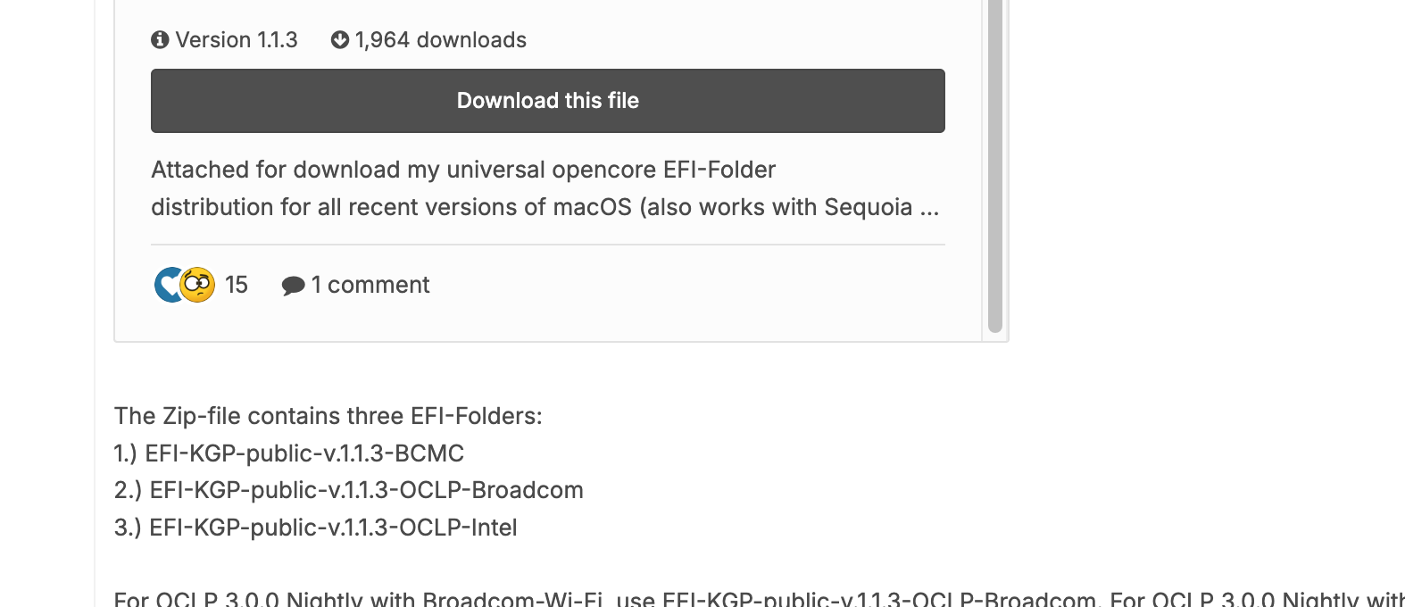

kgp Posted February 26 Share Posted February 26 (edited) On 2/26/2026 at 4:13 PM, LockDown said: was there a any changes in binaries, private/frameworks between those two versions mentioned? Im still using those files from 3.1.0 and still works with -amfipassbeta Yes.. there have been changes in both OCLP-Mod 3.1.5 and OCLP Nightly 3.1.6 mainly due to HFS+ issues with macOS 26.4 beta1. For OCLP-Mod see this thread and for OCLP Nightly see here. Apple fixed all HFS+ issues with macOS 26.4 beta2. If you are saying that OCLP-Mod 3.1.0 still works with macOS 26.4 beta2, the same might also state for OCLP 3.0.0 Nightly, once an appropriate KDK will be available for macOS 26.4 betas. Unfortunately, in contrary to OCLP-Mod 3.1.5 and OCLP Nightly 3.1.6, OCLP Nightly 3.0.0 has no toggle to disable the modern Audio patch (AppleHDA), thus it is not recommended for testing under macOS 26.4 beta2. I’m still running macOS 26.3 and generally don’t use the rapid prerelease betas. Recently the prerelease threads might have produced more noise and actions than apparently necessary 😉... Edited February 28 by KGP-iMacPro 3 Link to comment https://www.insanelymac.com/forum/topic/362386-pre-release-macos-tahoe-264/page/4/#findComment-2847791 Share on other sites More sharing options...
kgp Posted February 26 Share Posted February 26 6 minutes ago, ANTIKO said: Maybe I'm doing something wrong, but not a single link is active)) Reveal hidden contents Use this page for download and just click the download button. 3 Link to comment https://www.insanelymac.com/forum/topic/362386-pre-release-macos-tahoe-264/page/4/#findComment-2847792 Share on other sites More sharing options...
ANTIKO Posted February 26 Share Posted February 26 Just now, KGP-iMacPro said: Use this page for download and just click the download button. Ah! that's it, I figured it out)), before you just had separate links)) 3 Link to comment https://www.insanelymac.com/forum/topic/362386-pre-release-macos-tahoe-264/page/4/#findComment-2847793 Share on other sites More sharing options...

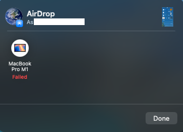

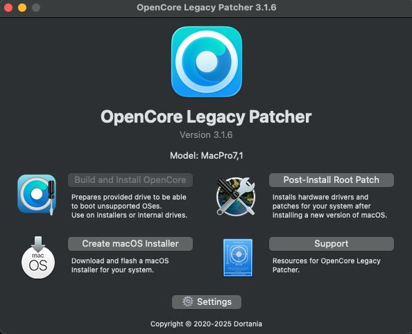

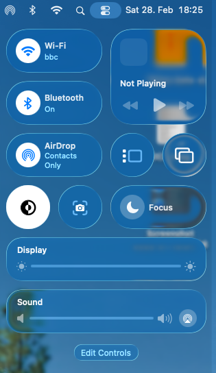

kgp Posted February 28 Share Posted February 28 (edited) Hi folks! I can now also officially confirm that the Modern Wi-Fi patch of OCLP 3.1.6 Nightly works under macOS Tahoe 26.4 beta 2, as long as the Modern Audio patch (AppleHDA) is disabled (default). While Wi-Fi, AirPlay and Screen Mirroring work flawlessly, there are issues with AirDrop: both devices can see each other on both ends, but the file transfer remains on "waiting" and ends with “failed”. For comparison: everything works flawlessly with OCLP 3.0.0 Nightly under macOS Tahoe 26.3 (same machine / same network / same EFI-folder). I finally decided to test OCLP 3.1.6 Nightly on Tahoe 26.4 beta 2 using a spare (but admittedly quite slow) external USB disk. If anyone plans to test OCLP-Mod 3.1.5 or OCLP Nightly 3.1.6 under Tahoe 26.4 beta 2, I’d strongly recommend doing the same and not using your productive system disk for experiments. If anything goes wrong during testing, you can always recover the last sealed snapshot by booting into Recovery and running: mount -uw "/Volumes/Tahoe-beta” bless --mount "/Volumes/Tahoe-beta" --bootefi --last-sealed-snapshot (Replace “Tahoe-beta” with the actual volume name of your 26.4 beta 2 test drive.) Cheers, KGP 👍 Update: I also tested now OCLP-Mod 3.1.5 under macOS 26.4 beta 2 with the AppleHDA patch disabled (warning: enabled by default). Wi-Fi, Airdrop, Airplay and Screen Mirroring work flawlessly.. 👍 Finally don’t forget that OCLP 3.1.6 Nightly requires boot-arg amfi=0x80, while OCLP-Mod 3.1.5 also boots with boot-arg -amfipassbeta. Edited March 5 by KGP-iMacPro Update 3 Link to comment https://www.insanelymac.com/forum/topic/362386-pre-release-macos-tahoe-264/page/4/#findComment-2847827 Share on other sites More sharing options...
MakAsrock Posted March 1 Share Posted March 1 10 hours ago, KGP-iMacPro said: Hi folks! I can now also officially confirm that the Modern Wi-Fi patch of OCLP 3.1.6 Nightly works under macOS Tahoe 26.4 beta 2, as long as the Modern Audio patch (AppleHDA) is disabled (default). While Wi-Fi, AirPlay and Screen Mirroring work flawlessly, there are issues with AirDrop: both devices can see each other on both ends, but the file transfer remains on "waiting" and ends with “failed”. For comparison: everything works flawlessly with OCLP 3.0.0 Nightly under macOS Tahoe 26.3 (same machine / same network / same EFI-folder). I finally decided to test OCLP 3.1.6 Nightly on Tahoe 26.4 beta 2 using a spare (but admittedly quite slow) external USB disk. If anyone plans to test OCLP-Mod 3.1.5 or OCLP Nightly 3.1.6 under Tahoe 26.4 beta 2, I’d strongly recommend doing the same and not using your productive system disk for experiments. If anything goes wrong during testing, you can always recover the last sealed snapshot by booting into Recovery and running: mount -uw "/Volumes/Tahoe-beta” bless --mount "/Volumes/Tahoe-beta" --bootefi --last-sealed-snapshot (Replace “Tahoe-beta” with the actual volume name of your 26.4 beta 2 test drive.) Cheers, KGP 👍 Update: I also tested now OCLP-Mod 3.1.5 under macOS 26.4 beta 2 with the AppleHDA patch disabled (warning: enabled by default). Wi-Fi, Airdrop, Airplay and Screen Mirroring work flawlessly.. 👍 I also noticed a difference when reverting patches: after testing OCLP 3.1.6 Nightly, the Wi-Fi root patch did not revert cleanly on my system. Using OCLP-Mod 3.1.5 I was able to properly revert the previous Wi-Fi root patch of OCLP 3.1.6 Nightly and then successfully apply the Wi-Fi root patch again with OCLP-Mod 3.1.5. Finally don’t forget that OCLP 3.1.6 Nightly requires boot-arg amfi=0x80 while OCLP-Mod 3.1.5 also boots with AMFIPass.kext 1.4.1 and boot-arg -amfipassbeta. I re-uploaded OCLP 3.1.6 with new While Wi-Fi, AirPlay and AirDrop. Try downloading again. 2 Link to comment https://www.insanelymac.com/forum/topic/362386-pre-release-macos-tahoe-264/page/4/#findComment-2847836 Share on other sites More sharing options...
LockDown Posted March 1 Share Posted March 1 40 minutes ago, MakAsrock said: new While Wi-Fi, AirPlay and AirDrop. Try downloading again. New or from previous oclp? 2 Link to comment https://www.insanelymac.com/forum/topic/362386-pre-release-macos-tahoe-264/page/4/#findComment-2847837 Share on other sites More sharing options...
kgp Posted March 1 Share Posted March 1 2 hours ago, MakAsrock said: I re-uploaded OCLP 3.1.6 with new While Wi-Fi, AirPlay and AirDrop. Try downloading again. Wi-Fi, Airplay and Screen mirroring just working fine. Airdrop issue persists. Maybe we should continue debugging in the experimental fork thread or via PM? 1 1 Link to comment https://www.insanelymac.com/forum/topic/362386-pre-release-macos-tahoe-264/page/4/#findComment-2847839 Share on other sites More sharing options...
MakAsrock Posted March 1 Share Posted March 1 7 hours ago, KGP-iMacPro said: Wi-Fi, Airplay and Screen mirroring just working fine. Airdrop issue persists. Maybe we should continue debugging in the experimental fork thread or via PM? I don't know what's wrong. Maybe it's because of the AMFI=80 boot argument. 9 hours ago, LockDown said: New or from previous oclp? From macOS Ventura 13.7.8. 2 Link to comment https://www.insanelymac.com/forum/topic/362386-pre-release-macos-tahoe-264/page/4/#findComment-2847844 Share on other sites More sharing options...
kgp Posted March 1 Share Posted March 1 (edited) 28 minutes ago, MakAsrock said: I don't know what's wrong. Maybe it's because of the AMFI=80 boot argument. From macOS Ventura 13.7.8. Sorry my friend for causing these few troubles, but It’s definitely not amfi=0x80. Because of laziness, I also booted OCLP-Mod 3.1.5 with amfi=0x80 during my testing and there, airdrop worked flawlessly. I also don’t know what is the reason for the airdrop issue with OCLP 3.1.6 under Tahoe 26.4 beta 2 on my system. Anybody else with the same issue? Airdrop works flawlessly on my system and the same EFI with OCLP-Mod 3.1.5 under Tahoe 26.4 beta 2 and with OCLP 3.0.0 Nightly under Tahoe 26.3. My friend, did you test OCLP 3.1.6 Nightly on your own system under Tahoe 26.4 beta 2? Do you have Airdrop fully working? It could well be that the problem is only at my side. Edited March 1 by KGP-iMacPro 2 Link to comment https://www.insanelymac.com/forum/topic/362386-pre-release-macos-tahoe-264/page/4/#findComment-2847845 Share on other sites More sharing options...
MakAsrock Posted March 1 Share Posted March 1 5 hours ago, KGP-iMacPro said: Sorry my friend for causing these few troubles, but It’s definitely not amfi=0x80. Because of laziness, I also booted OCLP-Mod 3.1.5 with amfi=0x80 during my testing and there, airdrop worked flawlessly. I also don’t know what is the reason for the airdrop issue with OCLP 3.1.6 under Tahoe 26.4 beta 2 on my system. Anybody else with the same issue? Airdrop works flawlessly on my system and the same EFI with OCLP-Mod 3.1.5 under Tahoe 26.4 beta 2 and with OCLP 3.0.0 Nightly under Tahoe 26.3. My friend, did you test OCLP 3.1.6 Nightly on your own system under Tahoe 26.4 beta 2? Do you have Airdrop fully working? It could well be that the problem is only at my side. No, I only tested it on macOS 26.3, and Airdrop works on it. On macOS 26.4b2, I only tested Wi-Fi, and it works exactly the same as on macOS 26.3, but I didn't keep the beta. 3 Link to comment https://www.insanelymac.com/forum/topic/362386-pre-release-macos-tahoe-264/page/4/#findComment-2847849 Share on other sites More sharing options...

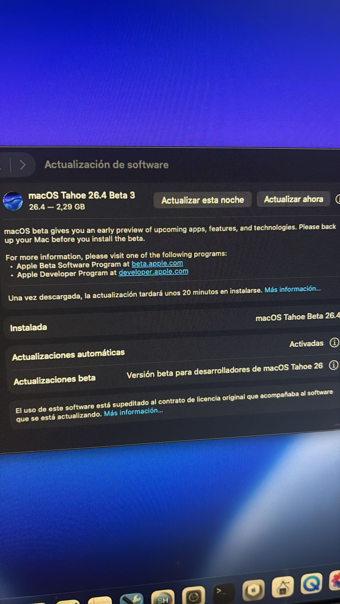

jlrycm Posted March 3 Share Posted March 3 (edited) 9 minutes ago, kaoskinkae said: Perfect: New: Lilu.kext beta 1.7.2 WhateverGreen.kext 1.7.0 New macOS 26.4 beta dropped? Edited March 3 by jlrycm 1 Link to comment https://www.insanelymac.com/forum/topic/362386-pre-release-macos-tahoe-264/page/4/#findComment-2847893 Share on other sites More sharing options...
kaoskinkae Posted March 3 Share Posted March 3 1 hour ago, jlrycm said: ¿Ya se lanzó la nueva versión beta de macOS 26.4? 3 Link to comment https://www.insanelymac.com/forum/topic/362386-pre-release-macos-tahoe-264/page/4/#findComment-2847894 Share on other sites More sharing options...
