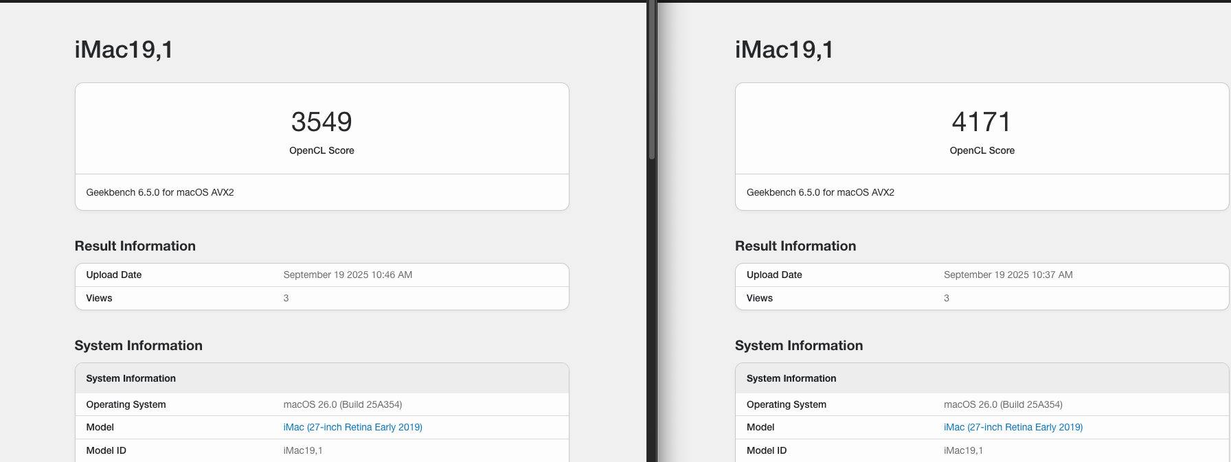

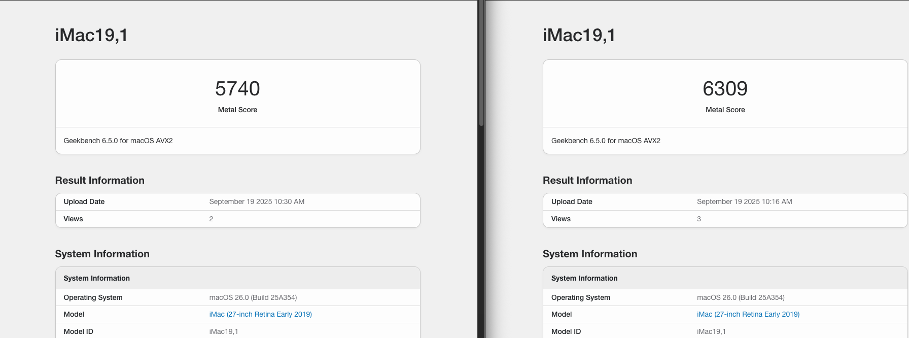

verdazil Posted September 19, 2025 Share Posted September 19, 2025 5 minutes ago, Cyberdevs said: Can you please disable agdpmod in your setting and see if that changes the boot delay? The boot delay is gone. So, now I have slightly better performance at the same temperature, without any negative effects. 1 Link to comment https://www.insanelymac.com/forum/topic/361692-gpu-device-properties-generator/page/2/#findComment-2840922 Share on other sites More sharing options...

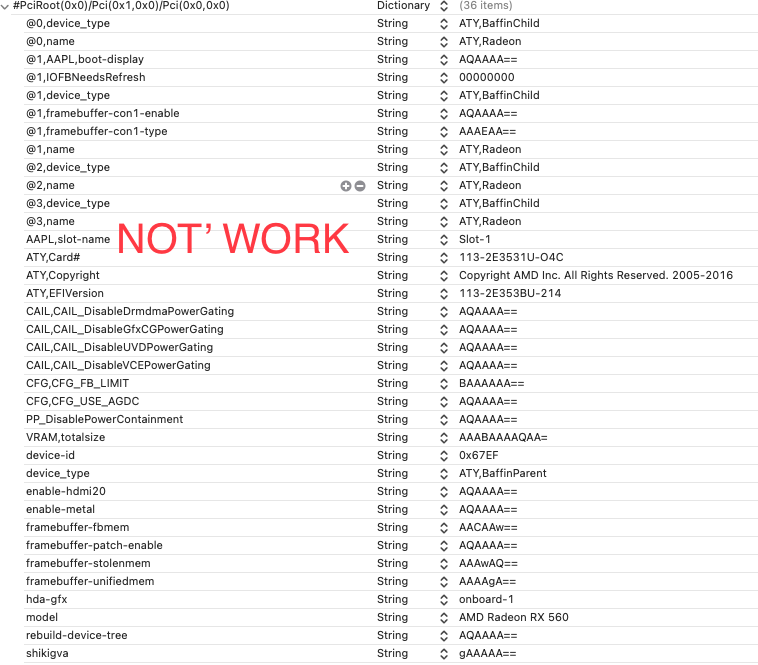

jlrycm Posted September 22, 2025 Share Posted September 22, 2025 On 9/19/2025 at 9:41 AM, JorgeMax said: Here I had black screen even with the WEG and boot-args “agpdmod=pikera”. I did a test by disabling the “agdpmod” key within the GPU properties with the NVRAM boot-args and WEG allowed to load. It gave video signal. I would like to know if it is possible to have the “IOFBneedsRefresh” key generated in the GPU properties. This key has to do with the boot-logo stage of the apple, that black screen between the first and second stage of the logo. He always stays active, he wanted to disable that key. Nice work. @JorgeMax @Cyberdevs what’s the real purpose of this “IOFBneedsRefresh” property? Is it safe to keep it permanently in AMD dGPUs like the RX 6600? 1 Link to comment https://www.insanelymac.com/forum/topic/361692-gpu-device-properties-generator/page/2/#findComment-2841113 Share on other sites More sharing options...

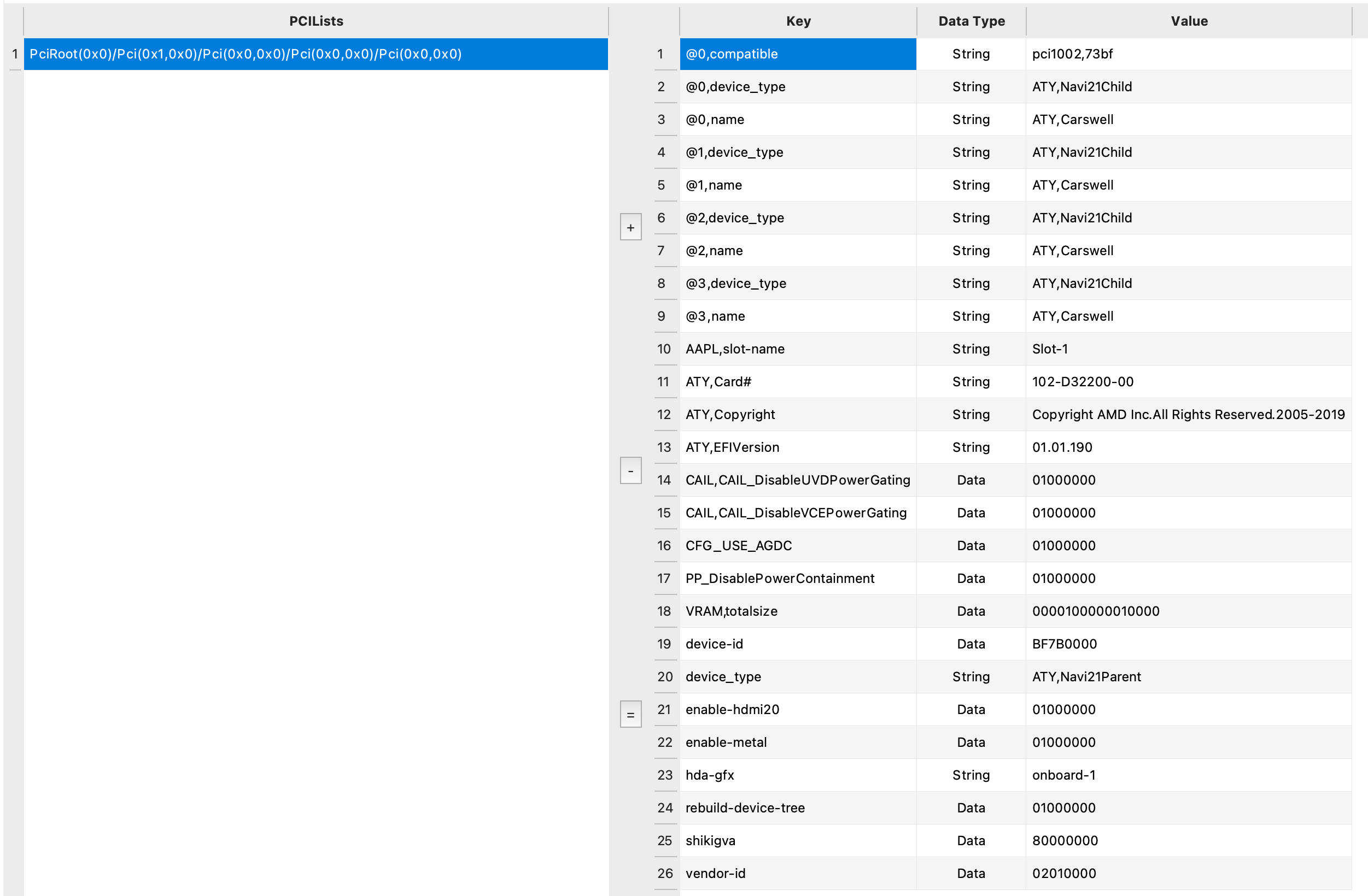

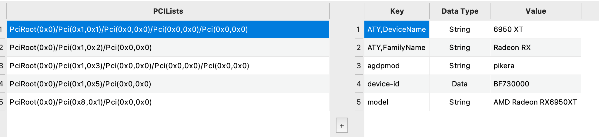

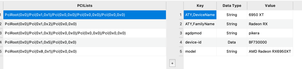

fabiosun Posted September 22, 2025 Share Posted September 22, 2025 Hi @Cyberdevs thank for your job to support hackintosh community I would like to share my tries: this is your app this is how i have it your app produce (IMHO) a wrong Device id for RX 6950 xt BF7B0000 the right one is: BF730000 But also doing this simple modify system does not boot and it loops in infinite errors Maybe is it for the latest iGpu part? 3 Link to comment https://www.insanelymac.com/forum/topic/361692-gpu-device-properties-generator/page/2/#findComment-2841114 Share on other sites More sharing options...
Cyberdevs Posted September 22, 2025 Author Share Posted September 22, 2025 17 minutes ago, jlrycm said: @JorgeMax @Cyberdevs what’s the real purpose of this “IOFBneedsRefresh” property? Is it safe to keep it permanently in AMD dGPUs like the RX 6600? That setting is supposed to fix the second stage boot but it wasn't working in my tests, I'll investigate further more and see if I can get it to work. @fabiosun You're most welcome, yup you're correct the device ID needs to be spoofed to use the RX 6900XT's, I fixed t and I will replace the file I attached in my previous post. Thanks for catching that. The BF7B0000 is the original device ID for RX 6950 XT. But this issue might have been because of the dual GPU in your rig, I didn't consider that. 1 Link to comment https://www.insanelymac.com/forum/topic/361692-gpu-device-properties-generator/page/2/#findComment-2841116 Share on other sites More sharing options...
