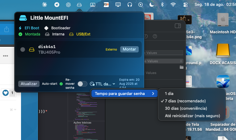

Max.1974 Posted August 18, 2025 Share Posted August 18, 2025 (edited) I hope God bless you my friend, my EFI is already too, with only keychain no password, doble click, ARM/intel Arch, start only in Menu Bar, etc... but your is too much superior, I hope people like and enjoy it much is I am Spoiler Edited August 18, 2025 by Max.1974 7 Link to comment https://www.insanelymac.com/forum/topic/361492-efi-mounter/page/9/#findComment-2839406 Share on other sites More sharing options...

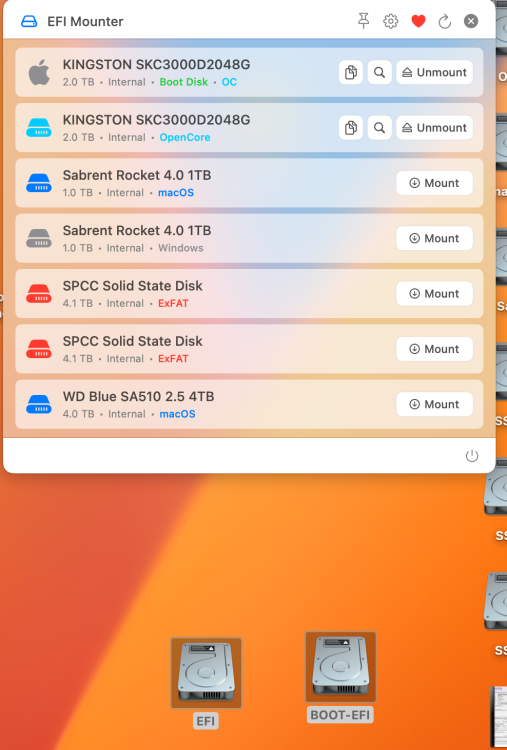

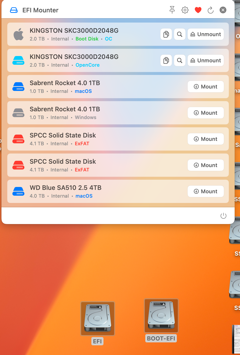

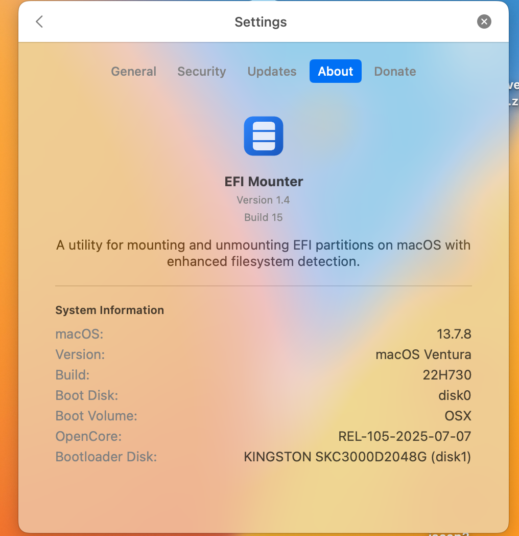

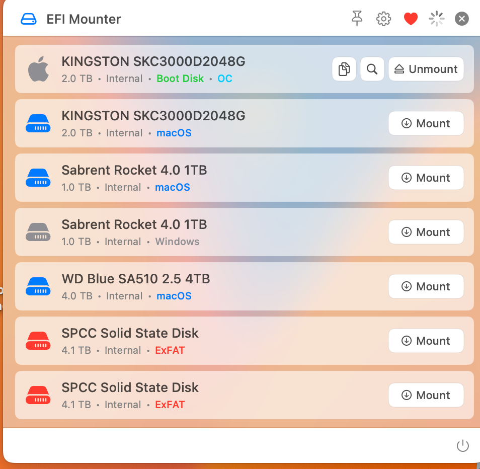

fabiosun Posted August 22, 2025 Share Posted August 22, 2025 (edited) Hi @Cyberdevs thank for your app very useful i have a little problem with it i have two identical Disks 2 Tb Kingston Nvme one for macOs <Ventura one for macOS Sequoia Opencore is on Sequoia One I set from my bios Sequoia as boot disk (inside there is ESP with EFI) if i choose then macOS Ventura EspMounter recognize the wrong disk for ESP: This ESP has an empty EFI obviusly If i boot on Sequoia ESPMounter is correct and i can mount the correct ESP with my booting EFI Have you some advice or could be useful some tests to debug this my problem? Thank you Edited August 22, 2025 by fabiosun 2 Link to comment https://www.insanelymac.com/forum/topic/361492-efi-mounter/page/9/#findComment-2839648 Share on other sites More sharing options...

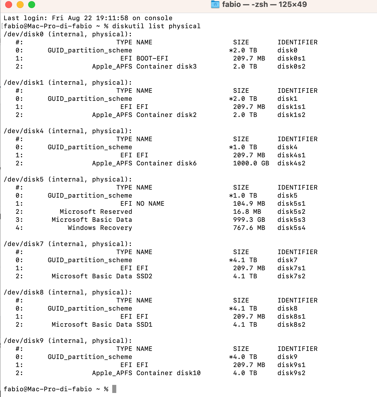

Cyberdevs Posted August 22, 2025 Author Share Posted August 22, 2025 @fabiosun Hi, you're welcome. if the ESP on the Ventura is empty there will be no bootloader indicator when you mount it the app will simply detect the filesystem, e.g, macOS, Windows, etc. You can mount both EFI partitions and send me the screen shot, and you can also run "diskutil list physical" and send me the results as the text and I'll check and see disk identifiers. Since the bootloader is on one disk and I'm assuming you use that EFI folder for both macOSes, I guess the logic gets confused and detects the disk that opencore has booted from. Did I get the problem right? 2 Link to comment https://www.insanelymac.com/forum/topic/361492-efi-mounter/page/9/#findComment-2839650 Share on other sites More sharing options...
fabiosun Posted August 22, 2025 Share Posted August 22, 2025 (edited) Spoiler I think you have understood and maybe i misunderstand the symbol "OC" in my first disk Edited August 22, 2025 by fabiosun 1 Link to comment https://www.insanelymac.com/forum/topic/361492-efi-mounter/page/9/#findComment-2839651 Share on other sites More sharing options...
Cyberdevs Posted August 22, 2025 Author Share Posted August 22, 2025 Ok, I'll look into it. The OC next to the Boot disk indicates that disk has OpenCore as the bootloader and the Boot Disk is the disk macOS has booted from. I guess that's were you get confused, I assume you thought that's the disk that has OpenCore in the EFI partition. 1 1 Link to comment https://www.insanelymac.com/forum/topic/361492-efi-mounter/page/9/#findComment-2839654 Share on other sites More sharing options...

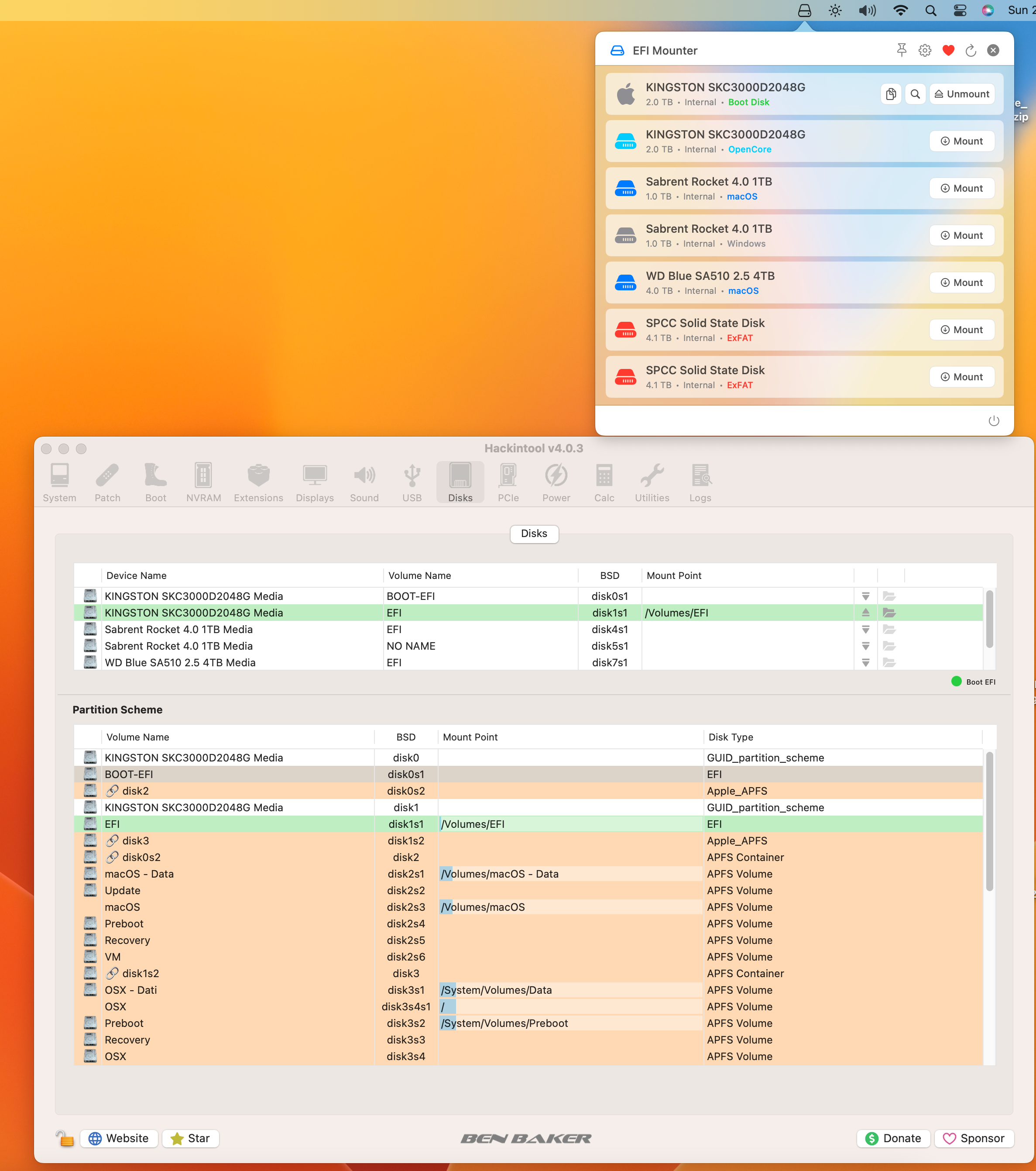

fabiosun Posted August 24, 2025 Share Posted August 24, 2025 @Cyberdevs the "problem"you corrected in brilliant way in your app is also present in Hackintool app Take a look! 2 Link to comment https://www.insanelymac.com/forum/topic/361492-efi-mounter/page/9/#findComment-2839691 Share on other sites More sharing options...

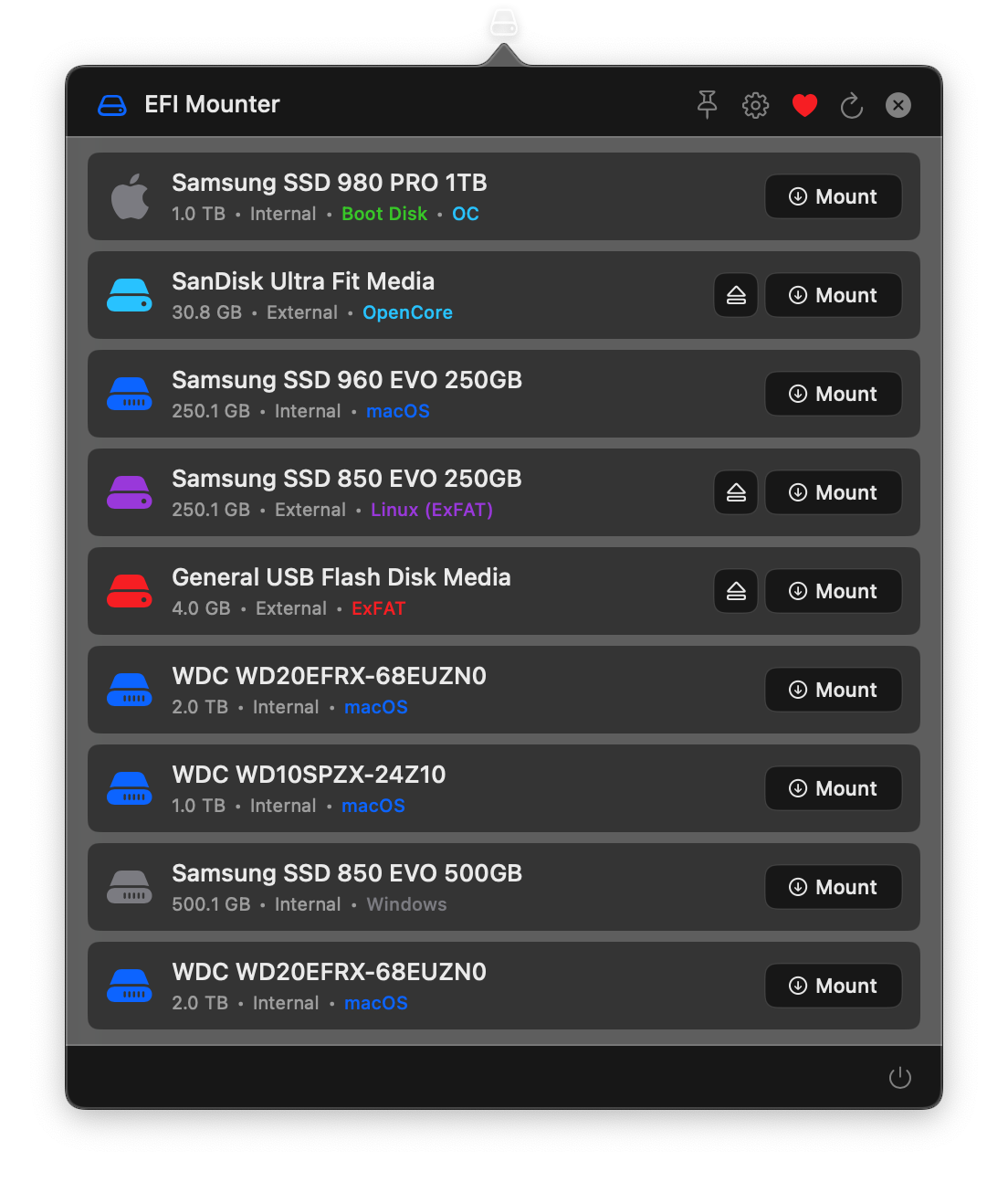

Cyberdevs Posted August 24, 2025 Author Share Posted August 24, 2025 I just published a new version 1.1 with the suggested fix by @fabiosun to detect OpenCore's boot path if system has booted from OpenCore on a disk which is not the same as the macOS boot disk. In this case I've booted the system for SanDisk Ultra Fit Media but macOS has booted from Samsung SSD 980 Pro disk. Also added a feature to Disable Auto Open Finder in app's settings. I hope it's bug free but if you've found any issues just let me know. 9 Link to comment https://www.insanelymac.com/forum/topic/361492-efi-mounter/page/9/#findComment-2839692 Share on other sites More sharing options...

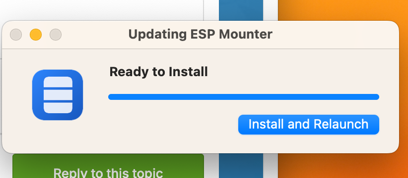

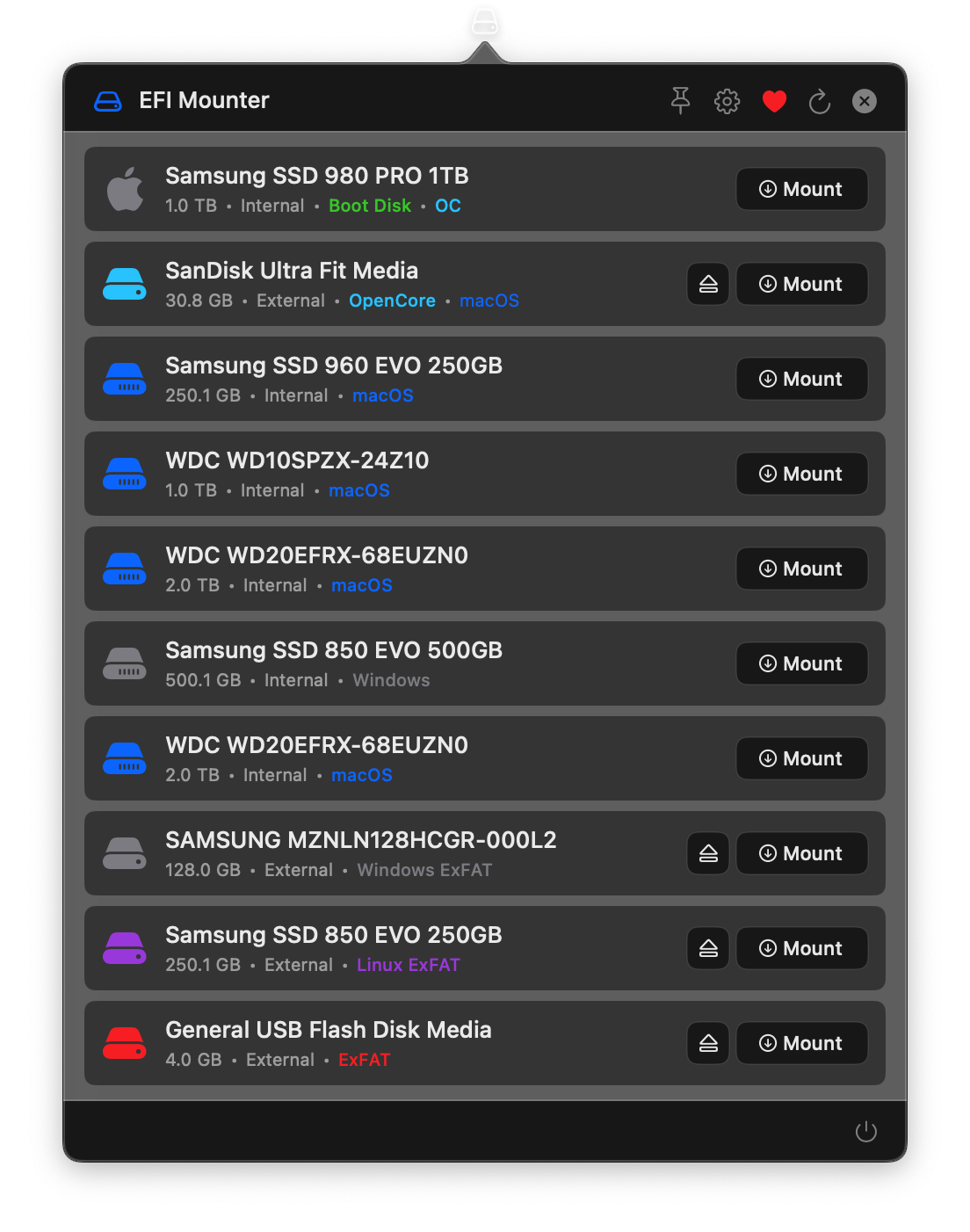

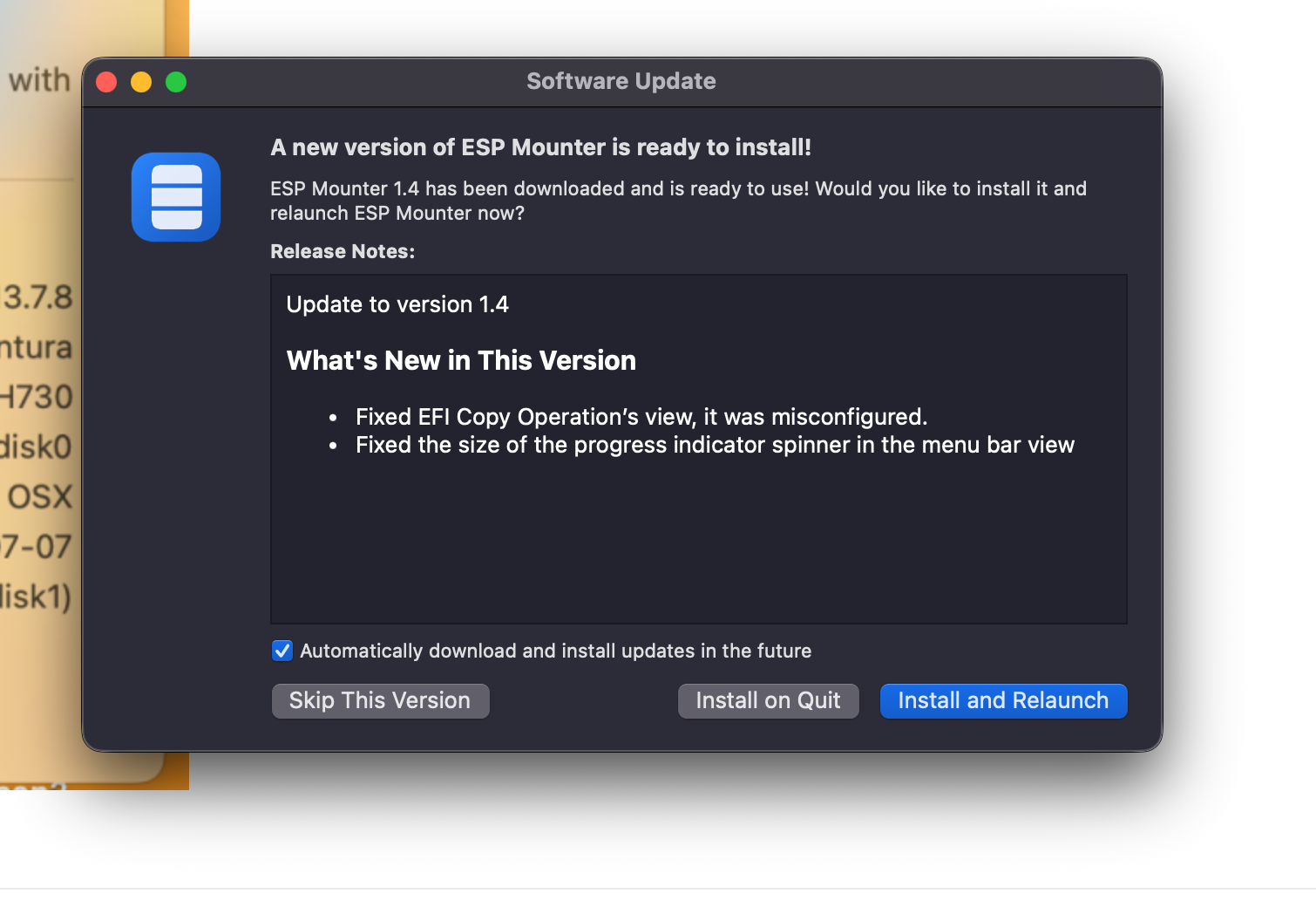

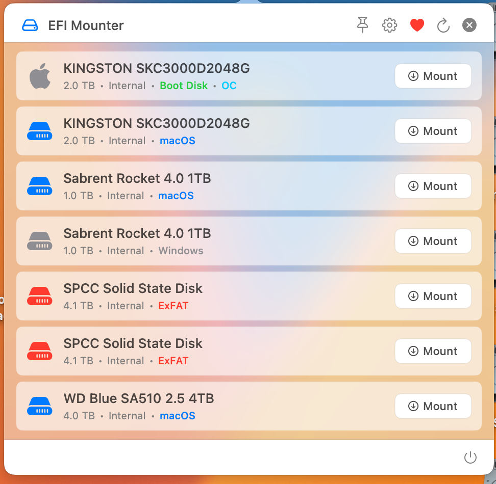

Cyberdevs Posted August 27, 2025 Author Share Posted August 27, 2025 New v1.4 with UI and Filesystem detection improvements. 6 2 Link to comment https://www.insanelymac.com/forum/topic/361492-efi-mounter/page/9/#findComment-2839846 Share on other sites More sharing options...

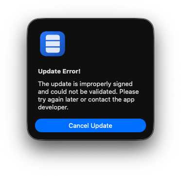

Anto65 Posted August 27, 2025 Share Posted August 27, 2025 (edited) 🙄 Edit : after reboot works ... updated ! Edited August 27, 2025 by Anto65 1 1 Link to comment https://www.insanelymac.com/forum/topic/361492-efi-mounter/page/9/#findComment-2839847 Share on other sites More sharing options...
Cyberdevs Posted August 27, 2025 Author Share Posted August 27, 2025 1 minute ago, Anto65 said: 🙄 But it seems to be ok on my end 2 Link to comment https://www.insanelymac.com/forum/topic/361492-efi-mounter/page/9/#findComment-2839848 Share on other sites More sharing options...

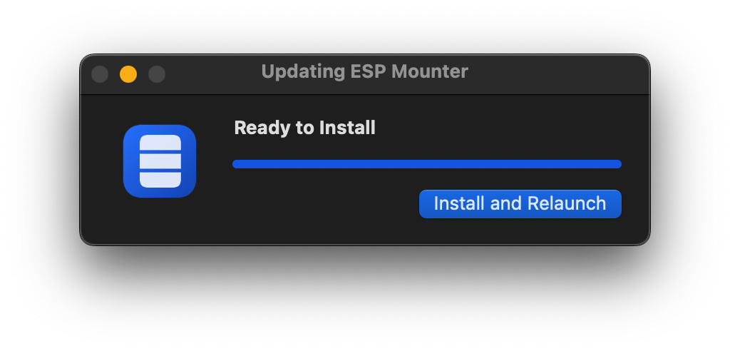

fabiosun Posted August 27, 2025 Share Posted August 27, 2025 2 Link to comment https://www.insanelymac.com/forum/topic/361492-efi-mounter/page/9/#findComment-2839854 Share on other sites More sharing options...

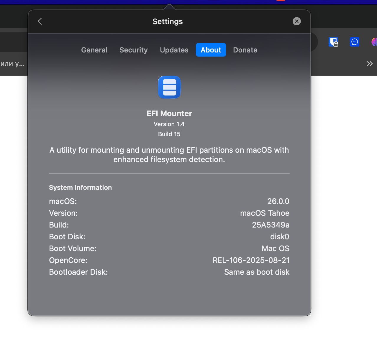

ANTIKO Posted August 27, 2025 Share Posted August 27, 2025 Everything is fine! Spoiler 1 Link to comment https://www.insanelymac.com/forum/topic/361492-efi-mounter/page/9/#findComment-2839872 Share on other sites More sharing options...

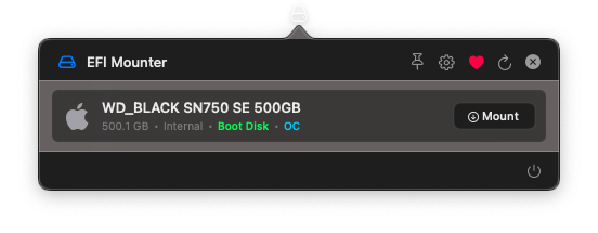

Alpha22 Posted August 31, 2025 Share Posted August 31, 2025 Update to version 1.4 Spoiler 1 Link to comment https://www.insanelymac.com/forum/topic/361492-efi-mounter/page/9/#findComment-2839992 Share on other sites More sharing options...

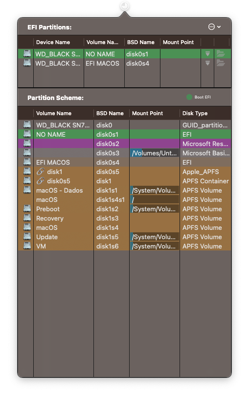

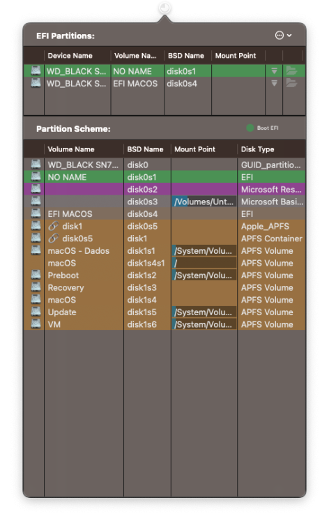

MaLd0n Posted October 1, 2025 Share Posted October 1, 2025 Bro @Cyberdevs! One more good thing! FAT32 created on Windows for easy dual boot in same SSD with Shrink Volume option and DiskGenius don't work. Procedure HERE. This way we have independent EFI partitions. With EFI Agent work fine and appear EFI macOS created on WIndows. 5 Link to comment https://www.insanelymac.com/forum/topic/361492-efi-mounter/page/9/#findComment-2841595 Share on other sites More sharing options...
