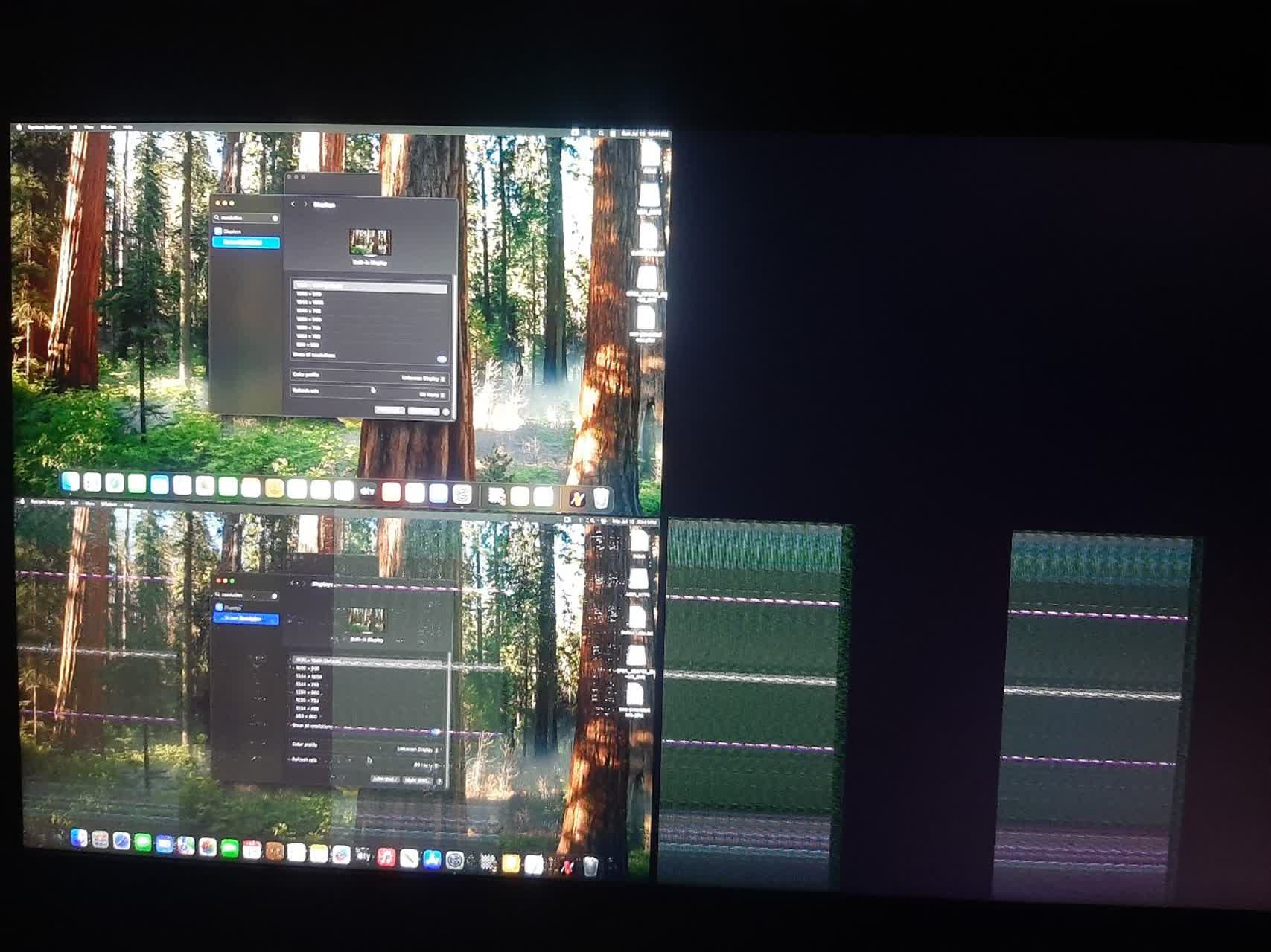

MatinDevs Posted July 16, 2025 Share Posted July 16, 2025 I managed to install macOS Sequoia on my HP EliteBook 1050 G1 with an i7-8750H and UHD 630. I was able to get a display by enabling VESA mode and completing the installation that way. Then I tried removing the flag and performing the necessary OpenCore configurations; however, the screen would freeze after displaying a large number of logs in verbose mode. After a bit of research and trial and error, I injected my dumped EDID into the config. The next boot would display the screen, and I can verify that iGPU acceleration is working; however, it appears to be split into four portions, as shown in the picture. I've tried these yet, with no success; It either freezes in boot, or the same quad-display issue. Enabling/Disabling CSM Trying to manually set resolution in macOS using 3rd Party apps Removing and adding device-id property (my GPU is supported and it's not needed) Trying various platform-ids (nothing seems to be changed) Dumping EDID from MonInfo on Windows, Intel Command Center, and also from Linux Mint, and crafting my own EDID again using edidcraft.com and AW EDID Editor Trying numerous boot-args (including igfx... and more) Changing SMBIOS (Macmini, MBP15,2) Clearing NVRAM using both tools, O,penCore allowed, for each change Verifying that the EDID is indeed being injected Trying to manipulate BusIDs Things that I haven't tried: Enabling dGPU (GTX 1080 with Max-Q Design) Connecting an external monitor (Laptop ports are wired to dGPU, which is disabled) Playing with ACPIs and Kexts (I found nothing related to my issue) I'll attach my latest EFI folder. I think now, with this amount of research I've done and achieved yet no success, maybe maintainers can help with this problem. However, any help is extremely appreaciated! EFI.zip Link to comment https://www.insanelymac.com/forum/topic/361364-quad-display-split-in-hp-laptop/ Share on other sites More sharing options...
Slice Posted July 22, 2025 Share Posted July 22, 2025 It looks like the problem I resolved in Clover several years ago <key>Graphics</key> <dict> <key>DualLink</key> <integer>0</integer> Or 1. Link to comment https://www.insanelymac.com/forum/topic/361364-quad-display-split-in-hp-laptop/#findComment-2837614 Share on other sites More sharing options...
MatinDevs Posted July 22, 2025 Author Share Posted July 22, 2025 Just now, Slice said: It looks like the problem I resolved in Clover several years ago <key>Graphics</key> <dict> <key>DualLink</key> <integer>0</integer> Or 1. Does it have any alternative in OpenCore? Link to comment https://www.insanelymac.com/forum/topic/361364-quad-display-split-in-hp-laptop/#findComment-2837648 Share on other sites More sharing options...
deeveedee Posted July 24, 2025 Share Posted July 24, 2025 @MatinDevs I haven't used that property, but it should be a graphics DeviceProperty that you can inject with Open Core config.plist > DeviceProperties or an SSDT. Link to comment https://www.insanelymac.com/forum/topic/361364-quad-display-split-in-hp-laptop/#findComment-2837833 Share on other sites More sharing options...
