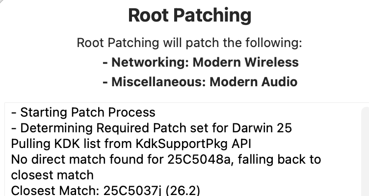

fabiosun Posted December 3, 2025 Share Posted December 3, 2025 (edited) https://github.com/OpenIntelWireless/itlwm/issues/1009#issuecomment-3602342522 in my system it doesnt work and i need to reseal my os also it detects a patch for audio that my system does not need Only doubt is i have 26.2 beta and KDK is different thanks @Anto65 to let me know about this EDIT It doesnt work also in 26.1 with a correct KDK Edited December 3, 2025 by fabiosun 1 Link to comment https://www.insanelymac.com/forum/topic/361249-oclp-mod-releaseissuediscussion/page/17/#findComment-2844433 Share on other sites More sharing options...
schrup21 Posted December 3, 2025 Share Posted December 3, 2025 (edited) 1 hour ago, fabiosun said: https://github.com/OpenIntelWireless/itlwm/issues/1009#issuecomment-3602342522 in my system it doesnt work and i need to reseal my os also it detects a patch for audio that my system does not need Only doubt is i have 26.2 beta and KDK is different thanks @Anto65 to let me know about this EDIT It doesnt work also in 26.1 with a correct KDK indeed it is working here, but needs amfi=0x80 instead of AmfiPass just airdropped a mp4 from Tahoe to my iPhone 😉 Edited December 3, 2025 by schrup21 4 Link to comment https://www.insanelymac.com/forum/topic/361249-oclp-mod-releaseissuediscussion/page/17/#findComment-2844434 Share on other sites More sharing options...

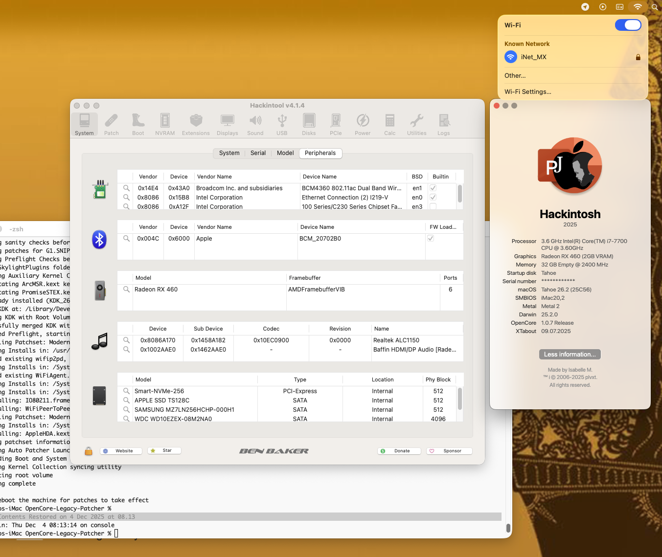

kgp Posted December 3, 2025 Share Posted December 3, 2025 (edited) All the above appears still somewhat cryptic to me. May I ask, what needs to be done is the following?: a.) Download OCLP 3.0.0 with this link?: https://nightly.link/lzhoang2801/OpenCore-Legacy-Patcher/workflows/build-app-wxpython/tahoe-patchset/OpenCore-Patcher.pkg.zip b.) Disable AMFIPass.kext and use boot arg "amfi=0x80" instead? c.) csr-active-config to 03080000? d.) AppleVTD disabled, i.e. DisableIOMapper=true? e.) Same com.apple.iokit.IOSkywalkFamily replacement like under Sequoia? By this, OCLP 3.0.0 Modern Wifi Patch (Broadcom) and Modern Audio Patch are fully working? The Wifi Patch works with my BCM943602CDP, BCM943602CS, BCM94360CD and even with my Intel X210 by adding airportitlwm.kext for Ventura? Thanks in advance for any clarification or confirmation! Cheers, KGP Edited December 3, 2025 by KGP-iMacPro 2 Link to comment https://www.insanelymac.com/forum/topic/361249-oclp-mod-releaseissuediscussion/page/17/#findComment-2844449 Share on other sites More sharing options...
pico joe Posted December 4, 2025 Share Posted December 4, 2025 2 hours ago, KGP-iMacPro said: All the above appears still somewhat cryptic to me. May I ask, what needs to be done is the following?: a.) Download OCLP 3.0.0 with this link?: https://nightly.link/lzhoang2801/OpenCore-Legacy-Patcher/workflows/build-app-wxpython/tahoe-patchset/OpenCore-Patcher.pkg.zip b.) Disable AMFIPass.kext and use boot arg "amfi=0x80" instead? c.) csr-active-config to 03080000? d.) AppleVTD disabled, i.e. DisableIOMapper=true? e.) Same com.apple.iokit.IOSkywalkFamily replacement like under Sequoia? By this, OCLP 3.0.0 Modern Wifi Patch (Broadcom) and Modern Audio Patch are fully working? The Wifi Patch works with my BCM943602CDP, BCM943602CS, BCM94360CD and even with my Intel X210 by adding airportitlwm.kext for Ventura? Thanks in advance for any clarification or confirmation! Cheers, KGP in my case no need to Disable AMFIPass.kext but yes must use boot-arg : amfi=0x80 4 Link to comment https://www.insanelymac.com/forum/topic/361249-oclp-mod-releaseissuediscussion/page/17/#findComment-2844452 Share on other sites More sharing options...
LockDown Posted December 4, 2025 Share Posted December 4, 2025 (edited) This is great. Only 2 frameworks replaced in /S/L/PF & 1 in /usr/libexec Edited December 4, 2025 by LockDown Link to comment https://www.insanelymac.com/forum/topic/361249-oclp-mod-releaseissuediscussion/page/17/#findComment-2844453 Share on other sites More sharing options...
pico joe Posted December 4, 2025 Share Posted December 4, 2025 4 Link to comment https://www.insanelymac.com/forum/topic/361249-oclp-mod-releaseissuediscussion/page/17/#findComment-2844456 Share on other sites More sharing options...
sam298 Posted December 4, 2025 Share Posted December 4, 2025 3 hours ago, pico joe said: in my case no need to Disable AMFIPass.kext but yes must use boot-arg : amfi=0x80 Same for me. Working fine with vt-d disabled in bios and following sequoia instructions except use amfi=0x80 instead of amfipass. I guess they will release a newer amfipass kext soon that will work with tahoe. Airdrop works great. Good thing is it also patches for audio - by installing kdk and kext in the background. 2 Link to comment https://www.insanelymac.com/forum/topic/361249-oclp-mod-releaseissuediscussion/page/17/#findComment-2844460 Share on other sites More sharing options...
