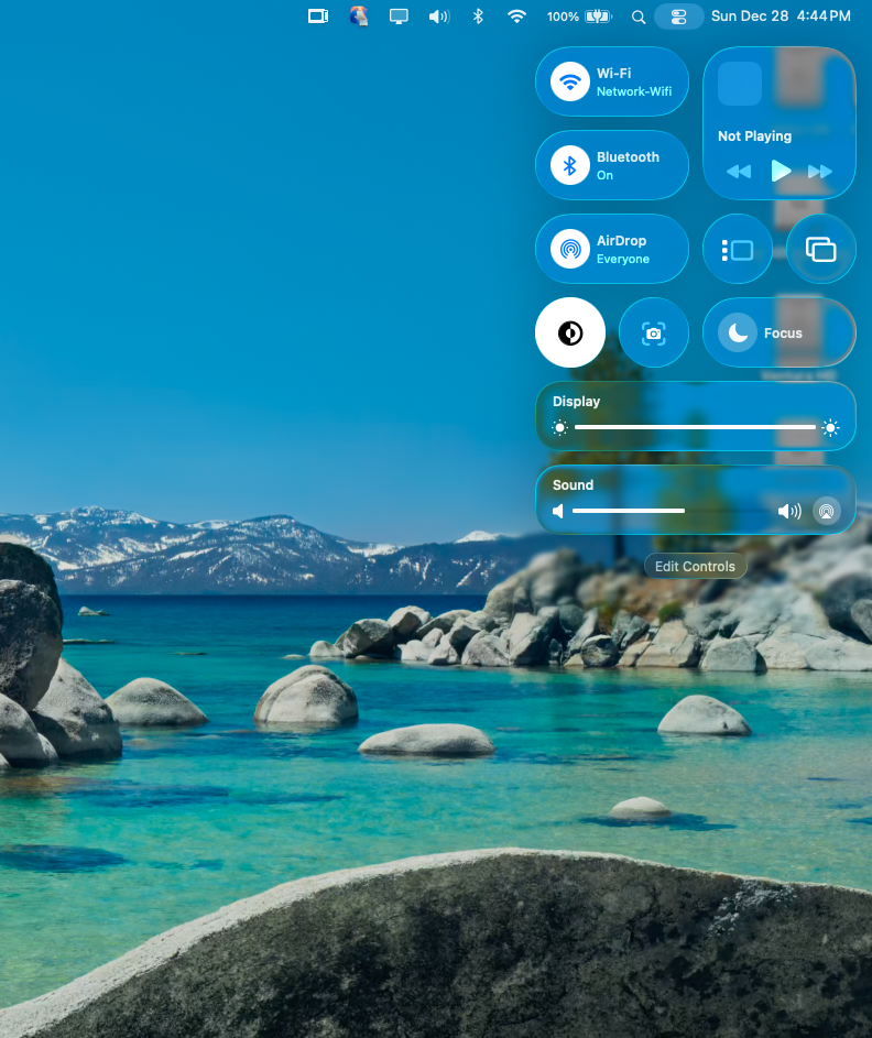

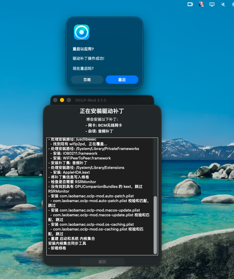

Just an update. I got the wifi working with my Fenvi 219 in Tahoe 26.3 beta. Thanks to all involved
I did have trouble with the wifi patch being greyed out in OcMod 3.1.1 after first reverting the old usb and audio patch. I soon found that was because I still had the original opencore patcher installed,so I also reverted that one too.
Also I found that the mod wanted to automatically install the KDK package before I could click on the patch button and after the patch button would be greyed out again. So I had to be careful to cancel the KDK update so that that patching button was available. The KDK package downloaded and installed after rebooting. I did use boot arg -amfipassbeta and DisableIoMapper set to true so I didn't need to disable vtd in my Bios.
I'm no expert so make of this what you want lol. Cheers

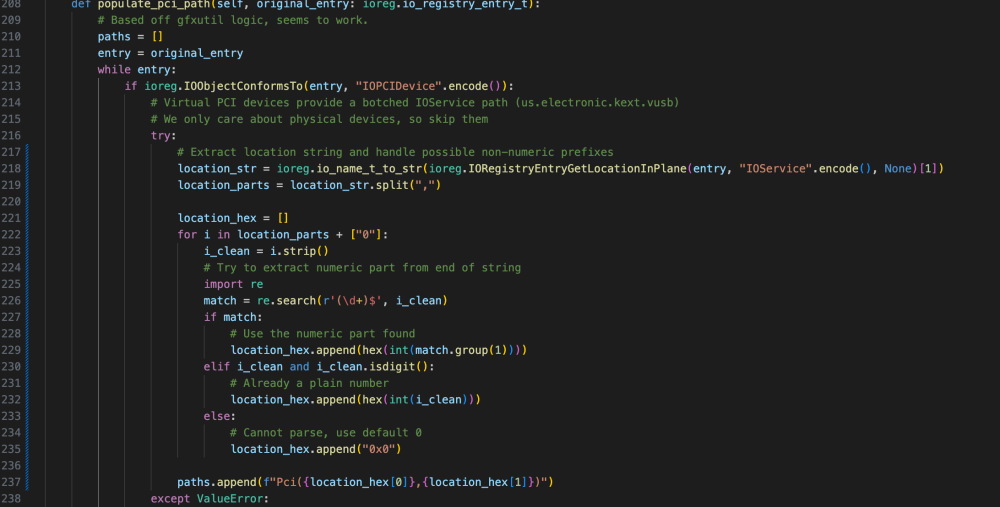

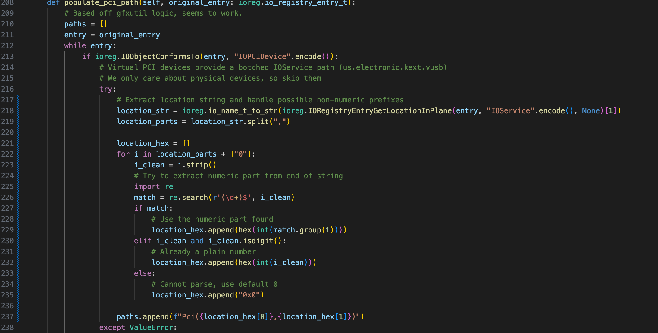

The original version of OCLP crashes on some C612 platforms due to the inability to detect PCI devices. I am unable to reproduce the issue and can only guess and fix it ... already included in OCLP-Mod 3.1.2. Perhaps it is effective?
in device_probe.py

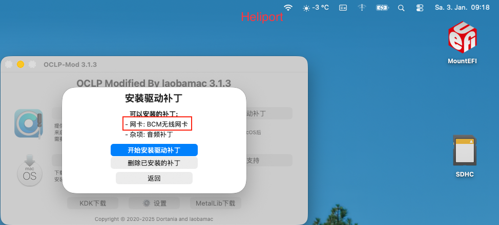

Hi @laobamac_yyds There's a little problem about the Modern WiFi Patch and Intel modules: even when using Itlwm + Heliport.app, and not having IOSkywalkFamily or IO80211FamilyLegacy enabled in OpenCore (nor the block entry for IOSkywalkFamily), OCLP-Mod still wants to apply the Modern WiFi patch. There doesn't seem to be an option to prevent this.
Some users might prefer Itlwm over AirportItlwm (e.g becaus of the use of a hidden Wifi, what AirportItlwm doen't support) and only want to Patch AppleHDA.
There should be a toggle for Modern Wifi oder the Patcher should recognize, if Itlwm is already loaded or if IO80211FamilyLegacy is present; something like that.
Edit: Applying the Modern Wifi Patch has no negative impact.
Spoiler
Edited by schrup21
42 minutes ago, LockDown said:
OCLP does not mind those kext for detection. You might have an IONAME in config
you are right, the BCM Adapter was detected because of IONAME - without OCLP-Mod applies a patch for an "Intel wireless network adapter" (effectively the same Modern Wifi Patch).
However, I've found that Itlwm also works with the Modern Wifi Patch, so it doesn't matter whether the patch is applied or not – it's purely cosmetic.
