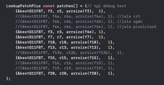

Stezza88 Posted November 11, 2024 Author Share Posted November 11, 2024 (edited) With new f13 patch, instead patch f16 must disable because it stalls on boot to me, log unchanged from previous (I think) wrapConnectionProbe is in use but I don't see changement (I think), hookcase already fixed to 0x044470 Patch in use : ookupPatchPlus const patches[] = {// tgl debug kext {&kextG11FBT, f2, r2, arrsize(f2), 1}, {&kextG11FBT, f7, r7, arrsize(f7), 1}, {&kextG11FBT, f10, r10, arrsize(f10), 1}, {&kextG11FBT, f13, r13, arrsize(f13), 1}, {&kextG11FBT, f15, r15, arrsize(f15), 1}, {&kextG11FBT, f20, r20, arrsize(f20), 1}, }; x.log Edited November 11, 2024 by ASUS Vivobook Link to comment https://www.insanelymac.com/forum/topic/360106-acer-pt14-51-laptop-howto/page/13/#findComment-2827751 Share on other sites More sharing options...
Stezza88 Posted November 11, 2024 Author Share Posted November 11, 2024 (edited) I disabled f3 connectors patch also.. I don't know if changes something but.. but I see square mouse without it pixelclock values come from agdc in my opinion, in the post above the log with new f13 patch, f16 stall on boot Edited November 11, 2024 by ASUS Vivobook Link to comment https://www.insanelymac.com/forum/topic/360106-acer-pt14-51-laptop-howto/page/13/#findComment-2827752 Share on other sites More sharing options...

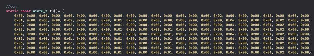

jalavoui Posted November 11, 2024 Share Posted November 11, 2024 (edited) that's what i tough you only needed to change port connection. disabling f3 will use default connectors so you're now using the 1st line if you wanna change something copy it to r3 if this fixed pipe0 then maybe u can enabled the powerwell,etc functions try to disable the f10 patch so the display can power cycle. might give new pixelclocks and check this patches https://github.com/joevt/WhateverGreen/commits/master/ the CheckTimingWithRange() will load in DYLDPatches with some mods. i write about it on main thread Edited November 11, 2024 by jalavoui Link to comment https://www.insanelymac.com/forum/topic/360106-acer-pt14-51-laptop-howto/page/13/#findComment-2827753 Share on other sites More sharing options...

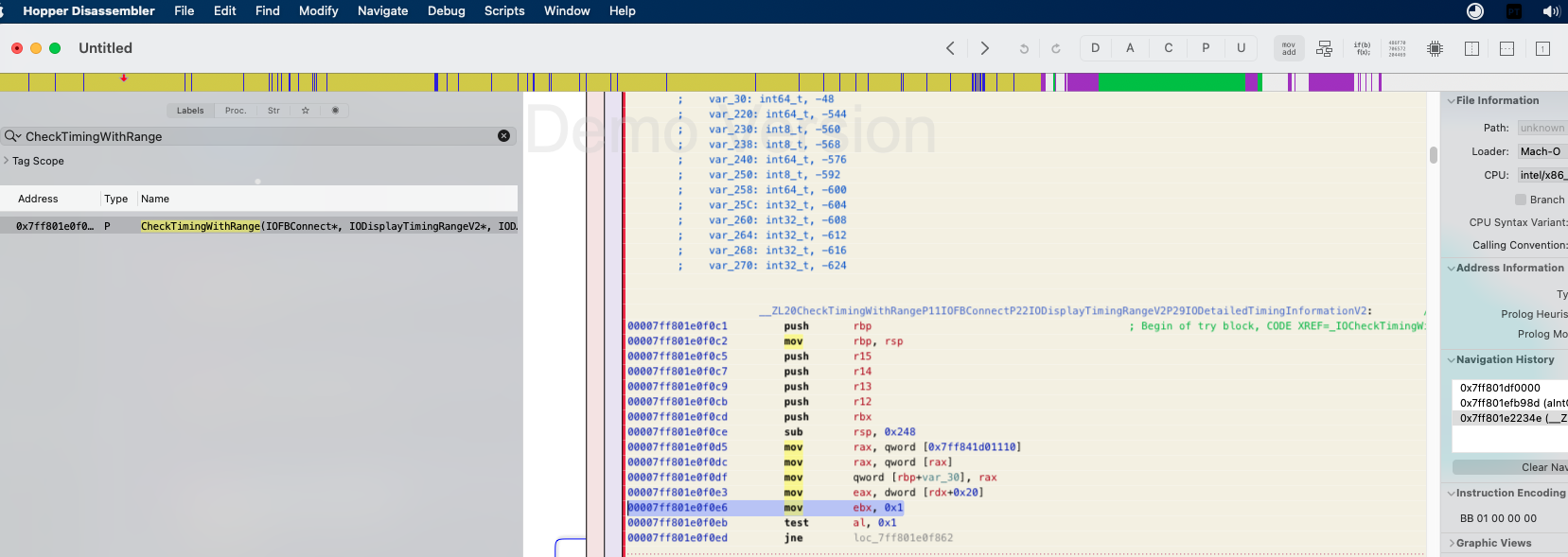

Stezza88 Posted November 11, 2024 Author Share Posted November 11, 2024 (edited) New patch 3 doesn't affected the result to me. Disabling patch 10 I collected a new series of kp and full black screen, I think is no good to my case disabling it. This patch? // 14.7, 15.0 // Patch created by kokozaurs https://github.com/oskarstr static const uint8_t CheckTimingWithRange_Find_14_0[] = { 0x8B, 0x42, 0x20, // mov eax, dword [rdx+0x20] 0x41, 0xBF, 0x01, 0x00, 0x00, 0x00, // mov r15d, 0x1 0xA8, 0x01, // test al, 0x1 0x0F, 0x85 // jne <somewhere> }; static const uint8_t CheckTimingWithRange_Repl_14_0[] = { 0x90, 0x90, 0x90, 0x90, 0x90, 0x90, // nop (6x) 0x41, 0xBF, 0x00, 0x00, 0x00, 0x00, // mov r15d, 0x0 0xE9 // jmp <somewhere> }; This should be wrong in your opinion? (AppleIntelTGLGraphicsFramebuffer) [IGFB][DEBUG][DISPLAY ][AppleIntelFB.cpp : 1853 ][initTimingRange ] (minClock=20000000, maxClock=720000000) Edited November 11, 2024 by ASUS Vivobook Link to comment https://www.insanelymac.com/forum/topic/360106-acer-pt14-51-laptop-howto/page/13/#findComment-2827759 Share on other sites More sharing options...

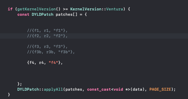

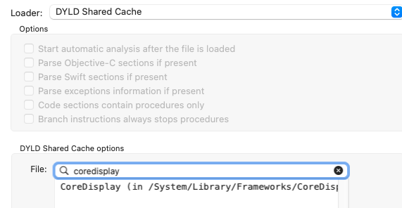

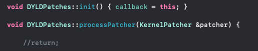

jalavoui Posted November 11, 2024 Share Posted November 11, 2024 (edited) ignore for now minClock. leave for the acelerator phase let me try remenber patch mod load dyld cache with hoper and open core display bytes are here (depend on os x version) because the bytes can match agains other libs copy a big hex string and change the jne to jump in hoper and copy the bytes to DYLDPatches.cpp some patch samples are already there (remove the return; at top to use dyldpatches) idk what else can help you gl Edited November 11, 2024 by jalavoui Link to comment https://www.insanelymac.com/forum/topic/360106-acer-pt14-51-laptop-howto/page/13/#findComment-2827762 Share on other sites More sharing options...
Stezza88 Posted November 11, 2024 Author Share Posted November 11, 2024 How can "load dyld cache" ? Link to comment https://www.insanelymac.com/forum/topic/360106-acer-pt14-51-laptop-howto/page/13/#findComment-2827764 Share on other sites More sharing options...

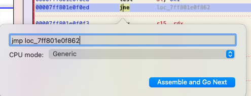

jalavoui Posted November 11, 2024 Share Posted November 11, 2024 (edited) file-read dyld in hopper use copy hex string of bytes to get bytes from hopper replace the f4 when you create the new patch + comment this line. sample for my ventura version - in hopper choose modify - assemble instruction find BB 01 00 00 00 A8 01 0F 85 6F 07 00 00 49 89 D7 49 89 F6 A8 04 74 0B 41 F6 46 3C 0C 0F 84 4E 07 00 00 rep BB 01 00 00 00 A8 01 E9 70 07 00 00 90 49 89 D7 49 89 F6 A8 04 74 0B 41 F6 46 3C 0C 0F 84 4E 07 00 00 Edited November 11, 2024 by jalavoui Link to comment https://www.insanelymac.com/forum/topic/360106-acer-pt14-51-laptop-howto/page/13/#findComment-2827765 Share on other sites More sharing options...
Stezza88 Posted November 11, 2024 Author Share Posted November 11, 2024 (edited) So.. I think that the patch by joevt is good for my system... Edited November 11, 2024 by ASUS Vivobook Link to comment https://www.insanelymac.com/forum/topic/360106-acer-pt14-51-laptop-howto/page/13/#findComment-2827766 Share on other sites More sharing options...
jalavoui Posted November 11, 2024 Share Posted November 11, 2024 (edited) yes you are full of bugs. i tested to force orignal conn zero - the reading of pixel fails,etc,etc good you found the solution Edited November 11, 2024 by jalavoui 1 Link to comment https://www.insanelymac.com/forum/topic/360106-acer-pt14-51-laptop-howto/page/13/#findComment-2827767 Share on other sites More sharing options...

jalavoui Posted November 11, 2024 Share Posted November 11, 2024 (edited) the pacthes will fail with this (wrong size) k test it. need to find out where it hangs or crashes disabling functions is wasting time kern_gen11.cpp Edited November 11, 2024 by jalavoui Link to comment https://www.insanelymac.com/forum/topic/360106-acer-pt14-51-laptop-howto/page/13/#findComment-2827771 Share on other sites More sharing options...
Stezza88 Posted November 11, 2024 Author Share Posted November 11, 2024 (edited) Changed.. always black screen with square mouse Don't know where we can go.. the log is good now... Edited November 11, 2024 by Stezza88 Link to comment https://www.insanelymac.com/forum/topic/360106-acer-pt14-51-laptop-howto/page/13/#findComment-2827772 Share on other sites More sharing options...

jalavoui Posted November 11, 2024 Share Posted November 11, 2024 (edited) 28 minutes ago, Stezza88 said: To me it hangs on boots because it cannot resolve the dependencie to powerwellinit that some of the requests you put into the solving array calls.. it not crash but the panic cone stuck and no kp is printed. that is impossible patches dont depended on functions. it is hanging on the conn zero enable wrapConnectionProbe() and use this conn static const uint8_t r3[]= { 0x00, 0x00, 0x00, 0x00, 0x00, 0x00, 0x00, 0x00, 0x01, 0x00, 0x00, 0x00, 0x01, 0x00, 0x00, 0x00, 0x02, 0x00, 0x00, 0x00, 0x18, 0x00, 0x00, 0x00, 0x01, 0x00, 0x00, 0x00, 0x02, 0x00, 0x00, 0x00, 0x01, 0x00, 0x00, 0x00, 0x00, 0x00, 0x00, 0x00, 0x00, 0x04, 0x00, 0x00, 0x01, 0x02, 0x00, 0x00, 0x02, 0x00, 0x00, 0x00, 0x03, 0x00, 0x00, 0x00, 0x01, 0x00, 0x00, 0x00, 0x00, 0x00, 0x00, 0x00, 0x00, 0x04, 0x00, 0x00, 0x01, 0x02, 0x00, 0x00, 0x00, 0x00, 0x00, 0x00, 0x00, 0x00, 0x00, 0x00, 0x00, 0x00, 0x00, 0x00, 0x00, 0x00, 0x00, 0x00, 0x00, 0x00, 0x00, 0x00, 0x00, 0x00, 0x00, 0x00, 0x00, 0x00, 0x00, 0x00, 0x00, 0x00, 0x00, 0x00, 0x00, 0x00, 0x00, 0x00, 0x00, 0x00, 0x00, 0x00, 0x00, 0x00, 0x00, 0x00, 0x00, 0x00, 0x00, 0x00, 0x00, 0x00, 0x00, 0x00, 0x00, 0x00, 0x00, 0x00, 0x00, 0x00, 0x00, 0x00, 0x00, 0x00, 0x00, 0x00, 0x00, 0x00, 0x00, 0x00, 0x00, 0x00, 0x00, 0x00, 0x00, 0x00, 0x00, 0x00, 0x00, 0x00, 0x00, 0x00, 0x00, 0x00, 0x00, 0x00, 0x00, 0x00, 0x00, 0x00, 0x00, 0x00, 0x00, 0x00, 0x00, 0x00, 0x00, 0x00, 0x00, 0x00, 0x00, 0x00, 0x00, 0x00, 0x00, 0x00, 0x00, 0x00, 0x00, 0x00, 0x00, 0x00, 0x00, 0x00, 0x00, 0x00, 0x00, 0x00, 0x00, 0x00, 0x00, 0x00, 0x00, 0x00, 0x00, 0x00, 0x00, 0x00, 0x00, 0x00, 0x00, 0x00, 0x00, 0x00, 0x00, 0x00, 0x00, 0x00, 0x00, 0x00, 0x00, 0x00, 0x00, 0x00, 0x00, 0x00}; do not disabled any function ! understand that doing that only makes the driver load with bugs you need to find a conn combo that allows the driver to load that is how current tgl driver works ofc we got other bugs to solve but the process is the same Edited November 11, 2024 by jalavoui Link to comment https://www.insanelymac.com/forum/topic/360106-acer-pt14-51-laptop-howto/page/13/#findComment-2827777 Share on other sites More sharing options...

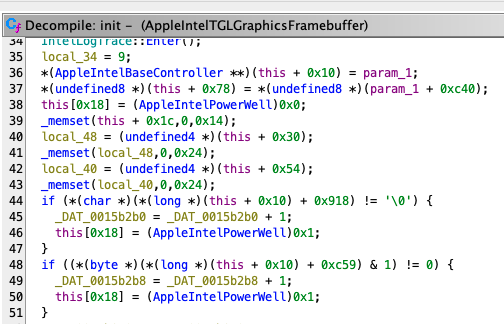

Stezza88 Posted November 11, 2024 Author Share Posted November 11, 2024 it crashes here, I guess! __text:000000000005BD33 call __ZN19AppleIntelPowerWell4initEP24AppleIntelBaseController Link to comment https://www.insanelymac.com/forum/topic/360106-acer-pt14-51-laptop-howto/page/13/#findComment-2827778 Share on other sites More sharing options...
jalavoui Posted November 11, 2024 Share Posted November 11, 2024 (edited) check the kp file for the crash line. did you change the conn patch? Edited November 11, 2024 by jalavoui Link to comment https://www.insanelymac.com/forum/topic/360106-acer-pt14-51-laptop-howto/page/13/#findComment-2827779 Share on other sites More sharing options...
Stezza88 Posted November 11, 2024 Author Share Posted November 11, 2024 (edited) I got no kp.. but it cannot resolve the dependencie without the resolve request to this and stall 15 minutes ago, Stezza88 said: __ZN19AppleIntelPowerWell4initEP24AppleIntelBaseController I changed r3 but stalls It's a guess, if you do a patch to jump this instruction i guess that not crash Edited November 11, 2024 by Stezza88 Link to comment https://www.insanelymac.com/forum/topic/360106-acer-pt14-51-laptop-howto/page/13/#findComment-2827780 Share on other sites More sharing options...
jalavoui Posted November 11, 2024 Share Posted November 11, 2024 (edited) sec. your nblue must be bugged try with this files kern_gen11.hppkern_gen11.cpp Edited November 11, 2024 by jalavoui Link to comment https://www.insanelymac.com/forum/topic/360106-acer-pt14-51-laptop-howto/page/13/#findComment-2827781 Share on other sites More sharing options...
Stezza88 Posted November 11, 2024 Author Share Posted November 11, 2024 (edited) I think no, i have builded Always the latest and never changed quite anything. I don't have kext or acpi about Power management, maybe Is that the motive Edited November 11, 2024 by Stezza88 Link to comment https://www.insanelymac.com/forum/topic/360106-acer-pt14-51-laptop-howto/page/13/#findComment-2827782 Share on other sites More sharing options...
jalavoui Posted November 11, 2024 Share Posted November 11, 2024 (edited) __ZN19AppleIntelPowerWell4initEP24AppleIntelBaseController is from tgl debug but i don't use it in nblue btw u can't disable this function cause of this initial settings. that is why so many bugs Edited November 11, 2024 by jalavoui Link to comment https://www.insanelymac.com/forum/topic/360106-acer-pt14-51-laptop-howto/page/13/#findComment-2827783 Share on other sites More sharing options...
