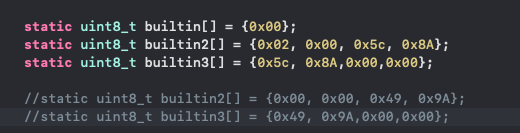

LookupPatchPlus const patches[] = {
	{&kextG11FB, f6, r6, arrsize(f6),1},
	{&kextG11FB, f15, r15, arrsize(f15),1},
Buil-in used
static uint8_t builtin2[] = {0x02, 0x00, 0x5c, 0x8A};
static uint8_t builtin3[] = {0x5c, 0x8A,0x00,0x00};
Edited by ASUS Vivobook

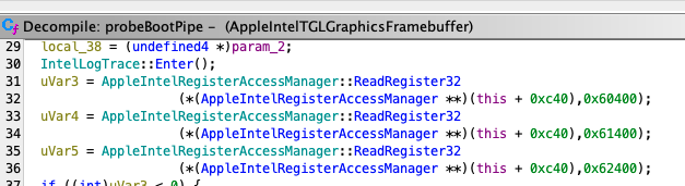

better check tgl kexts - icl is just 2 old
anyway u still can't load a framebuffer so focus on tgl framebuffer cause it is now working.

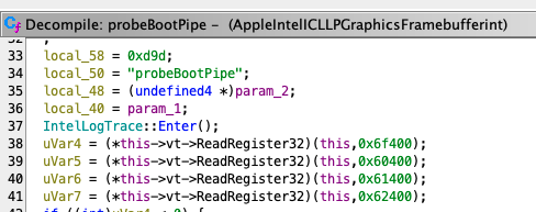

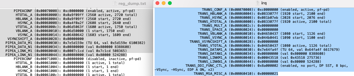

did u get a dump of linux registers like this?
trying to get graph kext to work before having a frame kext is kinda like
you are trying to run before you have learned howto walk
irq.txt
Edited by jalavoui

yes com.xxxxx.driver.AppleIntelTGLGraphicsFramebuffer
the method i use is search in linux code for this registers so i can understand the code.
next u search in the binary for the address.
example: 0x00060400 = 0x60400
in bytes 06 04 00
reverted 00 04 06
so you search inside the binary for 00 04 06
found here

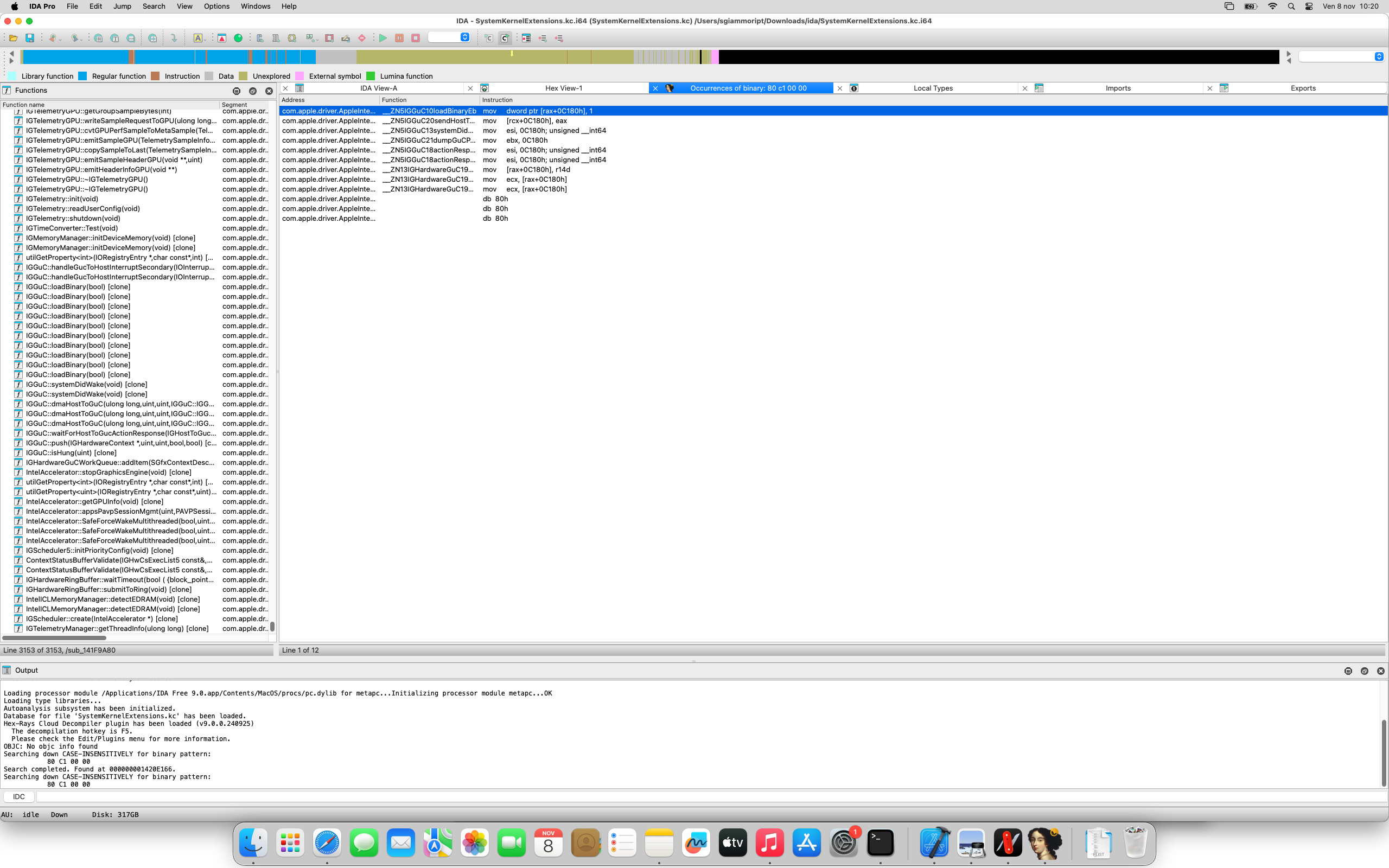

with AppleIntelTGLGraphicsFramebuffer all patches will work cause it's from DTK - we don't have nothing else
there's no magic here, this is hard finding and try/retry until the driver works
that is how tgl driver started to work in nblue

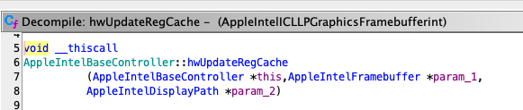

I've got a kp at the end of booting, quite booted after applying some changes..
I enabled these solving requests (after a fast look on Ghidra) (in the last nootedblue master
{"__ZN24AppleIntelBaseController16hwUpdateRegCacheEP21AppleIntelFramebufferP21AppleIntelDisplayPath",releaseDoorbell},
{"__ZN19AppleIntelPowerWell21hwSetPowerWellStatePGEbj.cold.1",releaseDoorbell},
{"__ZN19AppleIntelPowerWell21hwSetPowerWellStatePGEbj.cold.2",releaseDoorbell},
{"__ZN19AppleIntelPowerWell21hwSetPowerWellStatePGEbj.cold.3",releaseDoorbell},
{"__ZN19AppleIntelPowerWell21hwSetPowerWellStatePGEbj.cold.4",releaseDoorbell},
{"__ZN19AppleIntelPowerWell21hwSetPowerWellStatePGEbj.cold.5",releaseDoorbell},
{"__ZN19AppleIntelPowerWell21hwSetPowerWellStatePGEbj.cold.6",releaseDoorbell},
{"__ZN19AppleIntelPowerWell21hwSetPowerWellStatePGEbj.cold.7",releaseDoorbell},
{"__ZN19AppleIntelPowerWell21hwSetPowerWellStatePGEbj.cold.8",releaseDoorbell},
{"__ZN19AppleIntelPowerWell21hwSetPowerWellStatePGEbj.cold.9",releaseDoorbell},
{"__ZN19AppleIntelPowerWell21hwSetPowerWellStatePGEbj.cold.10",releaseDoorbell},
{"__ZN19AppleIntelPowerWell21hwSetPowerWellStatePGEbj.cold.11",releaseDoorbell},
{"__ZN19AppleIntelPowerWell21hwSetPowerWellStatePGEbj.cold.12",releaseDoorbell},
{"__ZN19AppleIntelPowerWell22hwSetPowerWellStateAuxEbj.cold.1",releaseDoorbell},
{"__ZN19AppleIntelPowerWell4initEP24AppleIntelBaseController",releaseDoorbell},
{"__ZN24AppleIntelBaseController5startEP9IOService",tgstart,this->otgstart},

that is old src code but you shouldn't disable those start functions (powerwell, cache)
go get the src i told u. you're using patches that are disabled
for your card try disable this patch only
{&kextG11FBT, f19, r19, arrsize(f19), 1},
if you get kp make sure you don't disable functions unless no other solution is possible
example: if you disable powerwell then all kind of errors will pop up on next functions. this is a bad idea
idk where are you getting nblue but look at current src. not like the one u using
I've modified the current because like this is not working to me.. it stall.. now i try to add one statement of my old config one per time since i had it working..
My final cpp file is this.. got this kp, and i think i Need to patch it.. I must modify the current cpp with some old requests to make things works on my system... I enabled the solving requests that seems corresponding to my bumped and Ghidra registers too..
"0xffffff7f96a6534e com.xxxxx.driver.AppleIntelTGLGraphicsFramebuffer : __ZN19AppleIntelPowerWell19enableDisplayEngineEv + 0x162
0xffffffcbc97a78f0 0xffffff7f96a67814 com.xxxxx.driver.AppleIntelTGLGraphicsFramebuffer : __ZN19AppleIntelPowerWell17enablePowerWellPGEj + 0x21a
0xffffffcbc97a7950 : 0xffffff7f96a562cd com.xxxxx.driver.AppleIntelTGLGraphicsFramebuffer : __ZN24AppleIntelBaseController16enableControllerEP21AppleIntelFramebuffer + 0xff
0xffffffcbc97a79b0 : 0xffffff800586d5da com.ChefKissInc.NootedBlue + 17882
0xffffffcbc97a79d0 : 0xffffff7f96a30af5 com.xxxxx.driver.AppleIntelTGLGraphicsFramebuffer : __ZN21AppleIntelFramebuffer16enableControllerEv + 0x10d"
Kernel-2024-11-09-031738.panickern_gen11.cpp
