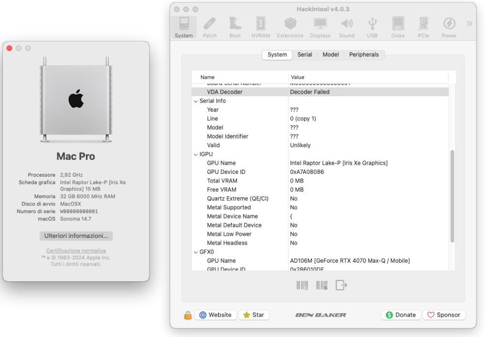

Stezza88 Posted October 15, 2024 Author Share Posted October 15, 2024 (edited) 19 hours ago, miliuco said: @ASUS Vivobook This card is not supported. See here supported models: https://openintelwireless.github.io/itlwm/Compat Please add a signature to your Account Details. EDIT: Nvidia not supported. iGPU is a work in progress. I've resolved with an "hama" usb ethernet adapter (the package told compatible for win and mac both) Edited October 16, 2024 by ASUS Vivobook 1 Link to comment https://www.insanelymac.com/forum/topic/360106-acer-pt14-51-laptop-howto/#findComment-2826532 Share on other sites More sharing options...
Stezza88 Posted October 17, 2024 Author Share Posted October 17, 2024 (edited) With this kext instead of whateverergreen it works too.. but still only 15 mb of ram and no acceleration ... but detected as Intel Iris Xe Graphics that is true.. NootedBlue.kext.zip Edited November 2, 2024 by ASUS Vivobook 1 Link to comment https://www.insanelymac.com/forum/topic/360106-acer-pt14-51-laptop-howto/#findComment-2826597 Share on other sites More sharing options...
miliuco Posted October 17, 2024 Share Posted October 17, 2024 @ASUS Vivobook Congratulations. Your iGPU is not working yet at 100%, but as far as I know this iGPU is not yet able to be completely installed on macOS. Link to comment https://www.insanelymac.com/forum/topic/360106-acer-pt14-51-laptop-howto/#findComment-2826620 Share on other sites More sharing options...
Stezza88 Posted October 18, 2024 Author Share Posted October 18, 2024 (edited) Using Whatevergreen (instead of nootedblue) (latest version) putting only AAPL,ig-platform-id taken by the previous "nootedblue conf" it gives to me a iGPU : Generic iGPU 15MB PCIe : Intel Raptor Lake-P [Iris Xe Graphics] AAPL,ig-platform-id <02005C8A> device-id <A0A70000> and setting this too : <key>PciRoot(0x0)/Pci(0x2,0x0)</key> <dict> <key>AAPL,ig-platform-id</key> <data>AAAF/w==</data> <key>acpi-path</key> <string>IOACPIPlane:/_SB/PC00/GFX0@20000</string> <key>AAPL,GfxYTile</key> <data>AQAAAA==</data> <key>AAPL,slot-name</key> <string>Internal@0,2,0</string> <key>AAPL00,override-no-connect</key> <data>AP///////wAw5HycAAAAAAAfAQSVIhNgA2+xp1VMniUMUFQAAAABAQEBAQEBAQEBAQEBAQEBLjaAoHA4H0AwIDUAWMIQAAAaHySAoHA4H0AwIDUAWMIQAAAaAAAAAAAAAAAAAAAAAAAAAAAAAAAAAgAMOv8KPH0SFCR9AAAAAEY=</data> <key>complete-modeset</key> <data>AQAAAA==</data> <key>disable-agdc</key> <data>AQAAAA==</data> <key>dpcd-max-link-rate</key> <data>CgAAAA==</data> <key>rps-control</key> <data>AQAAAA==</data> <key>igfxfw</key> <data>AgAAAA==</data> <key>framebuffer-stolenmem</key> <data>AAAwAQ==</data> <key>framebuffer-fbmem</key> <data>AACQAA==</data> <key>framebuffer-patch-enable</key> <data>AQAAAA==</data> <key>enable-dvmt-calc-fix</key> <data>AQAAAA==</data> <key>enable-dbuf-early-optimizer</key> <data>AQAAAA==</data> <key>enable-dpcd-max-link-rate-fix</key> <data>AQAAAA==</data> <key>enable-cdclk-frequency-fix</key> <data>AQAAAA==</data> <key>enable-backlight-smoother</key> <data>AQAAAA==</data> <key>enable-backlight-registers-fix</key> <data>AQAAAA==</data> <key>force-online</key> <data>AQAAAA==</data> <key>framebuffer-con0-alldata</key> <data>AAAAAAAAAAAAAAAAAAAAAAIAAAAYAAAA</data> <key>framebuffer-con0-enable</key> <data>AQAAAA==</data> <key>framebuffer-con1-alldata</key> <data>AgAAAAAAAAABAAAAAQAAAAAEAADBAgAA</data> <key>framebuffer-con1-enable</key> <data>AQAAAA==</data> <key>framebuffer-con2-alldata</key> <data>AwAAAAoAAAABAAAAAQAAAAAEAADBAgAA</data> <key>framebuffer-con2-enable</key> <data>AQAAAA==</data> <key>framebuffer-unifiedmem</key> <data>AAAAgA==</data> <key>hda-gfx</key> <string>onboard-1</string> <key>model</key> <string>Intel Raptor Lake-P [Iris Xe Graphics]</string> - and emulating kernel like this (https://chriswayg.gitbook.io/opencore-visual-beginners-guide/advanced-topics/using-alder-lake) but maybe better inserting Ice Lake kernel datas (i applied the Fake but setting the Ice Lake CPU ID 0x0706E5, instead of Comet lake of the guide mentioned) : Cpuid1Data : E5060700 00000000 00000000 00000000 Cpuid1Mask : FFFFFFFF 00000000 00000000 00000000 It's working but still 15 MB of RAM on system informations and no acceleration (either metal or QE/CI graphics acceleration didn't work) So, today i discovered that there is a little bit accent of support tò Raptor Lake gen.. i think i must wait future release of Whatevergreen tò have full support.. or maybe i'm not seeing right the Hackintool logs .. Edited October 22, 2024 by ASUS Vivobook 1 1 Link to comment https://www.insanelymac.com/forum/topic/360106-acer-pt14-51-laptop-howto/#findComment-2826631 Share on other sites More sharing options...

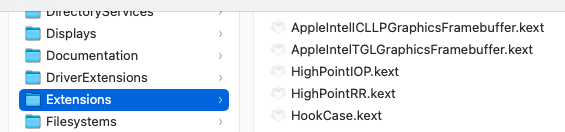

jalavoui Posted October 22, 2024 Share Posted October 22, 2024 (edited) very bad idea remove iondrv - it is needed by other kexts. when your system is fine just install the kexts i said in /Library/Extensions you only will get logs after correctly install nblue don't mount the system rw - you only will break it. i would start by installing only this 2 kexts +hookcase.kext in /L/E and test for loading using kextload -v then try load nblue in opencore when all his is done check for log files and post them here btw get a linux log file for your card so we can check how it works Edited October 23, 2024 by jalavoui Link to comment https://www.insanelymac.com/forum/topic/360106-acer-pt14-51-laptop-howto/#findComment-2826778 Share on other sites More sharing options...

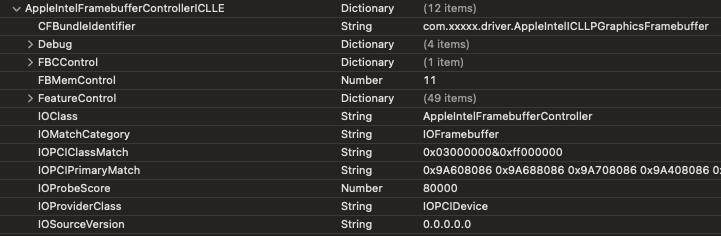

jalavoui Posted October 23, 2024 Share Posted October 23, 2024 (edited) just upload it. we need to check the log. only add your card id to AppleIntelFramebufferControllerICLLE or AppleIntelFramebufferControllerTGLLE at this stage you can only test one of these framebuffers choose 1 and test not in the kexts! use nblue - it is ment todo that Edited October 23, 2024 by jalavoui 1 Link to comment https://www.insanelymac.com/forum/topic/360106-acer-pt14-51-laptop-howto/#findComment-2826802 Share on other sites More sharing options...

Stezza88 Posted October 23, 2024 Author Share Posted October 23, 2024 (edited) AppleIntelFramebufferControllerICLLE ... Stucks in boot Edited November 2, 2024 by ASUS Vivobook Link to comment https://www.insanelymac.com/forum/topic/360106-acer-pt14-51-laptop-howto/#findComment-2826807 Share on other sites More sharing options...
Stezza88 Posted October 23, 2024 Author Share Posted October 23, 2024 (edited) 1 hour ago, jalavoui said: just upload it. we need to check the log. only add your card id to AppleIntelFramebufferControllerICLLE or AppleIntelFramebufferControllerTGLLE at this stage you can only test one of these framebuffers choose 1 and test not in the kexts! use nblue - it is ment todo that What it changes if i add IOPrimaryMatch in kexts info.plist also? There was 0x12345678 inside the two kexts *LE .. nothing i suppose Edited October 23, 2024 by ASUS Vivobook Link to comment https://www.insanelymac.com/forum/topic/360106-acer-pt14-51-laptop-howto/#findComment-2826809 Share on other sites More sharing options...

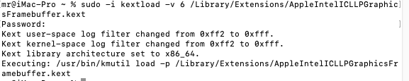

jalavoui Posted October 23, 2024 Share Posted October 23, 2024 (edited) you can only add your card id to ONE framebuffer not to all this will test AppleIntelFramebufferControllerICLLE same thing for AppleIntelFramebufferControllerTGLLE but delete id from ICLLE first! did you check if the kexts are loading using kextload -v /Library/Extensions/AppleIntelTGLGraphicsFramebuffer.kext ? you must get some kind of log from mac os x next job is figure out what's wrong by using xcode functions/patches inside nblue good luck you have a edp connector so this might work check nblue code as it is might not be enabled like this by default Edited October 23, 2024 by jalavoui 1 Link to comment https://www.insanelymac.com/forum/topic/360106-acer-pt14-51-laptop-howto/#findComment-2826810 Share on other sites More sharing options...
