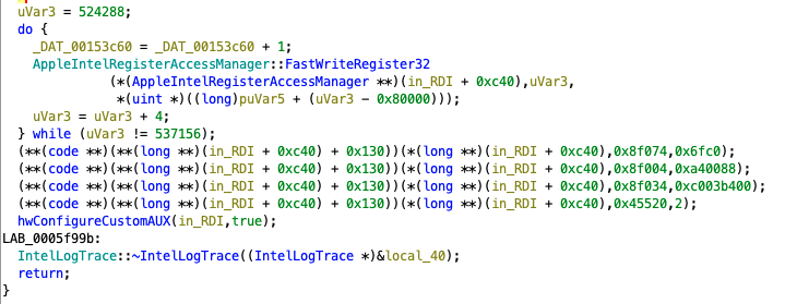

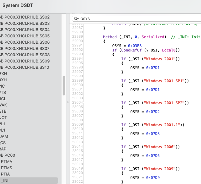

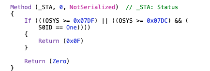

jalavoui Posted November 11, 2024 Share Posted November 11, 2024 (edited) let me explain some of lilu bugs this function void __thiscall AppleIntelPowerWell::init(AppleIntelPowerWell *this,AppleIntelBaseController *param_1) if you do in lilu {"__ZN19AppleIntelPowerWell4initEP24AppleIntelBaseController",handleLinkIntegrityCheck}, you are doing a bad function definition and this will cause bugs same thing when passing wrong parameters. the driver hangs you might need a working SSDT-OSYS.aml.zip if you dsdt.aml as something similiar with this symbols. check before use this sample this is used in dsdt.aml as in this sample Edited November 11, 2024 by jalavoui Link to comment https://www.insanelymac.com/forum/topic/360106-acer-pt14-51-laptop-howto/page/14/#findComment-2827794 Share on other sites More sharing options...

Stezza88 Posted November 13, 2024 Author Share Posted November 13, 2024 But the question is, why does {"__ZN19AppleIntelPowerWell4initEP24AppleIntelBaseController",releaseDoorbell}, unblock my nBlue? Link to comment https://www.insanelymac.com/forum/topic/360106-acer-pt14-51-laptop-howto/page/14/#findComment-2827840 Share on other sites More sharing options...
jalavoui Posted November 13, 2024 Share Posted November 13, 2024 check the new source code. i found why and it's fixed Link to comment https://www.insanelymac.com/forum/topic/360106-acer-pt14-51-laptop-howto/page/14/#findComment-2827844 Share on other sites More sharing options...

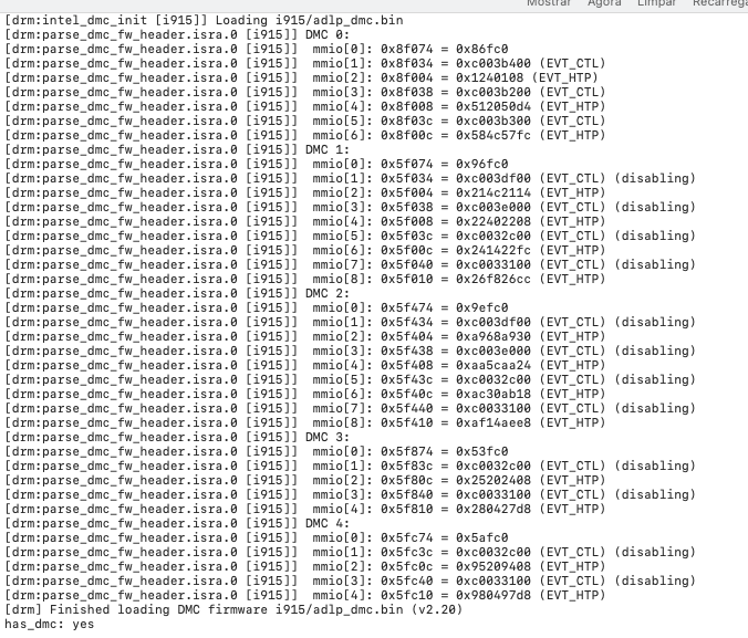

jalavoui Posted November 13, 2024 Share Posted November 13, 2024 (edited) upload the ioreg if you have a boot screen. you might miss the dmc firmare. i've done something in nblue about it but not fully working guess you have more work todo in nblue Edited November 13, 2024 by jalavoui Link to comment https://www.insanelymac.com/forum/topic/360106-acer-pt14-51-laptop-howto/page/14/#findComment-2827848 Share on other sites More sharing options...

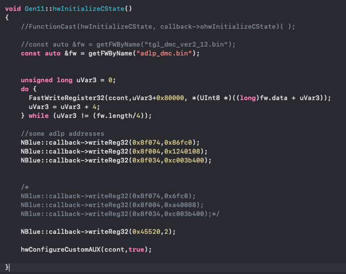

jalavoui Posted November 13, 2024 Share Posted November 13, 2024 (edited) gonna rewrite gmc firmware code.sec done. you need to set the patches for you card in nblue. and use this part idk about other adlp address as theyre not set in mac os x code might need extra checking as i cut linux firmware. Edited November 13, 2024 by jalavoui Link to comment https://www.insanelymac.com/forum/topic/360106-acer-pt14-51-laptop-howto/page/14/#findComment-2827855 Share on other sites More sharing options...

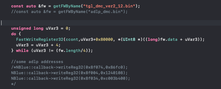

Stezza88 Posted November 13, 2024 Author Share Posted November 13, 2024 (edited) To me it boots (black screen and square mouse) modifing your kern_gen11.cpp like this Here the log (boot start at 00:45:15.684724+0100) kern_gen11.cpp x.log.zip Edited November 13, 2024 by Stezza88 Link to comment https://www.insanelymac.com/forum/topic/360106-acer-pt14-51-laptop-howto/page/14/#findComment-2827857 Share on other sites More sharing options...
jalavoui Posted November 14, 2024 Share Posted November 14, 2024 (edited) you forgot to enable the dmc code for adl. change to here the cutted bins to further checks with originals. see firmware code in NRed github i have some doubts about headers,etc i also see in linux different addresses for tgl and adl - need to investigate Arquivo.zip Edited November 14, 2024 by jalavoui Link to comment https://www.insanelymac.com/forum/topic/360106-acer-pt14-51-laptop-howto/page/14/#findComment-2827859 Share on other sites More sharing options...

jalavoui Posted November 14, 2024 Share Posted November 14, 2024 that's the connectors ports patch. if it is bad configured you get pipe errors and no display. you don't understand what i posted about dmc firmare? it's in the linux log 1 Link to comment https://www.insanelymac.com/forum/topic/360106-acer-pt14-51-laptop-howto/page/14/#findComment-2827862 Share on other sites More sharing options...
