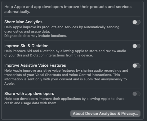

When I install macOS Beta versions, I disable Analytics reporting (System Settings > Private & Security > Analytics & Improvements).
Spoiler
Just curious ... is there anyone who has a strong feeling one way or the other about whether these analytics should be enabled or disabled for our hacks?

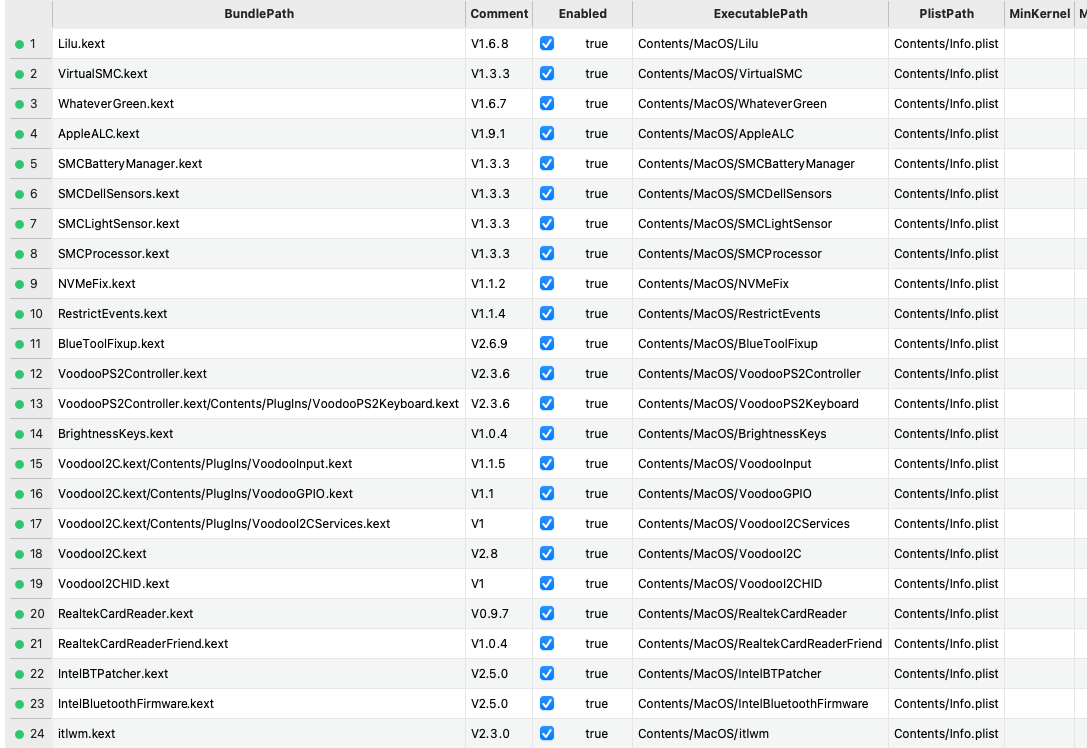

14 hours ago, cankiulascmnfye said:
My guess is that they can be loaded with -lilubetaall.
To the best of my knowledge, boot-arg -lilubetaall applies only to Lilu.kext and Lilu-dependent kexts/plug-ins (AppleALC, WhateverGreen, etc).  I don't think -lilubetaall boot-arg affects loading the Wi-Fi framework kexts that have been extracted from earlier versions of macOS.  Read more here.
EDIT: Control loading / non-loading of Wi-Fi framework kexts with Open Core's MinKernel / MaxKernel in config.plist.
Edited by deeveedee
  • Like 3

1 hour ago, cankiulascmnfye said:
That's corect. But the point is:  as long as not all kexts that rely on Lilu have been updated to support Sequoia, -lilubetaall is still needed, especially on laptops. I rather use one more boot-arg to avoid a kernel panic than waiting for a dev to increment the version check in the source code of his kext by 1.
Ok.  Not trying to debate you or question your preferences for the use of -lilubetaall.  It's just that you originally stated that -lilubetaall was required to load the Wi-Fi framework kexts extracted from earlier macOS.  I was merely stating that It is not.
As far as Min/Max Kernel setting is concerned: there's absolutely no point in using this option for kexts which are mandatory on macOS 12+ to get the legacy Wi-Fi working. You may want to set Min Kernel, Max needs to be left empty. Otherwise you might as well spend money on compatible hardware.
That may be true in the tests that you ran.  Without setting MaxKernel to 23.99.99 for 802.11 kexts on my HackBookPro6,2, Sequoia Beta 1 and Sequoia Beta 2 do not install.  I merely stated that MinKernel and MaxKernel can be used to control loading of the Wi-Fi framework kexts.  I wasn't trying to say that you needed use the Kernel limits and I have no problem with the way you use the Kernel limits.
EDIT: I fully expect to be able to remove the MaxKernel limit after OCLP fully supports Sequoia.
Edited by deeveedee

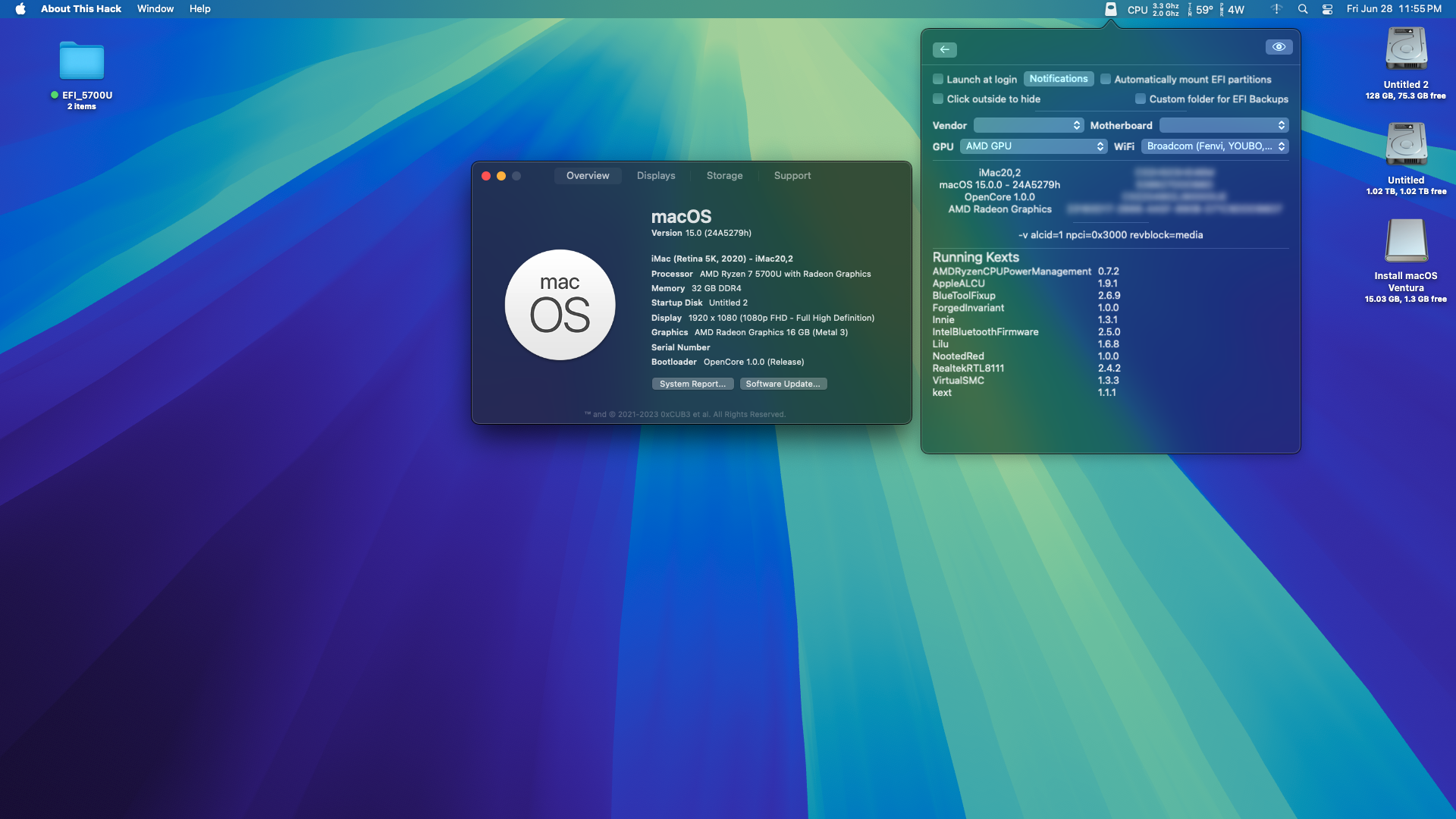

Successfully installed macOS Sequoia Beta 2 onto my 5700U GENmachine and NootedRed seems to working well so far!. Disabling the NootedRed.kext during installation is recommended, macOS installs so much quicker, took an hour from editing the EFI to Desktop.
Edited by Craig Hazan
  • Like 8
