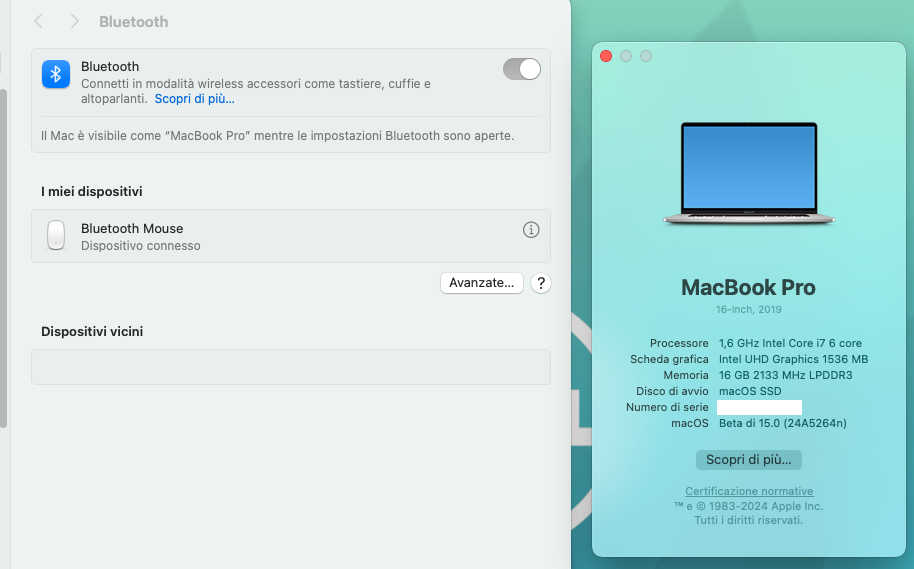

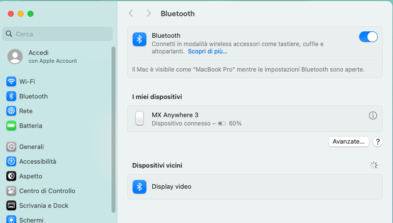

but add nvram setting
bluetoothExternalDongleFailed DATA 00
bluetoothInternalControllerInfo DATA 0000000000000000000000000000
and work
Edited by lorys89
  • Like 4
