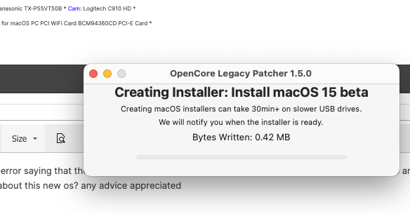

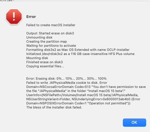

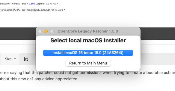

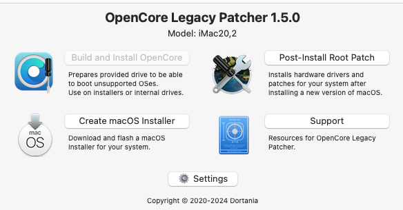

fuzzylogic Posted June 15, 2024 Share Posted June 15, 2024 (edited) I have been trying to create a bootable usb flash drive using openCore patcher and end up with an error saying that the patcher could not get permissions when trying to create a bootable usb any ideas or a better solution to creating a bootable usb drive, not sure why its not working to be honest, its not my first os install so is there something different about this new os? any advice appreciated managed to solve, full disk access was not in place ty Edited June 15, 2024 by fuzzylogic Link to comment https://www.insanelymac.com/forum/topic/359530-pre-release-macos-sequoia/page/9/#findComment-2821212 Share on other sites More sharing options...

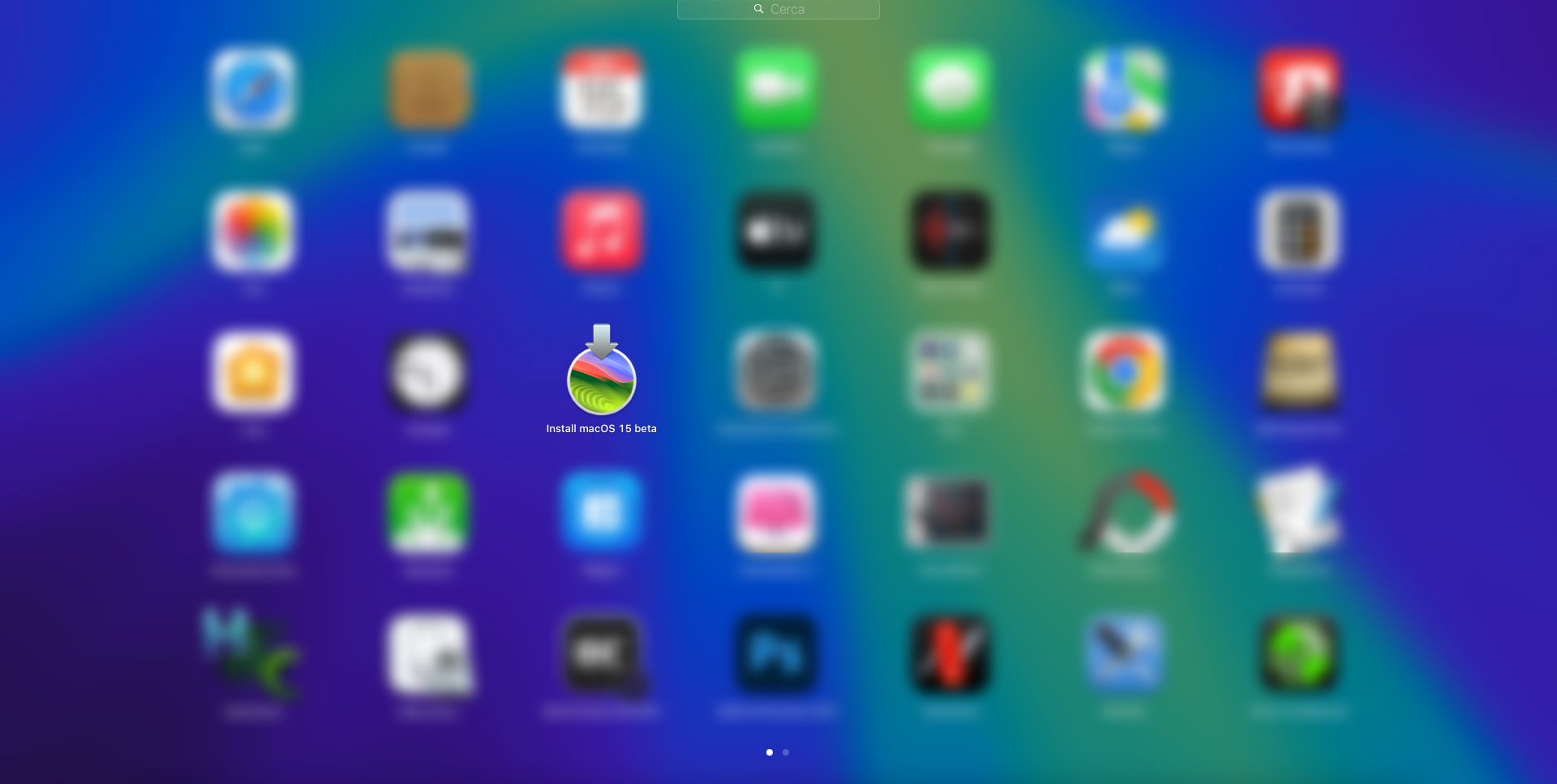

Anto65 Posted June 15, 2024 Share Posted June 15, 2024 Initialize the USB stick Scheme : GUID partition map Format: macOS Journaled Name it Usb From Terminal : sudo /Applications/Install\ macOS\ 15\ beta.app/Contents/Resources/createinstallmedia --volume /Volumes/Usb https://drive.google.com/file/d/1XSNzMpDQX0pZ6swCphvTeHglg5O10dlW/view?usp=drive_link Spoiler 6 Link to comment https://www.insanelymac.com/forum/topic/359530-pre-release-macos-sequoia/page/9/#findComment-2821213 Share on other sites More sharing options...

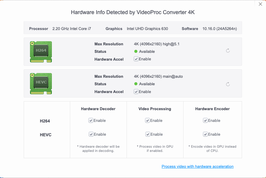

HyperX7 Posted June 15, 2024 Share Posted June 15, 2024 Asus Vivobook; Asus N10 USB Wifi adapter works smoothly with @chris1111 's kexts. Graphics acceleration works at full efficiency. 6 Link to comment https://www.insanelymac.com/forum/topic/359530-pre-release-macos-sequoia/page/9/#findComment-2821214 Share on other sites More sharing options...

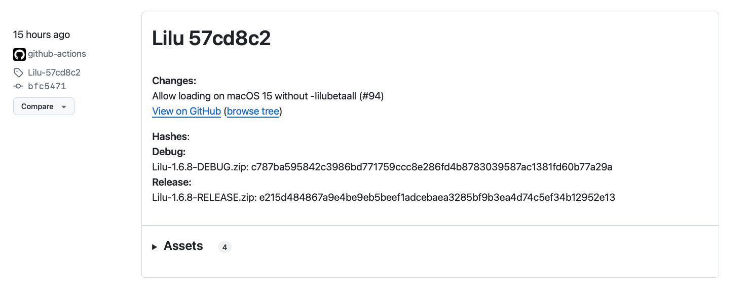

Anto65 Posted June 15, 2024 Share Posted June 15, 2024 Allow loading on macOS 15 without `-lilubetaall` https://github.com/acidanthera/Lilu/commit/4256f4315bf029c4a775cc52100a0d4a0c94663d Tried but not work 🤔 Anyone else have a chance to try it ? 2 1 Link to comment https://www.insanelymac.com/forum/topic/359530-pre-release-macos-sequoia/page/9/#findComment-2821215 Share on other sites More sharing options...
hoaug Posted June 15, 2024 Share Posted June 15, 2024 (edited) No, not yet. We still need it because Lilu plugins (such as WhateverGreen, etc.) have not been updated for macOS 15 Edited June 15, 2024 by kinhhoang161 2 Link to comment https://www.insanelymac.com/forum/topic/359530-pre-release-macos-sequoia/page/9/#findComment-2821216 Share on other sites More sharing options...

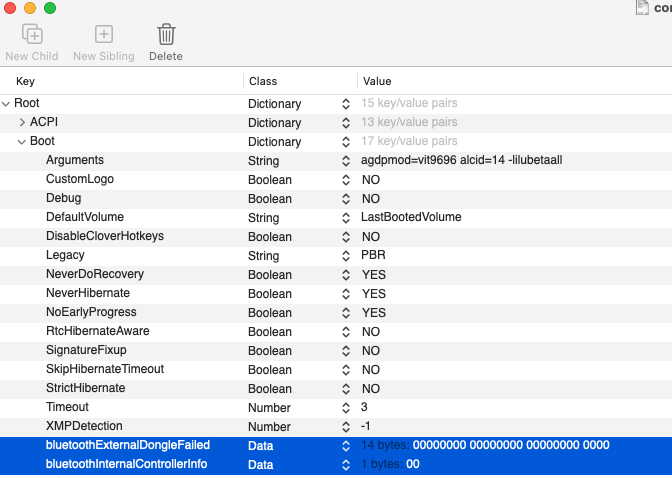

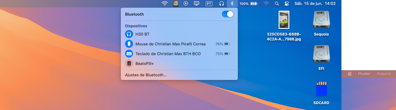

Max.1974 Posted June 15, 2024 Share Posted June 15, 2024 (edited) Hi guys!! Im get work Bluetooth KINIVO BDT-400 4.0 with helper from my friends @MaLd0n @chris1111 and @Hnanoto Just put on Clover on Boot section this arguments Works nice smooth and get Magic Keyboard and Magic Mouse, sound etc... Edited June 15, 2024 by Max.1974 6 Link to comment https://www.insanelymac.com/forum/topic/359530-pre-release-macos-sequoia/page/9/#findComment-2821217 Share on other sites More sharing options...

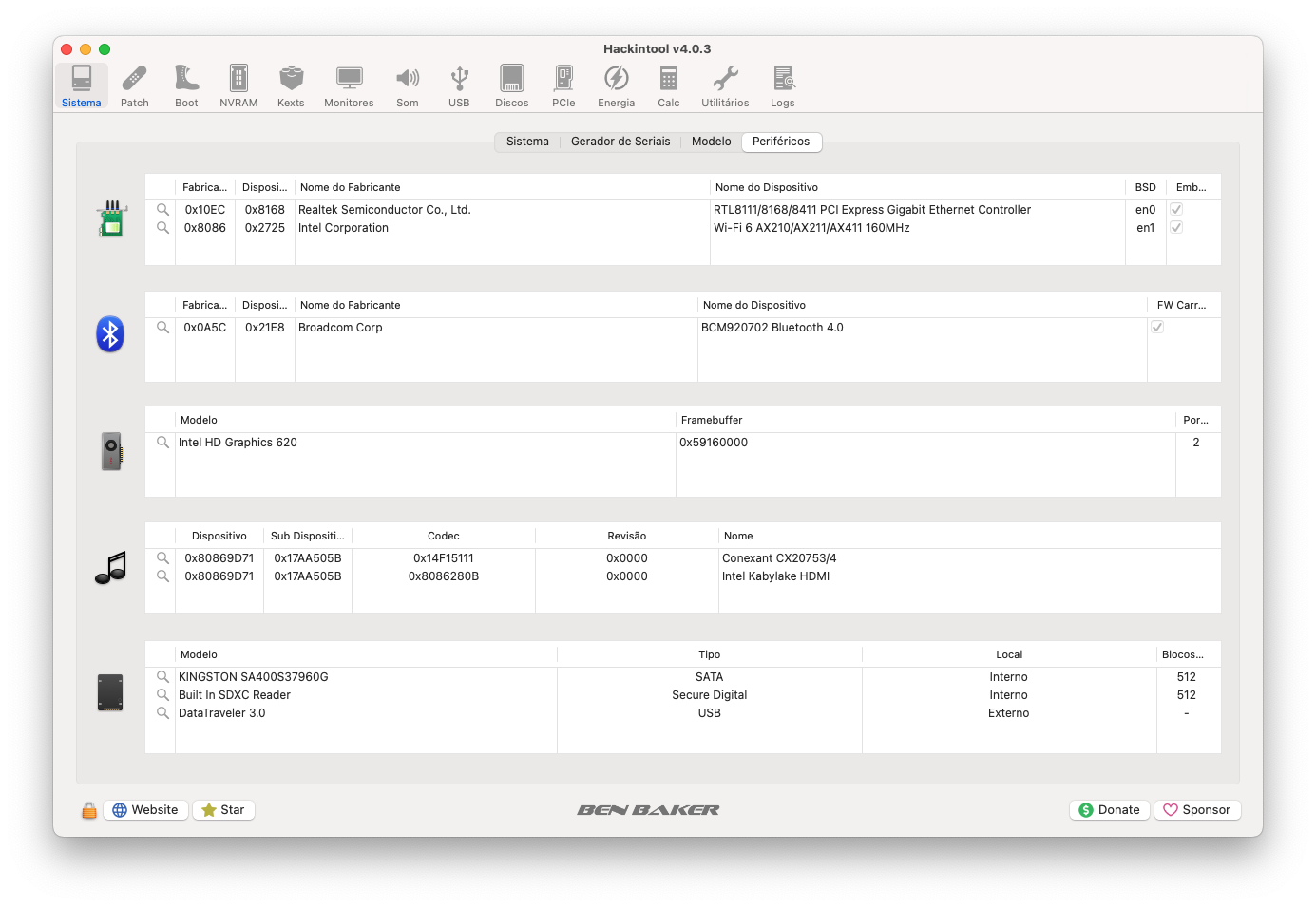

Max.1974 Posted June 15, 2024 Share Posted June 15, 2024 (edited) Im using only BlueToolFixup.kext Lenovo E470 Edited June 15, 2024 by Max.1974 1 Link to comment https://www.insanelymac.com/forum/topic/359530-pre-release-macos-sequoia/page/9/#findComment-2821218 Share on other sites More sharing options...

cankiulascmnfye Posted June 15, 2024 Share Posted June 15, 2024 (edited) 12 hours ago, Anto65 said: Allow loading on macOS 15 without `-lilubetaall` https://github.com/acidanthera/Lilu/commit/4256f4315bf029c4a775cc52100a0d4a0c94663d Tried but not work 🤔 Anyone else have a chance to try it ? Doesn't work for me either. With and without -lilubetaall the system crashes with this version. Reverted to previous build with -lilubetaall EDIT: It's working now with the latest kext and -lilubetaall. I've notices It's really important to reset NVRAM after updating Lilu. Otherwise the system crashes on boot. Edited June 16, 2024 by cankiulascmnfye 1 Link to comment https://www.insanelymac.com/forum/topic/359530-pre-release-macos-sequoia/page/9/#findComment-2821222 Share on other sites More sharing options...

Avery B Posted June 15, 2024 Share Posted June 15, 2024 My poor Chromebook with a 10th gen i5 capped at 15W is not very happy running Sequoia, especially when plugged into a higher res screen. Little hard to tell if it's any faster than Sonoma from here haha. Each Lilu plugin (Weg, ECEnabler, etc) all have their own check for the max macOS version they can run. `-lilubetaall` bypasses it for every Lilu plugin. You could skip it if you enabled that beta flag for every kext (`-ecebeta` for example for ECEnabler). 6 Link to comment https://www.insanelymac.com/forum/topic/359530-pre-release-macos-sequoia/page/9/#findComment-2821233 Share on other sites More sharing options...

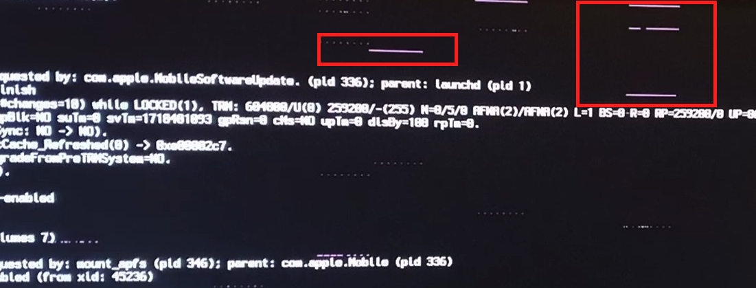

ismolika Posted June 15, 2024 Share Posted June 15, 2024 Stuck at this. This is i belive after last reboot. My monitors turn white and other one turns grey. Then this is where it hangs on. Any ideas? Link to comment https://www.insanelymac.com/forum/topic/359530-pre-release-macos-sequoia/page/9/#findComment-2821237 Share on other sites More sharing options...

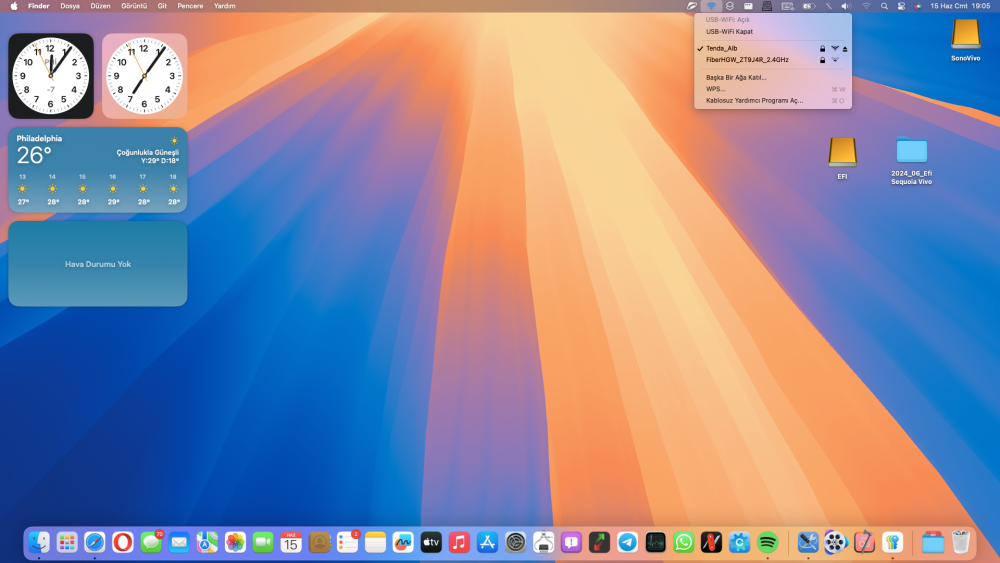

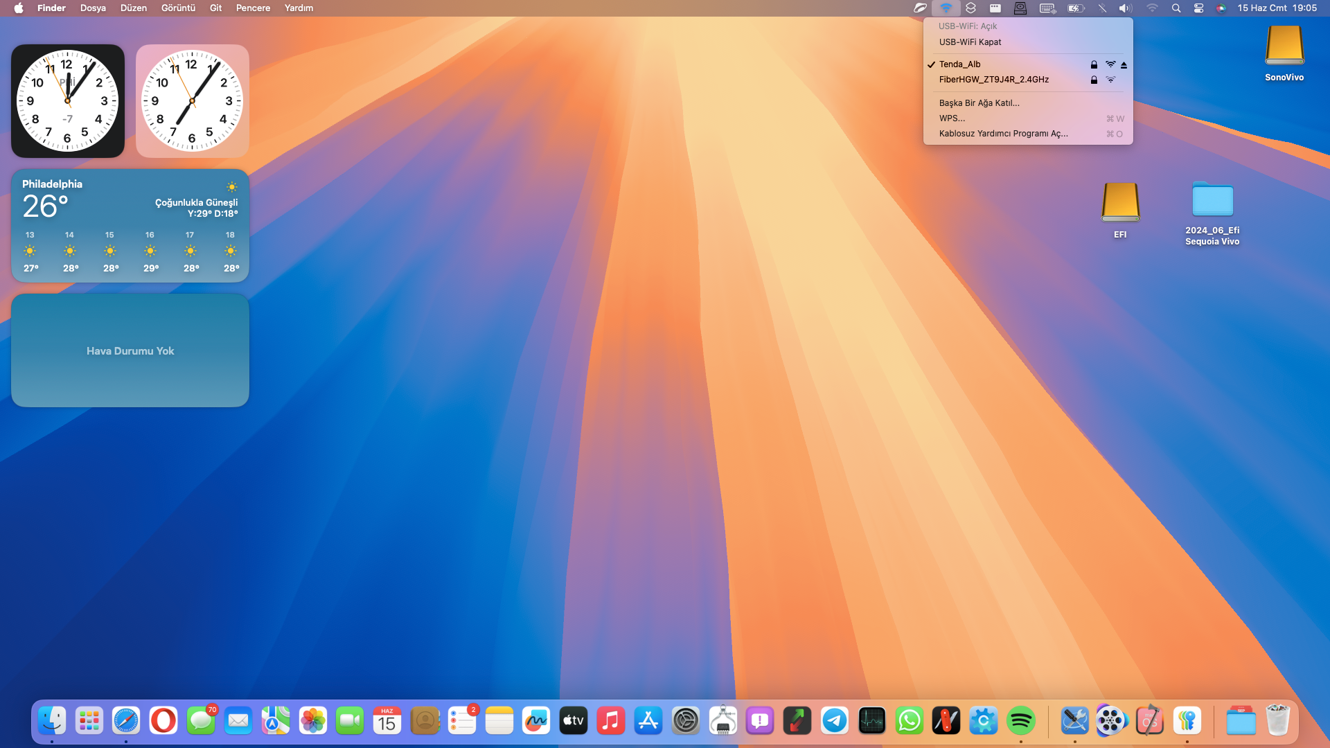

AlfredoM Posted June 16, 2024 Share Posted June 16, 2024 @Max.1974 I use this one: AC1900 High Gain Wireless Dual Band USB Adapter V.2 1 1 Link to comment https://www.insanelymac.com/forum/topic/359530-pre-release-macos-sequoia/page/9/#findComment-2821240 Share on other sites More sharing options...
cankiulascmnfye Posted June 16, 2024 Share Posted June 16, 2024 @ismolika We need verbose output to help you. Link to comment https://www.insanelymac.com/forum/topic/359530-pre-release-macos-sequoia/page/9/#findComment-2821243 Share on other sites More sharing options...
Joshua60 Posted June 16, 2024 Share Posted June 16, 2024 Try -lilubeta instead of -lilubetaall. It works for me at least. 1 Link to comment https://www.insanelymac.com/forum/topic/359530-pre-release-macos-sequoia/page/9/#findComment-2821244 Share on other sites More sharing options...
HyperX7 Posted June 16, 2024 Share Posted June 16, 2024 (edited) If you update Lilu kext, the -lilubetaall argument is no longer needed. https://github.com/dortania/build-repo/releases Edited June 16, 2024 by HyperX7 2 Link to comment https://www.insanelymac.com/forum/topic/359530-pre-release-macos-sequoia/page/9/#findComment-2821246 Share on other sites More sharing options...
BALDY_MAN Posted June 16, 2024 Share Posted June 16, 2024 @HyperX7 I still had to use -lilubetaall even with Lilu 1.6.8 1 Link to comment https://www.insanelymac.com/forum/topic/359530-pre-release-macos-sequoia/page/9/#findComment-2821247 Share on other sites More sharing options...
