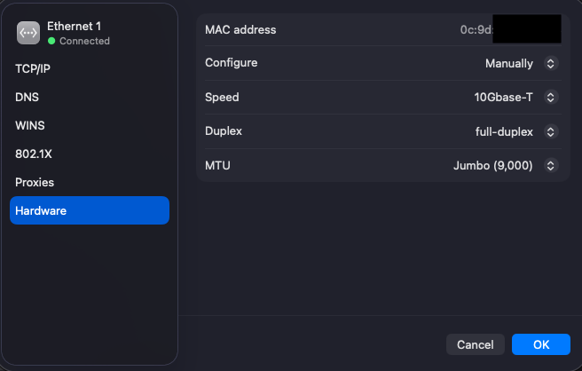

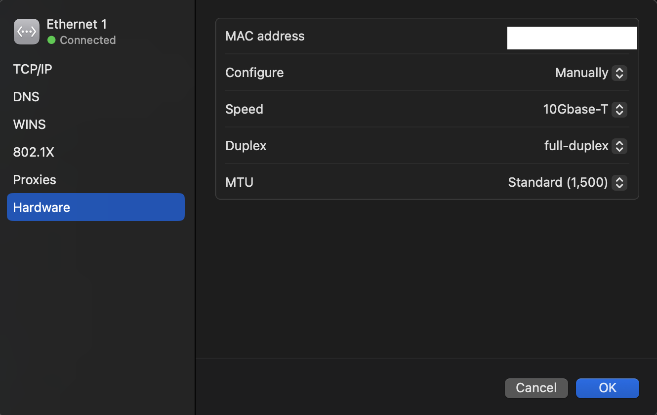

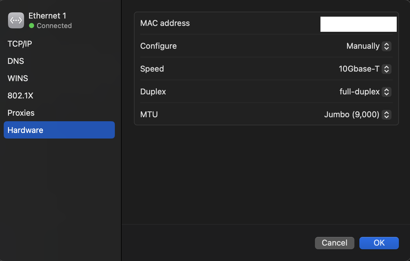

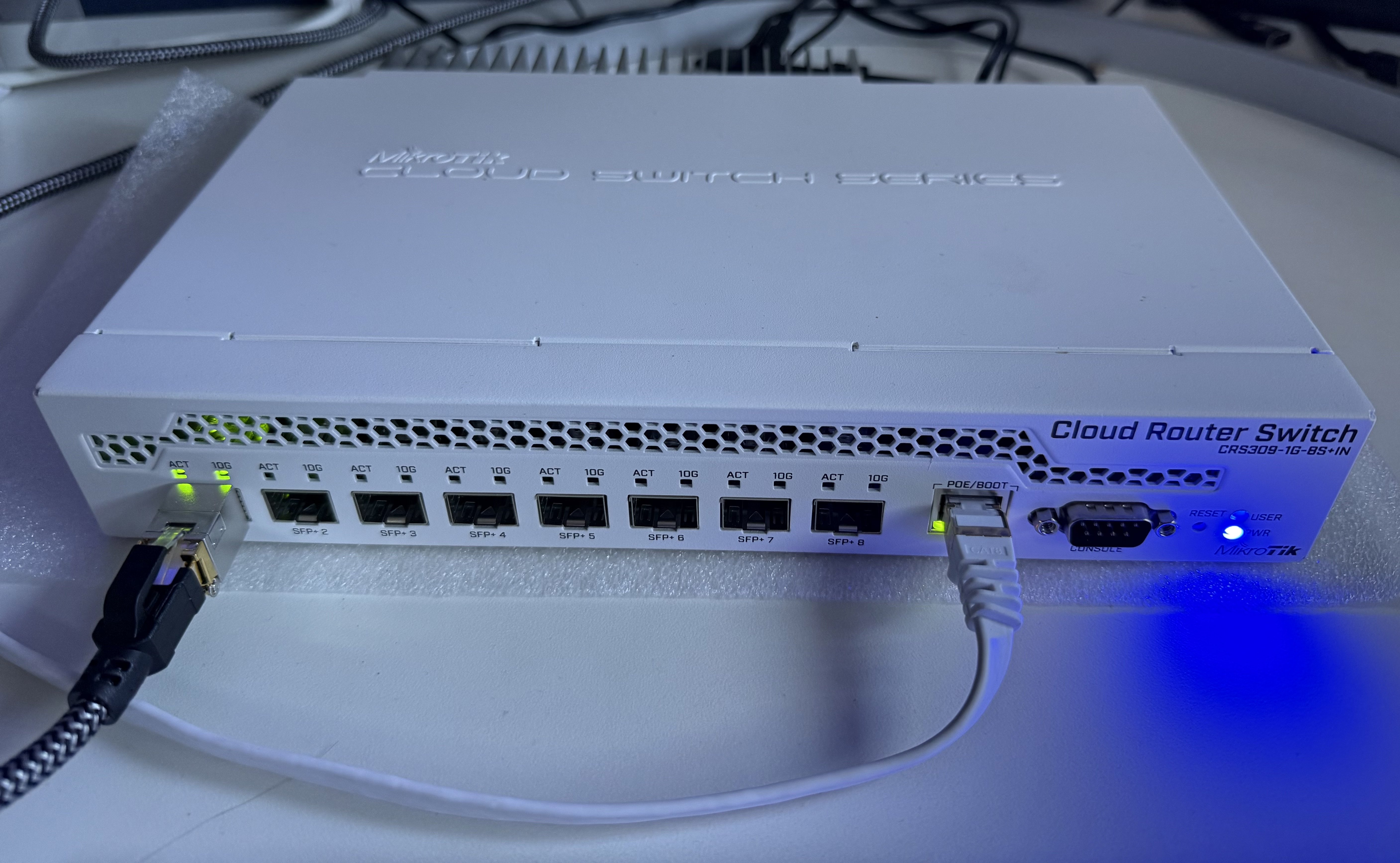

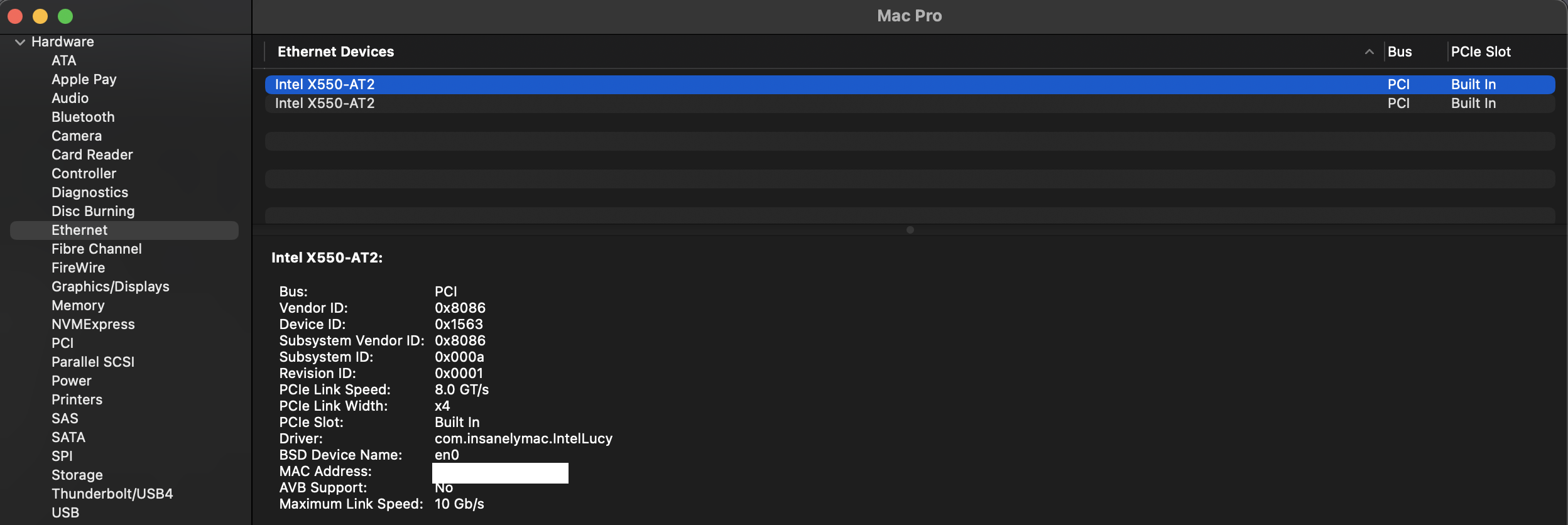

kgp Posted September 28, 2025 Share Posted September 28, 2025 (edited) @Mieze, @etorix – final success with X550-AT2 NICs of the ASUS X299 Sage 10G with MikroTik CRS309 and one of the two H!Fiber RJ45 SFP+ transceivers! 💫💥💯. IntelLucy works stable with either Auto-Negotiation (10GBase-T, Full Duplex, MTU 1500) or Hardware set to "manually" (10GBase-T, Full Duplex, MTU 1500 or Jumbo 9000). The second module appears faulty: it only connects at 1000Base-T, Full Duplex (MTU 1500 or Jumbo 9000) on every device tested (CRS309, Netgear ProSafe XS508M) with either IntelLucy, SmallTree, or even a MacBook Pro. At 10GBase-T, it always starts toggling after ~2 minutes, regardless of unplug/plug or switch reboot. I will return the faulty module to Amazon. Additional notes: Normal operating temperature of the H!Fiber module stays around 50 °C. Sleep/Wake tests are still pending and will follow. Tomorrow I’ll receive a MikroTik S+RJ10 module for final testing. However, already now: full success with CRS309 + IntelLucy + H!Fiber (good module) under both Sequoia and Tahoe 💫💥💯. Edited September 28, 2025 by KGP-iMacPro 3 Link to comment https://www.insanelymac.com/forum/topic/359009-intellucy-for-the-intel-x500-family/page/5/#findComment-2841396 Share on other sites More sharing options...
Mieze Posted September 28, 2025 Author Share Posted September 28, 2025 Attached you'll find the release build of IntelLucy version 1.1.340, which I'm using on all of my machines (X520-DA1 with DAC and 10Gbase-SR, X540 and X550) for a few days now without experiencing any problems. @KGP-iMacPro Congratulations! I have a question about the SFP+ module you are using. H!fiber offers three different 10Gbase-T modules: 30m range with Marvell AQR113C PHY for 36.99€ 30m range with Realtek RTL8261BE PHY for 33.99€ 80m range with Marvell CUX3610 PHY for 58.99€ Which one is yours? Mieze 😺 IntelLucy-1.1.340-release.zip 1 1 Link to comment https://www.insanelymac.com/forum/topic/359009-intellucy-for-the-intel-x500-family/page/5/#findComment-2841436 Share on other sites More sharing options...

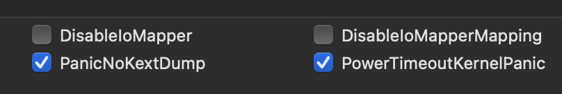

kgp Posted September 30, 2025 Share Posted September 30, 2025 (edited) @Mieze, despite the overall success with IntelLucy, there’s still a tiny drawback on my specific system, which I just realised now: IntelLucy only works with DisableIOMapper=true due to the missing IOMMU implementation of the X550-AT2 NICs on my ASUS X299 Sage 10G. With DisableIOMapper=false, the IP is "self-assigned" although the respective switch LEDs are green and blinking as usual . However, a new patch for native Apple BCM943602 Wi-Fi under Sequoia and Tahoe requires AppleVTD enabled. Do you see any possible workaround for this situation? If not, no worries – I guess I’ll just have to wait for the OCLP root patch for my BCM94360. 👍 Edited September 30, 2025 by KGP-iMacPro Link to comment https://www.insanelymac.com/forum/topic/359009-intellucy-for-the-intel-x500-family/page/5/#findComment-2841504 Share on other sites More sharing options...
Mieze Posted September 30, 2025 Author Share Posted September 30, 2025 @KGP-iMacPro With AppleVTD enabled any I/O access (the driver accessing the NIC's configuration registers and the NIC doing DMA operations from/to RAM) has to be mapped by the IOMMU. Without a proper mapping the access will be blocked and there is no clean way to get around this for a driver. Besides that, the author of the patch you mentioned explicitly states that his method is experimental and that there might be kernel panics on sleep/wake. I wouldn't even consider it for a productive system at the moment. Mieze 😺 1 Link to comment https://www.insanelymac.com/forum/topic/359009-intellucy-for-the-intel-x500-family/page/5/#findComment-2841517 Share on other sites More sharing options...
etorix Posted September 30, 2025 Share Posted September 30, 2025 7 hours ago, KGP-iMacPro said: missing IOMMU implementation of the X550-AT2 NICs on my ASUS X299 Sage 10G This is an issue which should be fixed by a BIOS update from Asus. Yes, I know, good luck with reaching Asus technical support… 2 Link to comment https://www.insanelymac.com/forum/topic/359009-intellucy-for-the-intel-x500-family/page/5/#findComment-2841541 Share on other sites More sharing options...
kgp Posted October 1, 2025 Share Posted October 1, 2025 (edited) Thanks a lot for the explanation, @Mieze. Just to clarify my former question: would it be possible to add a few lines of code to IntelLucy so that it simply ignores AppleVTD/IOMMU and still operates in non-IOMMU / direct DMA mode, even when DisableIOMapper=false, in line with the current situation on my particular system? @etorix, my last hope was Adrian N. - I don’t know if you know him - but he also refused to help with this issue, simply saying “my board is not supported by macOS.” 😉 Let’s see if ASUS will eventually release a BIOS update that fixes the IOMMU implementation issue. I hope I’ve brought it to their attention sufficiently. There’s nothing more I can do on this issue from my side. Edited October 1, 2025 by KGP-iMacPro Link to comment https://www.insanelymac.com/forum/topic/359009-intellucy-for-the-intel-x500-family/page/5/#findComment-2841570 Share on other sites More sharing options...
Mieze Posted October 1, 2025 Author Share Posted October 1, 2025 @KGP-iMacPro The IOMMU is a hardware security device to prevent IO-Devices from unauthorised memory access, which is mainly used in combination with virtualisation. It can not be bypassed or ignored once it is enabled, which means that if AppleVTD is enabled any DMA operation of a PCIe device to/from memory must be allowed by a valid mapping. If no mapping exists, the DMA access is blocked, which results in a non-working device. Therefore it is impossible to ignore or circumvent AppleVTD while it is enabled. Mieze 😺 1 Link to comment https://www.insanelymac.com/forum/topic/359009-intellucy-for-the-intel-x500-family/page/5/#findComment-2841574 Share on other sites More sharing options...

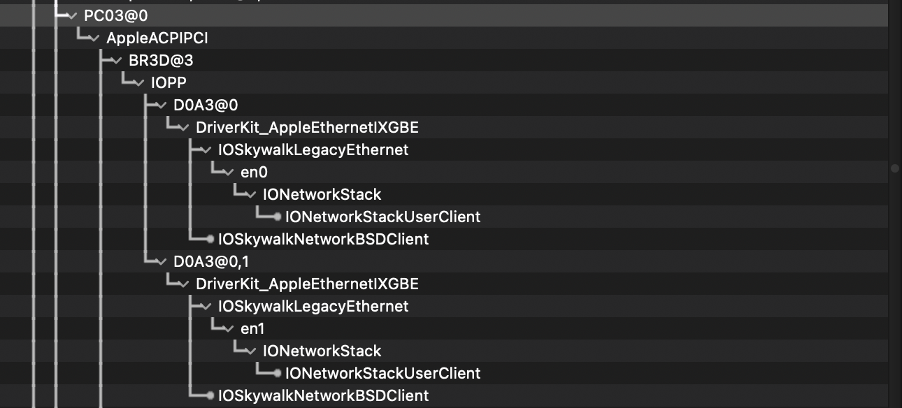

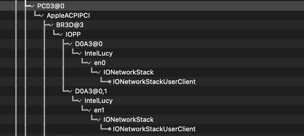

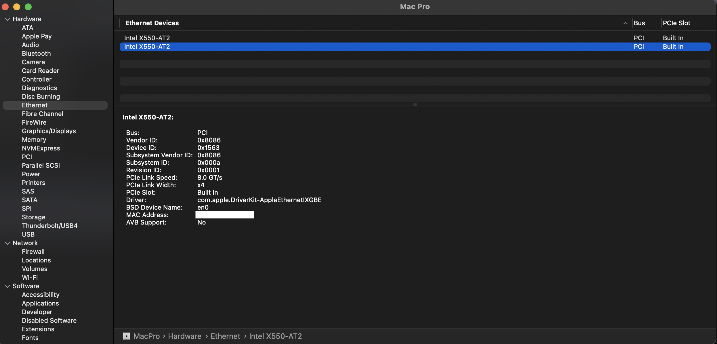

kgp Posted October 5, 2025 Share Posted October 5, 2025 (edited) @etorix, @Mieze, EFI-Folder of @apfelnico makes the magic happen 👍💥💯 Full Dext DriverKit implementation with my X550-AT2 NICs of the ASUS X299 Sage 10G ! 🙏 And evidently also IntelLucy works with DisableIOMapper= false 💯💥👍 Edited October 5, 2025 by KGP-iMacPro 1 Link to comment https://www.insanelymac.com/forum/topic/359009-intellucy-for-the-intel-x500-family/page/5/#findComment-2841746 Share on other sites More sharing options...
Mieze Posted October 5, 2025 Author Share Posted October 5, 2025 @KGP-iMacPro Congratulations! You might want to check the config.plist's Booter->Quirks and Kernel->Quirks sections for differences in memory mapping related settings to find out what solved the issue. Mieze 😺 1 Link to comment https://www.insanelymac.com/forum/topic/359009-intellucy-for-the-intel-x500-family/page/5/#findComment-2841755 Share on other sites More sharing options...
