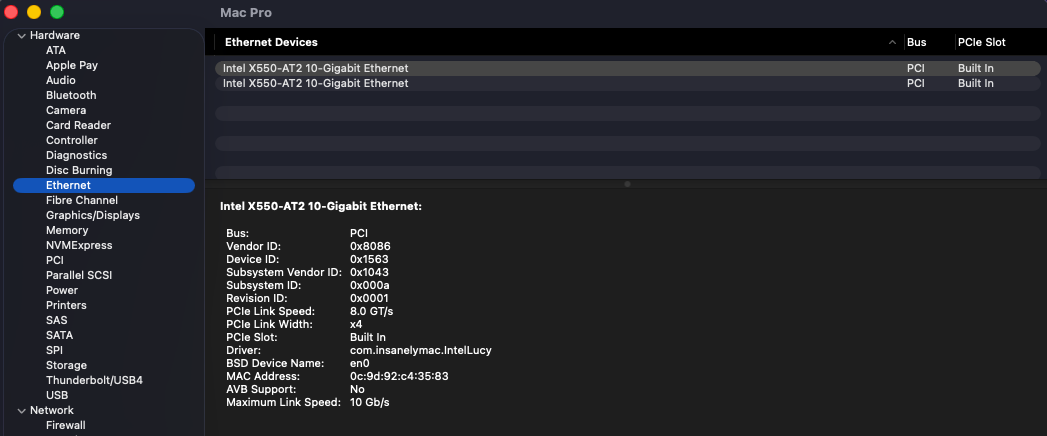

kgp Posted June 29, 2025 Share Posted June 29, 2025 (edited) In conclusion of all my tests and our discussion: IntelLucy.kext works with my onboard X550-AT2 NICs of the ASUS X299 SAGE 10G (BIOS Version 4701) under Tahoe Beta 2 only with the following procedure and kernel quirks DisableIoMapper <true>, DisableMapperMapping <false>: Enter BIOS -> Disable VT-D -> save -> reboot-> Enter BIOS -> Enable VT-D -> save -> Reboot -> Boot Tahoe -> Success 🤩 with: Ethernet 1 - IntelLucy, Ethernet - Intel AX210 Bluetooth/WIFI This VT-D BIOS RESET is a somewhat strange and a bit annoying approach but appears to work in principle… No DMAR modding, No DMAR dropping. With the 2 kernel quirk settings above, Intel AX210 Bluetooth/WIFI works as well. I can live with this solution for now. @Mieze and @etorix, many thanks for all your help and clarifications ! Edit: in addition I raised a ticket at ASUS: Thank you for handling my support request. First, here are my system specifications: Mainboard: ASUS X299 Sage 10G, BIOS version 4701 CPU: Intel Core i9-7980XE RAM: 128 GB Corsair Dominator Platinum DDR4 GPU: AMD Radeon VII Thunderbolt: GC-Titan Ridge Bluetooth/Wi-Fi: Broadcom BCM94360CD and Intel AX210 Monitor: LG 5K 34WK95U-W Operating Systems: macOS Sequoia 15.5 and macOS 26.0 Developer Preview 2 (“Tahoe”) Bootloader: OpenCore 1.0.5 Issue Description: There is a critical issue when initializing the X550-AT2 onboard controllers under macOS Sequoia 15.5 and macOS 26.0 Developer Preview 2. This may be caused by a conflict between ASUS BIOS version 4701, VT-d, and Apple’s VT-d implementation. The latest macOS versions ship with Apple’s native DriverKit-based driver: com.apple.DriverKit-AppleEthernetIXGBE.dext for Intel 10Gbit Ethernet controllers. Problem: This DriverKit extension crashes immediately upon loading and fails to initialize. The system logs show: Exception Type: EXC_CRASH (SIGABRT) Termination Reason: SIGNAL, Code 6 (Abort trap) Function: IOUserNetworkEthernet::init() → panic() caused by __assert_rtn As a result, the onboard X550 interfaces are not available in macOS, and no Ethernet connectivity is possible unless the DEXT driver loads successfully. Workaround Using IntelLucy.kext (Community Driver): As a workaround, the open-source IntelLucy.kext (a community fork of SmallTree/IntelIX) can partially initialize the X550 controller under macOS 15.5 and 26.0. While the driver does load during boot, network connectivity is unreliable: the interface sometimes connects for a few seconds and then drops back to "disconnected" status. A temporary workaround helps in some cases: In BIOS, disable VT-d, save and reboot Re-enter BIOS, enable VT-d again, save and reboot Only then boot macOS In addition, the following OpenCore kernel quirks are required: DisableIoMapper: true DisableMapperMapping: false However, even with these steps, the connection is not stable – Ethernet may disconnect after sleep/wake cycles or system reboots and the vt-d BIOS reset workaround works sometimes but not always. My Questions for ASUS: Are there any known compatibility issues or firmware problems with the X550-AT2 controller, especially regarding VT-d and Apple’s DriverKit implementation? Is ASUS planning a BIOS update or firmware patch to improve DriverKit and VT-d compatibility under modern operating systems like macOS 15.5 and 26.0? Would it be possible to provide an updated NIC firmware for the onboard X550 to resolve these issues? I would be happy to provide kernel logs, system crash reports, or sample data upon request and am available for any further testing or feedback you may need. Thank you very much in advance for your assistance. Suggestions what else to add to this ticket are highly appreciated. So far the initial request has been forwarded to the 2nd Level Team. Edited June 30, 2025 by KGP-iMacPro new ticket at ASUS 2 Link to comment https://www.insanelymac.com/forum/topic/359009-intellucy-for-the-intel-x500-family/page/3/#findComment-2835504 Share on other sites More sharing options...

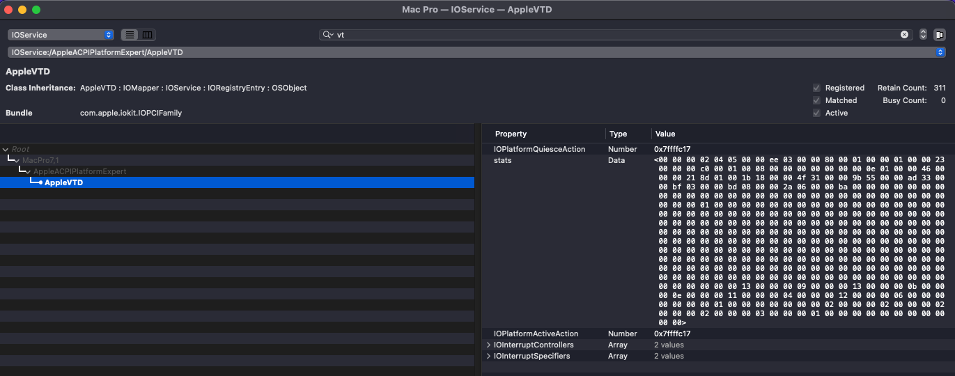

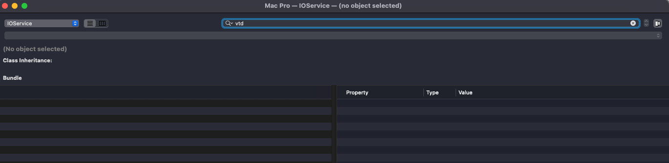

kgp Posted July 6, 2025 Share Posted July 6, 2025 On 7/4/2025 at 8:57 AM, etorix said: This looks correct, but without working VT-d there can be no native support by DriverKIt, and @Mieze said that IntelLucy.kext, which does not depend on AppleVTd, does not check for subsystem IDs. I don't know where the issue is… @etorix, @Mieze AppleVTD / IOMMU fully functional under macOS 26 (Tahoe) Running macOS 26.0 DP2 (Tahoe) on an ASUS X299 Sage 10G with Intel X550-AT2 NICs. VT-d is enabled in BIOS, and OpenCore 1.0.5 is configured with: DisableIoMapper = false DisableMapperMapping = false AppleVTD is loaded and active: kmutil showloaded | grep -i AppleVTD kgp@Mac-Pro ~ % kmutil showloaded | grep -i AppleVTD 175 0 0xffffff7f950fd000 0x2fe0 0x2fe0 com.apple.driver.AppleVTD (1.0) 1A2B3C4D-1234-5678-9ABC-DEF012345678 <...> Both NICs are correctly assigned to the VT-d domain: ioreg -lw0 -c AppleVTDDevice | grep -E 'XGBE|XGBF|IOMMUUnit|pciclass' IOService:/.../PC03@0/BR3D@30000/IOMMUUnit@0 ├── XGBE@0 (pci8086,1563) └── XGBF@1 (pci8086,1563) Conclusion: AppleVTD.kext is present and fully operational IOMMU/VT-d device assignment works as expected No misconfiguration or VT-d issues However: LAN/internet still fails due to: IntelLucy.kext not able to connect to LAN/Internet Crashing com.apple.DriverKit-AppleEthernetIXGBE.dext I guess this is rather a driver-layer problem, not a VT-d or platform issue. LAN/internet connection still fails due to higher-layer driver issues (IntelLucy.kext, Apple DEXT crashes), not because of missing VT-d or IOMMU. That's all from my side for now. btw.. I am not available the next 2 days (holidays without internet 🙂) 2 Link to comment https://www.insanelymac.com/forum/topic/359009-intellucy-for-the-intel-x500-family/page/3/#findComment-2836110 Share on other sites More sharing options...
etorix Posted July 6, 2025 Share Posted July 6, 2025 14 minutes ago, KGP-iMacPro said: IOService:/.../PC03@0/BR3D@30000/IOMMUUnit@0 "IOMMUUnit" is not valid ACPI name. If this is the issue, the solution should be a SSDT to give a proper name to the chlld at address 0 under PC03.BR3D. 2 Link to comment https://www.insanelymac.com/forum/topic/359009-intellucy-for-the-intel-x500-family/page/3/#findComment-2836113 Share on other sites More sharing options...

kgp Posted September 6, 2025 Share Posted September 6, 2025 (edited) Hi @Mieze, first of all, many thanks for ordering, installing, and testing the X550 card on your system. Very kind, really! 🙏 Just for the sake of coherence: I performed all tests under macOS with actual IntelLucy.kext v. 1.1.1 release from Github. I’ve prepared a complete set of requested information of my ASUS X299 Sage 10G system with the onboard X550-AT2 NICs. The information has been gathered under Ubuntu 16.04.7 LTS, which I have installed for EEPROM modding. All files are in the ZIP I’m sharing. Below is a breakdown of each file, its purpose, and the command I used to generate it. Main Mieze folder: dump_enp225s0f0.txt – Low-level driver dump of enp225s0f0 (sudo ethtool -d enp225s0f0). dump_enp225s0f1.txt – Low-level driver dump of enp225s0f1 (sudo ethtool -d enp225s0f1). eeprom_enp225s0f0.bin – Raw EEPROM dump of enp225s0f0 (sudo ethtool -e enp225s0f0 raw on). eeprom_enp225s0f0.txt – Human-readable EEPROM dump of enp225s0f0 (sudo ethtool -e enp225s0f0). eeprom_enp225s0f1.bin – Raw EEPROM dump of enp225s0f1. eeprom_enp225s0f1.txt – Human-readable EEPROM dump of enp225s0f1. ethtool_enp225s0f0.txt – General interface info of enp225s0f0 (sudo ethtool enp225s0f0). ethtool_enp225s0f1.txt – General interface info of enp225s0f1. lspci_vvv.txt – Full PCI information for all devices (sudo lspci -vvv). Addon folder (~/Mieze/addon): dmesg_enp225s0.txt – Kernel messages filtered for my X550-AT2 interfaces (dmesg | grep enp225s0). dmesg_ixgbe.txt – Kernel messages filtered for the ixgbe driver (dmesg | grep ixgbe). ethtool_i_enp225s0f0.txt – Driver info for enp225s0f0 (sudo ethtool -i enp225s0f0). ethtool_i_enp225s0f1.txt – Driver info for enp225s0f1. ethtool_version.txt – Installed version of ethtool (ethtool -V). lsb_release.txt – Linux distribution information (lsb_release -a). modinfo_ixgbe.txt – ixgbe driver module info (modinfo ixgbe). uname.txt – Kernel version and architecture (uname -a). I hope this gives you all the information you need to investigate the onboard NICs of my ASUS X299 Sage 10G. Please let me know if you need anything else! Best regards, kgp👍 Mieze.zip Edited September 7, 2025 by KGP-iMacPro Adding information concerning Intellucy version in use for testing under macOS 1 Link to comment https://www.insanelymac.com/forum/topic/359009-intellucy-for-the-intel-x500-family/page/3/#findComment-2840239 Share on other sites More sharing options...

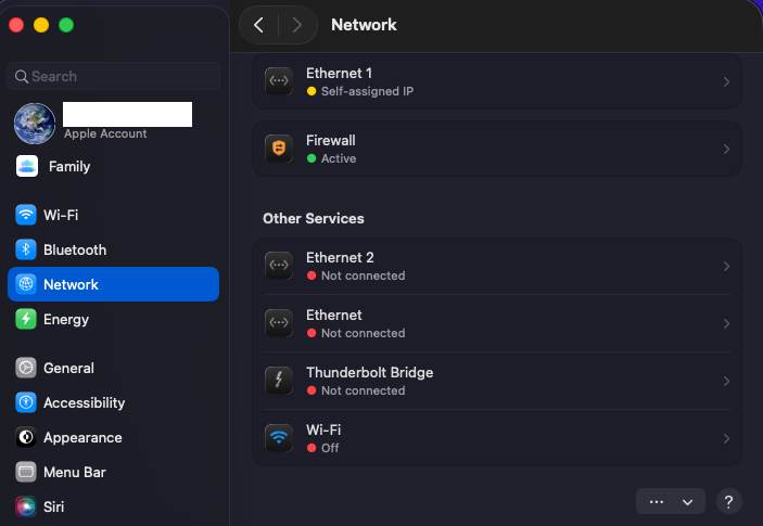

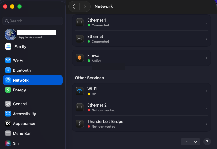

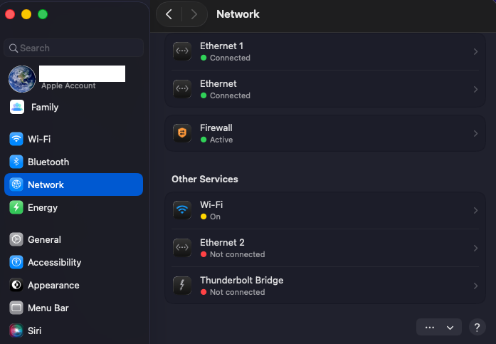

kgp Posted September 7, 2025 Share Posted September 7, 2025 (edited) Edit on 09.09.2025: Hi @Mieze, it seems you have reproduced only part of my problem. On my X550, the link toggle issue with IntelLucy doesn’t just occur after sleep/wake - it already appears right after boot and/or after deactivating/activating Ethernet 1 (en0). IntelLucy establishes via DHCP a valid link for a second with valid TCP/IP and DNS values via DHCP (Ethernet 1 - green) but looses the link immediately afterwards for 5 to 10 seconds (Ethernet 1 - red) until the same procedure starts right from the beginning. Under Sequoia, this cycle only reproducibly stops if I set TCP/IP and DNS to manual (after deactivating Ethernet 1). In addition, changing the hardware settings (speed/duplex etc.) during the toggling of the Ethernet-1 interface using IntelLucy might help in establishing a successful link. However, most of the time, these settings reset themselves automatically by IntelLucy. Interestingly, after a final successful connection with IntelLucy, Ethernet-1 sometimes may remain green, but the PC loses internet connectivity after ~30 seconds. In such cases, also SmallTree.kext won't work subsequently with DHCP or manual TCP/IP settings unless I reboot the switch and/or router. Under Tahoe, the link toggle is infinite, independently of DHCP on/of and any change of "Hardware" Settings. Could you please check how your X550 behaves when toggling the interface manually via "Make inactive" / "Make active" in the System Settings? I expect it might work correctly for you, since your card connects immediately after boot. With IntelLucy, my X550 onboard NICs seem to have a rather general PHY initialization/state problem than a Sleep/Wake issue. However, by finding the culprit for the link toggle of your X550-AT2 after sleep/wake with IntelLucy under Sequoia, you might be able to expand the necessary changes globally in your code, which in consequence might also help my X550 NICs in successfully establishing a link via DHCP directly after boot or after deactivating/activating Ethernet 1 (en0) subsequently. BTW.. are we both using the same version of IntelLucy (v.1.1.1) for our tests? Best regards, KGP Edited September 9, 2025 by KGP-iMacPro Rewriting the correspondence to be more explicit. Please reread! Link to comment https://www.insanelymac.com/forum/topic/359009-intellucy-for-the-intel-x500-family/page/3/#findComment-2840299 Share on other sites More sharing options...
Mieze Posted September 7, 2025 Author Share Posted September 7, 2025 @KGP-iMacPro Have you checked the UEFI settings I asked you to verify? The problem might be related to the driver / firmware coexistence mechanism. I remember a similar problem with IntelMausiEthernet on LM-versions (with management firmware) of the I219-chips years ago. The problem was that the driver took control of the NIC late in the initialisation process and released it during sleep with the result that certain configurations din't work at all or failed to resume work after wakeup, which reminds me of our problem. The solution was to take control early in the initialisation process and keep it while sleeping. 1 Link to comment https://www.insanelymac.com/forum/topic/359009-intellucy-for-the-intel-x500-family/page/3/#findComment-2840300 Share on other sites More sharing options...
kgp Posted September 7, 2025 Share Posted September 7, 2025 (edited) @Mieze, I’ve double-checked all BIOS/UEFI settings relevant to the onboard Intel NICs on my ASUS X299 Sage 10G (BIOS 4701): Intel LAN Controller: Enabled (both onboard ports active and cannot be switched on/off separately) Intel LAN PXE Option ROM: Disabled (no preboot network) Network Stack: Disabled Wake-on-LAN: Not separately configurable Link speed, duplex, and similar NIC settings: Not configurable in BIOS/UEFI (driver auto-negotiation only); Only NIC Configuration: Blink Leds 0 Additionally, I was never able to update to the latest Intel ME firmware, since I don’t have a Windows environment available for the update. I don't know if this matters somehow. Anyway, all NIC functions - including DHCP, manual TCP/IP configuration, hardware link settings, link lease, and Internet connectivity - work with the SmallTree.kext despite the annoying KPs under Tahoe. Thus, the BIOS settings should not be any issue. Update - listing of BIOS settings attached below: 04092025_BIOS_settings.txt Edited September 7, 2025 by KGP-iMacPro Adding listing of BIOS settings Link to comment https://www.insanelymac.com/forum/topic/359009-intellucy-for-the-intel-x500-family/page/3/#findComment-2840302 Share on other sites More sharing options...
Mieze Posted September 9, 2025 Author Share Posted September 9, 2025 @KGP-iMacPro First of all, to avoid any further discussions about boot and wakeup, the driver has to go through the same initialisation code on boot and while waking up. If the problem shows up in one of these situations, the other one is almost certainly affected too. I've spent the las two days investigation the issue. It looks like there is a race condition in the initialisation code. In certain unknown situations the PHY gets in a state, in which the established link is always unstable, so that the link is lost within a few seconds and the up/down cycle keeps repeating until the PHY is power-cycled. I haven't been able to identity the exact reason but the fact that it occurs only sometimes is a strong indicator for a race condition. Anyway, I managed to find a work-around to recover from that situation. When the link is lost within the first 4 seconds after the link up event, the PHY is powered down for 5 seconds before it gets powered on again. This seems to break the cycle and reestablishes normal operation. I'm currently testing the patch and will publish it as ASAP, provided that a few days of real world testing will confirm that it's working as expected. Mieze 😺 3 Link to comment https://www.insanelymac.com/forum/topic/359009-intellucy-for-the-intel-x500-family/page/3/#findComment-2840411 Share on other sites More sharing options...

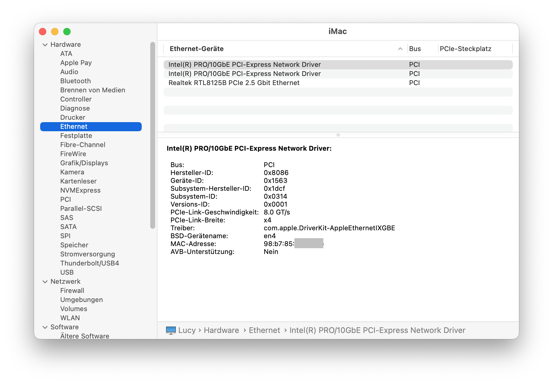

Mieze Posted September 10, 2025 Author Share Posted September 10, 2025 @KGP-iMacPro The card also works with the native Apple DEXT com.apple.DriverKit-AppleEthernetIXGBE under 15.6.1, but I haven't tried Tahoe at all. 2 Link to comment https://www.insanelymac.com/forum/topic/359009-intellucy-for-the-intel-x500-family/page/3/#findComment-2840475 Share on other sites More sharing options...
Mieze Posted September 11, 2025 Author Share Posted September 11, 2025 Here is a first test version (built 1.1.308), which solved the problem for me. In case the PHY is unable to negotiate a stable link, it power-cycles the PHY to recover from that situation, which takes about 7 seconds. Good luck testing! Mieze 😺 IntelLucy-1.1.308.zip 2 1 Link to comment https://www.insanelymac.com/forum/topic/359009-intellucy-for-the-intel-x500-family/page/3/#findComment-2840513 Share on other sites More sharing options...

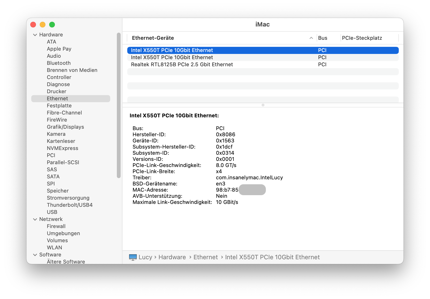

kgp Posted September 11, 2025 Share Posted September 11, 2025 (edited) Intel X550-AT2 + Apple DEXT + IOMMU/VT-d on ASUS X299 Sage 10G – Status Update Mieze successfully got her X550-AT2 NIC running with com.apple.DriverKit-AppleEthernetIXGBE. On my system, I patched the EEPROM of my X550-AT2 to match her card IDs and ran tests with macOS 15.6.1 & 26 RC. SSDT was extended with properties such as device-managed, iommu-selection, and IOServiceDEXTEntitlements. Results: AppleVTD.kext loads, IOMMU/VT-d is generally active. Other devices bind correctly. X550-AT2 NICs refuse IOMMU assignment → DEXT does not load stably, even though ID properties appear correct in IORegistry. Previously, in a one timer event, the NICs seemed correctly integrated into the VT-d tree, but this is currently not reproducible – behaviour likely depends on root port topology, BIOS, or timing. IntelLucy.kext remains the only “nearly” stable solution for my onboard X550-AT2 NICs. PHY / IntelLucy Patch: Mieze’s PHY-toggle patch (1.1.308) automates the PHY power-cycle to stabilise the link after wake. On my setup (DisableIOMapper = true / VT-d not functional), the patch does not reliably break the toggle cycle. After boot, the NIC is generally without any connection using DHCP or it still toggles between green (connection) and red (no connection)). A possible connection can be established using the following procedure: Make inactive Details → Configure IPv4 “Manually” → Configure IPv6 “Manually” Hardware “Manually” → Speed 10GBase-T, Full-Duplex, Jumbo (9,000) Make active → starts a toggle every ~7 seconds until the NIC eventually establishes a stable link This manual procedure essentially simulates the PHY power-cycle that the patch is intended to automate anyway. On my system, the patch might not be able to reliably trigger this cycle due to VT-d/IOMMU limitations (DisableIOMapper=true due to the unsatisfactory results with respect to IOMMU). SmallTree.kext: Under macOS 15.x / Sequoia → all functions stable, no issues. Under macOS 26 / Tahoe → PHY + link remain stable, but Kernel Panics occur, likely due to Kext incompatibility with the Tahoe kernel. Conclusion: SSDT/property patching alone is insufficient to achieve IOMMU assignment of the NICs and allow the DEXT to load reliably (attached my SSDT attempts for IOMMU/DEXT functionality). IntelLucy.kext remains the only “nearly” stable solution for my onboard X550-AT2 NICs under Tahoe. PHY-toggle patch should stabilize IntelLucy initialization in principle, but VT-d/IOMMU limitations on my system might prevent it from being fully effective, and the NIC may require manual intervention after boot to establish a stable link. SmallTree provides best link stability, but produces a KP problem under Tahoe. IntelLucy or DEXT are better alternatives, but on my setup they still encounter PHY / VT-d / IOMMU initialisation and toggling issues. Sorry for not providing more positive news regarding my system.. 🤒 congrats and many thanks to @Mieze and @etorix anyway!! Any further help would be highly welcome and more than appreciated... SSDT-X299-ETH.aml Edited September 12, 2025 by KGP-iMacPro Link to comment https://www.insanelymac.com/forum/topic/359009-intellucy-for-the-intel-x500-family/page/3/#findComment-2840516 Share on other sites More sharing options...
