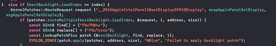

jalavoui Posted November 9, 2024 Share Posted November 9, 2024 (edited) gonna leave the bins untouched on other thread till we find something better i'm loking at nvram and cameliia (china) registers added saved-config var to nblue sources + savednvram patch for kernel call masta can you test it? what happens if you disable the applebacklight ?. the displays gets full brightness? Edited November 9, 2024 by jalavoui Link to comment https://www.insanelymac.com/forum/topic/358305-iris-xe-igpu-on-tiger-lake-successfully-loaded-icllp-frambuffer-and-vram-also-recognizes-1536mb-however-some-issues/page/29/#findComment-2827609 Share on other sites More sharing options...
Mastachief Posted November 9, 2024 Share Posted November 9, 2024 This boot is using the updated nblue source, just disabled net and compiled, didnt edit connectors as it gives a hang.Boots the same as before at half brightness.The pnlf is disabled, you can check my config.plist in the github, however, it's still half brightness. hackintool boot.logHackintool system.log Link to comment https://www.insanelymac.com/forum/topic/358305-iris-xe-igpu-on-tiger-lake-successfully-loaded-icllp-frambuffer-and-vram-also-recognizes-1536mb-however-some-issues/page/29/#findComment-2827615 Share on other sites More sharing options...

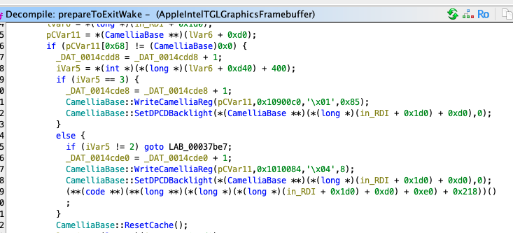

jkbuha Posted November 9, 2024 Share Posted November 9, 2024 (edited) 5 hours ago, jalavoui said: Xe IGPU (0x46a6) is kinda same family as asus laptop (check his thread) from is logs i think is doable - load adl in tgl framebuffer. the connector patch you mentioned is so easy todo using nblue (conn zero). but i think other issues will pop up don't think at 0x9a49 as a limitation. it is the way i foud out to link tgl settings with tgl fram kext graphics kext. waht really makes the driver works are the patches idk what you guys need todo it but we here to help Thanks, and it's much appreciated. Apologies in advance if anything I say or do is noob-level, as I'm out of my comfort zone here. I have finally successfully managed to build the first working kext for NootedBlue that loads, at least I think it does, but framebuffer still shows 8MB (so I guess framebuffer not correct). But it doesn't KP anymore with Unsupported ICL Sku, so something is done right atm. Things I've only changed so far: static uint8_t builtin[] = {0x00}; static uint8_t builtin2[] = {0x00, 0x00, 0x05, 0xFF}; // this ICL framebuffer worked for me with WG, am assuming I should test with this? static uint8_t builtin3[] = {0xA6, 0x46, 0x00, 0x00}; // my native device-id, should I still keep this enabled? Other points worth of note: AAPL,ig-platform-id set to 000005FF. Connectors in DeviceProperties set just as my github (9520) Julian's XPS 9520 Macbook Air - NootedKextLoaded.ioreg.zip Edited November 9, 2024 by jkbuha Link to comment https://www.insanelymac.com/forum/topic/358305-iris-xe-igpu-on-tiger-lake-successfully-loaded-icllp-frambuffer-and-vram-also-recognizes-1536mb-however-some-issues/page/29/#findComment-2827620 Share on other sites More sharing options...

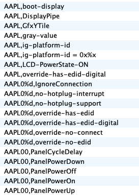

jalavoui Posted November 9, 2024 Share Posted November 9, 2024 (edited) indeed masta let me check for the properties in tgl driver. i remenber saw then so nblue as 3 connectors that you can overwrite using opencore. most important is con zero - make the lcd display work i don't remenber this flags but wg as docs about them so AAPL00,override will alow edid injection - not sure which1 hope you can find something about this all this flags are read by the tgl driver. this is nice cause we can inject panel power cycle delay from linux values and maybe help on backlight support using camellia and banksia code messing with this port really brings lots of hangs/broken display. i've tested some changes and it only gets worst Edited November 10, 2024 by jalavoui Link to comment https://www.insanelymac.com/forum/topic/358305-iris-xe-igpu-on-tiger-lake-successfully-loaded-icllp-frambuffer-and-vram-also-recognizes-1536mb-however-some-issues/page/29/#findComment-2827640 Share on other sites More sharing options...

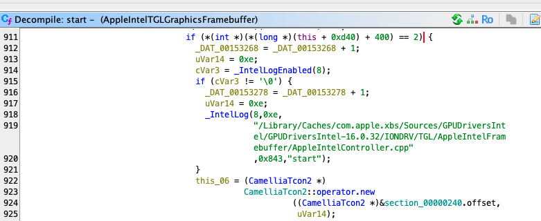

jalavoui Posted November 9, 2024 Share Posted November 9, 2024 (edited) so this code as linux ref and is here ty linux for clarifying added some of the linux workarounds to nblue srcs - will be needed for aceleration Edited November 10, 2024 by jalavoui Link to comment https://www.insanelymac.com/forum/topic/358305-iris-xe-igpu-on-tiger-lake-successfully-loaded-icllp-frambuffer-and-vram-also-recognizes-1536mb-however-some-issues/page/29/#findComment-2827641 Share on other sites More sharing options...

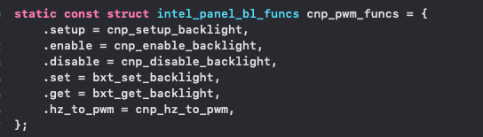

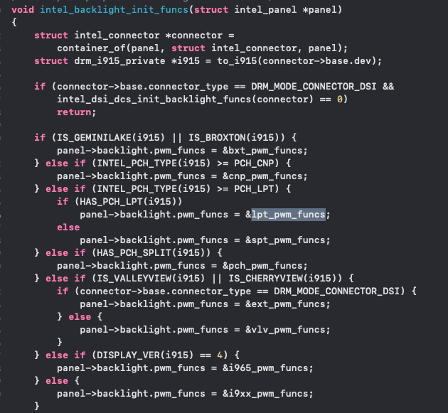

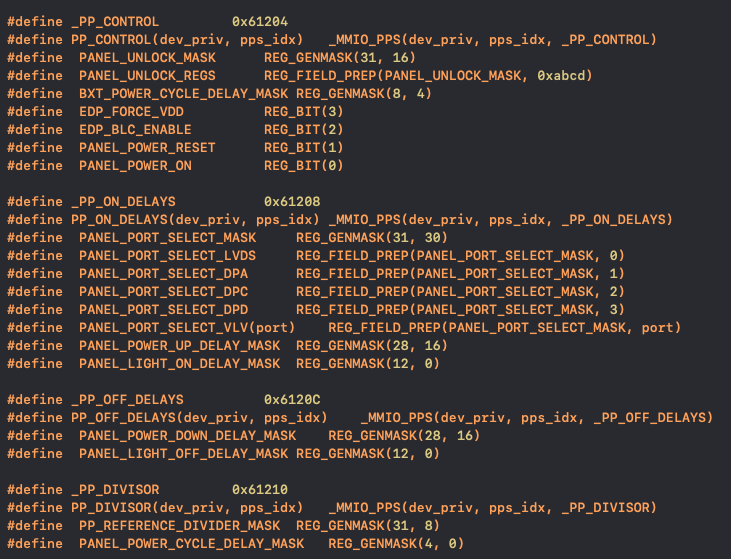

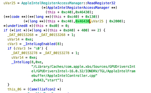

jalavoui Posted November 10, 2024 Share Posted November 10, 2024 (edited) from here? /* WaEnableChickenDCPR:skl,bxt,kbl,glk,cfl */ intel_uncore_rmw(&i915->uncore, GEN8_CHICKEN_DCPR_1, 0, MASK_WAKEMEM); this register "fix" also used in... void AppleIntelPowerWell::enableDisplayEngine(void) but they say code from 1969 Edited November 10, 2024 by jalavoui Link to comment https://www.insanelymac.com/forum/topic/358305-iris-xe-igpu-on-tiger-lake-successfully-loaded-icllp-frambuffer-and-vram-also-recognizes-1536mb-however-some-issues/page/29/#findComment-2827682 Share on other sites More sharing options...
jalavoui Posted November 11, 2024 Share Posted November 11, 2024 (edited) i almost forgot that we are now in tgk so the question which backlight do we have ?? Edited November 11, 2024 by jalavoui Link to comment https://www.insanelymac.com/forum/topic/358305-iris-xe-igpu-on-tiger-lake-successfully-loaded-icllp-frambuffer-and-vram-also-recognizes-1536mb-however-some-issues/page/29/#findComment-2827757 Share on other sites More sharing options...

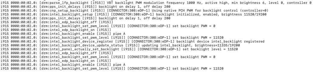

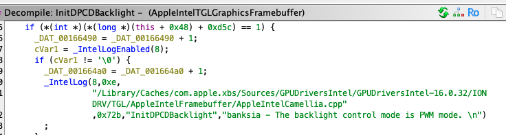

Mastachief Posted November 11, 2024 Share Posted November 11, 2024 (edited) Well, something is setting the brightness to mid brightness on boot when using either Production/Debug. Look in my github, it had the registers i wrote to in my tests. ubuntu@ubuntu:/etc/X11/xorg.conf.d$ sudo intel_reg read 0xc8254 (0x000c8254): 0x00017700 (freq 1, cycle 30464) ubuntu@ubuntu:/etc/X11/xorg.conf.d$ sudo intel_reg read 0xc8254 (0x000c8254): 0x00017700 (freq 1, cycle 30464) ubuntu@ubuntu:/etc/X11/xorg.conf.d$ sudo intel_reg write 0xc8254 0x00027700 ubuntu@ubuntu:/etc/X11/xorg.conf.d$ sudo intel_reg write 0xc8254 0x00047700 ubuntu@ubuntu:/etc/X11/xorg.conf.d$ sudo intel_reg write 0xc8254 0x00017700 ubuntu@ubuntu:/etc/X11/xorg.conf.d$ sudo intel_reg write 0xc8254 0x00027700 ubuntu@ubuntu:/etc/X11/xorg.conf.d$ sudo intel_reg write 0xc8254 0x00017700 ubuntu@ubuntu:/etc/X11/xorg.conf.d$ sudo intel_reg write 0xc8254 0x00017700 ubuntu@ubuntu:/etc/X11/xorg.conf.d$ sudo intel_reg write 0xc8254 0x00027700 ubuntu@ubuntu:/etc/X11/xorg.conf.d$ sudo intel_reg write 0xc8254 0x00037700 ubuntu@ubuntu:/etc/X11/xorg.conf.d$ sudo intel_reg write 0xc8254 0x00017700 ubuntu@ubuntu:/etc/X11/xorg.conf.d$ sudo intel_reg write 0xc8254 0x00027700 ubuntu@ubuntu:/etc/X11/xorg.conf.d$ sudo intel_reg write 0xc8254 0x00012700 ubuntu@ubuntu:/etc/X11/xorg.conf.d$ sudo intel_reg write 0xc8254 0x00017700 ubuntu@ubuntu:/etc/X11/xorg.conf.d$ sudo intel_reg read 0xc8255 0x00012700 (0x000c8255): 0xfd000177 (0x00012700): 0x00000000 ubuntu@ubuntu:/etc/X11/xorg.conf.d$ sudo intel_reg read 0xc8253 0x00012700 (0x000c8253): 0x0000fd80 (0x00012700): 0x00000000 ubuntu@ubuntu:/etc/X11/xorg.conf.d$ sudo intel_reg read 0xc8256 0x00012700 (0x000c8256): 0x00fd0001 (0x00012700): 0x00000000 ubuntu@ubuntu:/etc/X11/xorg.conf.d$ sudo intel_reg read 0xc8257 0x00012700 (0x000c8257): 0x0000fd00 (0x00012700): 0x00000000 ubuntu@ubuntu:/etc/X11/xorg.conf.d$ sudo intel_reg read 0xc8258 0x00012700 (0x000c8258): 0x0000b6d3 (0x00012700): 0x00000000 ubuntu@ubuntu:/etc/X11/xorg.conf.d$ sudo intel_reg read 0xc8253 0x00012700 (0x000c8253): 0x0000fd80 (0x00012700): 0x00000000 ubuntu@ubuntu:/etc/X11/xorg.conf.d$ sudo intel_reg read 0xc8254 (0x000c8254): 0x00017700 (freq 1, cycle 30464) ubuntu@ubuntu:/etc/X11/xorg.conf.d$ sudo intel_reg read 0xc8255 (0x000c8255): 0xfd000177 ubuntu@ubuntu:/etc/X11/xorg.conf.d$ sudo intel_reg read 0xc8255 (0x000c8255): 0xfd000177 TIme to whip out the old Ubuntu USB, got to edit my grub to grab debug, which Glavor GNU/Linux and Kernel are you using to pull your info Jala? Wanna be as close as possible in producing results. or did you just use the lastest driver with the current Kernel? like this one ---> https://www.intel.com/content/www/us/en/docs/vtune-profiler/user-guide/2024-2/rebuild-and-install-i915-module-ubuntu.html Edited November 12, 2024 by Mastachief Link to comment https://www.insanelymac.com/forum/topic/358305-iris-xe-igpu-on-tiger-lake-successfully-loaded-icllp-frambuffer-and-vram-also-recognizes-1536mb-however-some-issues/page/29/#findComment-2827795 Share on other sites More sharing options...
jalavoui Posted November 11, 2024 Share Posted November 11, 2024 (edited) masta any linux is fine. just make sure you update the linux kernel maye the inital tgl code works partial for your display one of this calls ? you can try hack this condition for testing. there's a banksia conditon also available at AppleIntelBaseController::start(AppleIntelBaseController *this,IOService *param_1) you can also try to inject the value maybe at new workarounds call function from nblue this is disabled by default in nblue. i enabled and got the backlight slider working. the range needs a fix Edited November 12, 2024 by jalavoui Link to comment https://www.insanelymac.com/forum/topic/358305-iris-xe-igpu-on-tiger-lake-successfully-loaded-icllp-frambuffer-and-vram-also-recognizes-1536mb-however-some-issues/page/29/#findComment-2827799 Share on other sites More sharing options...

jalavoui Posted November 13, 2024 Share Posted November 13, 2024 (edited) changed the sources to allow using the internal panel code. it is disabled by default on tgl debug section. masta that bin is old can you test nblue internal panel code? enable and disable patch f10 in Edited November 14, 2024 by jalavoui Link to comment https://www.insanelymac.com/forum/topic/358305-iris-xe-igpu-on-tiger-lake-successfully-loaded-icllp-frambuffer-and-vram-also-recognizes-1536mb-however-some-issues/page/29/#findComment-2827842 Share on other sites More sharing options...

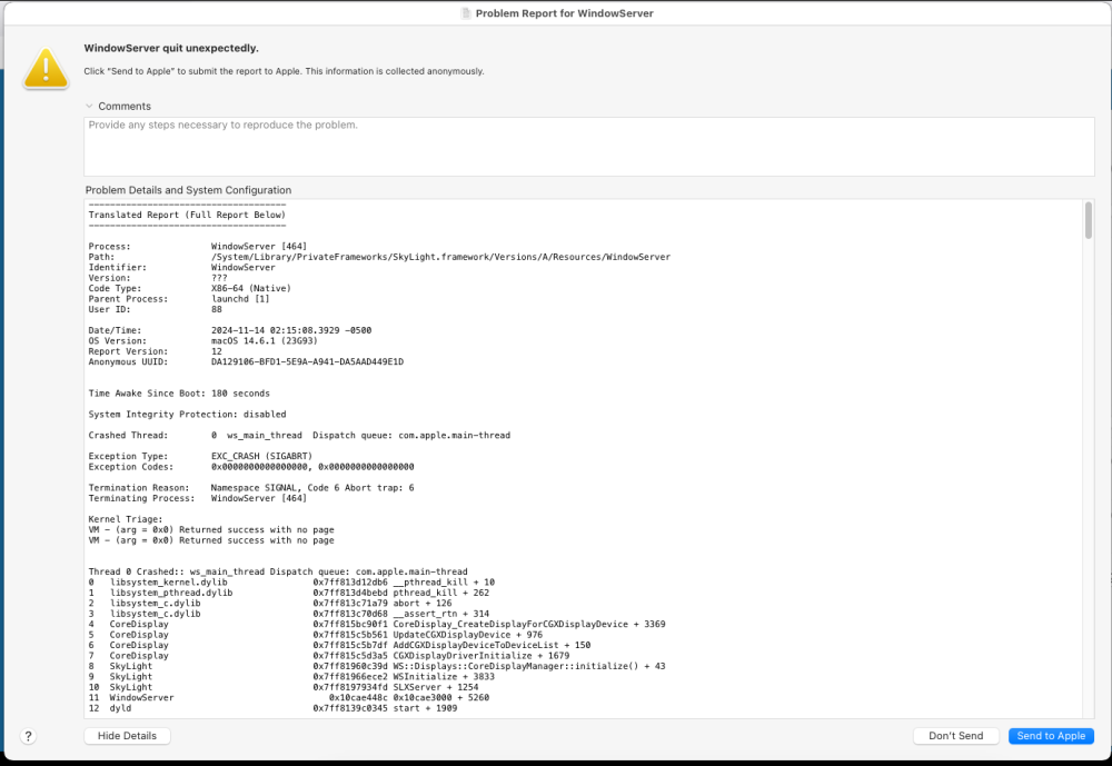

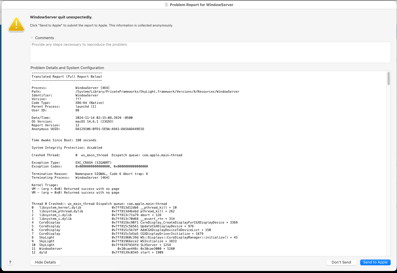

Mastachief Posted November 14, 2024 Share Posted November 14, 2024 (edited) Tglframe debug in LE, f10 patch disabled (for debug), panel code enabled. could be coredisplay, and skylight framework, seems panle doesnt get initialised, but i can remote in NootedBlue.kext.zip If I move the PCI id's from gen7tgl to the gen7tglle section in nblue, it boots to a black screen, backlight is on, but it's low backlight brightness and screen is black, upon reboot to the older nblue using iclframe get a window server error log, see below. i attached the window server crash as well that i get after rebooting to older nblue. x2.log.zip window server report.rtf So i am able to access the screen via ARD even though i get black screen on the internal display hackintool log while screen black.rtf Edited November 14, 2024 by Mastachief 1 Link to comment https://www.insanelymac.com/forum/topic/358305-iris-xe-igpu-on-tiger-lake-successfully-loaded-icllp-frambuffer-and-vram-also-recognizes-1536mb-however-some-issues/page/29/#findComment-2827864 Share on other sites More sharing options...
jalavoui Posted November 14, 2024 Share Posted November 14, 2024 (edited) if you move the PCI id's from gen7tgl to the gen7tglle you are loading AppleIntelTGLGraphics.kext from /L/E instead of /S/L/E it will fail (hang) if the kext is not installed or can't load. for this test better not put pci ids for AppleIntelTGLGraphics.kext your logs are from production version. can you install AppleIntelTGLGraphicsFramebuffer.kext from sle_Internal/le folder (debug version) with panel code i also see low backlight brightness and screen is black but logs show panel power off or not connected this might be interesting cause if we can use that code then backlight and sleep will work currently the panel seem to use external display code. maybe it needs nred agdc igpu patch Edited November 14, 2024 by jalavoui Link to comment https://www.insanelymac.com/forum/topic/358305-iris-xe-igpu-on-tiger-lake-successfully-loaded-icllp-frambuffer-and-vram-also-recognizes-1536mb-however-some-issues/page/29/#findComment-2827874 Share on other sites More sharing options...

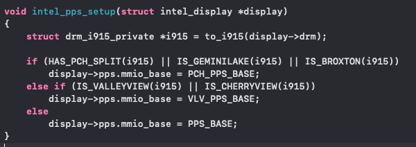

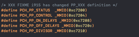

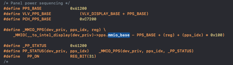

jalavoui Posted November 14, 2024 Share Posted November 14, 2024 (edited) what about with no patches? used in tgl 0xC7200 ?? also used in tgl should be Edited November 14, 2024 by jalavoui Link to comment https://www.insanelymac.com/forum/topic/358305-iris-xe-igpu-on-tiger-lake-successfully-loaded-icllp-frambuffer-and-vram-also-recognizes-1536mb-however-some-issues/page/29/#findComment-2827886 Share on other sites More sharing options...
Mastachief Posted November 14, 2024 Share Posted November 14, 2024 After just disabling net so it can compile, I compile without any edits and place in my internal ssd,Still get a igpu hangNo edits at all done to the info.plist just debug tglframe and hookcase in LE, repaired permissions just in case. No logs Link to comment https://www.insanelymac.com/forum/topic/358305-iris-xe-igpu-on-tiger-lake-successfully-loaded-icllp-frambuffer-and-vram-also-recognizes-1536mb-however-some-issues/page/29/#findComment-2827888 Share on other sites More sharing options...
jalavoui Posted November 14, 2024 Share Posted November 14, 2024 (edited) i just tested new power addresses. not enough guess better just don't use lcd internal pannel functions gonna add to nblue as disabled patch. right forgot to disable netdebg and remov tglgraph ids. that is way u got that hang masta updating sources... should be fine now Edited November 14, 2024 by jalavoui Link to comment https://www.insanelymac.com/forum/topic/358305-iris-xe-igpu-on-tiger-lake-successfully-loaded-icllp-frambuffer-and-vram-also-recognizes-1536mb-however-some-issues/page/29/#findComment-2827892 Share on other sites More sharing options...
