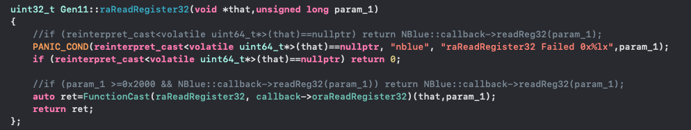

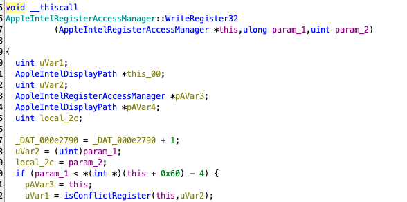

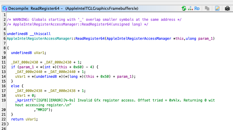

jalavoui Posted November 2, 2024 Share Posted November 2, 2024 (edited) dam production also as this bug that i patched in debug it's a small bug but gonna patch it anyway looking at depthFromAttribute() - trying to guess why the first null come from here Edited November 2, 2024 by jalavoui Link to comment https://www.insanelymac.com/forum/topic/358305-iris-xe-igpu-on-tiger-lake-successfully-loaded-icllp-frambuffer-and-vram-also-recognizes-1536mb-however-some-issues/page/26/#findComment-2827229 Share on other sites More sharing options...
Visual Ehrmanntraut Posted November 2, 2024 Share Posted November 2, 2024 Just now, jalavoui said: dam production also as this bug that i patched in debug What's the bug? Oh, regOff < rmmioSize - 4 instead of 8. Link to comment https://www.insanelymac.com/forum/topic/358305-iris-xe-igpu-on-tiger-lake-successfully-loaded-icllp-frambuffer-and-vram-also-recognizes-1536mb-however-some-issues/page/26/#findComment-2827230 Share on other sites More sharing options...

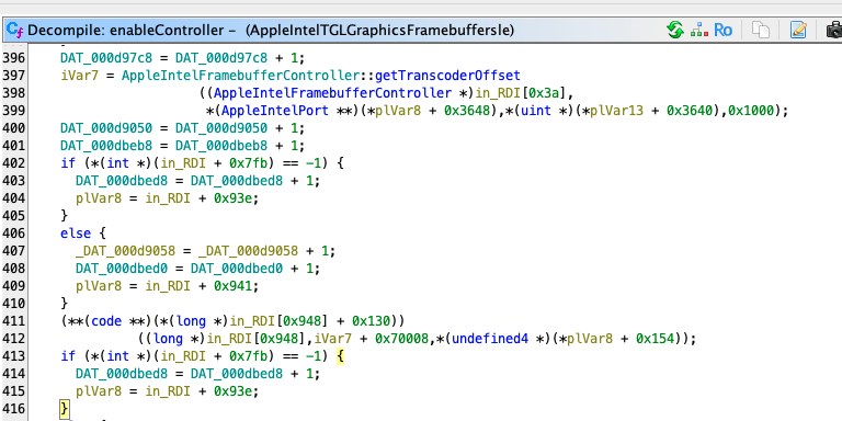

jalavoui Posted November 2, 2024 Share Posted November 2, 2024 (edited) yeah that was easy to fix. this part of code is where all bad things start to happen and make me patch the plane/scaler calls gonna waste some time with this the china code (**(code **)(*(long *)in_RDI[0x948] + 0x130)) looks like a writereg() to me gonna control values from this fastwritereg also Edited November 2, 2024 by jalavoui Link to comment https://www.insanelymac.com/forum/topic/358305-iris-xe-igpu-on-tiger-lake-successfully-loaded-icllp-frambuffer-and-vram-also-recognizes-1536mb-however-some-issues/page/26/#findComment-2827231 Share on other sites More sharing options...
Visual Ehrmanntraut Posted November 2, 2024 Share Posted November 2, 2024 My database says 0003b198 let field_4a08_1: *mut AppleIntelDisplayPath = ADJ(rax_29)->field_4a08; 0003b19b data_d97c8 += 1; 0003b1ad let rax_30: i32 = AppleIntelFramebufferController::getTranscoderOffset(fController_7, rsi_34, field_4a08_1->fPipe, 0x1000); 0003b1b2 let fRegAccessManager_1: *mut AppleIntelRegisterAccessManager = this->fRegAccessManager; 0003b1b9 data_d9050 += 1; 0003b1c0 data_dbeb8 += 1; 0003b1d3 let mut rcx_15: *mut *mut AppleIntelDisplayPath; 0003b1d3 0003b1d3 if this->field_3fd8 == 0xffffffff { 0003b1ec data_dbed8 += 1; 0003b1f3 rcx_15 = &this->field_49f0; 0003b1d3 } else { 0003b1d5 data_d9058 += 1; 0003b1dc data_dbed0 += 1; 0003b1e3 rcx_15 = &this->field_4a08; 0003b1d3 } 0003b1d3 0003b209 fRegAccessManager_1->vt->WriteRegister32(fRegAccessManager_1, (rax_30 + 0x70008) as u64, *(ADJ(rcx_15)->field_4a08.byte_offset(0x154) as *mut i64)); y'know what just take the bndb lol AppleIntelTGLGraphicsFramebuffer.bndb.tar.zst Link to comment https://www.insanelymac.com/forum/topic/358305-iris-xe-igpu-on-tiger-lake-successfully-loaded-icllp-frambuffer-and-vram-also-recognizes-1536mb-however-some-issues/page/26/#findComment-2827232 Share on other sites More sharing options...

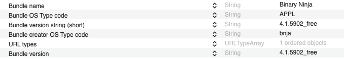

jalavoui Posted November 2, 2024 Share Posted November 2, 2024 (edited) no, this is what i get from trying to read code - bugs ! gonna download bninja again note to self: b4 donwload a new release read the pop up - i need a old release Edited November 2, 2024 by jalavoui Link to comment https://www.insanelymac.com/forum/topic/358305-iris-xe-igpu-on-tiger-lake-successfully-loaded-icllp-frambuffer-and-vram-also-recognizes-1536mb-however-some-issues/page/26/#findComment-2827236 Share on other sites More sharing options...
Visual Ehrmanntraut Posted November 2, 2024 Share Posted November 2, 2024 17 minutes ago, jalavoui said: omg why this happening grrrr I'm using BN 4.2.6335 Link to comment https://www.insanelymac.com/forum/topic/358305-iris-xe-igpu-on-tiger-lake-successfully-loaded-icllp-frambuffer-and-vram-also-recognizes-1536mb-however-some-issues/page/26/#findComment-2827237 Share on other sites More sharing options...
jalavoui Posted November 2, 2024 Share Posted November 2, 2024 this is latest Link to comment https://www.insanelymac.com/forum/topic/358305-iris-xe-igpu-on-tiger-lake-successfully-loaded-icllp-frambuffer-and-vram-also-recognizes-1536mb-however-some-issues/page/26/#findComment-2827239 Share on other sites More sharing options...
Visual Ehrmanntraut Posted November 2, 2024 Share Posted November 2, 2024 (edited) 2 minutes ago, jalavoui said: this is latest Oh, no. I'm using latest development version of Binary Ninja Personal, not free Edited November 2, 2024 by Visual Ehrmanntraut Link to comment https://www.insanelymac.com/forum/topic/358305-iris-xe-igpu-on-tiger-lake-successfully-loaded-icllp-frambuffer-and-vram-also-recognizes-1536mb-however-some-issues/page/26/#findComment-2827240 Share on other sites More sharing options...

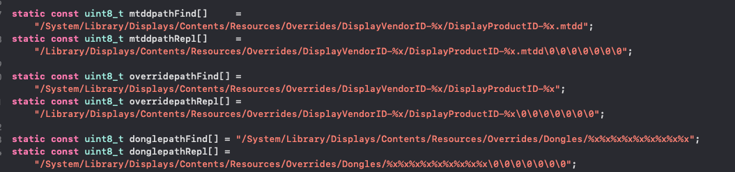

jalavoui Posted November 2, 2024 Share Posted November 2, 2024 (edited) hi joevet it's in the sle_Internal.zip page 24 in that folder /lep is the production version that visual is studying /sle are debug versions /sle are signed unmodified versions btw i've check your patches and i can't guess how you find out this are you overwritting apple default in /S/L with user default in /L/E ? this is very interesting speaking about patches u giys need to follow this https://github.com/moraea/non-metal-frameworks this is a very good work also https://github.com/ChefKissInc/NootedRed is bug free btw visual do you remenber howto config this ? i mean os x boot args i know there's other tool but i'd like to add this code to nblue i wrote about it long ago and dont remenber howto setup boot args and most important which tool to use in terminal to link to network and get live logs idk why u remove such a great tool from nred i'm also thinking on adding this to nblue idk why but can't get lilu to print results... old sources from https://github.com/NyanCatTW1/NootedRed/blob/nyanDbg2/NootedRed/kern_nred.cpp any1 as an Apple ethernet driver with kdp protocol ? i kinda miss this Edited November 2, 2024 by jalavoui 1 Link to comment https://www.insanelymac.com/forum/topic/358305-iris-xe-igpu-on-tiger-lake-successfully-loaded-icllp-frambuffer-and-vram-also-recognizes-1536mb-however-some-issues/page/26/#findComment-2827260 Share on other sites More sharing options...
joevt Posted November 3, 2024 Share Posted November 3, 2024 15 hours ago, jalavoui said: btw i've check your patches and i can't guess how you find out this are you overwritting apple default in /S/L with user default in /L/E ? this is very interesting User overrides are in /L/Displays and system overrides are in /S/L/Displays. SwitchResX modifies user overrides. It can override EDID and some other stuff related to the display. User overrides is used by CoreDisplay.framework to create display modes. If a User override doesn't exist, then it uses system overrides. System overrides is used by displaypolicyd for .mtdd files and for some other settings. I wanted to test changes to .mtdd files. I tried making mtdd files in the user overrides location but nothing happened, so I grepped for the overrides location to find that displaypolicyd was responsible for loading mtdd files and that it wouldn't load mtdd files from the user overrides location. I needed a method to modify system overrides. I figured it would be easier to make displaypolicyd always use user overrides (requires copying system overrides to the user overrides location). I don't think what I wanted to achieve actually worked though (dual tile 4K 144Hz). But there might be a use for this patch. I have a script to get a list of all the properties that exist in the overrides. I need to make a list of all the properties that CoreDisplay and displaypolicyd use (search for CFDictionaryGetValue?) and compare to see which are unique to each. 15 hours ago, jalavoui said: any1 as an Apple ethernet driver with kdp protocol ? i kinda miss this Maybe you can add a serial COM port? https://github.com/acidanthera/bugtracker/issues/1954 Or maybe Firewire kprintf or fwkdp or fwkpfv? I haven't tried either recently. 1 Link to comment https://www.insanelymac.com/forum/topic/358305-iris-xe-igpu-on-tiger-lake-successfully-loaded-icllp-frambuffer-and-vram-also-recognizes-1536mb-however-some-issues/page/26/#findComment-2827284 Share on other sites More sharing options...

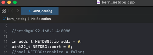

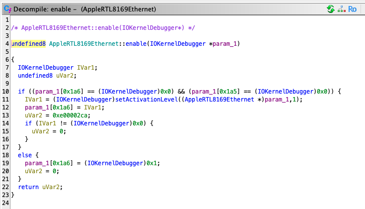

jalavoui Posted November 3, 2024 Share Posted November 3, 2024 (edited) this is from old thread. most of us don't have a apple driver for our etherner cards and as such we miss iokerneldebugger and can't do proper debugging visual can you check what parts of this code is needed so it will work on RealtekRTL8111 ? it's mieze driver i can't decompile this better... omfg i just can't belive this. the kext still works on ventura i loaded in opencore. just added my card id but acer physically disable the cable connector so i can't use this here's the kext if someone wanna use iokerneldebugger parameters are in the 2016 thread above AppleRTL8169Ethernet.kext.zip Edited November 3, 2024 by jalavoui Link to comment https://www.insanelymac.com/forum/topic/358305-iris-xe-igpu-on-tiger-lake-successfully-loaded-icllp-frambuffer-and-vram-also-recognizes-1536mb-however-some-issues/page/26/#findComment-2827294 Share on other sites More sharing options...

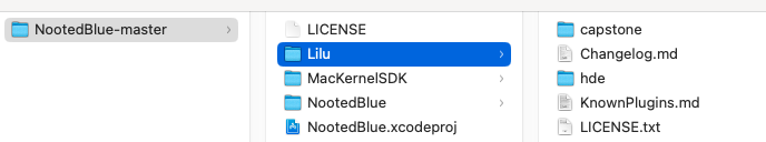

jalavoui Posted November 3, 2024 Share Posted November 3, 2024 (edited) i'm doing a review on nblue dependencies so to build nblue first get some files from (type this in terminal) git clone --recursive https://github.com/ChefKissInc/NootedRed.git files will be on your home folder (NootedRed). next move Lilu + MacKernelSDK from nred to nblue folder (replace) then build nblue. no need build lilu bug, etc complain to this guy great now can't load nblue... fixing... so kp+kp+kp -> fixed by using nred base xcode.proj ... Edited November 3, 2024 by jalavoui 2 Link to comment https://www.insanelymac.com/forum/topic/358305-iris-xe-igpu-on-tiger-lake-successfully-loaded-icllp-frambuffer-and-vram-also-recognizes-1536mb-however-some-issues/page/26/#findComment-2827298 Share on other sites More sharing options...
Visual Ehrmanntraut Posted November 3, 2024 Share Posted November 3, 2024 8 hours ago, jalavoui said: visual can you check what parts of this code is needed so it will work on RealtekRTL8111 ? it's mieze driver AppleRTL8169Ethernet_high_level_lang.txt Link to comment https://www.insanelymac.com/forum/topic/358305-iris-xe-igpu-on-tiger-lake-successfully-loaded-icllp-frambuffer-and-vram-also-recognizes-1536mb-however-some-issues/page/26/#findComment-2827303 Share on other sites More sharing options...
Visual Ehrmanntraut Posted November 3, 2024 Share Posted November 3, 2024 I would assume you need to override the ::enable(IOKernelDebugger*) variant. From a quick look in RTL8111 I don't see that existing. There are also calls to ::lock and ::unlock. Link to comment https://www.insanelymac.com/forum/topic/358305-iris-xe-igpu-on-tiger-lake-successfully-loaded-icllp-frambuffer-and-vram-also-recognizes-1536mb-however-some-issues/page/26/#findComment-2827304 Share on other sites More sharing options...

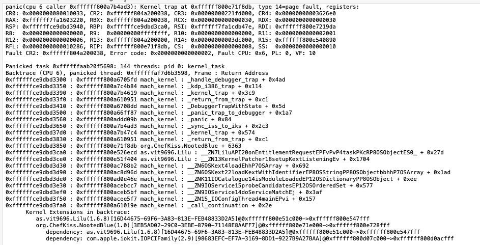

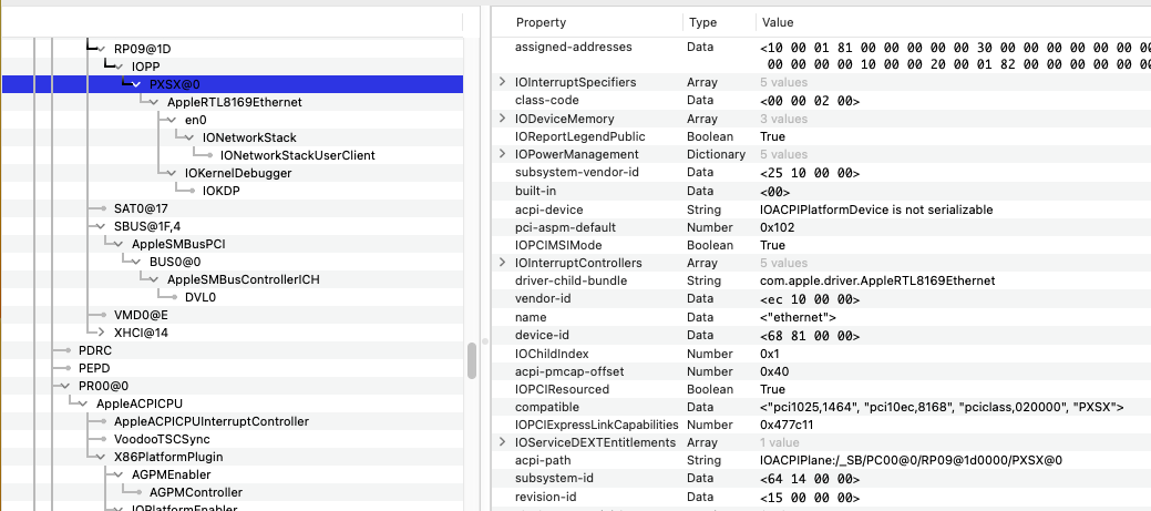

jalavoui Posted November 3, 2024 Share Posted November 3, 2024 (edited) tks. now that i ported nred base to nblue i'm getting all sort of lilu bugs. i wonder how it was working b4. hmm maybe cause i have al kexts installed and lilu didnt crash cause of that pain continues got this theory and i would like an opinion. all working igpus have this property with a non zero value (this is nred sample) this apple driver at start() do something to config space (same as nred as seen in logs) i there a way to enable this iopciexpresslinkstatus() for the igpu. maybe this is checked by os x and a lot of things depend on this setting this is my new lilu issue... Edited November 3, 2024 by jalavoui Link to comment https://www.insanelymac.com/forum/topic/358305-iris-xe-igpu-on-tiger-lake-successfully-loaded-icllp-frambuffer-and-vram-also-recognizes-1536mb-however-some-issues/page/26/#findComment-2827305 Share on other sites More sharing options...

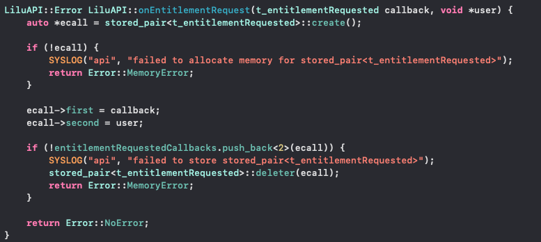

Visual Ehrmanntraut Posted November 3, 2024 Share Posted November 3, 2024 1 hour ago, jalavoui said: this is my new lilu issue... accessed invalid or read-only memory (you probably forgot to call MachInfo::setKernelWriting) Link to comment https://www.insanelymac.com/forum/topic/358305-iris-xe-igpu-on-tiger-lake-successfully-loaded-icllp-frambuffer-and-vram-also-recognizes-1536mb-however-some-issues/page/26/#findComment-2827306 Share on other sites More sharing options...
jalavoui Posted November 3, 2024 Share Posted November 3, 2024 (edited) well old nblue as this guy name and new nblue and ofc it is crashing renaming didnt solve the issue. same kp gonna try debug it wonder what changed from old xcodeproj to new nred proj hmm i doubt this kp address is correct code is fresh from nred any1 with older source plz upload it - i got no backup of old code Edited November 6, 2024 by jalavoui Link to comment https://www.insanelymac.com/forum/topic/358305-iris-xe-igpu-on-tiger-lake-successfully-loaded-icllp-frambuffer-and-vram-also-recognizes-1536mb-however-some-issues/page/26/#findComment-2827307 Share on other sites More sharing options...
joevt Posted November 4, 2024 Share Posted November 4, 2024 All Lilu based kexts need to be built with the same version of Lilu that is injected by Open Core. I use sym links for MacKernelSDK and Lilu for building each of the Lilu based kexts with my forks. myprojects=/Volumes/Work/Programming/KextProjects lilukext="$myprojects/Lilu/joevt-Lilu/DerivedData/Lilu/Build/Products/Debug/Lilu.kext" # build lilu with Xcode mkdir -p "$myprojects/WhateverGreen" cd "$myprojects/WhateverGreen" git clone https://github.com/joevt/WhateverGreen.git "joevt-WhateverGreen" cd "$myprojects/WhateverGreen/joevt-WhateverGreen" rm Lilu.kext 2> /dev/null ; ln -s "$lilukext" "Lilu.kext" rm MacKernelSDK 2> /dev/null ; ln -s "$myprojects/MacKernelSDK/joevt-MacKernelSDK" "MacKernelSDK" Link to comment https://www.insanelymac.com/forum/topic/358305-iris-xe-igpu-on-tiger-lake-successfully-loaded-icllp-frambuffer-and-vram-also-recognizes-1536mb-however-some-issues/page/26/#findComment-2827308 Share on other sites More sharing options...
