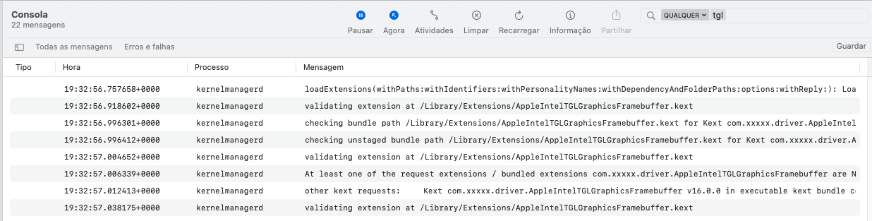

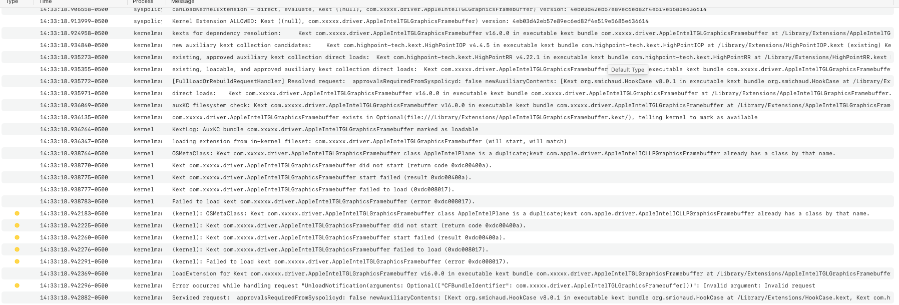

Mastachief Posted November 6, 2024 Share Posted November 6, 2024 (edited) becoolio@MacBook-Air Downloads % sudo kextload /Library/Extensions/AppleIntelTGLGraphicsFramebuffer.kext Executing: /usr/bin/kmutil load -p /Library/Extensions/AppleIntelTGLGraphicsFramebuffer.kext Error Domain=KMErrorDomain Code=71 "Kernel request failed: (libkern/kext) kext (kmod) start/stop routine failed (-603946985)" UserInfo={NSLocalizedDescription=Kernel request failed: (libkern/kext) kext (kmod) start/stop routine failed (-603946985)} becoolio@MacBook-Air Downloads % Apple Backlight is usually added via the nblue plist, but it wasnt modified when i was testing. Edited November 6, 2024 by Mastachief Link to comment https://www.insanelymac.com/forum/topic/358305-iris-xe-igpu-on-tiger-lake-successfully-loaded-icllp-frambuffer-and-vram-also-recognizes-1536mb-however-some-issues/page/28/#findComment-2827487 Share on other sites More sharing options...
jalavoui Posted November 6, 2024 Share Posted November 6, 2024 (edited) open log console and redo kextload so you can check the error. seems like permissions or dependencie error. use tgl as console filter anyway u found the cause hope this is not some extra dependency caused by sonoma Edited November 6, 2024 by jalavoui Link to comment https://www.insanelymac.com/forum/topic/358305-iris-xe-igpu-on-tiger-lake-successfully-loaded-icllp-frambuffer-and-vram-also-recognizes-1536mb-however-some-issues/page/28/#findComment-2827488 Share on other sites More sharing options...
Mastachief Posted November 6, 2024 Share Posted November 6, 2024 (edited) com.xxxxx.driver.AppleIntelTGLGraphicsFramebuffer exists in Optional(file:///Library/Extensions/AppleIntelTGLGraphicsFramebuffer.kext/), telling kernel to mark as available KextLog: AuxKC bundle com.xxxxx.driver.AppleIntelTGLGraphicsFramebuffer marked as loadable loading extension from in-kernel fileset: com.xxxxx.driver.AppleIntelTGLGraphicsFramebuffer (will start, will match) OSMetaClass: Kext com.xxxxx.driver.AppleIntelTGLGraphicsFramebuffer class AppleIntelPlane is a duplicate;kext com.apple.driver.AppleIntelICLLPGraphicsFramebuffer already has a class by that name. Kernel Extension ALLOWED: Kext ((null), com.xxxxx.driver.AppleIntelTGLGraphicsFramebuffer) version: 4eb03d42eb57e89ec6ed82f4e519e5685e636614 Kext com.xxxxx.driver.AppleIntelTGLGraphicsFramebuffer did not start (return code 0xdc00400a). Edited November 6, 2024 by Mastachief Link to comment https://www.insanelymac.com/forum/topic/358305-iris-xe-igpu-on-tiger-lake-successfully-loaded-icllp-frambuffer-and-vram-also-recognizes-1536mb-however-some-issues/page/28/#findComment-2827490 Share on other sites More sharing options...
jalavoui Posted November 6, 2024 Share Posted November 6, 2024 (edited) same id in com.apple.driver.AppleIntelICLLPGraphicsFramebuffer ? 0x9a49 shoudn't match system icl i've got that error some time ago also. cache error from old kexts maybe that is cause u booted wit icl kext that's why u got that error boot without nblue to test glad i remenbered that anyway just reset /L/E cache after boot. i think the cache might be ok so hang issue is something else. test nblue binary with card id on icl sys frame to check (leave tgl card id empty) Edited November 6, 2024 by jalavoui Link to comment https://www.insanelymac.com/forum/topic/358305-iris-xe-igpu-on-tiger-lake-successfully-loaded-icllp-frambuffer-and-vram-also-recognizes-1536mb-however-some-issues/page/28/#findComment-2827491 Share on other sites More sharing options...

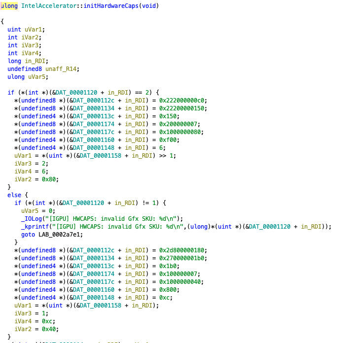

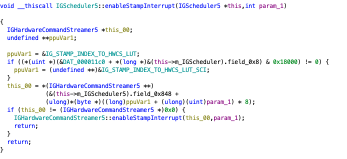

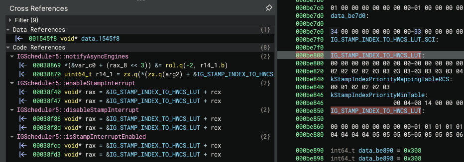

jalavoui Posted November 6, 2024 Share Posted November 6, 2024 (edited) no wg no nblue boot with zero graph kexts. idk if what asus sayd about lilu kext loader loop is causing some type of hang tying to understand this code. maybe relates to CsbProcModeSelect parameter from info.plist scheduler 5 doesnt load firmware. trying to guess how this works and why it is failing visual can you translate this china code ? better start here Edited November 6, 2024 by jalavoui Link to comment https://www.insanelymac.com/forum/topic/358305-iris-xe-igpu-on-tiger-lake-successfully-loaded-icllp-frambuffer-and-vram-also-recognizes-1536mb-however-some-issues/page/28/#findComment-2827494 Share on other sites More sharing options...

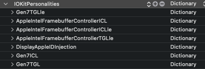

jalavoui Posted November 7, 2024 Share Posted November 7, 2024 (edited) i've updated nblue to allow loading any of the tgl framebuffers (debug or production) +extra patches so choose tgl frame from sle_internal (le or lep) and test it gonna move srcs +sle_internal to another thread so i can update 1st post Edited November 9, 2024 by jalavoui 2 Link to comment https://www.insanelymac.com/forum/topic/358305-iris-xe-igpu-on-tiger-lake-successfully-loaded-icllp-frambuffer-and-vram-also-recognizes-1536mb-however-some-issues/page/28/#findComment-2827513 Share on other sites More sharing options...
jalavoui Posted November 7, 2024 Share Posted November 7, 2024 symbols to dwarf in bn Link to comment https://www.insanelymac.com/forum/topic/358305-iris-xe-igpu-on-tiger-lake-successfully-loaded-icllp-frambuffer-and-vram-also-recognizes-1536mb-however-some-issues/page/28/#findComment-2827527 Share on other sites More sharing options...

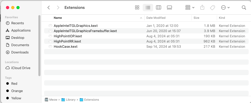

jalavoui Posted November 8, 2024 Share Posted November 8, 2024 (edited) found the hang at boot reason. doing updates to nblue done test the binary again it defaults to tgl loading. src is updated with tgl graph in /l/e. the entry is gen7TGLle (devs only) so the problem is caused by having in nblue info.plist an entry with a card id and the kext to load is not on the system or can't be loaded. care when you put a value in IOPCIPrimaryMatch on this section btw this changes are all masta fault. that is why i got this hang bug hope it works Edited November 8, 2024 by jalavoui Link to comment https://www.insanelymac.com/forum/topic/358305-iris-xe-igpu-on-tiger-lake-successfully-loaded-icllp-frambuffer-and-vram-also-recognizes-1536mb-however-some-issues/page/28/#findComment-2827542 Share on other sites More sharing options...

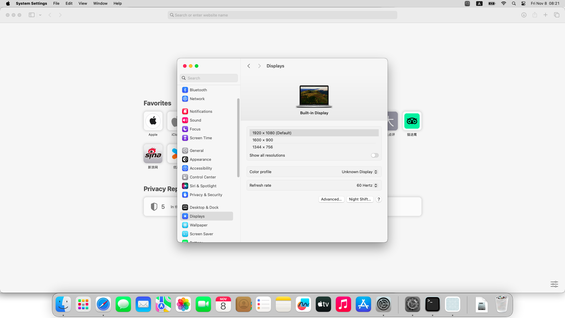

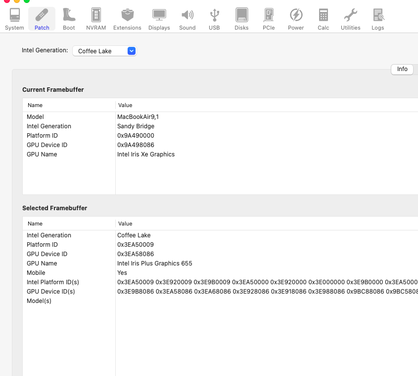

Mastachief Posted November 8, 2024 Share Posted November 8, 2024 (edited) Yeah, it's my fault indeed, sorry Jala, I just did a wipe and reinstalled Sonoma to get rid of SLE bug, also I was able to get logs and all now. it boots with le TGL frame in /L/E For some reason, it shows the intel generation as Sandy Bridge.Also, even if you raise the brightness to max at the opencore boot screen, it switches back to a mid level brightness at the log in screen. If the laptop goes to sleep and wakes up, the screen becomes inverted in colors, if you change resolutions the colors switch to the normal colors for a quarter second before going back to the inverted colors. its the last image in this post. Here's my current ioreg. ---> becoolio’s MacBook Air ioreg.zip logs ---> x.log.zip Edited November 8, 2024 by Mastachief Link to comment https://www.insanelymac.com/forum/topic/358305-iris-xe-igpu-on-tiger-lake-successfully-loaded-icllp-frambuffer-and-vram-also-recognizes-1536mb-however-some-issues/page/28/#findComment-2827559 Share on other sites More sharing options...
jalavoui Posted November 8, 2024 Share Posted November 8, 2024 (edited) glad it worked. let me think about the issues u have. on my system on shutdown os x reboots. must be cause of preparetoxxx calls. and also cause i dont have a wake/sleep cycle working on the laptop your log files as no tgl log lines. 1st boot bug? sometimes i dont get logs on 1st boot the color issue idk. os x color profile? if u wanna play with source code try change port settings. carefull cause wrong settings and you get a hung try inject display props with nblue info.plist also a option the edid overwrite injected with open core might help anyway now u can help me with advanced testing in xcode hope you find new things to fix you now can swap tgl debug / tgl production kexts in /L/E as they are expected to work Edited November 8, 2024 by jalavoui Link to comment https://www.insanelymac.com/forum/topic/358305-iris-xe-igpu-on-tiger-lake-successfully-loaded-icllp-frambuffer-and-vram-also-recognizes-1536mb-however-some-issues/page/28/#findComment-2827560 Share on other sites More sharing options...

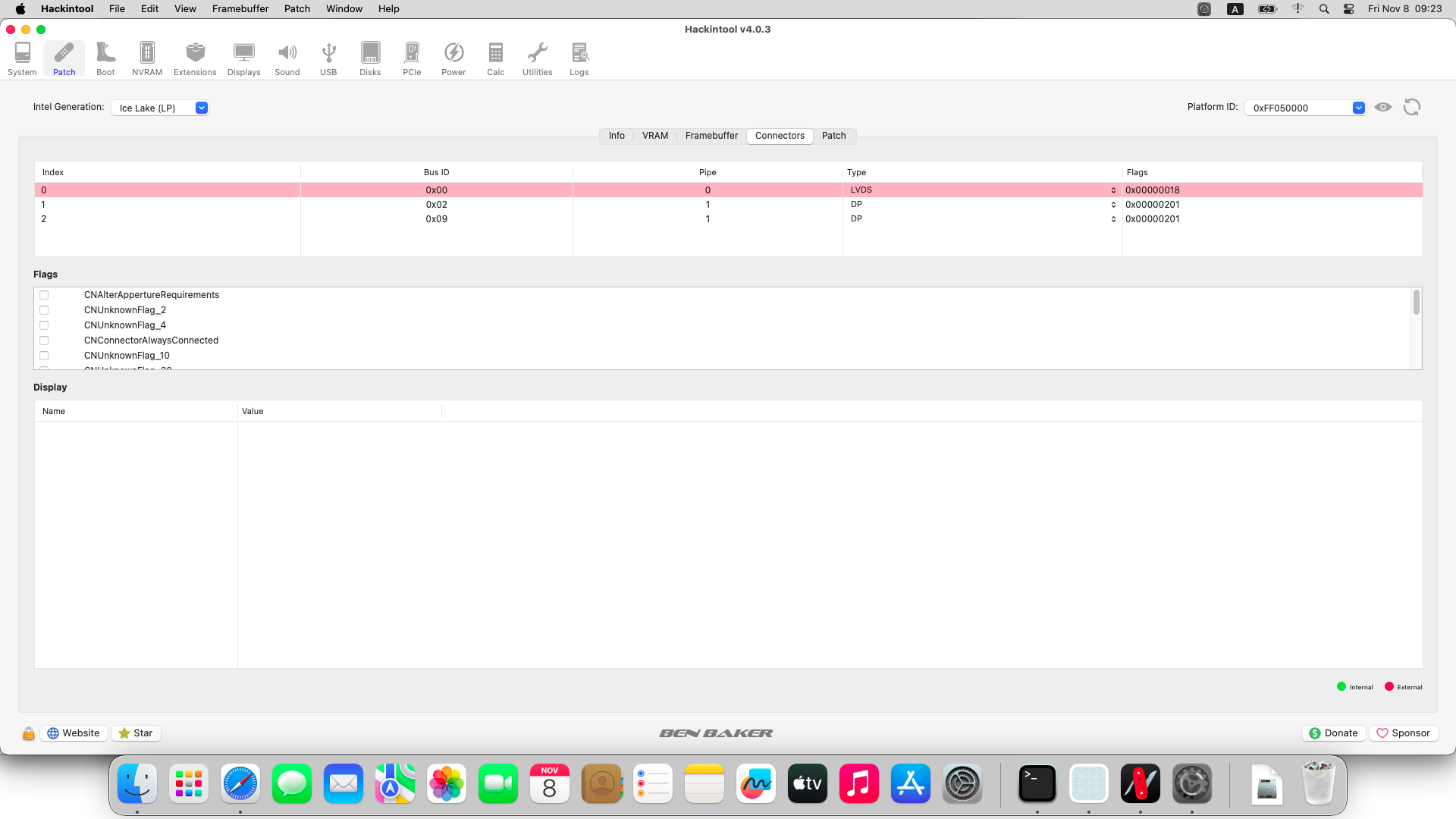

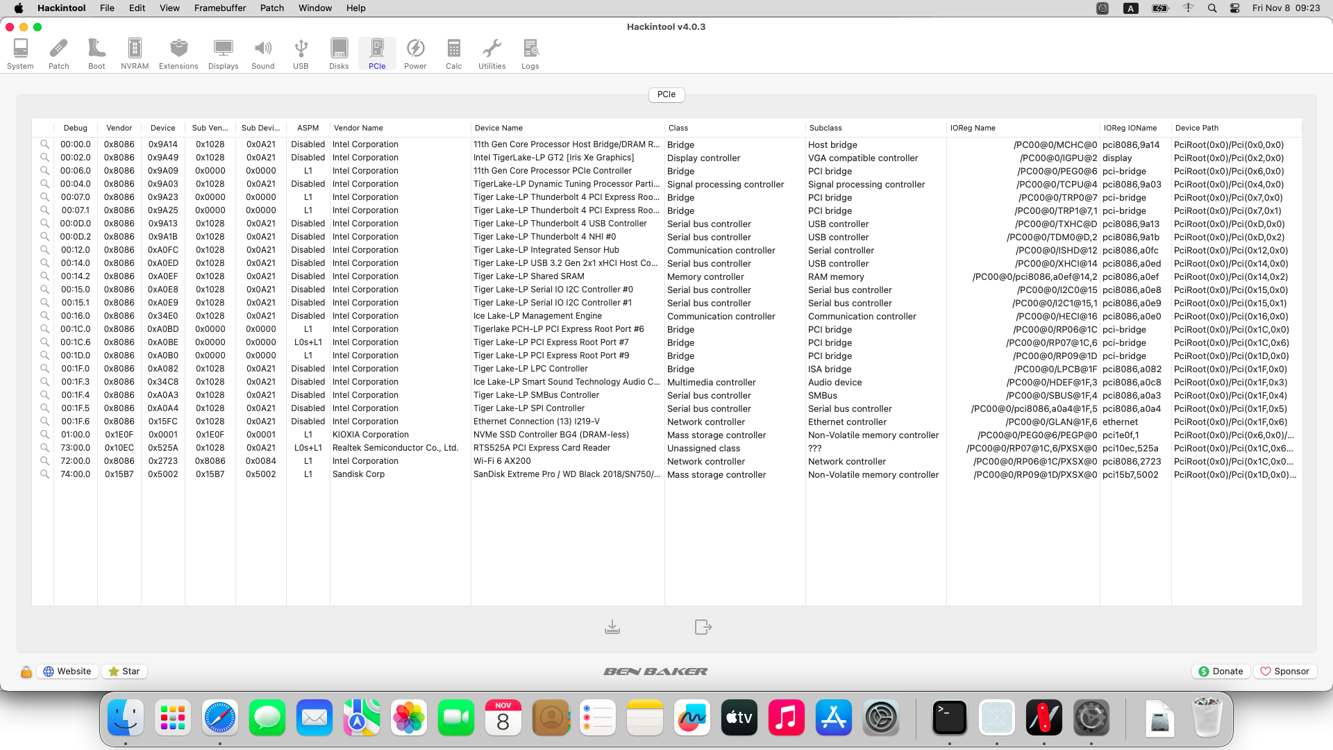

Mastachief Posted November 8, 2024 Share Posted November 8, 2024 (edited) Just rebooted, however, I don't get the logs on the second boot either, Ill need to check my oc settings to see where the logs are going. If only we had more people with the 9A49 or 9A40 variant. got this log from using hackintool when using the le debug version. boot.log the tglframe production version in le with tglgraphics kext works, well it boots and i dont have that log as yet. I override the display with my own EDID using nblue plist, however it wont show up until connectors are fixed. Edited November 8, 2024 by Mastachief Link to comment https://www.insanelymac.com/forum/topic/358305-iris-xe-igpu-on-tiger-lake-successfully-loaded-icllp-frambuffer-and-vram-also-recognizes-1536mb-however-some-issues/page/28/#findComment-2827561 Share on other sites More sharing options...
jalavoui Posted November 8, 2024 Share Posted November 8, 2024 (edited) also check this in asl patches. the logs i think are some oc flag.check asus thread check joevt wg patch for syspolicyd. it is for dell vendor id so atm only 2 people are using nblue dam that is low your display seems very active. mine is not doing this. maybe this causes issues? masta can you test by removing bkl ssdt? maybe helps. bkl code is broken atm in tgl why u don't use this ? and the sbus? Edited November 8, 2024 by jalavoui Link to comment https://www.insanelymac.com/forum/topic/358305-iris-xe-igpu-on-tiger-lake-successfully-loaded-icllp-frambuffer-and-vram-also-recognizes-1536mb-however-some-issues/page/28/#findComment-2827563 Share on other sites More sharing options...

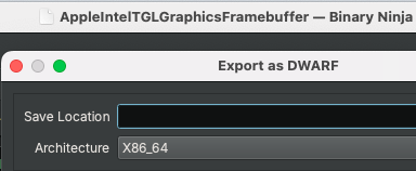

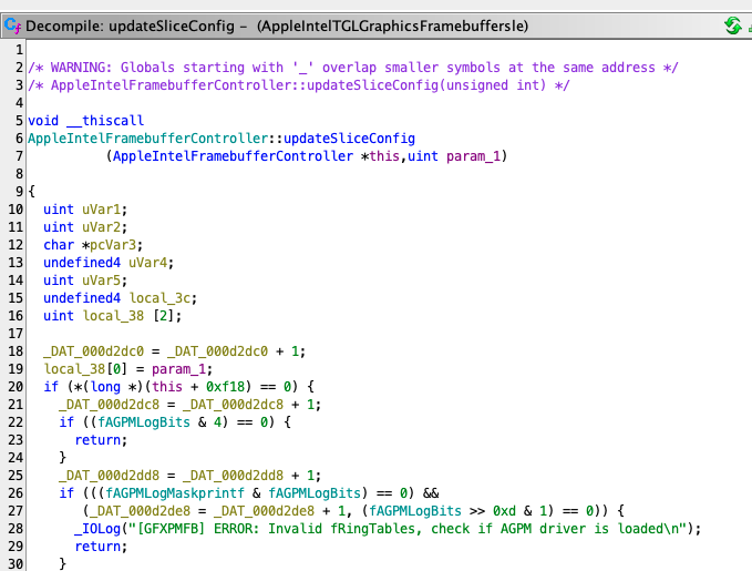

jalavoui Posted November 8, 2024 Share Posted November 8, 2024 (edited) so i was playing with this for tgl production. and with some ida imports got a dwarf file that can be shared goal is get rid of china code disassembly tgl.dwo.zip was fun but i think can do better can i make bninja read from aux.kc and get functions from sys.kc and boot.kc as in ida pro? ofc there must be a easier way Edited November 8, 2024 by jalavoui Link to comment https://www.insanelymac.com/forum/topic/358305-iris-xe-igpu-on-tiger-lake-successfully-loaded-icllp-frambuffer-and-vram-also-recognizes-1536mb-however-some-issues/page/28/#findComment-2827567 Share on other sites More sharing options...

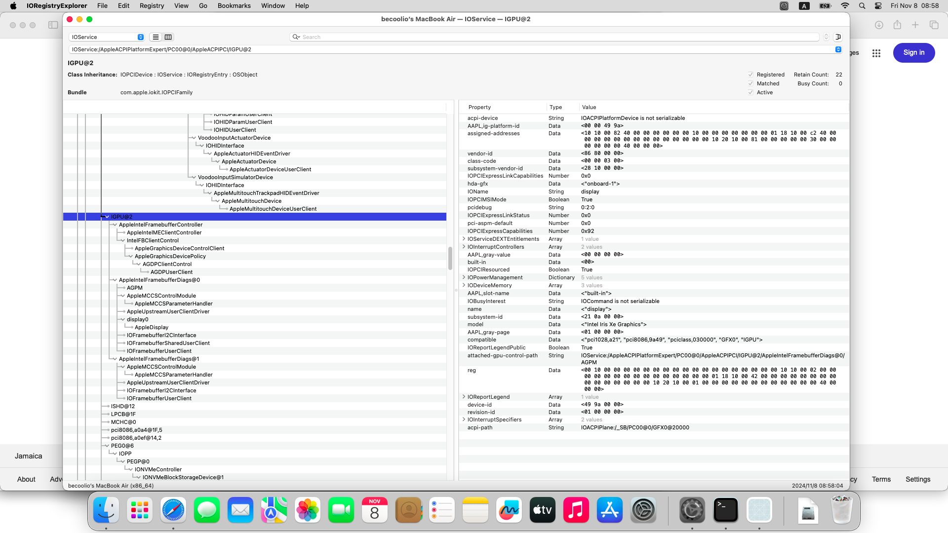

Mastachief Posted November 9, 2024 Share Posted November 9, 2024 Updated SSDT-HPET.aml Updated SSDT-SBUS-MCHC.aml Disabled SSDT-ALS0.aml Disabled SSDT-PNLF.aml new ioreg attached becoolio’s MacBook Air.zip I'm really not sure what kind of i2c issues are causing the Display to be so active hackintool boot.rtf Hackintool system.log Link to comment https://www.insanelymac.com/forum/topic/358305-iris-xe-igpu-on-tiger-lake-successfully-loaded-icllp-frambuffer-and-vram-also-recognizes-1536mb-however-some-issues/page/28/#findComment-2827580 Share on other sites More sharing options...
jalavoui Posted November 9, 2024 Share Posted November 9, 2024 (edited) option a) is nblue ports patch. i just remenber you can try change display connect flags maybe it helps and wrong port type 2 value i remenber long ago to disable some power settings with hackintool. some are display related. not sure which ones to look for hope you find some workaround for the colors issue nblue as prepareToExitWake disabled. try enable it might work for you cause u have a working sleep/wake laptop anyway u have a much better laptop to fix than me so i guess for now all good let's focus on acelerator kext... Edited November 9, 2024 by jalavoui Link to comment https://www.insanelymac.com/forum/topic/358305-iris-xe-igpu-on-tiger-lake-successfully-loaded-icllp-frambuffer-and-vram-also-recognizes-1536mb-however-some-issues/page/28/#findComment-2827582 Share on other sites More sharing options...

Mastachief Posted November 9, 2024 Share Posted November 9, 2024 (edited) I just pushed the latest config, the original "working" nblue is in a zipped folder in EFI/OC/Kexts, its currently set to use the nblue that requires the production/debug version of tglframebuffer and tglgraphics kexts in /Library/Extentions. Edited November 9, 2024 by Mastachief 1 Link to comment https://www.insanelymac.com/forum/topic/358305-iris-xe-igpu-on-tiger-lake-successfully-loaded-icllp-frambuffer-and-vram-also-recognizes-1536mb-however-some-issues/page/28/#findComment-2827604 Share on other sites More sharing options...

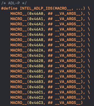

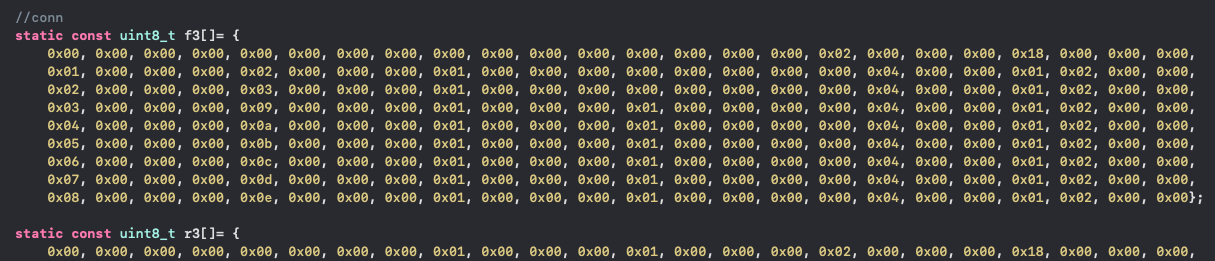

jalavoui Posted November 9, 2024 Share Posted November 9, 2024 (edited) Xe IGPU (0x46a6) is kinda same family as asus laptop (check his thread) from is logs i think is doable - load adl in tgl framebuffer. the connector patch you mentioned is so easy todo using nblue (conn zero). but i think other issues will pop up don't think at 0x9a49 as a limitation. it is the way i foud out to link tgl settings with tgl fram kext graphics kext. waht really makes the driver works are the patches idk what you guys need todo it but we here to help the i2c gpio pins... i just can't do it. staying in pool mode for now but ofc i'm here also to learn altough i'm bad with dsdt's (can't make lilu do a simple GPRW rename...) jkbuha can you link us your github ? omg i'm so pro... my SSDT-AWAC.aml was disabled and no sleep/wake cycle. now that is enabled i have the power cycle working Edited November 9, 2024 by jalavoui 1 Link to comment https://www.insanelymac.com/forum/topic/358305-iris-xe-igpu-on-tiger-lake-successfully-loaded-icllp-frambuffer-and-vram-also-recognizes-1536mb-however-some-issues/page/28/#findComment-2827605 Share on other sites More sharing options...
