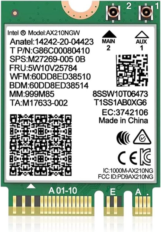

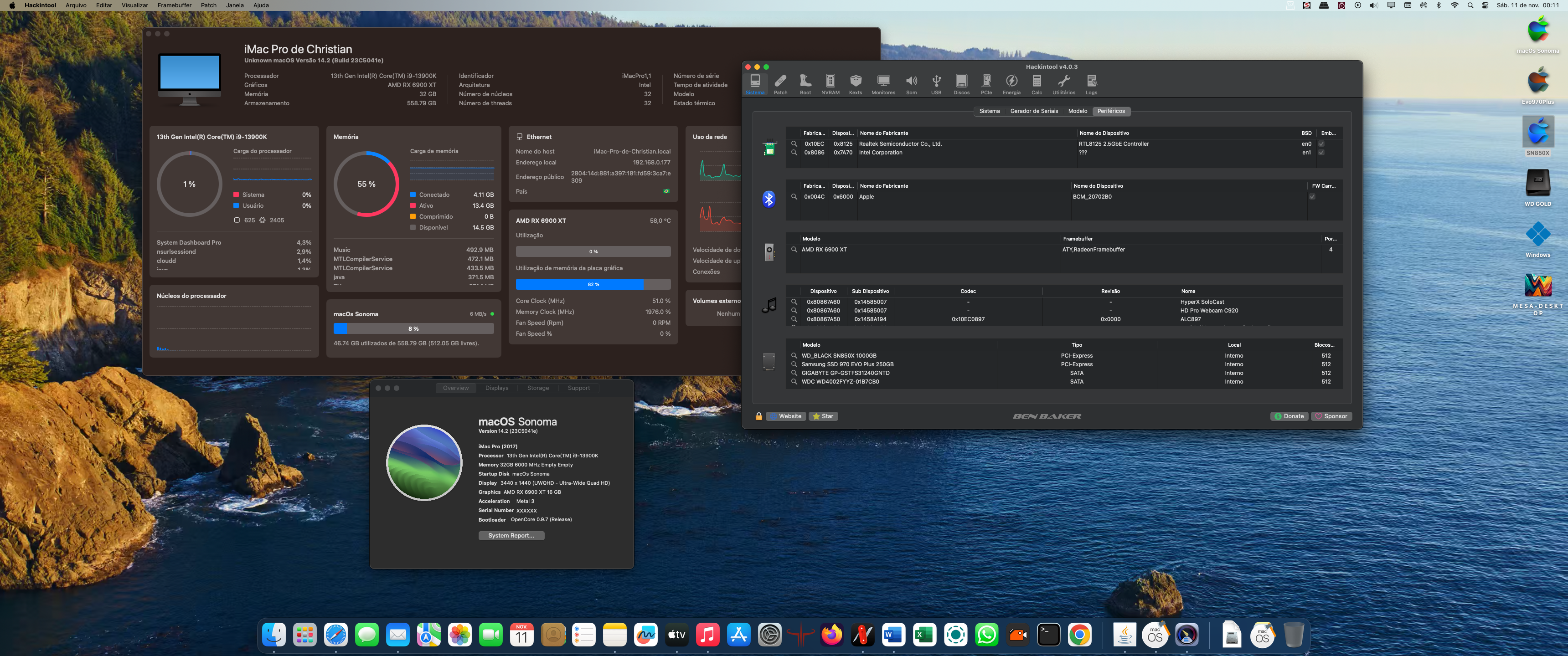

miliuco Posted November 10, 2023 Share Posted November 10, 2023 (edited) Wi-Fi 6 Intel AX210 on macOS Sonoma macOS Sonoma removed drivers for Broadcom Wi-Fi cards found in Mac models prior to 2017. One of the affected cards is the Fenvi T-919, widely used in Hacks. OCLP developers published a fix that allows these Wi-Fi to work in Sonoma, adding this feature to the root patches that OCLP can apply. In order to apply root patches, OCLP requires macOS to run with some relaxed security features: SecureBootModel disabled and SIP partially disabled. This still represents a certain loss of security in macOS, as some users have noted (a reminder to @deeveedee). Here I propose a model of Intel Wi-Fi card that by default lacks support but can be used in Sonoma thanks to the work of the OpenIntelWireless site. This is the Intel AX210S PCIe WiFi 6E card. This card can work with regular macOS security conditions without needing to relax Apple Secure Boot or SIP. It may be interesting for those who lack Wi-Fi in Sonoma or for those who want to keep the security of their system without resorting to OCLP patches. Hardware The card can be purchased in 2 different ways: fully assembled by Ziyituod and others: WiFi 6E Intel AX210S PCIe in 2 parts, card itself on the one hand (WiFi 6E Intel AX210 NGW Bluetooth Card for Laptop with M.2/NGFF Connector) and adapter on the other (PCIE X1 to M.2/NGFF A+E Key Adapter for WiFi Bluetooth Module). Spoiler Revert OCLP patch and config.plist changes In config.plist: disable kexts (IOSkywalk.kext, IO80211FamilyLegacy.kext and AirPortBrcmNIC.kext) disable IOSkywalk.kext blocking change csr-active-config to 00000000 change Secure Boot Model to a value other than Disabled. From OpenCore-Patcher >> Post-Install Root Patch >> Revert Root Patches. Installing wifi module The 2 kexts are available on the OpenIntelWireless site. There are 2 ways to install Wi-Fi: itlwm.kext: uses IOEthernetController instead of IO80211Family so the connection spoofs as Ethernet even though it works as wifi. It does not use the macOS Wi-Fi menu, instead you have to use the HeliPort application. AirportItlwm.kext: uses IO80211Family so it works like the rest of the system's Wi-Fi connections. It provides minimal Continuity features (Handoff and Universal Clipboard) but appears to have lower stability than itlwm.kext and cannot connect to hidden networks. No HeliPort needed. Both kexts should not be used at the same time, only one of them. I have tried both and they seem to have worked well, in my opinion the stability is very similar although with AirportItlwm.kext Photos app sometimes displays the "poor network with synchronization paused" message. The card is well detected, as you can see in Hackintool. Spoiler I am using HeliPort from diepeterpan, it is a fork of the original but has performance and interface improvements. From the HeliPort icon in the menu bar you can connect and disconnect Wi-Fi networks as well as set it to be added to the startup items. Spoiler Installing Bluetooth module On Monterey and newer you have to install 3 extensions: IntelBTPatcher.kext (available in OpenIntelWireless), requires Lilu 1.6.2 >> fixes a bug in bluetoothd by correctly initializing the bluetooth module IntelBluetoothFirmware.kext (available on OpenIntelWireless), at least version 2.2.0 >> load the firmware to the device and set the device name in USB Host Controller to Bluetooth USB Host Controller BlueToolFixup.kext (available in Acidanthera's BrcmPatchRAM package) >> on macOS Monterey IntelBluetoothInjector.kext stopped working due to changes made by Apple to the Bluetooth stack. Performance The Intel wifi card has performance not so different from the Fenvi with Broadcom. As for the 2 ways to install it, AirportItlwm.kext gives a better score. Spoiler Summary This hardware is a valid option for those who do not have Wi-Fi in Sonoma or do not want to apply OCLP patches. It is not expensive and is easy to install. As a main drawback, the features of the Apple ecosystem are lost (all with itlwm.kext and most with AirportItlwm.kext). Airdrop does not work in any way and this is the feature that I miss the most with respect to the Fenvi. Thanks @Max.1974 Edited December 10, 2023 by miliuco 6 2 Link to comment Share on other sites More sharing options...

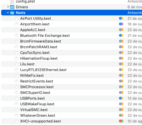

miliuco Posted November 11, 2023 Author Share Posted November 11, 2023 @Max.1974 Airport Utility doesn't work for me. I put it in Kexts folder and config.plist, disabling itlwm and AirportItlwm. Is this the way? 1 Link to comment Share on other sites More sharing options...
Max.1974 Posted November 12, 2023 Share Posted November 12, 2023 (edited) 5 hours ago, miliuco said: @Max.1974 Airport Utility doesn't work for me. I put it in Kexts folder and config.plist, disabling itlwm and AirportItlwm. Is this the way? Hi my dear friend, you can use only one kexts from intel, or Airportltwm, or itlwm. It's recommended by developer, but im sure that you know. The kexts Airpot Utility and Bluetooth Exchange you can use normally like any another kext. Enable all others kexts mentioned above. Not exclude intel, use all of them together So you can see better performance and connectivity with Bluetooth. The same with Broadcom, if you will use on Ventura, for exemple. Can you use together Sorry not detailer more than usual. Best Regards my friend!! Edited November 12, 2023 by Max.1974 2 Link to comment Share on other sites More sharing options...

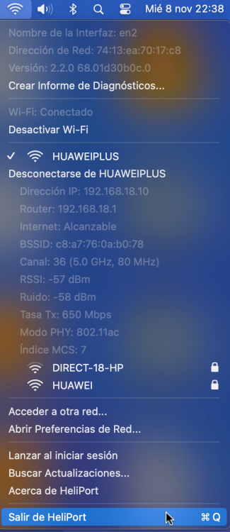

deeveedee Posted November 26, 2023 Share Posted November 26, 2023 (edited) @miliuco I'm using itlwm.kext v2.2.0 (stable) with Heliport 1.4.1 in Sonoma 14.1.1 (Release) on my MBP15,2 (HP Envy). Easy install. Very clever the way itlwm uses an Ethernet interface so that it does not need macOS 802.11 framework. I only need basic Wi-Fi capability, so this is perfect for me. No need to break APFS seal, no need to inject uncertified root patches, no need to partially disable SIP. This Intel solution has come a long way since I last looked at it. EDIT: Intel Bluetooth working (in my limited testing so far) in Sonoma 14.1.1 with IntelBTPatcher.kext 2.3.0 IntelBluetoothFirmware.kext 2.3.0 BlueToolFixup.kext 2.6.8 Edited November 26, 2023 by deeveedee Link to comment Share on other sites More sharing options...

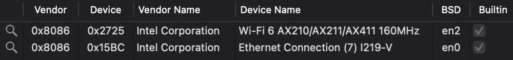

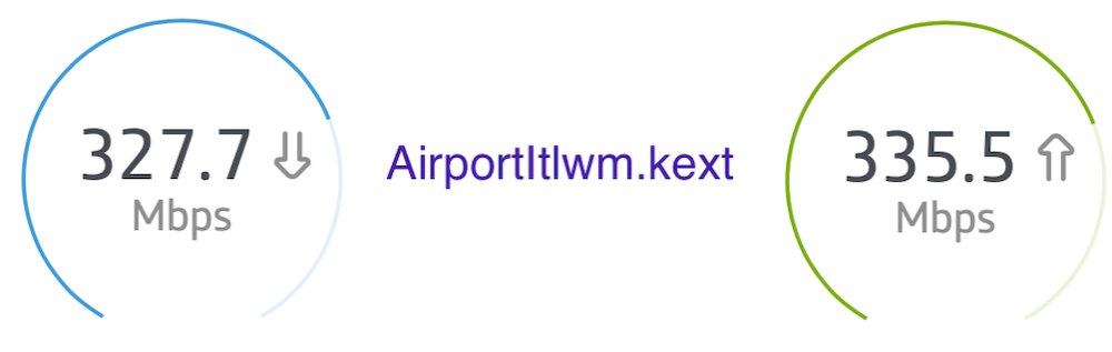

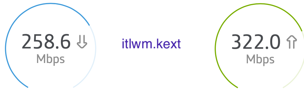

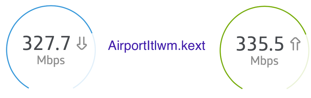

miliuco Posted November 26, 2023 Author Share Posted November 26, 2023 (edited) @deeveedee Good morning. I see that the Intel AX210 gets better wifi bandwidth scores than Broadcom Fenvi T919, not much better but consistently. Its performance in this aspect is excellent, leaving aside Apple's specific functions. I use Heliport by diepeterpan, especially because the interface when displaying the menu is more developed (with official Heliport sometimes text elements of drop-down menu are clipped or overlapped) but also according to the developer it has some better changes specific to Sonoma. Like you, I have itlwm 2.2.0 stable. If I have to say a (small) drawback, it is that, when turning on the computer, Heliport takes longer to connect to the network than with Broadcom using macOS 802.11 framework but I'm talking about a few seconds longer. I have also tried AirportItlwm 2.3.0 alpha. Wifi connects faster when starting up, Heliport is not needed and the speed is slightly faster than itlwm but Photos app shows a message of sync paused due to poor network and I have to click the Resume sync button. With itlwm this does not happen. Regarding Bluetooth, I have the same kexts as you but in a different order in config.plist, I don't know if this has any influence: IntelBluetoothFirmware.kext 2.3.0 IntelBTPatcher.kext 2.3.0 BlueToolFixup.kext 2.6.8. BT works fine with only one drawback that appears to be cosmetic: in System Profiler >> Bluetooth >> Chipset it says THIRD_PARTY_DONGLE. I see users here who have a specific chipset model. I don't know why it happens and I haven't found a way to change it. I have also tried 2 boot args but I have not observed any differences. Do you have these boot args? <key>NVRAM</key> <dict> <key>Add</key> <dict> <key>7C436110-AB2A-4BBB-A880-FE41995C9F82</key> <dict> <key>bluetoothInternalControllerInfo</key> <data>AAAAAAAAAAAAAAAAAAA=</data> <key>bluetoothExternalDongleFailed</key> <data>AA==</data> </dict> </dict> <key>Delete</key> <dict> <key>7C436110-AB2A-4BBB-A880-FE41995C9F82</key> <array> <string>bluetoothInternalControllerInfo</string> <string>bluetoothExternalDongleFailed</string> </array> </dict> </dict> Edited November 26, 2023 by miliuco 1 Link to comment Share on other sites More sharing options...

deeveedee Posted November 26, 2023 Share Posted November 26, 2023 (edited) 4 hours ago, miliuco said: I use Heliport by diepeterpan, especially because the interface when displaying the menu is more developed (with official Heliport sometimes text elements of drop-down menu are clipped or overlapped) but also according to the developer it has some better changes specific to Sonoma. Like you, I have itlwm 2.2.0 stable. If I have to say a (small) drawback, it is that, when turning on the computer, Heliport takes longer to connect to the network than with Broadcom using macOS 802.11 framework but I'm talking about a few seconds longer. Regarding Bluetooth, I have the same kexts as you but in a different order in config.plist, I don't know if this has any influence: IntelBluetoothFirmware.kext 2.3.0 IntelBTPatcher.kext 2.3.0 BlueToolFixup.kext 2.6.8. BT works fine with only one drawback that appears to be cosmetic: in System Profiler >> Bluetooth >> Chipset it says THIRD_PARTY_DONGLE. I see users here who have a specific chipset model. I don't know why it happens and I haven't found a way to change it. I have also tried 2 boot args but I have not observed any differences. Do you have these boot args? I have observed the compressed drop-down menu. I find that if I unselect and reselect the drop down menu, the menu is fixed. I have not observed the longer connection time. Maybe the kext order doesn't matter. I took the order from here. I'm just adding the kexts in the order they were listed in the documentation. My Bluetooth appears as follows. Its USB port is Internal. I don't think it matters, but I am replacing DMAR with a modified DMAR that removes XHC Reserved Region. I do not have the NVRAM adds/deletes (although I did use these before zxystd incorporated these fixes into his BlueToolFixup.kext mods). Edited November 26, 2023 by deeveedee 1 Link to comment Share on other sites More sharing options...

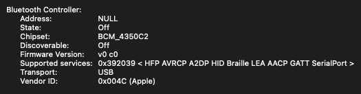

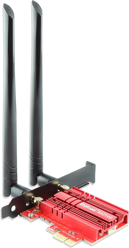

miliuco Posted November 26, 2023 Author Share Posted November 26, 2023 @deeveedee Yes, I have also found that dropdown menu was fixed unselecting and reselecting items. I'll try changing kexts order, orderig them as you do and comment. You have a name in Chipset, where I have THIRD_PARTY_DONGLE. Maybe this happens sometimes although I guess you are also using an Intel AX210 card, right? As me. @cankiulascmnfye It's not a real dongle, it's a PICe card. USB port where BT cable is plugged is set as internal in UTBMap. From what I have read, there are users who have THIRD_PARTY DONGLE and there are others who have a specific chipset. It doesn't seem to affect the operation but I don't like seeing it like this. Link to comment Share on other sites More sharing options...
cankiulascmnfye Posted November 26, 2023 Share Posted November 26, 2023 As long as it works, get over it. It's only a SystemProfiler info thing. 1 Link to comment Share on other sites More sharing options...

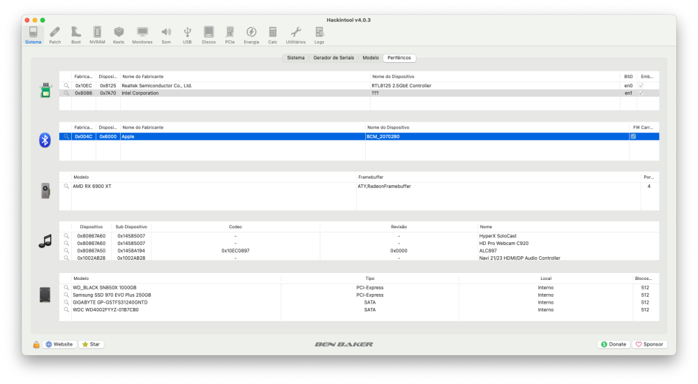

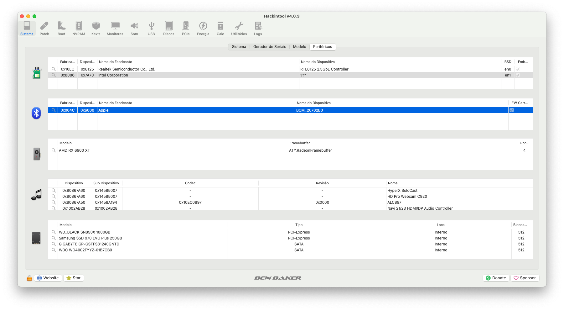

Max.1974 Posted November 27, 2023 Share Posted November 27, 2023 Hello my friend @miliuco , I had the privilege, even though I didn't know it at the time, of having purchased a Z790 Aorus Elite AX, which comes with an AX211 wireless card, WI-FI 6E M.2 slot: CNVio2. To my surprise, I can use the Pcie Bluetooth that comes with the Broadcom card, isolating the Intel Bluetooth with mapping. And I use both Wireless Cards, whether on the Intel Sonoma or the Broadcom Ventura, which because the latter is native, I don't need kexts, and can boot with just the Intel ones. The correct name appears there. Native Bluetooth BCM_20702B0. Greetings Spoiler 1 Link to comment Share on other sites More sharing options...

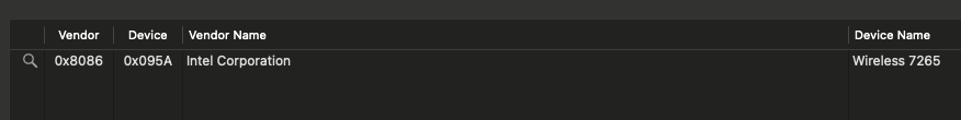

deeveedee Posted November 27, 2023 Share Posted November 27, 2023 (edited) My Wi-Fi card is an older Intel 7265. Sorry I was OT in this thread. Spoiler Edited November 27, 2023 by deeveedee 1 Link to comment Share on other sites More sharing options...
