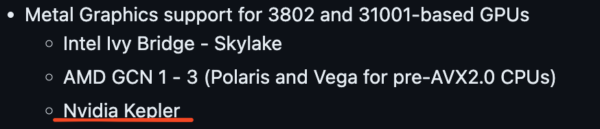

Cyberdevs Posted August 13, 2023 Share Posted August 13, 2023 19 minutes ago, Soul92 said: thanks the installation worked, but when it restarted I don't see any change in graphics, it remains without gtx970, do I have to add kexts or modify the boot-args? In case you missed it, your GPU is not supported in macOS Sonoma or any other previous versions like Ventura, Monterey, Big Sur, Catalina and Mojave Only macOS Sierra and High Sierra are supporting nVidia Web Drivers. https://dortania.github.io/OpenCore-Install-Guide/macos-limits.html#gpu-support 2 Link to comment https://www.insanelymac.com/forum/topic/356881-pre-release-macos-sonoma/page/58/#findComment-2810177 Share on other sites More sharing options...
Soul92 Posted August 13, 2023 Share Posted August 13, 2023 14 minuti fa, Cyberdevs ha dichiarato: Nel caso te lo fossi perso, la tua GPU non è supportata in macOS Sonoma o in qualsiasi altra versione precedente come Ventura, Monterey, Big Sur, Catalina e Mojave Solo macOS Sierra e High Sierra supportano i driver Web nVidi. https://github.com/dortania/OpenCore-Legacy-Patcher/pull/1077#issuecomment-1646934494 I found this on github that might work Link to comment https://www.insanelymac.com/forum/topic/356881-pre-release-macos-sonoma/page/58/#findComment-2810178 Share on other sites More sharing options...
Cyberdevs Posted August 13, 2023 Share Posted August 13, 2023 32 minutes ago, Soul92 said: https://github.com/dortania/OpenCore-Legacy-Patcher/pull/1077#issuecomment-1646934494 I found this on github that might work The last Mac that has a nVidia GPU is the 2013 iMac which has a Kepler chipset that Apple officially supported until macOS Catalina and your GPU is Maxwell which Apple never used in any Mac so that won't apply to you. But if you'd like to test that and prove that it works be my guest. 1 Link to comment https://www.insanelymac.com/forum/topic/356881-pre-release-macos-sonoma/page/58/#findComment-2810179 Share on other sites More sharing options...
Soul92 Posted August 13, 2023 Share Posted August 13, 2023 14 minutes ago, Cyberdevs said: The last Mac that has a nVidia GPU is the 2013 iMac which has a Kepler chipset that Apple officially supported until macOS Catalina and your GPU is Pascal which Apple never used in any Mac so that won't apply to you. But if you'd like to test that and prove that it works be my guest. My nvidia gtx970 is maxvell and worked with high sierra Link to comment https://www.insanelymac.com/forum/topic/356881-pre-release-macos-sonoma/page/58/#findComment-2810181 Share on other sites More sharing options...
Cyberdevs Posted August 13, 2023 Share Posted August 13, 2023 4 minutes ago, Soul92 said: My nvidia gtx970 is maxvell and worked with high sierra Yes. My bad I edited my post, it is Maxwell but it only worked with nVidia Webdrivers right? Link to comment https://www.insanelymac.com/forum/topic/356881-pre-release-macos-sonoma/page/58/#findComment-2810182 Share on other sites More sharing options...

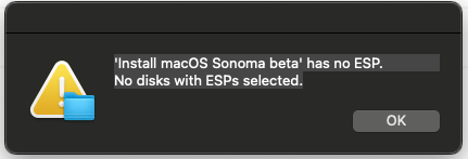

MorenoAv Posted August 18, 2023 Share Posted August 18, 2023 (edited) Hi guys good night, I have installed MacOS Sonoma beta 5, but I have some annoyances that I want to erase, my Sonoma ssd don't boot without the USB installer and after boot it takes 10 seconds with the beachball to enter after the password. For that reason I want to make a new USB installer and after trying various times the results is this picture below... Anyone knows how I solve this? Thanks Edited August 18, 2023 by MorenoAv 2 Link to comment https://www.insanelymac.com/forum/topic/356881-pre-release-macos-sonoma/page/58/#findComment-2810332 Share on other sites More sharing options...
ANTIKO Posted August 18, 2023 Share Posted August 18, 2023 (edited) 13 hours ago, MorenoAv said: Anyone knows how I solve this? You should make sure to erase the whole drive where you are going to install in APFS and GUID partition map. Disk Utility makes the EFI partition for you. Or create manually, Just go to disk utility, choose view, show all. Now, select the physical disk at the root level. Choose "partition". It will give you a warning, choose to partition anyways. Now create a 300MB partition in the format FAT (FAT32). Name it EFI. Run the operation Once you're done, place your EFI folder in the EFI partition Edit: this is not the best way to recreate an EFI partition, it's just the easiest. Edited August 18, 2023 by ANTIKO 2 Link to comment https://www.insanelymac.com/forum/topic/356881-pre-release-macos-sonoma/page/58/#findComment-2810334 Share on other sites More sharing options...

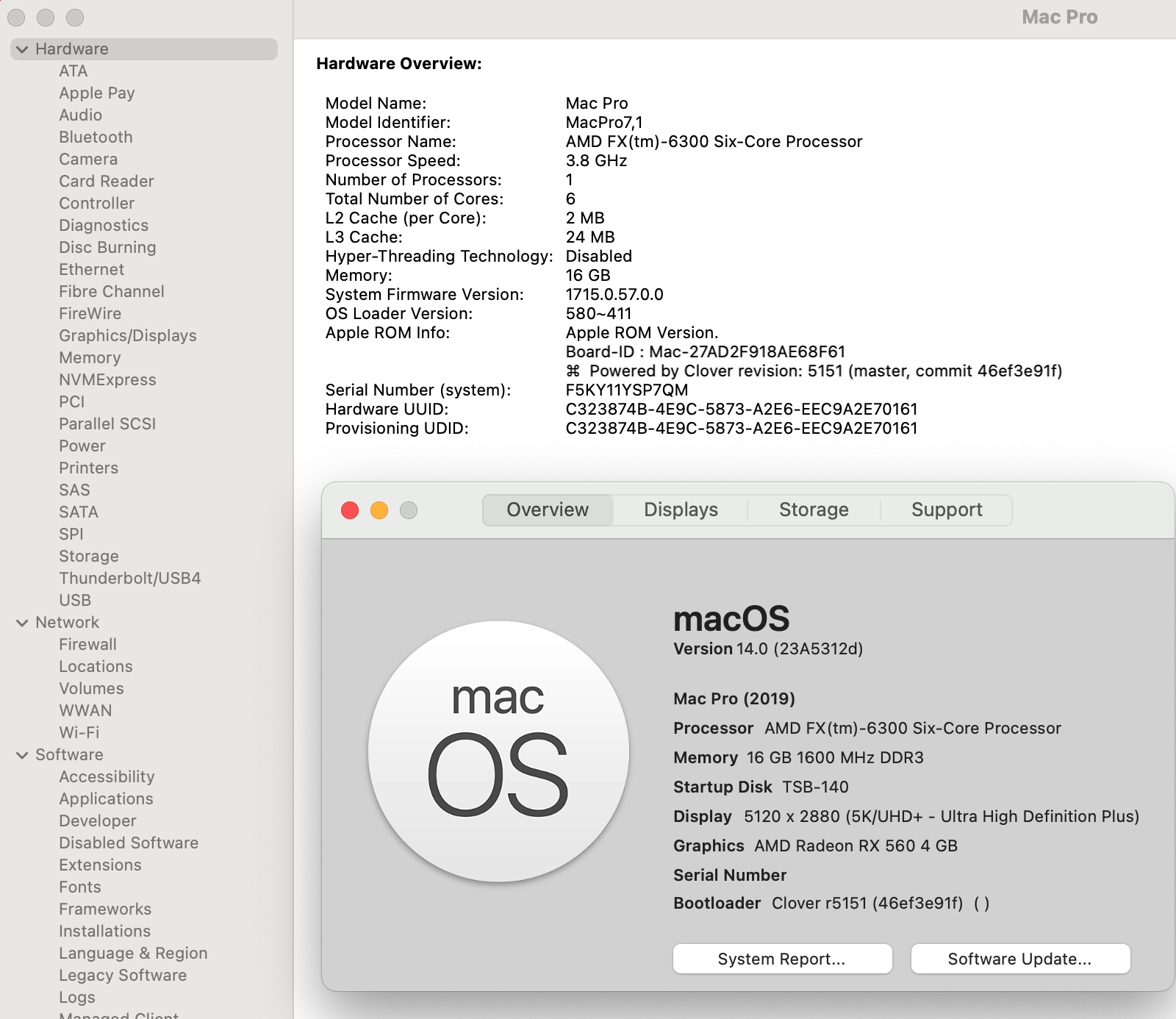

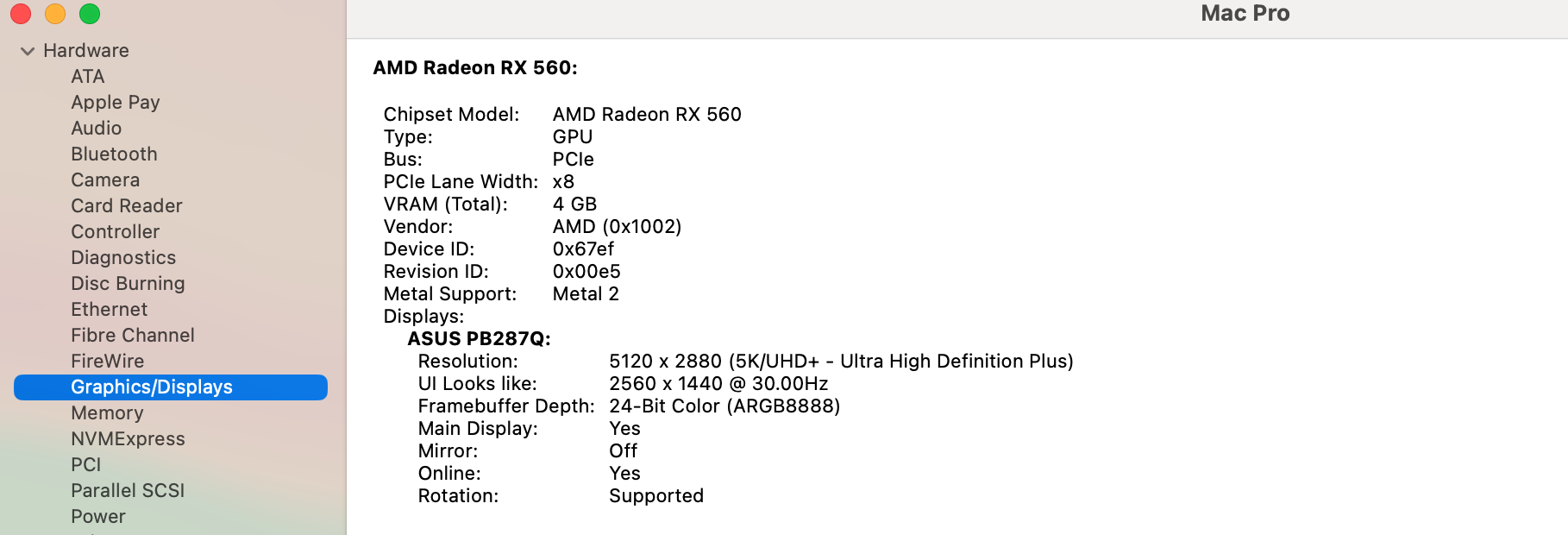

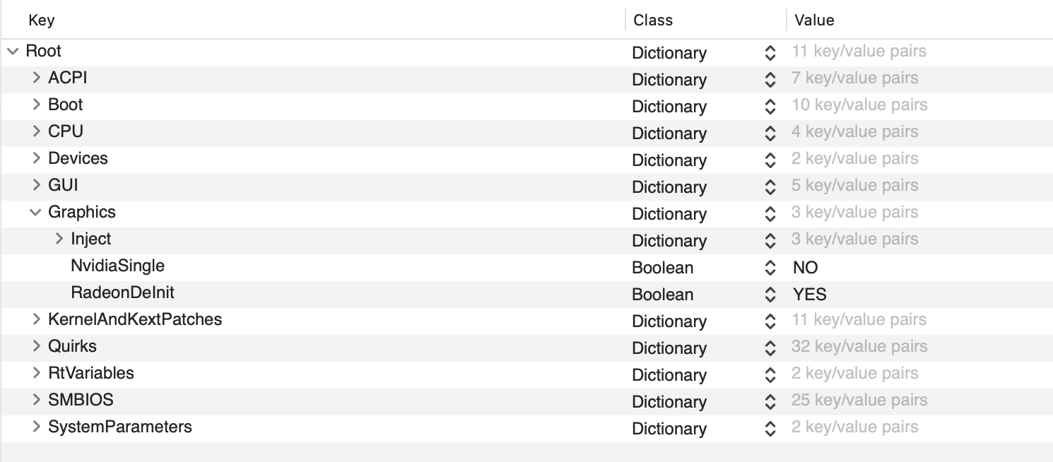

jsl2000 Posted August 19, 2023 Share Posted August 19, 2023 (edited) After many trials and errors my M5A(FX-6300) can boot Sonoma with Clover 5151 now ! The key issue is related to my GPU RX-560 which need RadeonDeInit to avoid blank screen before login desktop and also fix previous unable to wakeup from sleep issue at Ventura/Sonoma now ! config.plist Edited August 19, 2023 by jsl2000 9 Link to comment https://www.insanelymac.com/forum/topic/356881-pre-release-macos-sonoma/page/58/#findComment-2810337 Share on other sites More sharing options...
Matgen84 Posted August 19, 2023 Share Posted August 19, 2023 8 hours ago, MorenoAv said: Hi guys good night, I have installed MacOS Sonoma beta 5, but I have some annoyances that I want to erase, my Sonoma ssd don't boot without the USB installer and after boot it takes 10 seconds with the beachball to enter after the password. For that reason I want to make a new USB installer and after trying various times the results is this picture below... Anyone knows how I solve this? Thanks Hi @MorenoAv With Disk Utiliity, the USB key must be format macOS Journalized with Table Partition GUID. ESP is created automatically. 2 Link to comment https://www.insanelymac.com/forum/topic/356881-pre-release-macos-sonoma/page/58/#findComment-2810341 Share on other sites More sharing options...
