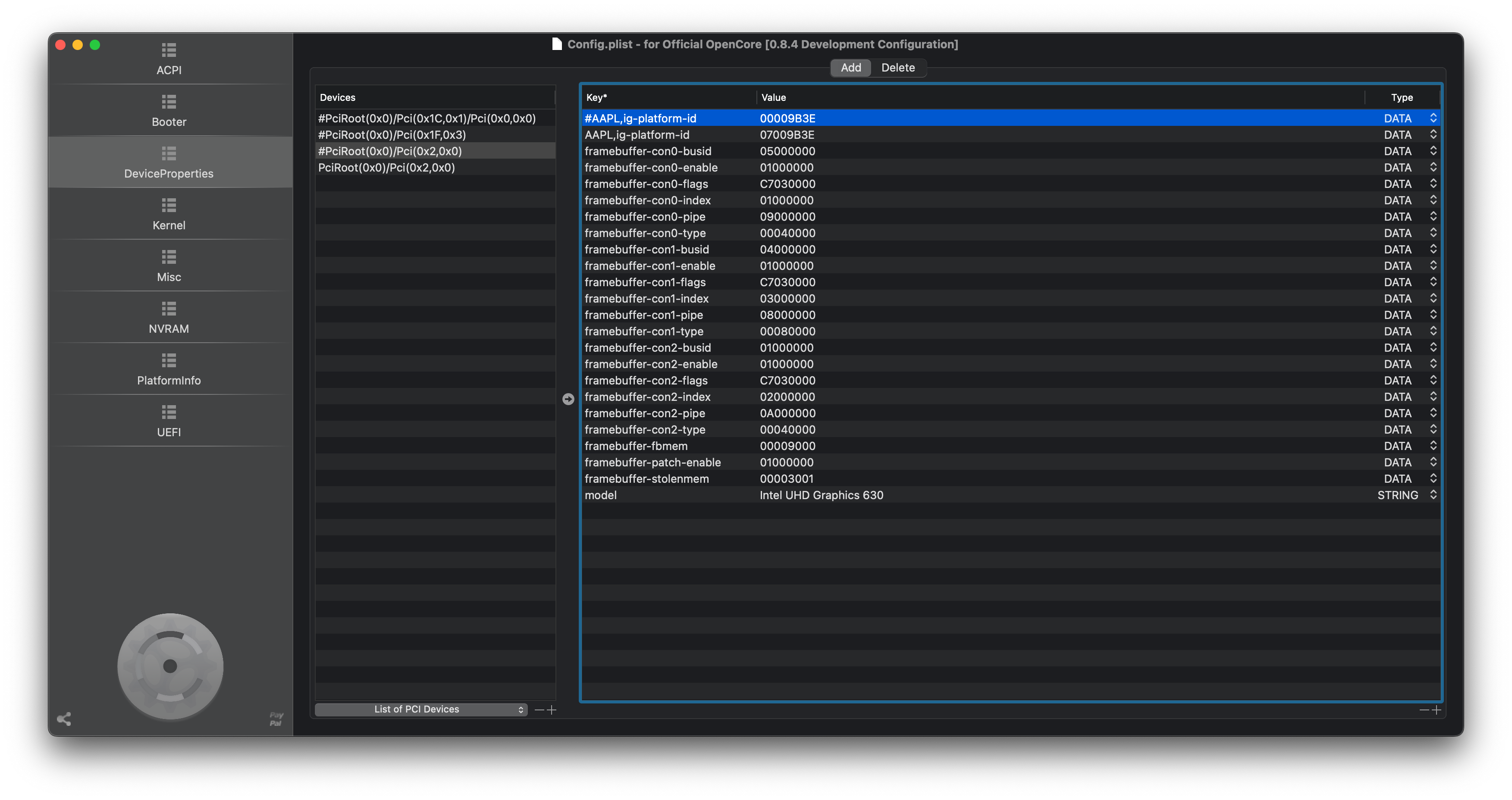

maly70 Posted August 18, 2022 Share Posted August 18, 2022 (edited) 4 hours ago, Joshua60 said: @Slice Because I only have the Framebuffers given in https://github.com/acidanthera/WhateverGreen/blob/master/Manual/FAQ.IntelHD.en.md and all have 0 connectors and Stolen memory 1MB. (0x9BC80003 0x9BC50003 0x9BC40003) They are the only Framebuffers that work but with 7MB VRAM. It's my guess but I think there is a little confusion between Coffee Lake and Comet Lake Framebuffers. hi, try 07009B3E and device id as: C89B8868 Edited August 18, 2022 by maly70 1 Link to comment https://www.insanelymac.com/forum/topic/353004-release-macos-monterey-1251/page/2/#findComment-2791632 Share on other sites More sharing options...

Joshua60 Posted August 22, 2022 Share Posted August 22, 2022 On 8/18/2022 at 4:05 PM, maly70 said: hi, try 07009B3E and device id as: C89B8868 @maly70 black screen, thank you anyway Link to comment https://www.insanelymac.com/forum/topic/353004-release-macos-monterey-1251/page/2/#findComment-2791825 Share on other sites More sharing options...
Slice Posted August 22, 2022 Share Posted August 22, 2022 On 8/18/2022 at 5:05 PM, maly70 said: hi, try 07009B3E and device id as: C89B8868 This device-id is completely wrong. Link to comment https://www.insanelymac.com/forum/topic/353004-release-macos-monterey-1251/page/2/#findComment-2791828 Share on other sites More sharing options...
Joshua60 Posted August 22, 2022 Share Posted August 22, 2022 On 8/18/2022 at 4:44 PM, Cyberdevs said: I already updated the EFI but I might have missed something, compare it to you efi and remove what's unnecessary @Cyberdevs I have tried Framebuffer: 07009B3E. Device id: 983E0000 from your EFI. Blackscreen and 0 connectors. Probably the only values that work are giving 7MB VRAM. Link to comment https://www.insanelymac.com/forum/topic/353004-release-macos-monterey-1251/page/2/#findComment-2791831 Share on other sites More sharing options...
Cyberdevs Posted August 22, 2022 Author Share Posted August 22, 2022 28 minutes ago, Joshua60 said: I have tried Framebuffer: 07009B3E. Device id: 983E0000 from your EFI. Blackscreen and 0 connectors. Probably the only values that work are giving 7MB VRAM. Try with only these settings: PciRoot(0x0)/Pci(0x2,0x0) AAPL,ig-platform-id: 0300C89B AAPL,slot-name: Built-In device_type: Display Controller model: Intel UHD Graphics 630 1 Link to comment https://www.insanelymac.com/forum/topic/353004-release-macos-monterey-1251/page/2/#findComment-2791832 Share on other sites More sharing options...
Joshua60 Posted August 22, 2022 Share Posted August 22, 2022 37 minutes ago, Cyberdevs said: Try with only these settings: PciRoot(0x0)/Pci(0x2,0x0) AAPL,ig-platform-id: 0300C89B AAPL,slot-name: Built-In device_type: Display Controller model: Intel UHD Graphics 630 @Cyberdevs the system does not boot. It already happens if I remember right. Link to comment https://www.insanelymac.com/forum/topic/353004-release-macos-monterey-1251/page/2/#findComment-2791834 Share on other sites More sharing options...
Cyberdevs Posted August 22, 2022 Author Share Posted August 22, 2022 Well that's weird, nothing seems to work on your rig. 1 Link to comment https://www.insanelymac.com/forum/topic/353004-release-macos-monterey-1251/page/2/#findComment-2791835 Share on other sites More sharing options...
Joshua60 Posted August 22, 2022 Share Posted August 22, 2022 (edited) 1 hour ago, Cyberdevs said: Well that's weird, nothing seems to work on your rig. As far as I understand you need 'framebuffer-patch-enable <01000000> ' according to the OC Guide. But nevermind I think there is no solution for that problem. Thank you so much for your support. Edited August 22, 2022 by Joshua60 1 Link to comment https://www.insanelymac.com/forum/topic/353004-release-macos-monterey-1251/page/2/#findComment-2791838 Share on other sites More sharing options...
Cyberdevs Posted August 22, 2022 Author Share Posted August 22, 2022 You're welcome. As I understand there are few people that succeeded with the same board, but what I don't understand is why isn't yours working. Take a look at these posts: https://github.com/Twixes/Hackintosh-Intel-i7-10700K-Gigabyte-Z490-Vision-D https://gitee.com/softxing/Hackintosh-Intel-i7-10700k-Gigabyte-Z490-Vision-G Although they are using Gigabyte boards but they have successfully installed Big Sur and if you want to use their EFI folders you need to make some changes and update OC and kexts. You can use OC Auxiliary Tool to update them easily. For instance if you see the attached config under #PciRoot(0x0)/Pci(0x2,0x0) (# symbol disables the entry by the way so it won't work you need to remove the # before any entry for it to be activated) there are all sort of connector and framebuffer data. Config.plist 1 Link to comment https://www.insanelymac.com/forum/topic/353004-release-macos-monterey-1251/page/2/#findComment-2791839 Share on other sites More sharing options...
Anto65 Posted August 23, 2022 Share Posted August 23, 2022 @Joshua60 If you want to try (2 configurations) add the Framebuffer in PciRoot (0x0) / Pci (0x2,0x0) Comet-Dev-DeviceProperties.zip 1 1 Link to comment https://www.insanelymac.com/forum/topic/353004-release-macos-monterey-1251/page/2/#findComment-2791882 Share on other sites More sharing options...
Joshua60 Posted August 23, 2022 Share Posted August 23, 2022 (edited) 20 hours ago, Cyberdevs said: You're welcome. As I understand there are few people that succeeded with the same board, but what I don't understand is why isn't yours working. Take a look at these posts: https://github.com/Twixes/Hackintosh-Intel-i7-10700K-Gigabyte-Z490-Vision-D https://gitee.com/softxing/Hackintosh-Intel-i7-10700k-Gigabyte-Z490-Vision-G Although they are using Gigabyte boards but they have successfully installed Big Sur and if you want to use their EFI folders you need to make some changes and update OC and kexts. You can use OC Auxiliary Tool to update them easily. For instance if you see the attached config under #PciRoot(0x0)/Pci(0x2,0x0) (# symbol disables the entry by the way so it won't work you need to remove the # before any entry for it to be activated) there are all sort of connector and framebuffer data. Config.plist 23.61 kB · 2 downloads @Cyberdevs I took a look at the config you attached. I already try this framebuffer 0300C89B. The system works but with 7MB VRAM. It works correctly according to the OC guide. I've looked at your first link. It use iMac20,2 system. My system is set to iMac20,1. Edited August 23, 2022 by Joshua60 Link to comment https://www.insanelymac.com/forum/topic/353004-release-macos-monterey-1251/page/2/#findComment-2791883 Share on other sites More sharing options...
Slice Posted August 23, 2022 Share Posted August 23, 2022 2 minutes ago, Joshua60 said: @Cyberdevs I took a look at the config you attached. I already try this framebuffer 0300C89B. The system works but with 7MB VRAM. It works correctly according to the OC guide. You will get 7mb also with framebuffer like 12345678. 1 Link to comment https://www.insanelymac.com/forum/topic/353004-release-macos-monterey-1251/page/2/#findComment-2791884 Share on other sites More sharing options...

JorgeMax Posted August 23, 2022 Share Posted August 23, 2022 Some things I've been analyzing here about the iGPU using a motherboard with the B360 chipset: I used an ASUS TUF B360 PLUS GAMING. In it there was only the option "Pre-Allocated DVMT". I made changes to values and none worked, I always went to a black screen with no signal on the monitor. I went to do some research and saw that the key "DVMT Total Gfx Mem" that I didn't have on my board could be missing. I dumped her bios, took a tool that "opens" the bios and navigated through the sections until I got where these keys were for the integrated video, ASUS removed this key "DVMT Total Gfx Mem". But there was a hidden key for the user to change, which was the "Aperture Size" and it was fixed at 256MB. I got it and gave up activating the iGPU on this motherboard. A while passed and my video card was a problem, what I did I bought a motherboard from Gigabyte GA-B360M-AORUS-GAMING. In addition to the "Pre-Allocated DVMT", there were also the other two keys that on the ASUS card I did not have. Testing, leaving "DVMT Pre-Allocated" at 64MB, "DVMT Total Gfx Mem" at "MAX" and "Aperture Size" at 256MB (I also tested the values above 256MB, the same result). There was no video signal after the first boot stage of the system, it was to change the "Aperture Size" to 128MB, then I had the video signal and arrived on desktop (table). But I couldn't get acceleration, it was always at 7MB. I tried all the framebuffers. Somehow this "Aperture size" is what gets in the way. 1 Link to comment https://www.insanelymac.com/forum/topic/353004-release-macos-monterey-1251/page/2/#findComment-2791893 Share on other sites More sharing options...
Joshua60 Posted August 23, 2022 Share Posted August 23, 2022 3 hours ago, antuneddu said: @Joshua60 If you want to try (2 configurations) add the Framebuffer in PciRoot (0x0) / Pci (0x2,0x0) Comet-Dev-DeviceProperties.zip 2.55 kB · 4 downloads @antuneddu <0300C89B> works but ... 7MB thank you so much Link to comment https://www.insanelymac.com/forum/topic/353004-release-macos-monterey-1251/page/2/#findComment-2791894 Share on other sites More sharing options...

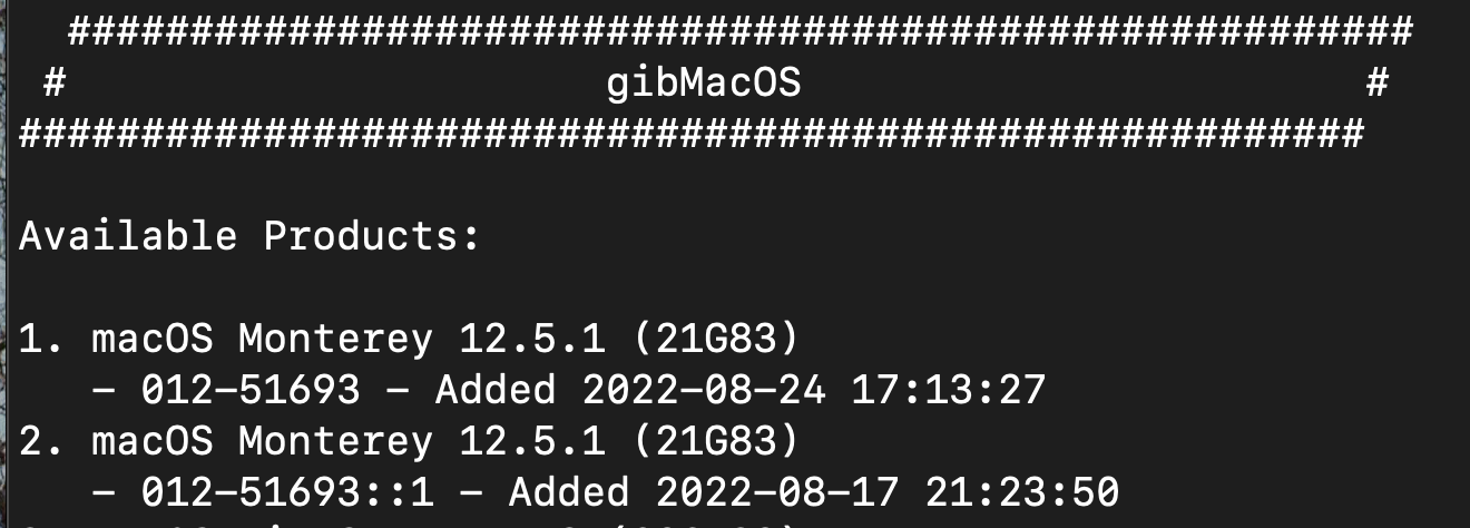

Henties Posted August 26, 2022 Share Posted August 26, 2022 (edited) In the regular release section of "gibMacOS" there are 2 download options for Monterey 12.5.1 (21G83), one dated 17.08.2022 and the other dated 24.08.2022, entered a week later. My question is: Are these 2 entries identical, "code wise", or not. Hoping somebody can shed some light on this, what seems to be a rather confusing anomaly, at least to me. A screenshot has been attached to highlight the confusing entries in gibMacOS. Your comments as to what has likely been happening here will be appreciated. Greetings Henties Edited August 26, 2022 by Henties Link to comment https://www.insanelymac.com/forum/topic/353004-release-macos-monterey-1251/page/2/#findComment-2792060 Share on other sites More sharing options...
Cyberdevs Posted August 26, 2022 Author Share Posted August 26, 2022 @Henties I'm not sure what's the difference between those two files but Apple just released a TimeZone Update on all devices couple of days ago and that might be reason for those different files. I might be wrong tho. 1 Link to comment https://www.insanelymac.com/forum/topic/353004-release-macos-monterey-1251/page/2/#findComment-2792062 Share on other sites More sharing options...
Henties Posted August 26, 2022 Share Posted August 26, 2022 Whow @Cyberdevs your response was indeed lightning fast, thank you for that, much appreciated indeed. I am all of a sudden getting "time difference" notifications" originating from the "Private Cloud Services" I set up for myself under Monterey, I have therefore, based on your "hunch", decided to also download the later version of Monterey 12.5.1 (21G83) and see what happens and also compare the 2 releases, differing only in their time stamp, with my favourite file comparison utility. Should the 2 Monterey versions indeed differ "codewise" then Apple may well be "slipstreaming" updated code, which is not really an ethical act to indulge in by any reputable software pedlar. Greetings Henties Link to comment https://www.insanelymac.com/forum/topic/353004-release-macos-monterey-1251/page/2/#findComment-2792065 Share on other sites More sharing options...
Cyberdevs Posted August 26, 2022 Author Share Posted August 26, 2022 @Henties You're welcome I checked the App Store and the installer is from a week ago so they haven't updated the App Store yet which begs the question why there's another installer available in the catalog! Link to comment https://www.insanelymac.com/forum/topic/353004-release-macos-monterey-1251/page/2/#findComment-2792068 Share on other sites More sharing options...
Henties Posted August 27, 2022 Share Posted August 27, 2022 @Cyberdevs I just made a size comparison between the Monterey 12.5.1 (21G83) installer dated 17.08.2022 and Monterey 12.5.1 (21G83) dated 24.08.2022 the latter being 200 kilobytes larger in size with both being available as public download options through gibMacOS. If this was intentional by Apple then one can only classify this as "slipstreaming" new code, I am now rather perturbed because this kind of practice is just not tolerable. Imagine a huge company, with hundreds of machines, have two macOS opsyses running, completely equal as far as their Version numbers are concerned, but with different code bases, who would be able support such a mess ? Greetings Henties Link to comment https://www.insanelymac.com/forum/topic/353004-release-macos-monterey-1251/page/2/#findComment-2792088 Share on other sites More sharing options...
