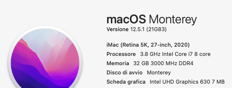

Joshua60 Posted August 18, 2022 Share Posted August 18, 2022 (edited) Installation went fine, but with possible issue VRAM is 7 MB, I did some searching. The meaning is 'no graphic acceleration, VRAM 7MB and solid background for dock'. See Comet Lake laptop device properties here. My rig is a Desktop Comet Lake and I tried all Framebuffers but with the same result (VRAM 7 MB). (0x9BC80003 0x9BC50003 0x9BC40003) All three are empty Framebuffers so it make sense to me. I don't know if that is a real issue. Edited August 18, 2022 by Joshua60 Link to comment https://www.insanelymac.com/forum/topic/353004-release-macos-monterey-1251/#findComment-2791604 Share on other sites More sharing options...
Cyberdevs Posted August 18, 2022 Author Share Posted August 18, 2022 @Joshua60 Try these settings: ig-platform-id: 0900A53E or 9BC5003 without the 0x 1 Link to comment https://www.insanelymac.com/forum/topic/353004-release-macos-monterey-1251/#findComment-2791607 Share on other sites More sharing options...
Joshua60 Posted August 18, 2022 Share Posted August 18, 2022 @Cyberdevs Tried but both fail, they even boot. I forgot to mention that I have 'device-id=<C59B0000>'. Link to comment https://www.insanelymac.com/forum/topic/353004-release-macos-monterey-1251/#findComment-2791609 Share on other sites More sharing options...
Cyberdevs Posted August 18, 2022 Author Share Posted August 18, 2022 @Joshua60 What about these settings: ig-platform-id: 07009B3E device-id: 983E0000 Look at this config it's from a rig with 10700K CPU and the UHD630 iGPU config.plist 2 1 Link to comment https://www.insanelymac.com/forum/topic/353004-release-macos-monterey-1251/#findComment-2791610 Share on other sites More sharing options...
Slice Posted August 18, 2022 Share Posted August 18, 2022 1 hour ago, Joshua60 said: Installation went fine, but with possible issue VRAM is 7 MB, I did some searching. The meaning is 'no graphic acceleration, VRAM 7MB and solid background for dock'. See Comet Lake laptop device properties here. My rig is a Desktop Comet Lake and I tried all Framebuffers but with the same result (VRAM 7 MB). (0x9BC80003 0x9BC50003 0x9BC40003) All three are empty Framebuffers so it make sense to me. I don't know if that is a real issue. Why you set empty framebuffer if this is your only videocard? You need a framebuffer with connectors! 2 Link to comment https://www.insanelymac.com/forum/topic/353004-release-macos-monterey-1251/#findComment-2791611 Share on other sites More sharing options...
Joshua60 Posted August 18, 2022 Share Posted August 18, 2022 @Cyberdevs Same result as before. I will look deeper in the config maybe there is something I missed. Thank you so much for your help. Link to comment https://www.insanelymac.com/forum/topic/353004-release-macos-monterey-1251/#findComment-2791612 Share on other sites More sharing options...
Joshua60 Posted August 18, 2022 Share Posted August 18, 2022 (edited) @Slice Because I only have the Framebuffers given in https://github.com/acidanthera/WhateverGreen/blob/master/Manual/FAQ.IntelHD.en.md and all have 0 connectors and Stolen memory 1MB. (0x9BC80003 0x9BC50003 0x9BC40003) They are the only Framebuffers that work but with 7MB VRAM. It's my guess but I think there is a little confusion between Coffee Lake and Comet Lake Framebuffers. Edited August 18, 2022 by Joshua60 Link to comment https://www.insanelymac.com/forum/topic/353004-release-macos-monterey-1251/#findComment-2791613 Share on other sites More sharing options...
Joshua60 Posted August 18, 2022 Share Posted August 18, 2022 @Cyberdevs Attached my config.plist for your information. config.plist Link to comment https://www.insanelymac.com/forum/topic/353004-release-macos-monterey-1251/#findComment-2791614 Share on other sites More sharing options...

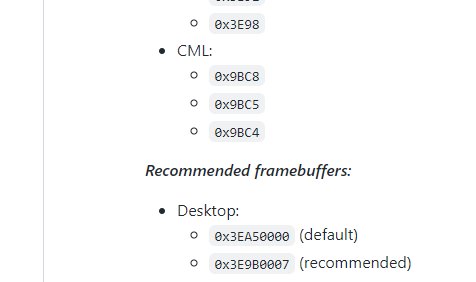

Cyberdevs Posted August 18, 2022 Author Share Posted August 18, 2022 @Joshua60 I just added the settings from the config i sent you to your config give it a try and let me know. Sadly I have no comet lake rig to test it out myself. config.plist 1 1 Link to comment https://www.insanelymac.com/forum/topic/353004-release-macos-monterey-1251/#findComment-2791616 Share on other sites More sharing options...
Slice Posted August 18, 2022 Share Posted August 18, 2022 51 minutes ago, Joshua60 said: @Slice Because I only have the Framebuffers given in https://github.com/acidanthera/WhateverGreen/blob/master/Manual/FAQ.IntelHD.en.md and all have 0 connectors and Stolen memory 1MB. (0x9BC80003 0x9BC50003 0x9BC40003) They are the only Framebuffers that work but with 7MB VRAM. It's my guess but I think there is a little confusion between Coffee Lake and Comet Lake Framebuffers. From the link you provided 4 Link to comment https://www.insanelymac.com/forum/topic/353004-release-macos-monterey-1251/#findComment-2791619 Share on other sites More sharing options...
Joshua60 Posted August 18, 2022 Share Posted August 18, 2022 @Cyberdevs It behaves the same like it does for me. No boot, start the next system in line. Maybe it's my rig? or something else. Thanks anyway for your precious help. Link to comment https://www.insanelymac.com/forum/topic/353004-release-macos-monterey-1251/#findComment-2791624 Share on other sites More sharing options...
Joshua60 Posted August 18, 2022 Share Posted August 18, 2022 @Slice Yes exactly what I meant. The recommended Framebuffers doesn't work for me. Maybe they are for Coffee Lake. Thanks so much for your professional help. Link to comment https://www.insanelymac.com/forum/topic/353004-release-macos-monterey-1251/#findComment-2791625 Share on other sites More sharing options...
Cyberdevs Posted August 18, 2022 Author Share Posted August 18, 2022 I think it's a misconfiguration. look at this page and try to boot using this EFI folder. just don't replace yours with this one use another USB to from https://github.com/AutismSuperman/Hackintosh-ASUS-Z490-P-i7-10700K-UHD630 2 Link to comment https://www.insanelymac.com/forum/topic/353004-release-macos-monterey-1251/#findComment-2791626 Share on other sites More sharing options...

Joshua60 Posted August 18, 2022 Share Posted August 18, 2022 (edited) @Cyberdevs I did what you asked me to do. Other USB plus clean EFI and the boot stop at: OC: Driver ResetNvramEntry.efi at 4 cannot be found. Halting on critical error. Maybe it might help? Edited August 18, 2022 by Joshua60 Link to comment https://www.insanelymac.com/forum/topic/353004-release-macos-monterey-1251/#findComment-2791629 Share on other sites More sharing options...
miliuco Posted August 18, 2022 Share Posted August 18, 2022 @Joshua60 Easy. Config.plist has this driver enabled but it doesn't exist in the Drivers folder. Set the driver Enabled=False in config.plist or add it to the Drivers folder. 3 Link to comment https://www.insanelymac.com/forum/topic/353004-release-macos-monterey-1251/#findComment-2791630 Share on other sites More sharing options...
