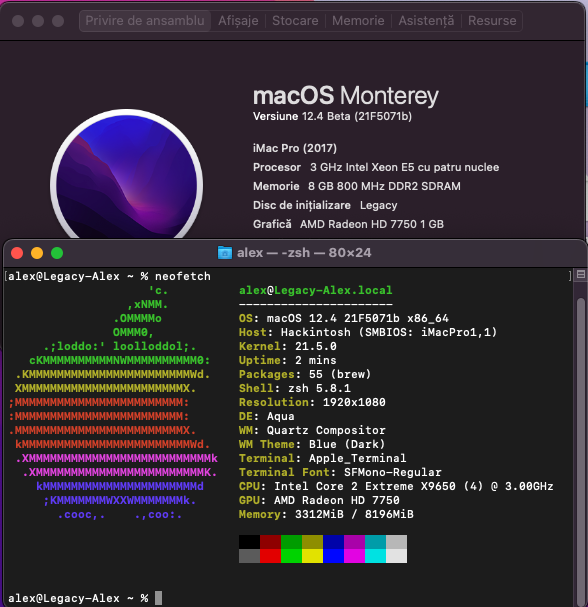

Stefanalmare Posted May 8, 2022 Share Posted May 8, 2022 12 hours ago, PoMpIs said: Today I tried Monterey beta on an old computer 😁 Spoiler Older then this? 😀 5 Link to comment https://www.insanelymac.com/forum/topic/351357-pre-release-macos-monterey-124/page/3/#findComment-2781962 Share on other sites More sharing options...
jsl2000 Posted May 8, 2022 Share Posted May 8, 2022 (edited) 43 minutes ago, Stefanalmare said: Older then this? 😀 Is this a LGA 775 hackintosh ? My ASUS P5Q PRO & P6TSE hackintoshs need set csr to 00000000 in legacy OpenCore 0.7.9 otherwise Firefox or Google Chrome will hang on open. Did you have the same issue at Monterey ? Edited May 8, 2022 by jsl2000 Link to comment https://www.insanelymac.com/forum/topic/351357-pre-release-macos-monterey-124/page/3/#findComment-2781964 Share on other sites More sharing options...
Stefanalmare Posted May 8, 2022 Share Posted May 8, 2022 41 minutes ago, jsl2000 said: Is this a LGA 775 hackintosh ? My ASUS P5Q PRO & P6TSE hackintoshs need set csr to 00000000 in legacy OpenCore 0.7.9 otherwise Firefox or Google Chrome will hang on open. Did you have the same issue at Monterey ? Yep, LGA 775. I have no issue with this configuration. But I played around with ASUS P5Q (non PRO) and it was fully functional with Monterey, less sleep. No metter what I tried, the machine doesn't sleep. So I transformed that machine into a TrueNAS. I attach the OpenCore and Clover EFI's for P5Q, maybe will help you. Arhivă.zip 2 Link to comment https://www.insanelymac.com/forum/topic/351357-pre-release-macos-monterey-124/page/3/#findComment-2781965 Share on other sites More sharing options...

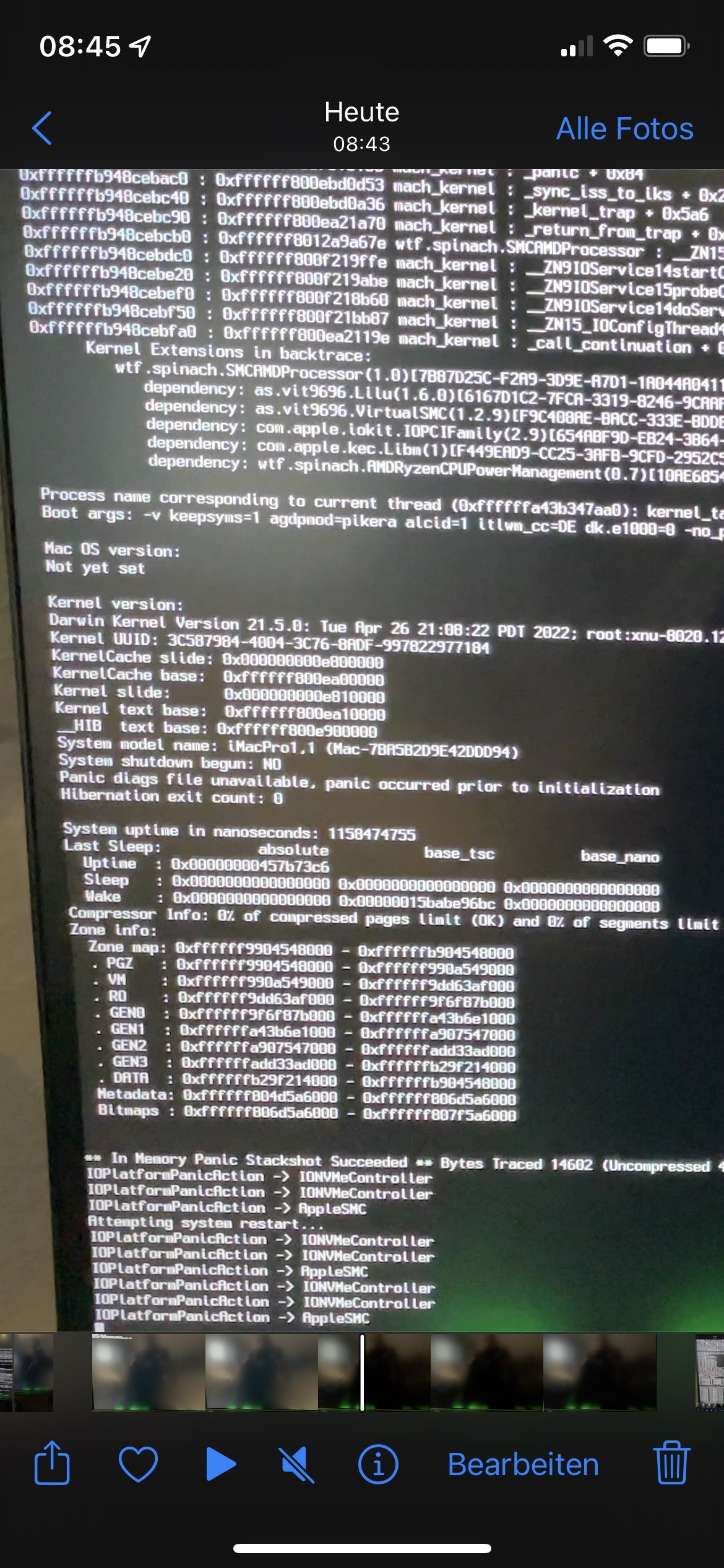

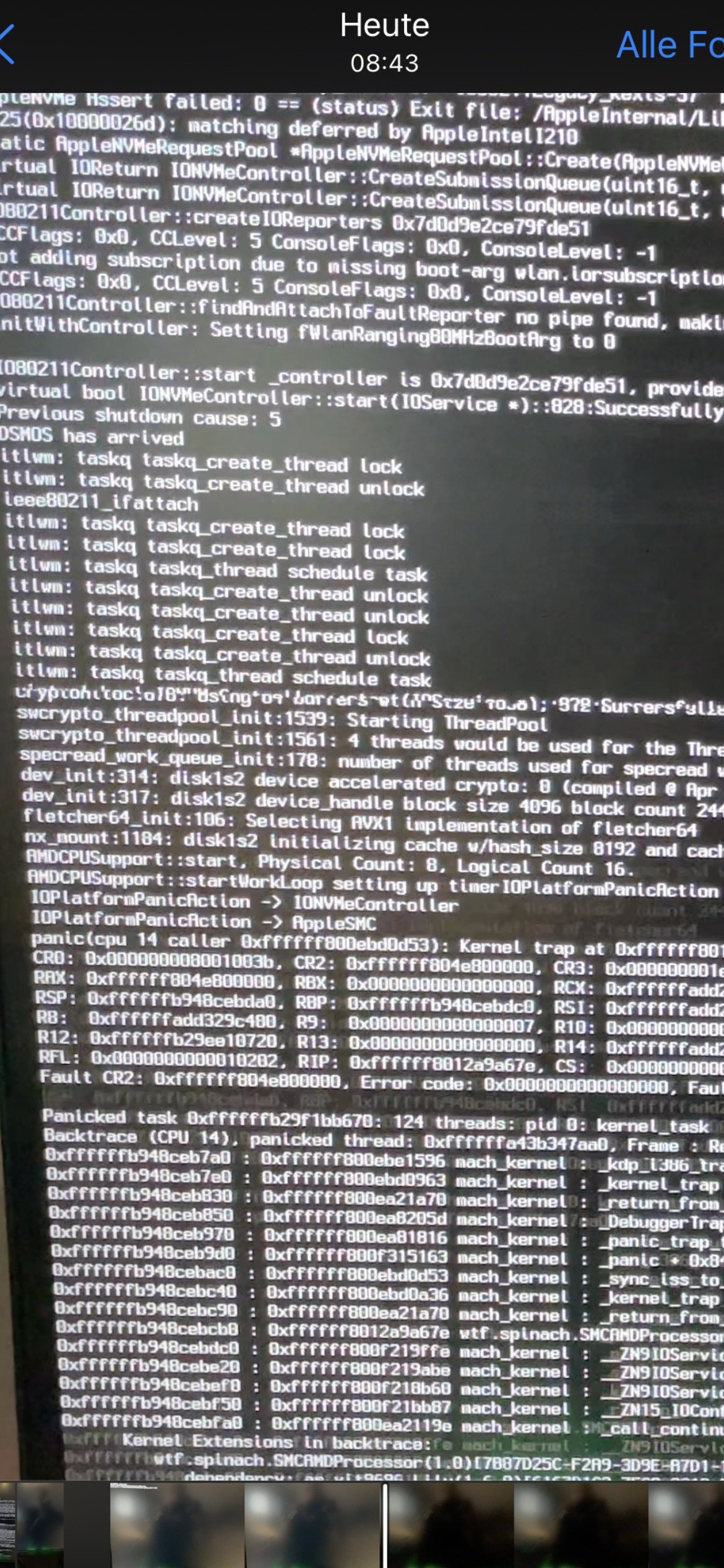

spacepilot3000 Posted May 13, 2022 Share Posted May 13, 2022 I have a massive problem on my ryzentosh with 12.4RC and the betas. EFI on 12.3.1 on OC 0.8.1 is working fine. On first reboot after update start to 12.4 I get a kernel panic boot loop on IONVME, AppleSMC stage. I tried the dk.e1000=0 setting read before without change. Updated kexts, disabled NVMEfix for test... no change... Any idea here? Link to comment https://www.insanelymac.com/forum/topic/351357-pre-release-macos-monterey-124/page/3/#findComment-2782236 Share on other sites More sharing options...
Slice Posted May 13, 2022 Share Posted May 13, 2022 I see the panic with SMCAMDProcessor. What if you exclude it? 2 Link to comment https://www.insanelymac.com/forum/topic/351357-pre-release-macos-monterey-124/page/3/#findComment-2782237 Share on other sites More sharing options...
spacepilot3000 Posted May 13, 2022 Share Posted May 13, 2022 2 hours ago, Slice said: I see the panic with SMCAMDProcessor. What if you exclude it? Wow, a first step. THANKS! I removed it and got further. I now get another crash much later. After booting back to 12.3.1 now, the system wants do "redo" the 12.4 update... waiting for first reboot. Okay. I had to disable SMCAMDProcessor AND reload the whole update process. NOW I am on 12.4. THANK you for the golden hint! 1 Link to comment https://www.insanelymac.com/forum/topic/351357-pre-release-macos-monterey-124/page/3/#findComment-2782238 Share on other sites More sharing options...
