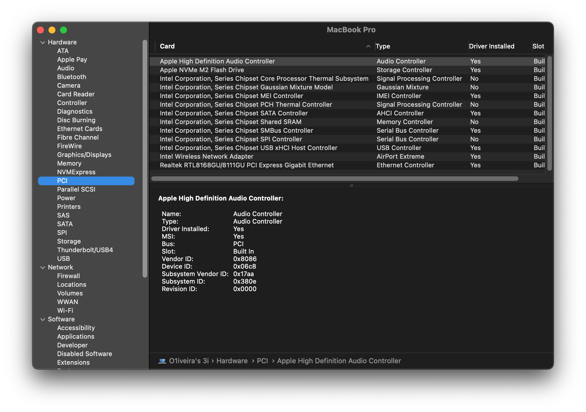

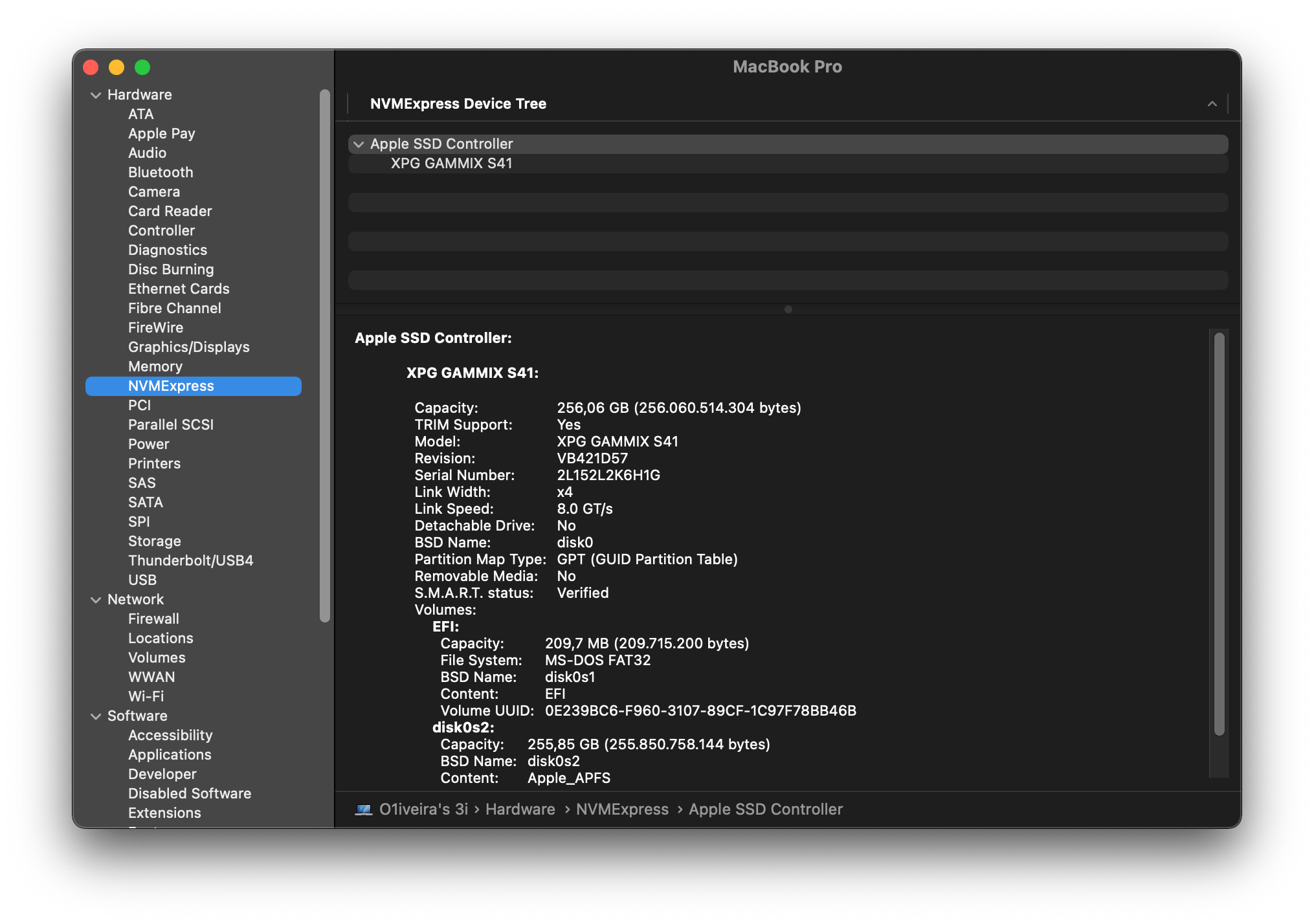

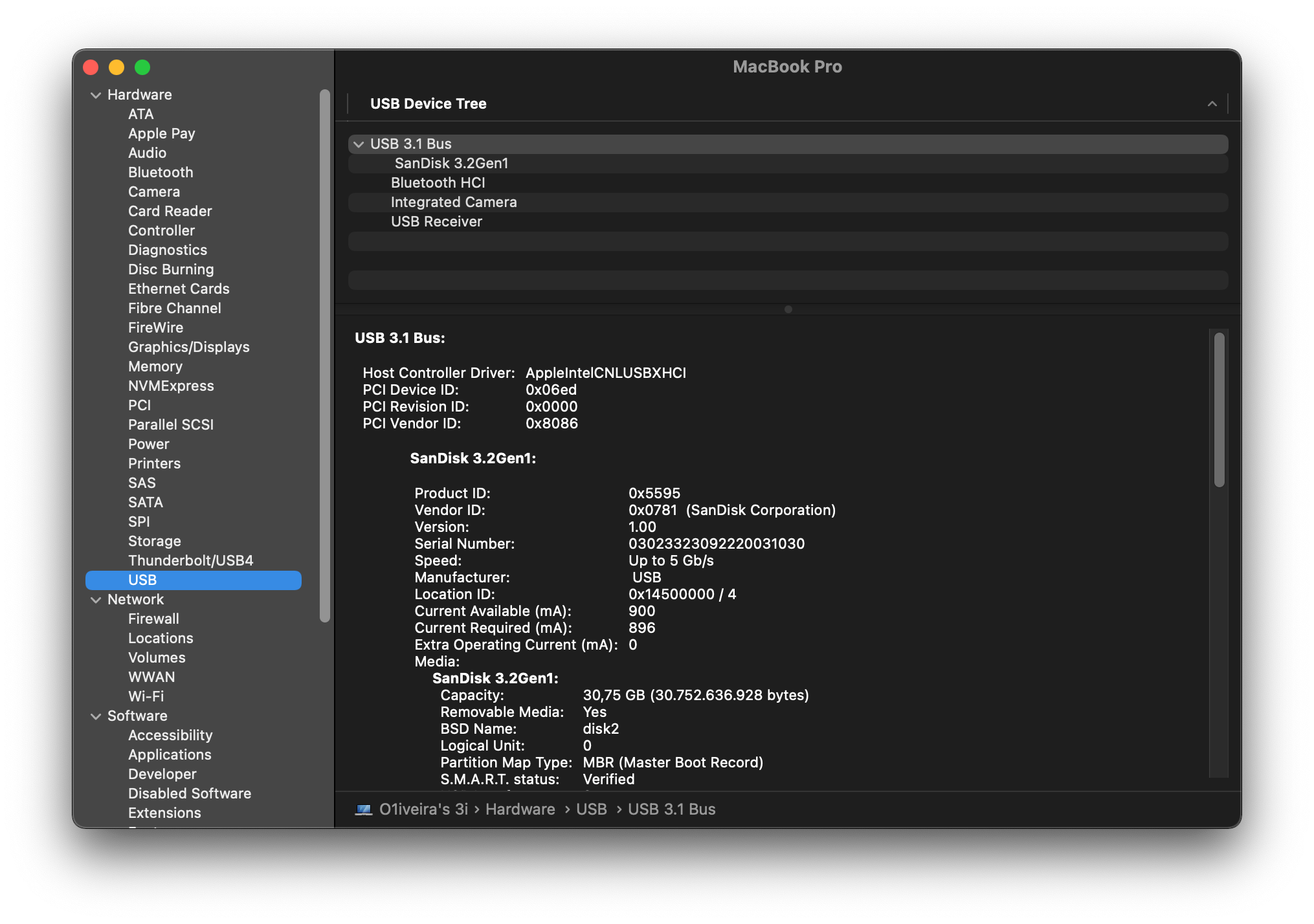

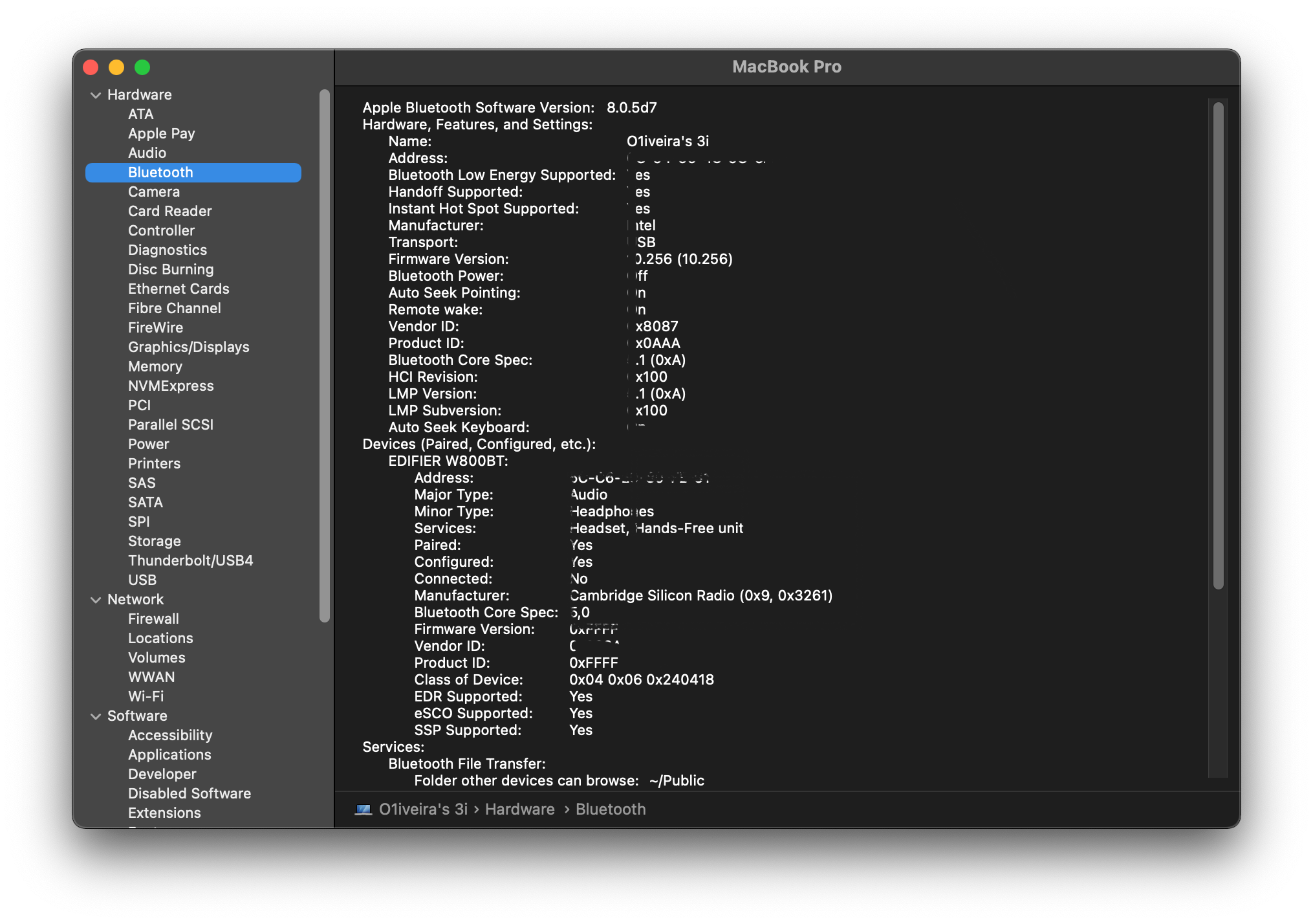

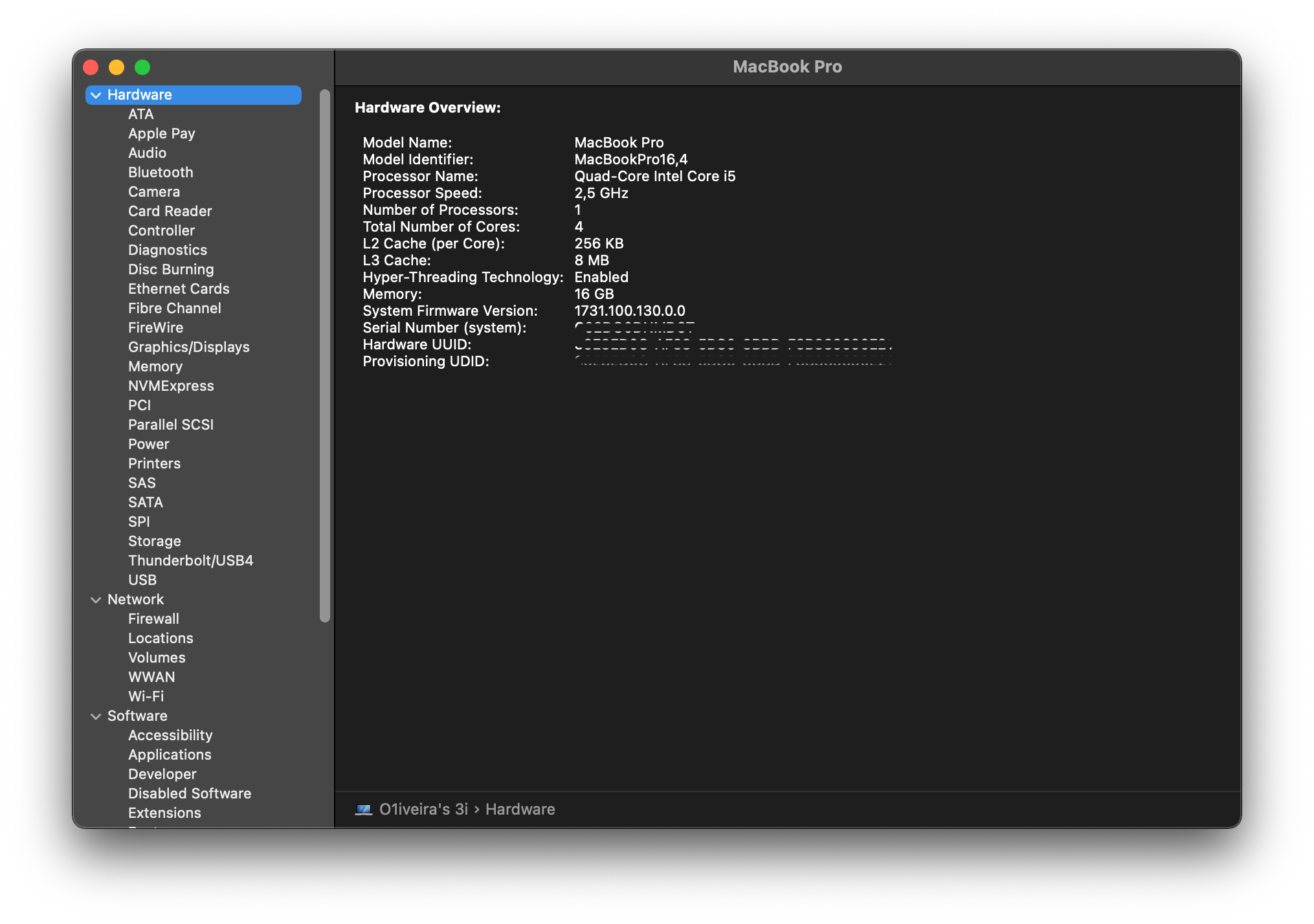

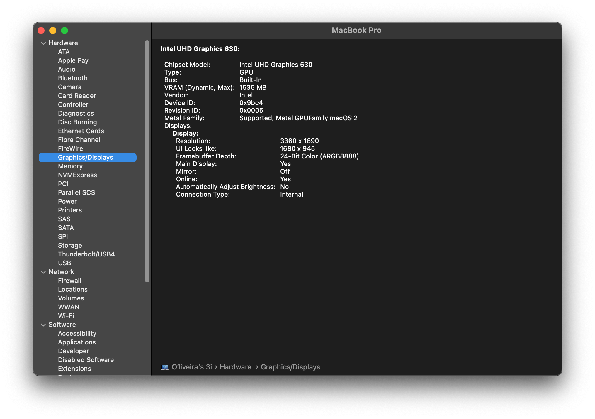

Allan Posted April 5, 2022 Share Posted April 5, 2022     Hello guys! New laptop in da house! 🤩  Specifications:    BIOS Version: EGCN36WW (Latest)    Intel 10th gen i5-10300H, 4.50 GHz - (Comet Lake)    Integrated Intel UHD630    15" 1920x1080 Full-HD IPS - To get a nice screen resolution, I recommend the one-key-hidpi script by @xzhih    16 (2x8) DDR4-2933 RAM (Up to 32GB)    2x M.2 2280 PCIe Gen3x4 256GB    RTL8168GU/8111GU Gigabit Ethernet    Fn keys and keyboard backlight    Touchpad with all the gestures    Realtek ALC255    Intel WiFi - AC    Intel Bluetooth 5.0    Integrated WecCam 720p HD    1 x 3.5mm universal jack (combo audio)    1x USB Type C port 3.1    2x USB 3.1 ports    1 x HDMI port  Working: All the components above!!  Not working, and never will dGPU - GTX 1650 4GB HDMI port - it's integrated to Nvidia card   Methods used: To install macOS: Hackintosh Guide - Install MacOS with Olarila Image, Step by Step, Install and Post Install, Windows or Mac To activate my WiFi: OpenIntelWireless Full DSDT patches: DSDT patch requests To get dual-boot with OpenCore (each OS at their own SSD), I'm using this: OpenCore_NO_ACPI Look here how to use it: OpenCore_NO_ACPI - Opencore with additional features/changes implemented  Screenshots:  Credits: @MaLd0n as always helping me with the DSDT and keep my Hack stable as a real Mac! @headkaze with his awesome Hackintool app also.  And I'm thank all the community to get this machice working, the OpenCore and Clover guys.  Your hard work guys, will be always appreciate by me.  👇 My full dump with DSDT patched - OpenCore 0.8.0  Full Dump O1iveiras-3i.zip    3 1 Link to comment https://www.insanelymac.com/forum/topic/351348-guide-ideapad-gaming-3i-i5-10300h-opencore-monterey-and-windows/ Share on other sites More sharing options...
