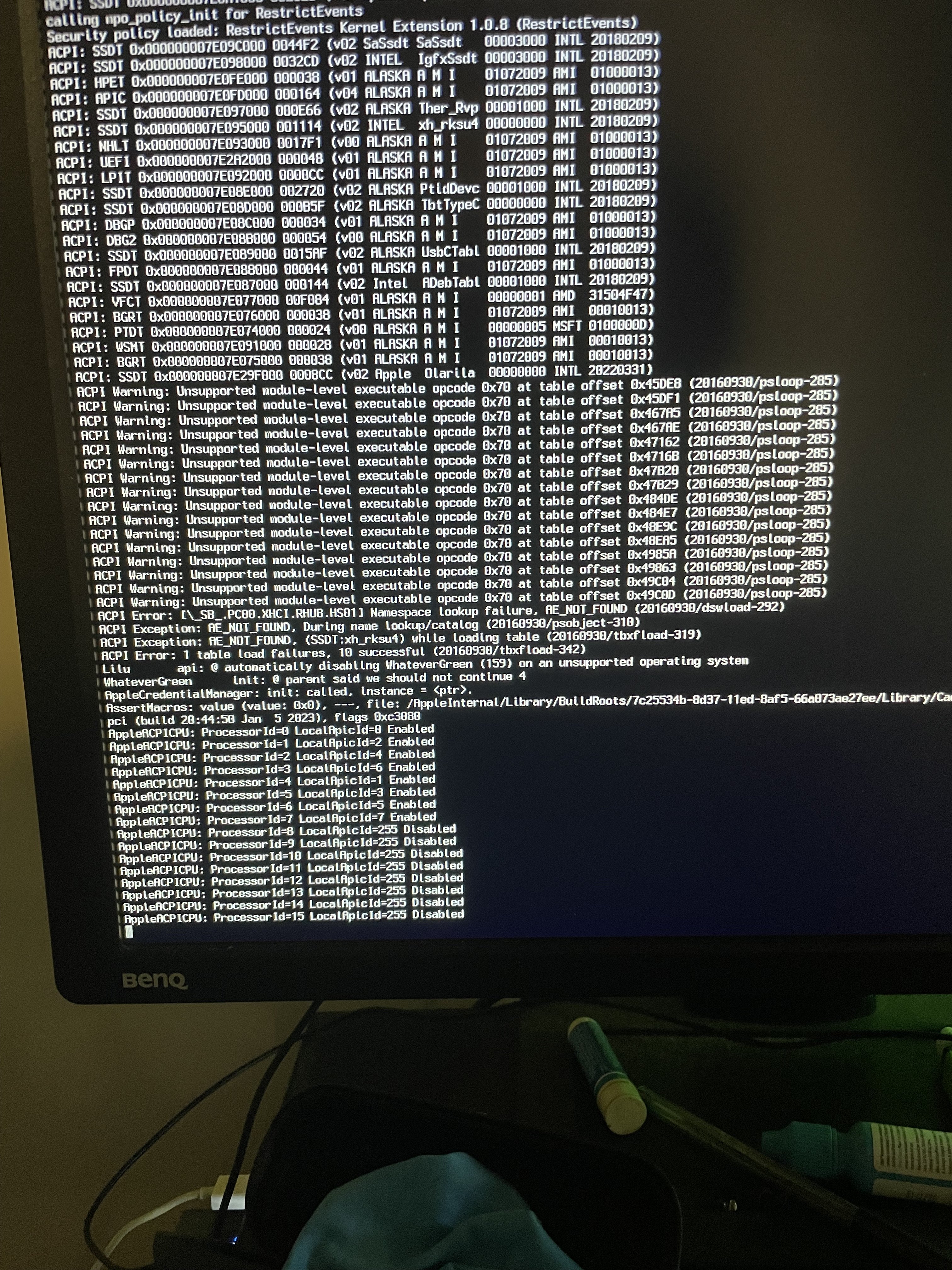

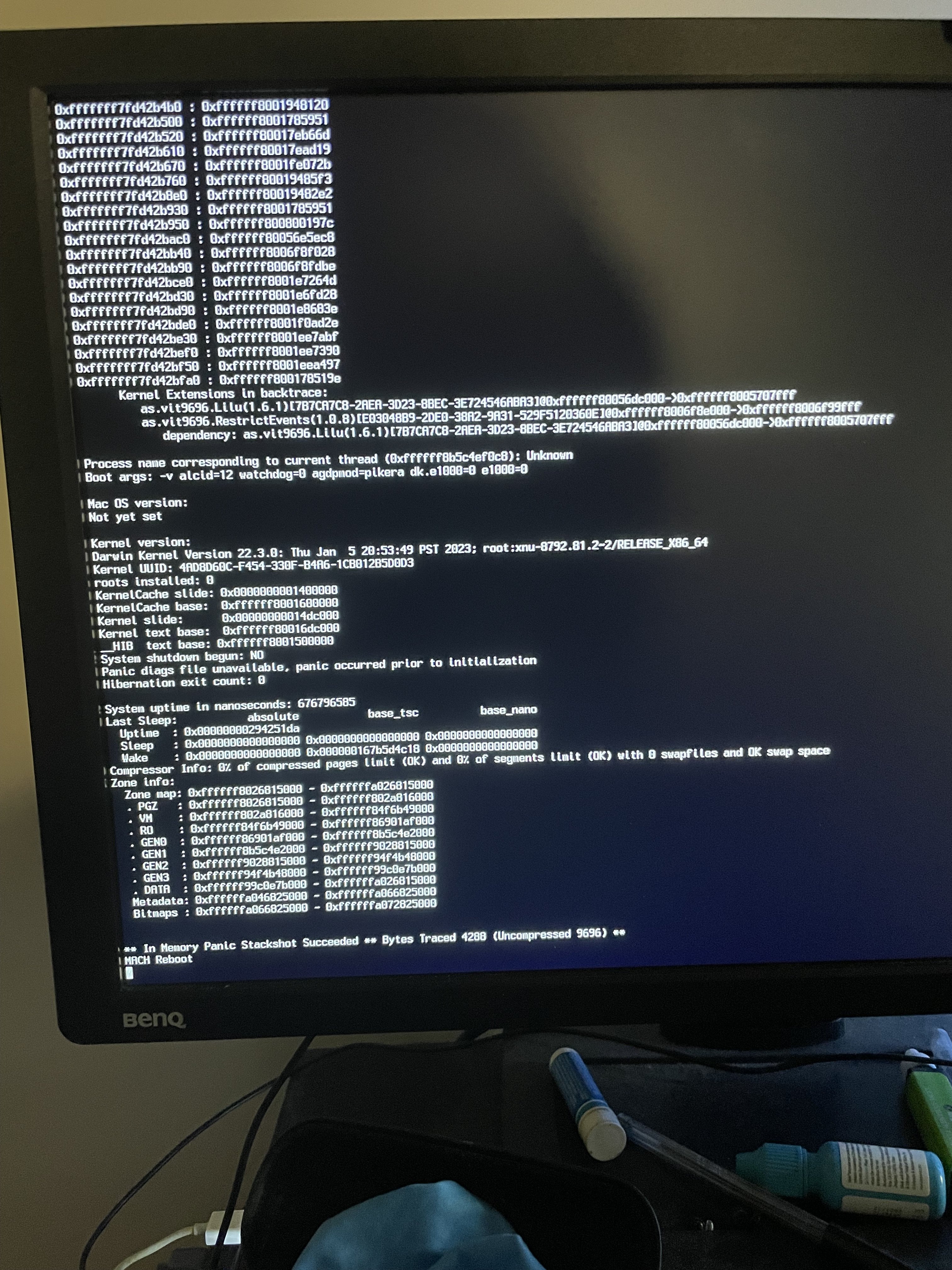

STLVNUB Posted January 23, 2023 Share Posted January 23, 2023 Here Is My config.plist Could Someone Check It, I Get Reboot With It config.plist.zip Link to comment https://www.insanelymac.com/forum/topic/350754-opencore-general-discussion/page/323/#findComment-2800420 Share on other sites More sharing options...

deeveedee Posted January 23, 2023 Share Posted January 23, 2023 (edited) @STLVNUB I stopped reviewing your config.plist after seeing that you have an ACPI > Patch that renames HPET._CRS->XCRS, but you don't have a corresponding ACPI > Add that defines a new HPET._CRS. Also not sure why you define OemTableId = <00000000> for the ACPI patch. If I were to guess, I'd say your config.plist is needs work. EDIT: Your config.plist looks to be derived from a config.plist generated by Open Core Legacy Patcher pre-version 0.5.2. Is it your intent to use this config.plist to enable new macOS on an old hack? Also, some characteristics of the config.plist suggest that your hack is a Dell PC? Is that correct? Edited January 23, 2023 by deeveedee Link to comment https://www.insanelymac.com/forum/topic/350754-opencore-general-discussion/page/323/#findComment-2800441 Share on other sites More sharing options...

STLVNUB Posted January 24, 2023 Share Posted January 24, 2023 8 hours ago, deeveedee said: @STLVNUB I stopped reviewing your config.plist after seeing that you have an ACPI > Patch that renames HPET._CRS->XCRS, but you don't have a corresponding ACPI > Add that defines a new HPET._CRS. Also not sure why you define OemTableId = <00000000> for the ACPI patch. If I were to guess, I'd say your config.plist is needs work. EDIT: Your config.plist looks to be derived from a config.plist generated by Open Core Legacy Patcher pre-version 0.5.2. Is it your intent to use this config.plist to enable new macOS on an old hack? Also, some characteristics of the config.plist suggest that your hack is a Dell PC? Is that correct? no I got i.m trying different configs from different places, thanks for your time Link to comment https://www.insanelymac.com/forum/topic/350754-opencore-general-discussion/page/323/#findComment-2800459 Share on other sites More sharing options...
STLVNUB Posted January 24, 2023 Share Posted January 24, 2023 (edited) 9 hours ago, eSaF said: @STLVNUB - Hi, try this EFI Folder on a spare USB, you'll have to put your Machine's data in the Config.plist, ROM, S/N etc or you can use it to compare the settings within to your own to see what is different. Good luck. EFI.zip 5.86 MB · 2 downloads Still Reboots, Thanks Anyway edit: Looks Like I May Have To Stick With My S L O W Clover Edited January 24, 2023 by STLVNUB Link to comment https://www.insanelymac.com/forum/topic/350754-opencore-general-discussion/page/323/#findComment-2800461 Share on other sites More sharing options...
STLVNUB Posted January 24, 2023 Share Posted January 24, 2023 (edited) 37 minutes ago, eSaF said: Check your BIOS Settings again specially TPM Security. ok edit: Bios settings were ok,No Difference still reboots Edited January 24, 2023 by STLVNUB Link to comment https://www.insanelymac.com/forum/topic/350754-opencore-general-discussion/page/323/#findComment-2800464 Share on other sites More sharing options...

STLVNUB Posted January 26, 2023 Share Posted January 26, 2023 (edited) On 1/24/2023 at 8:29 PM, eSaF said: Hiyah - The reason I said Check BIOS Settings, my MSI Z490 BIOS Menu has these two Settings and has to be set as 'Secure Boot=Disabled' and 'Secure Boot Mode=Standard' if not, it induces a Reboot. I don't know if your B560 has those same settings since both our boards are from the same manufacture. Hope you find a solution soon though. here if they are set the loader is not available, have a config that has kernel panic config.plist and this one gives acpi error config.plist Never Had This Problem Before,Should Be Straight Forward Edited January 26, 2023 by STLVNUB Link to comment https://www.insanelymac.com/forum/topic/350754-opencore-general-discussion/page/323/#findComment-2800570 Share on other sites More sharing options...
