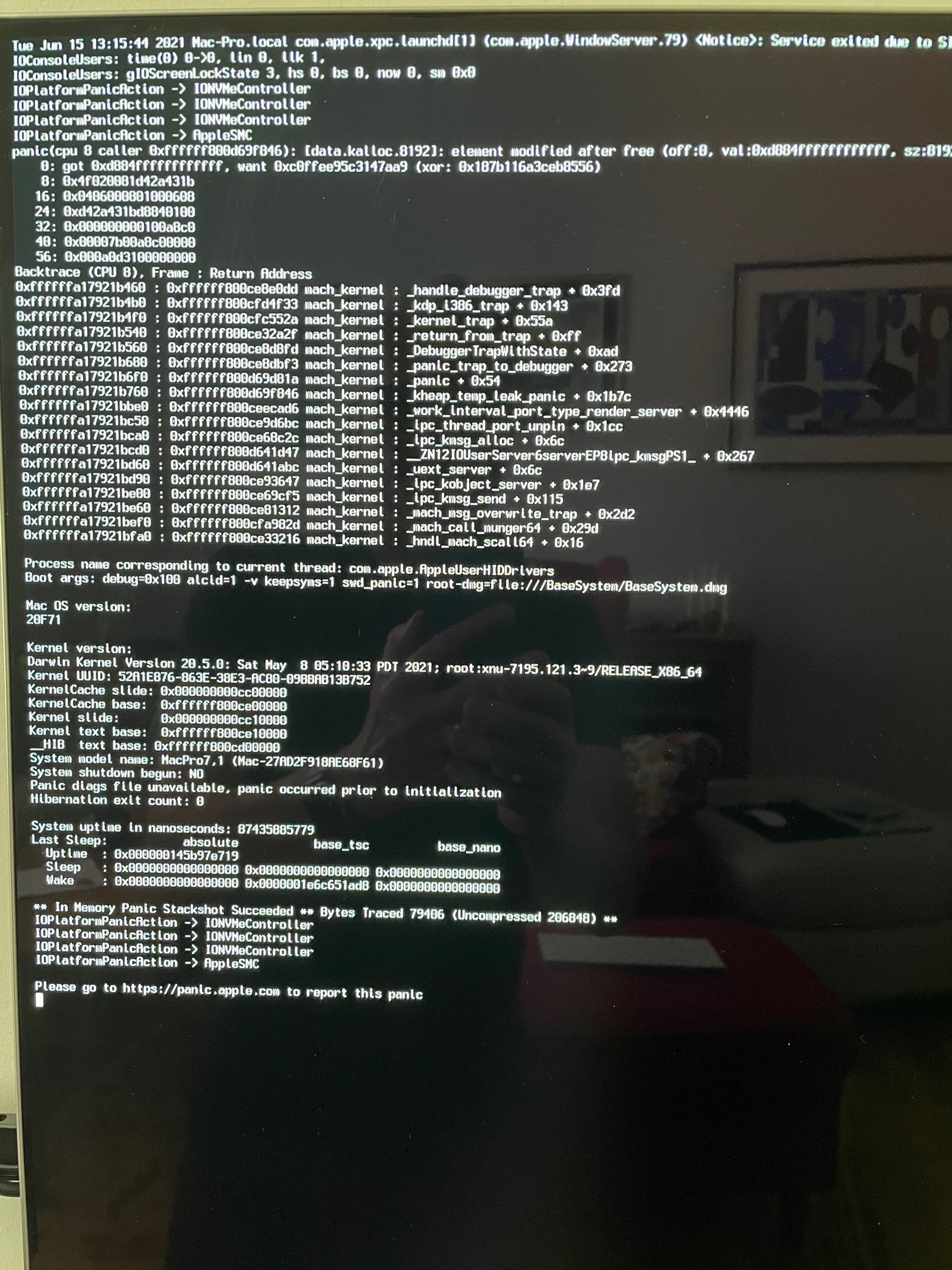

obus Posted June 15, 2021 Author Share Posted June 15, 2021 (edited) Ok guys I will try what you suggest. I did a minimal EFI setup (debug version OC 0.7.0) with only Bluetooth and my Samsung 960 Pro NVMe M.2 disk earlier today with no success. After panic when I was trying install from my USB stick I get this error: Edited June 15, 2021 by obus Link to comment Share on other sites More sharing options...
deeveedee Posted June 15, 2021 Share Posted June 15, 2021 @obus Samsung NVMe SSD? I've had problems with them and don't use Samsung in my hacks any more. I know many swear by Samsung. I prefer Western Digital Black. If all else fails, swap the SSD for something other than Samsung. See here. 2 Link to comment Share on other sites More sharing options...
HenryV Posted June 16, 2021 Share Posted June 16, 2021 4 hours ago, obus said: Ok guys I will try what you suggest. I did a minimal EFI setup (debug version OC 0.7.0) with only Bluetooth and my Samsung 960 Pro NVMe M.2 disk earlier today with no success. After panic when I was trying install from my USB stick I get this error: Do you have a booting installation of Big Sur or Catalina? If so, try installing over top of that if you have at least 40 gigs free. 1 Link to comment Share on other sites More sharing options...

etorix Posted June 16, 2021 Share Posted June 16, 2021 Glad you solved it. The first screenshot repeatedly points to IONVMeController and I never had any success with Samsung PM981 drives, so my guess would be that your Samsung drive no longer works with 11.4. You may try with NVMeFix.kext and see if it helps. For what it is worth, I use Toshiba/Kioxia SSDs in my hacks. Consumer-grade XG5 and XG6 work perfectly so far, including with NVMeFix. Data centre XD5 drives (in M.2 22110 or U.2 format) cause a kernel panic on boot if NVMeFix is present; without NVMeFix they work fine—I suppose that power management by NVMeFix does not play well with Power Loss Protection. 1 Link to comment Share on other sites More sharing options...

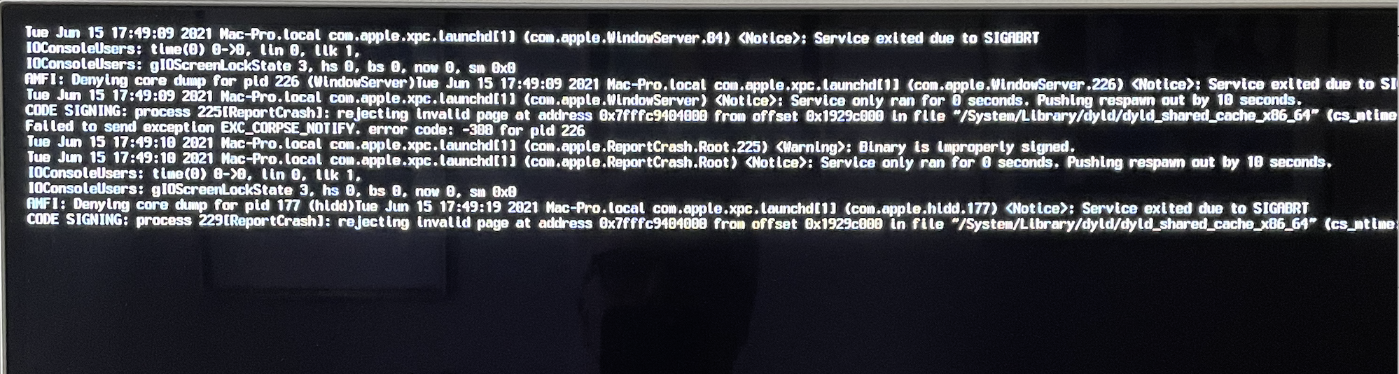

obus Posted June 16, 2021 Author Share Posted June 16, 2021 I have KP and restart all the time now after login screen. This with my installation on my Intel 160 Gb SSD disk. Tested with only one memory and a minimal EFI. No other hardware than my intel disk. Tested different WEG fixes without success. CSM disabled in bios and above 4G enabled. Tested PCIe speed set to 3 gen but nothing seems to stop my KP after login. Late here in Sweden (00.10) even if its still daylight outside. Will take a nap now and try again tomorrow. Link to comment Share on other sites More sharing options...

yapan4 Posted June 17, 2021 Share Posted June 17, 2021 7 hours ago, obus said: I have KP and restart all the time now after login screen. What kind of kernel panic now? Link to comment Share on other sites More sharing options...
obus Posted June 17, 2021 Author Share Posted June 17, 2021 8 minutes ago, yapan4 said: What kind of kernel panic now? Have no idea. Can't see the Apple dump-file because I can't login. My rig is booting mostly fine so OC debug file is saying nothing. It must be something with the new graphics driver Apple introduce in this version. I have no idea how to solve this problem. I've been struggling now for a week. Link to comment Share on other sites More sharing options...

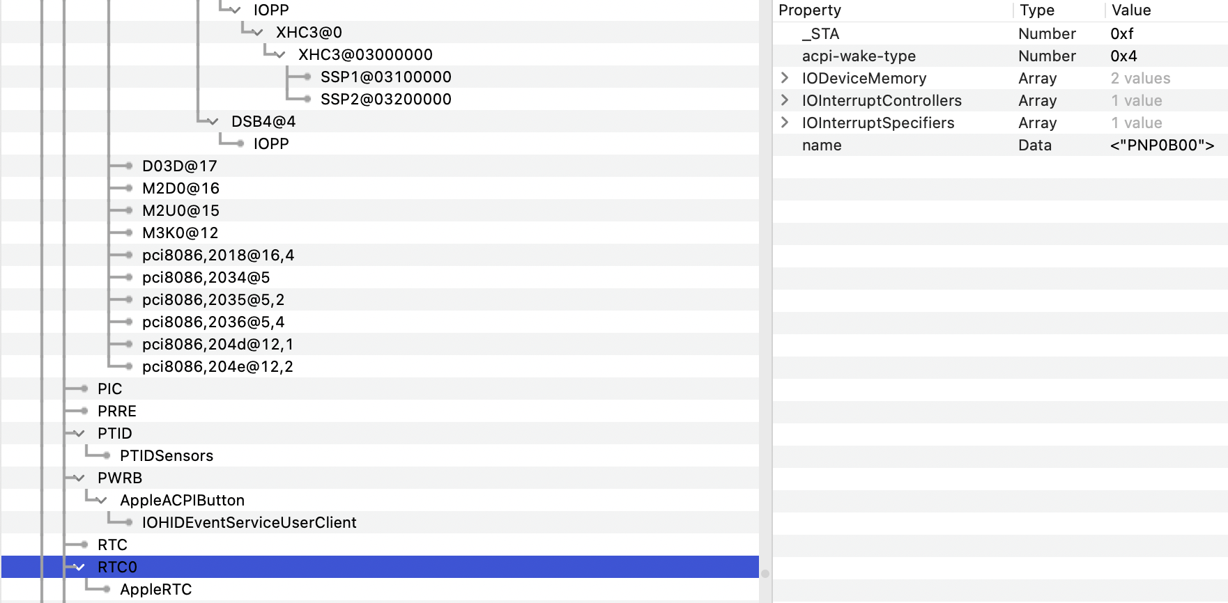

obus Posted June 17, 2021 Author Share Posted June 17, 2021 (edited) Hi @tonyx86 Here we go! I will test a little bit further with my original EFI without USBMap.kext (will use one of my four USB 2.0 ports). Test a new RTC patch. My Samsung disk is not connected. Back to my original bios 3003. This has AWAC and only RTC0. DSDT.aml Mac Pro.ioreg Edited June 17, 2021 by obus Link to comment Share on other sites More sharing options...
