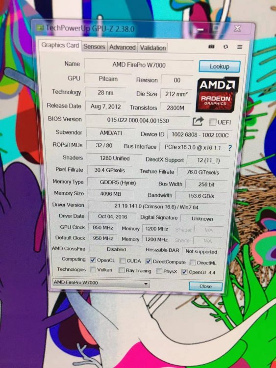

Slice Posted April 7, 2021 Share Posted April 7, 2021 1 hour ago, Hervé said: No ATI/AMD card here but can't fake id be implemented by injecting the desired id through Device Properties injection in the OpenCore config? Under the identified IO location: device-id 09680000 DATA This being said, FirePro W5000 appears to carry id 1002:6809 so you would never need to fake the card's own id! https://pci-ids.ucw.cz/read/PC/1002/6809 So it's better to fake the card to nearest supported 0x6808 1 1 Link to comment https://www.insanelymac.com/forum/topic/347302-any-successful-case-on-get-firepro-w5000-graphics-card-working-on-big-sur/#findComment-2754901 Share on other sites More sharing options...

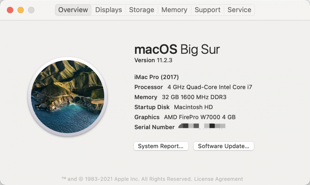

MarvZheng Posted April 8, 2021 Author Share Posted April 8, 2021 5 hours ago, yapan4 said: Thanks to everyone who joined. There are forecasts of further growth in the value of bitcoin, so video cards of this type can still serve well, haha ... At this time I need a full-featured hackintosh so I put back the working WX4100. But I would like to clarify the situation with the W5000 (W7000, W5100, W7100, etc...) on Big Sur, so I'm ready for future tests... I bought one and I can confirm that W7000 works well, OOB. 2 Link to comment https://www.insanelymac.com/forum/topic/347302-any-successful-case-on-get-firepro-w5000-graphics-card-working-on-big-sur/#findComment-2754955 Share on other sites More sharing options...
miliuco Posted April 8, 2021 Share Posted April 8, 2021 4 hours ago, MarvZheng said: I bought one and I can confirm that W7000 works well, OOB. Thanks for the info. I suppose without needing of id injection. Only Lilu and WhateverGreen, no? Link to comment https://www.insanelymac.com/forum/topic/347302-any-successful-case-on-get-firepro-w5000-graphics-card-working-on-big-sur/#findComment-2754967 Share on other sites More sharing options...

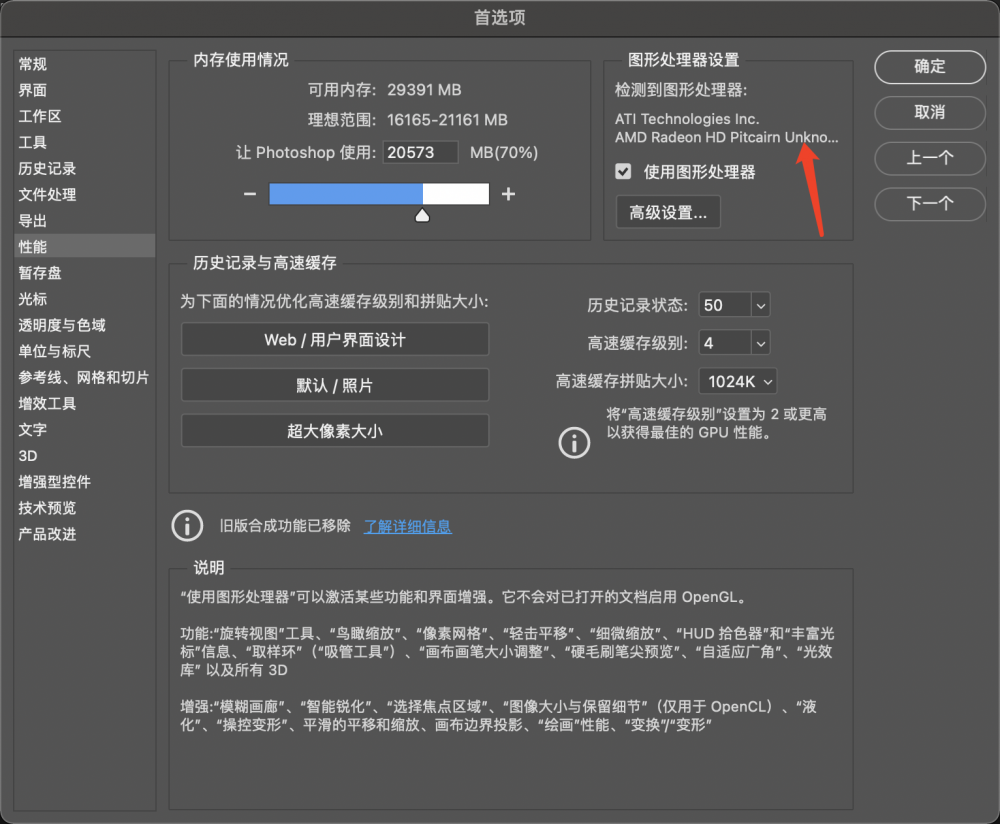

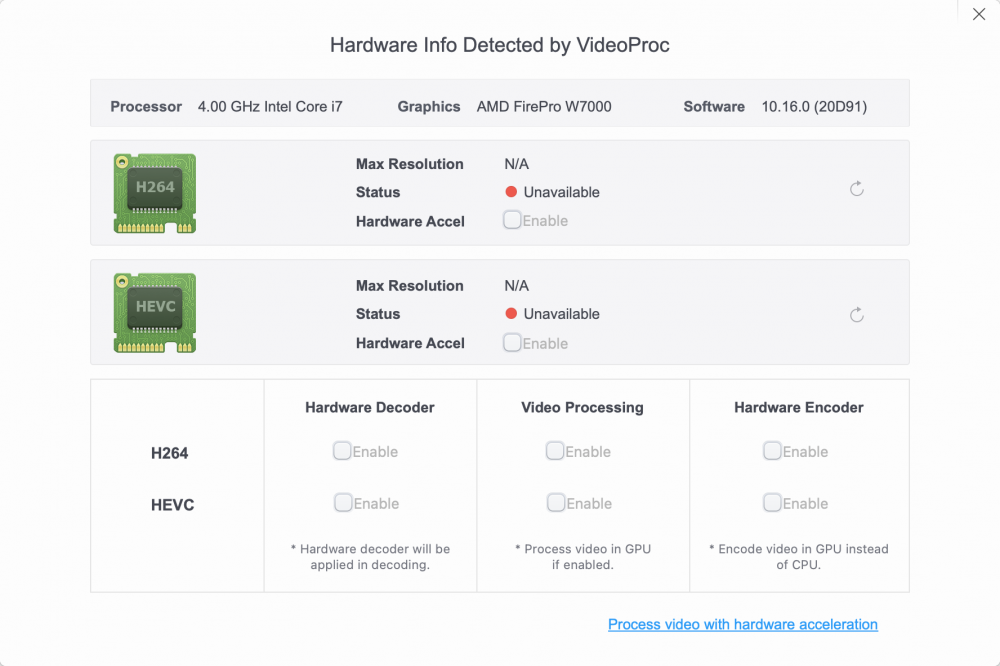

MarvZheng Posted April 9, 2021 Author Share Posted April 9, 2021 (edited) On 4/8/2021 at 5:59 PM, Hervé said: Correct. W7000 normally carries PCI id 1002:6808 which is natively supported by AMD7000 controller kext (see the link I posted above). Of course, check the card's id when you receive it should graphics acceleration not work OOB. I think you are right. In PS even its model is not known. How to enable acceleration? I connected 2 DP ports to my Dell so as to support 5k resolustion. Sometime my screen flash or even turn black but will come back very soon. Edited April 9, 2021 by MarvZheng 1 Link to comment https://www.insanelymac.com/forum/topic/347302-any-successful-case-on-get-firepro-w5000-graphics-card-working-on-big-sur/#findComment-2755110 Share on other sites More sharing options...
MarvZheng Posted April 10, 2021 Author Share Posted April 10, 2021 (edited) 11 hours ago, Hervé said: Huh ? Yesterday, you posted this: I found I did nothing but the system can recogize it and resolustion is correct, so I think it works. Sorry I didn't check it in depth. I can't tell why system can recongize it but PS didn't and acceration is not enable. Edited April 10, 2021 by MarvZheng Link to comment https://www.insanelymac.com/forum/topic/347302-any-successful-case-on-get-firepro-w5000-graphics-card-working-on-big-sur/#findComment-2755140 Share on other sites More sharing options...
