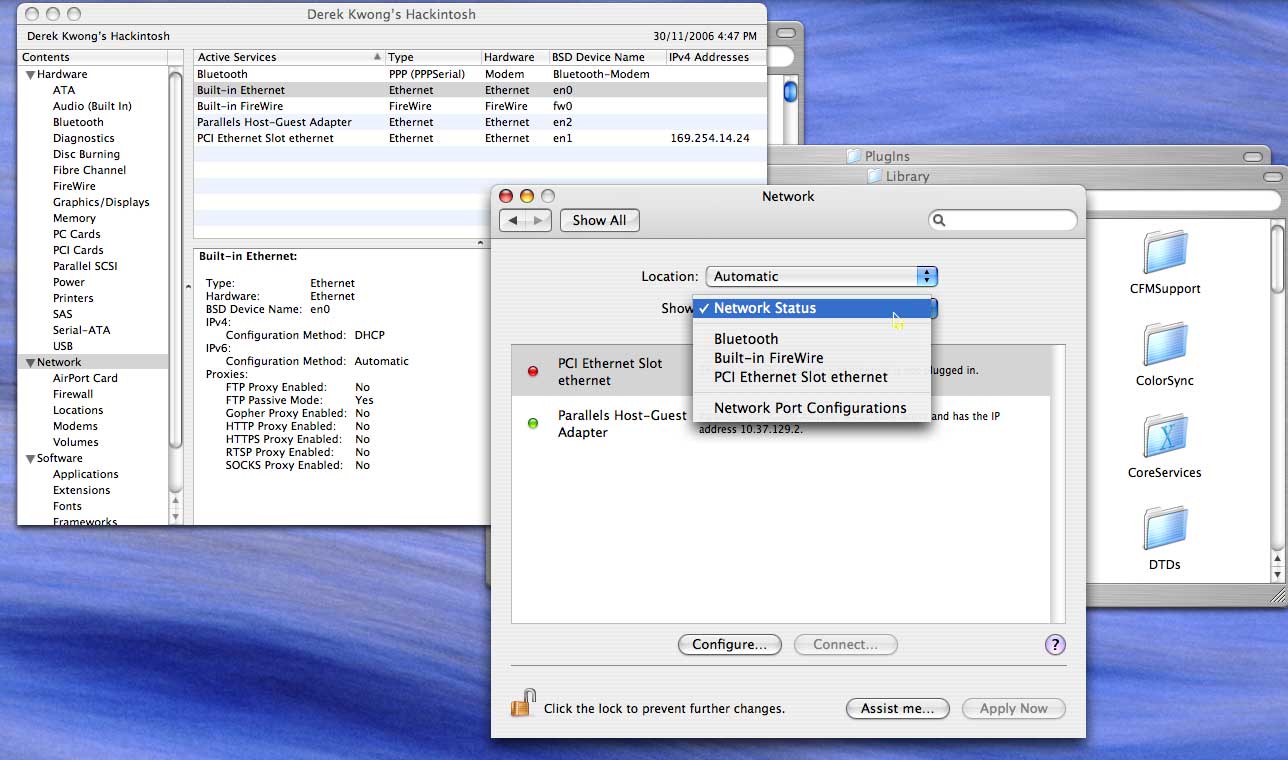

rgb Posted November 30, 2006 Author Share Posted November 30, 2006 Hi I has been followed your guide, but i still can't to use the yukon 8056. In the network preference, it don't display the 8056 yukon. It only display the 8001 yukon. I would like to make dual ethernet port works. Please help Link to comment https://www.insanelymac.com/forum/topic/34446-marvell-yukon-pci-e-8056-works/#findComment-244827 Share on other sites More sharing options...
Rammjet Posted November 30, 2006 Share Posted November 30, 2006 To get your Yukon 88E8056 Ethernet to work, you need to add your device id to the AppleYukon.kext. Go to Terminal and type: cd /System/Library/Extensions <-- changes directory sudo nano IONetworking.kext/Contents/PlugIns/AppleYukon.kext/Info.plist <-- edits file (find and change: <key>Yukon-88E8053</key>) (to: <key>Yukon-88E8056</key>) <-- change "53" to "56" (find and change: <string>Yukon Gigabit Adapter 88E8053</string>) (to: <string>Yukon Gigabit Adapter 88E8056</string>) <-- change "53" to "56" (find and change: <string>0x436211AB</string>) (to: <string>0x436411AB</string>) <-- change "62" to "64" (press Control-O) <-- saves changes (press Y and Enter) <-- accepts saving to existing file (press Control-X) <-- exits nano sudo chown -R root:wheel IONetworkingFamily.kext <-- repairs permissions cd /System/Library <-- changes directories sudo rm -rf Extensions.mkext Extensions.kextcache <-- rebuilds kextcache on reboot Then reboot. Link to comment https://www.insanelymac.com/forum/topic/34446-marvell-yukon-pci-e-8056-works/#findComment-245032 Share on other sites More sharing options...

Stiffy Posted December 5, 2006 Share Posted December 5, 2006 download this: http://rapidshare.com/files/3117240/gigaby...3-4pack.1.2.dmg open it w/ pacifist, right-click the Yukon pkg to install the pre-patched kext. after installation, do info.plist modification following post #4. good luck! Link to comment https://www.insanelymac.com/forum/topic/34446-marvell-yukon-pci-e-8056-works/#findComment-248125 Share on other sites More sharing options...
OhWessTen Posted February 28, 2007 Share Posted February 28, 2007 Thanks everyone...this worked for me in trying to get the Ethernet working on my Gigabyte 965P-DS4, which also has the Yukon Marvell 8056 (as a built in). Just one thing though, the file I had to edit was /System/Library/Extensions/IONetworking.kext/Contents/PlugIns/AppleYukon.kext/Contents/Info.plist Link to comment https://www.insanelymac.com/forum/topic/34446-marvell-yukon-pci-e-8056-works/#findComment-312995 Share on other sites More sharing options...
