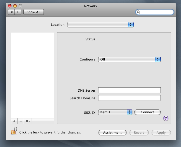

smuudge Posted February 24, 2010 Share Posted February 24, 2010 Hi, i have installed ideneb 10.5.5 on my Quanta TW3M(advent 8315) and its working fine but i have no network options available. I have a Marvel Yukon ethernet card built in although i dont know what model it is, how can i find out easily? I dont have windows on my pc anymore, just 10.5.5 and the system profiler doesnt give me any pointers as to the model of the card! Is there a easily installable generic Marvel Yukon driver that i can download from somewhere? I attach a screenshot of a very empty looking network control panel! Not sure if i should have any options here at all! Thanks! Smuudge Link to comment https://www.insanelymac.com/forum/topic/34446-marvell-yukon-pci-e-8056-works/page/4/#findComment-1417107 Share on other sites More sharing options...
