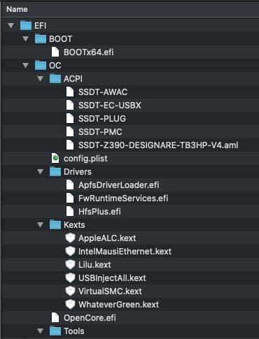

bread.io Posted May 3, 2020 Share Posted May 3, 2020 Hey everyone! Got my first build up and running a few days ago, and while almost everything works perfectly, I'm experiencing some odd sound quality issues. I'm currently listening to my audio through the 3.5mm jack on the front of my case. The sound quality sporadically jumps from being muffled to clear and is also a bit staticky. I've dug into a number of different scenarios that sound similar to mine, but I hoped that someone here might be able to give me more clarity. Here's a sample of the issue: https://clyp.it/xyfxysf2 Config.plist: https://pastebin.com/BStEGbpe My hardware:CPU: Intel i9 9900kGPU: Radeon 5700 XT OCRAM: Corsair ddr4 32GB (2x16)Motherboard: Z390 Designare LGA1151 Any help is really appreciated! Link to comment Share on other sites More sharing options...
bread.io Posted May 3, 2020 Author Share Posted May 3, 2020 SOLVED: In my config.plist I changed the bootargs value from alcid=1 to alcid=11. Link to comment Share on other sites More sharing options...
