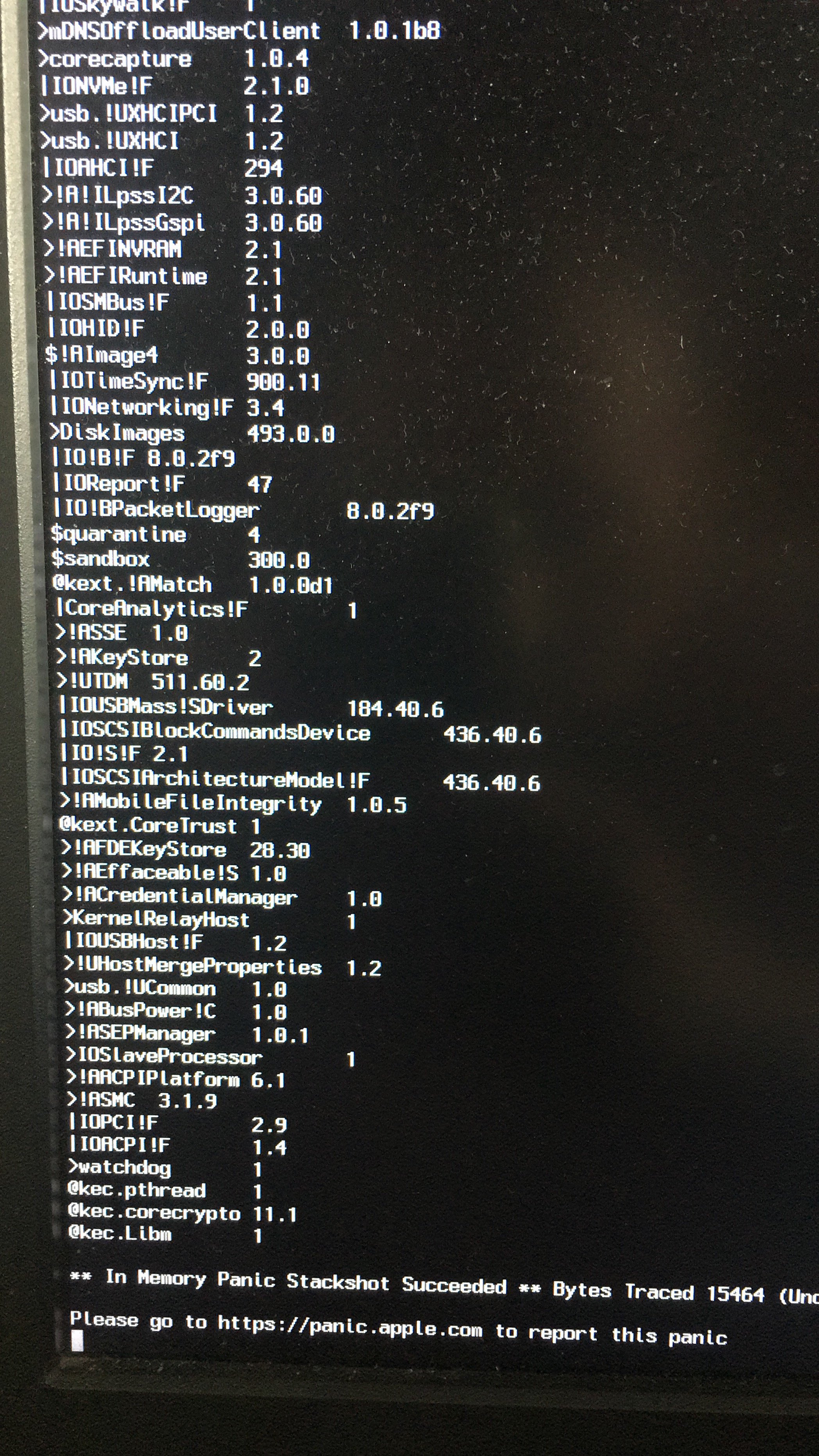

albertoacj Posted December 16, 2020 Share Posted December 16, 2020 is not a good idea update Big Sur to 11.1, did here and my Hackinotsh doesn't boot anymore. Link to comment Share on other sites More sharing options...
albertoacj Posted December 16, 2020 Share Posted December 16, 2020 What is this issue ? Link to comment Share on other sites More sharing options...
kushwavez Posted December 16, 2020 Author Share Posted December 16, 2020 (edited) Did you boot from the Preboots ("Mac OS X Install via Preboot" when updating)? at the end I see "corecrypto" which means it wasn't booted from Preboot. Unfortunately the system isn't here anymore so I can't really test it. But the installation went fine on my other 3 hacks (OTA ~3.4 GB update from Software Update). Maybe try a NVRAM reset. One thing, once I did break the OTA updating by not booting from "Mac OS X Install via Preboot from macOS SSD". In order to fix that I had to boot the system and re-search and re-download the OTA update. After that, and after selecting the right Preboot the OTA update went fine. Edited December 16, 2020 by kushwavez 1 Link to comment Share on other sites More sharing options...
albertoacj Posted December 17, 2020 Share Posted December 17, 2020 I booted from Mac OS X Install Preboot >:/ I'll try a fresh install, in the worst case just restore the backup and stay in 11.0.1. Thanks for help. Link to comment Share on other sites More sharing options...
albertoacj Posted December 17, 2020 Share Posted December 17, 2020 I try to install a fresh install Big Sur 11.1 and got the same error , using the new EFI here, first boot fresh install selected install from pen drive , second preboot macOS install Link to comment Share on other sites More sharing options...
kushwavez Posted December 17, 2020 Author Share Posted December 17, 2020 Try Clover v5127.efi from github Link to comment Share on other sites More sharing options...
albertoacj Posted December 20, 2020 Share Posted December 20, 2020 Now its works, to update to Big Sur 11.1 with clover, have to update apfs drive and boot from preboot stay in preboot all the time, now 11.1 here. 1 Link to comment Share on other sites More sharing options...

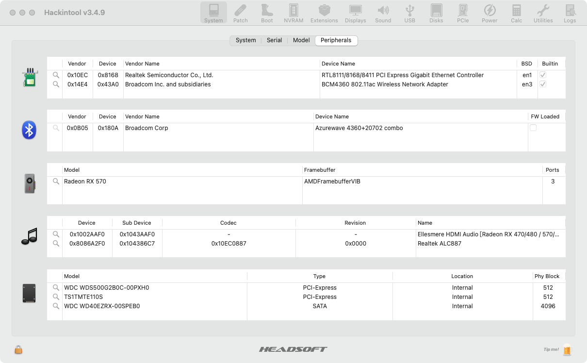

kenlgj Posted December 30, 2020 Share Posted December 30, 2020 hi man !! I am use BCM94360HMB mini pic-e. but just wifi working.can't open the BT. can you tell me how to work perfectly in big sur. Link to comment Share on other sites More sharing options...
albertoacj Posted December 30, 2020 Share Posted December 30, 2020 2 hours ago, kenlgj said: hi man !! I am use BCM94360HMB mini pic-e. but just wifi working.can't open the BT. can you tell me how to work perfectly in big sur. Sorry for ask, but normally comes a cable that you have to connect to usb in your mother board. Did you connect this cable ? Link to comment Share on other sites More sharing options...
kenlgj Posted December 30, 2020 Share Posted December 30, 2020 8 hours ago, albertoacj said: 抱歉,请原谅,但通常需要连接到主板上的USB的电缆。你连接了这条电缆吗? yes I have connect to usb jumper on mother board!!!but still can't working !Is it need driver or other setting ? Link to comment Share on other sites More sharing options...
