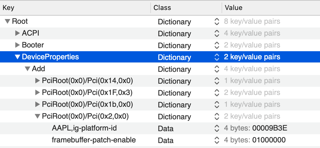

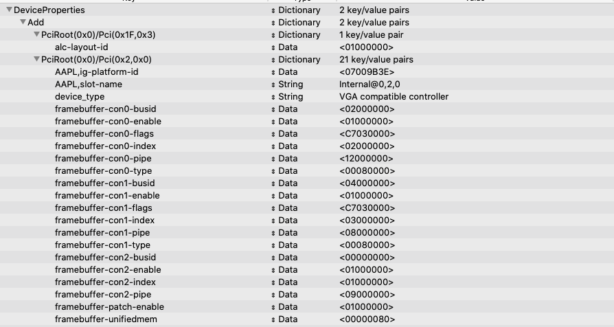

Instead of Clover, I'm a newbie and using Opencore. My motherboard only has a HDMI and a DVI ports, I cannot make dual monitor work, I must unplug the DVI and put it back in when I boot my hackintosh, otherwise both 2 monitors have lot of stripe on them. Only HDMI one works after awake.
I tried both Macmini8,1 and iMac19.1, no luck.
I'm gonna try your EFI out, just the framebuffer part.
May I have any suggestions from you?

On 4/27/2020 at 9:20 AM, danofun said:
@ludufre Thank you for your guide! I too am running Catalina (currently 10.15.4) on a Gigabyte z370n WiFi with an Intel i7 8700k processor and onboard HD 630 graphics. I have recently migrated from Clover to OpenCore. Check out Dortania's excellent guide.
Before making any changes, be sure to backup your data! I'd also suggest testing any new configuration on a bootable USB before moving it to the hard drive. To do so, simply format a USB with a GUID Partition Map, mount the USB's EFI partition, copy the EFI folder you'd like to test, and boot from the USB.
I've attached my OpenCore EFI folder. I believe the only change you'll have to make is to update your SMBIOS info in the PlatformInfo - Generic section of EFI/OC/config.plist using ProperTree. You can either migrate your existing MLB, ROM, SystemSerialNumber, and SystemUUID or generate them using CorpNewt's GenSMBIOS application.
NOTE: OpenCore successfully injects kexts from the EFI/OC/Kexts folder. I'm running a clean system so if you have added any kexts to your system (i.e. sudo mv -R /Volumes/EFI/EFI/CLOVER/kexts/10.15/* /Library/Extensions/ ) you may need to remove them before migrating. Cheers!
EFI.zip

@ludufre, thanks for this guide. Helped me to get Catalina working on my MSI Z370 Gaming Plus + 8700K. I could not get the UHD 630 working on this motherboard though. Whatever I did I would get random video corruption and eventual crashes, think there's something wrong with the MSI BIOS implementation.
Instead I used an RX 5700 XT and disabled the iGPU, works out of the box (with agdpmod=pikera). I used the iMacPro1,1 SMBIOS as without this I would get app crashes due to it trying to access the iGPU for acceleration. Sleep works. Requires drivers64UEFI/OsxAptioFix2Drv-free2000.efi.

Figured out the iGPU issue on MSI Z370 Gaming Plus + 8700K, you need to set the Primary GPU as the iGPU if you have a discreet card installed. After this setting everything is stable and no graphics corruption, plus the iGPU appears in "About this Mac". Worth adding to your tutorial for this motherboard.
