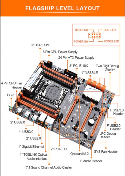

zzmadd Posted March 27, 2020 Share Posted March 27, 2020 (edited) Hi, I'm trying to understand which motherboard you used. YOu say: "SZMZ X99-8D3". I couldn't find a specific model. Would a Huananzhi board like this one work? https://it.aliexpress.com/item/4000197657606.html?spm=a2g0s.8937460.0.0.601f2e0eTQBoze Thanks. Edited March 27, 2020 by zzmadd Link to comment Share on other sites More sharing options...

e97 Posted May 5, 2020 Author Share Posted May 5, 2020 (edited) On 3/27/2020 at 8:58 AM, zzmadd said: Hi, I'm trying to understand which motherboard you used. YOu say: "SZMZ X99-8D3". I couldn't find a specific model. Would a Huananzhi board like this one work? https://it.aliexpress.com/item/4000197657606.html?spm=a2g0s.8937460.0.0.601f2e0eTQBoze Thanks. This is the board: https://it.aliexpress.com/item/4000786291209.html https://it.aliexpress.com/item/4000439515295.html https://it.aliexpress.com/item/4000794489933.html On 4/23/2020 at 6:54 PM, Ryanfromrussia said: Hi! I have a huanan x99 motherboard and an e5 2678v3 processor. I can’t turn on speedstep and turboboost according to this instruction. And the script for creating ssdt does not recognize this processor “unknown processor”.. help is good for me ( Havent used the Huanan X99 board and don't have one to test. Since you got the board running you are almost there, try removing NullCpu and create a SSDT. Best way to get help: 1) search first, 2) if nothing similar, make a new thread with full system specs and config files. This way others with the same board can help you and others can find and benefit too. Edited May 5, 2020 by e97 1 Link to comment Share on other sites More sharing options...

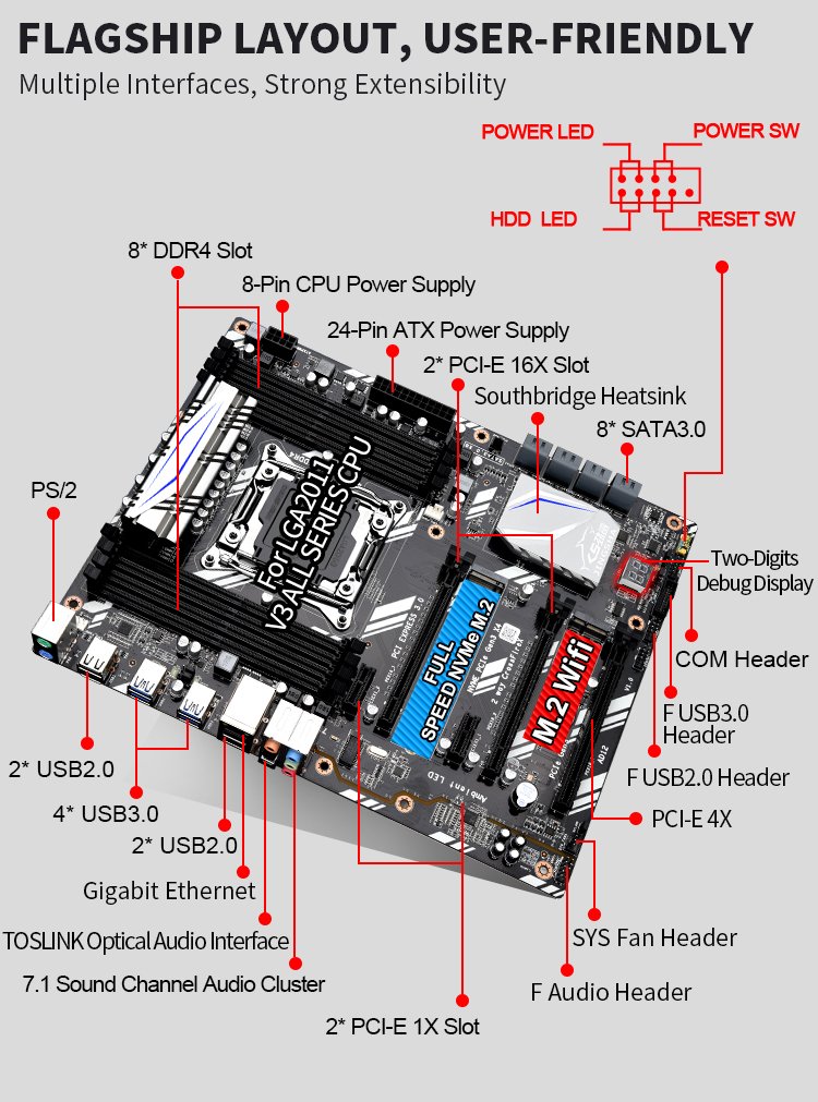

zzmadd Posted May 7, 2020 Share Posted May 7, 2020 (edited) On 5/5/2020 at 5:49 PM, e97 said: This is the board: https://it.aliexpress.com/item/4000786291209.html https://it.aliexpress.com/item/4000439515295.html https://it.aliexpress.com/item/4000794489933.html Thanks for your reply. That's the Jingsha board but there's an identical board sold by Kllisre: https://it.aliexpress.com/item/4000552611991.html?spm=a2g0y.12010612.8148356.16.725d71d8pYeINj I was able to run this board. I'm really happy about it. Just sleep doesn't work at all. Turbo is unlocked. https://it.aliexpress.com/item/4000741824519.html?spm=a2g0y.12010612.8148356.18.725d71d8pYeINj E5 2620 V3 - Cinebench R15: 960 Any advice? Edited May 7, 2020 by zzmadd Link to comment Share on other sites More sharing options...
e97 Posted May 9, 2020 Author Share Posted May 9, 2020 (edited) On 5/7/2020 at 1:52 AM, zzmadd said: Thanks for your reply. That's the Jingsha board but there's an identical board sold by Kllisre: https://it.aliexpress.com/item/4000552611991.html?spm=a2g0y.12010612.8148356.16.725d71d8pYeINj Same manufacturer, different sellers. Thats a DDR4 board: the one I linked and use is DDR3 : On 5/7/2020 at 1:52 AM, zzmadd said: I was able to run this board. I'm really happy about it. Just sleep doesn't work at all. Turbo is unlocked. https://it.aliexpress.com/item/4000741824519.html?spm=a2g0y.12010612.8148356.18.725d71d8pYeINj E5 2620 V3 - Cinebench R15: 960 Any advice? Congrats! Sleep depends on sleep state hardware support, BIOS support and then proper config. People seem to have better luck with OpenCore. Like most things hackintosh, trial and error. Edited May 9, 2020 by e97 Link to comment Share on other sites More sharing options...

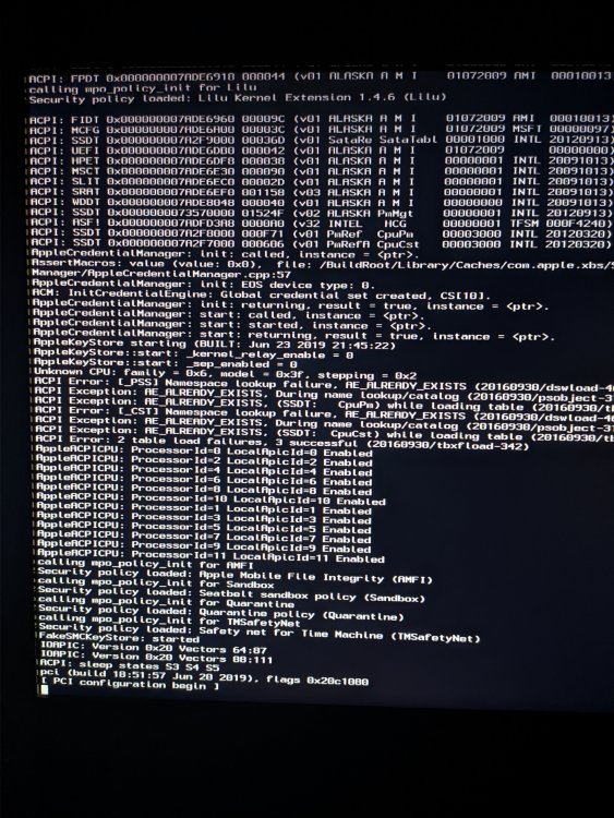

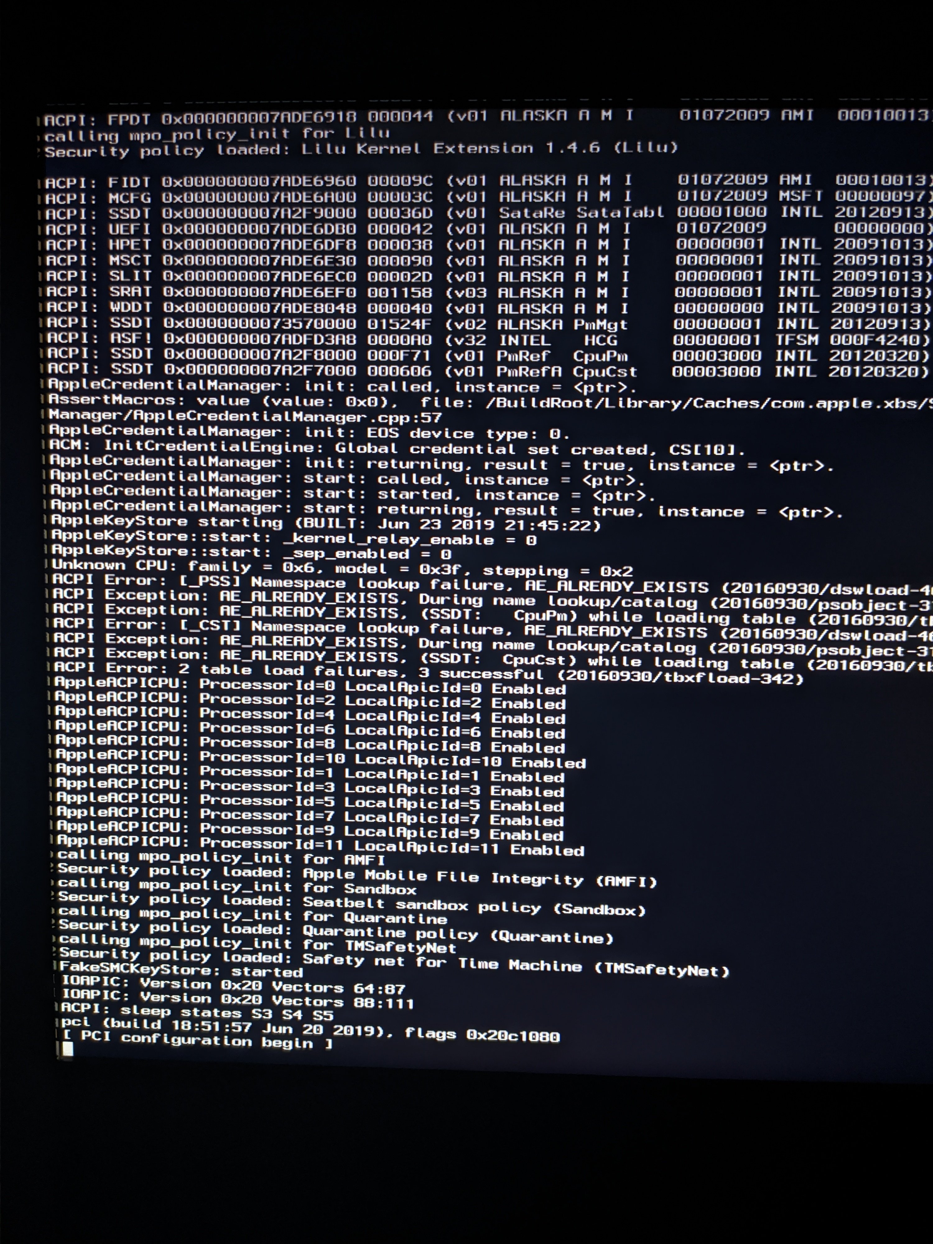

Singa Posted August 9, 2020 Share Posted August 9, 2020 (edited) Hi, I'm trying to instal macOS Mojave. My PC: GPU - AMD RX580 Pulse 4GB CPU - Intel Xeon e5 2620v3 [6c/12t] (TurboBoost 3.2GHz) Motherboard - LGA2011v3 Kllisre X99Z v102(bios - huananzhi x99-TF) RAM - DDR4 Kllisre 2400MHz(1866MHz) Dual Chanel When I try to install, I get an error "Failed to start CPU 02, rebooting... CPU halted" and "bsd process name corresponding to current thread" This is solved by argument: cpus=1 But after that I have the next eror: "PCI configuration begin". Any arguments doesnt work. My clover: EFI.rar Edited August 10, 2020 by Singa Link to comment Share on other sites More sharing options...
