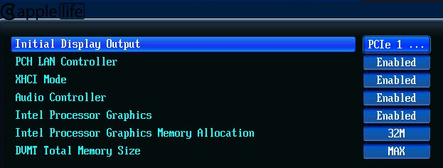

hardcorehenry Posted July 5, 2019 Share Posted July 5, 2019 2 hours ago, URBANsUNITED said: Thanks, but doesn't work. Catalina wakes from sleep, but USB ports stop working, if the rest is ok, I don't know, maybe my whole system freeze?!? Everything else is fine I've attached my clover folder, maybe someone can have a look at? But btw... the AGMP injector kext is not loading as it looks like: As with kext or without control-id stays 0x11 Thanks again URBANsUNITED CLOVER.zip Set your bios graphic like in the picture (miltimonitor+32mb+pcie initial display in my case) or better read this. Use translator if you have to. I added ig-platform and device id into properties of your config.plist. You could also try without device-id, I need this for my Intel Pentium Haswell. 1 Link to comment https://www.insanelymac.com/forum/topic/339381-no-sleep-with-catalina-on-haswell-system/#findComment-2680242 Share on other sites More sharing options...

URBANsUNITED Posted July 5, 2019 Author Share Posted July 5, 2019 @hardcorehenry Thanks! With your help, I got my system sleeping and waking up successfully!!! Many many thanks! It was you below tip and maybe(?) adding the two needed kexts for VirtualSMC. Thanks!!! Cheers URBANsUNITED 11 hours ago, hardcorehenry said: Set your bios graphic like in the picture (miltimonitor+32mb+pcie initial display in my case) or better read this. Use translator if you have to. I added ig-platform and device id into properties of your config.plist. You could also try without device-id, I need this for my Intel Pentium Haswell. Link to comment https://www.insanelymac.com/forum/topic/339381-no-sleep-with-catalina-on-haswell-system/#findComment-2680332 Share on other sites More sharing options...
