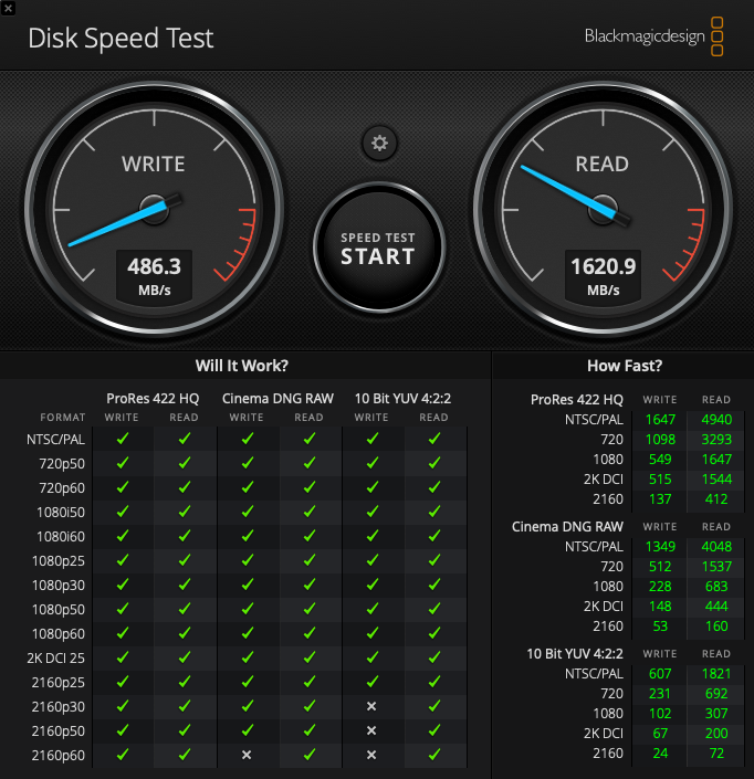

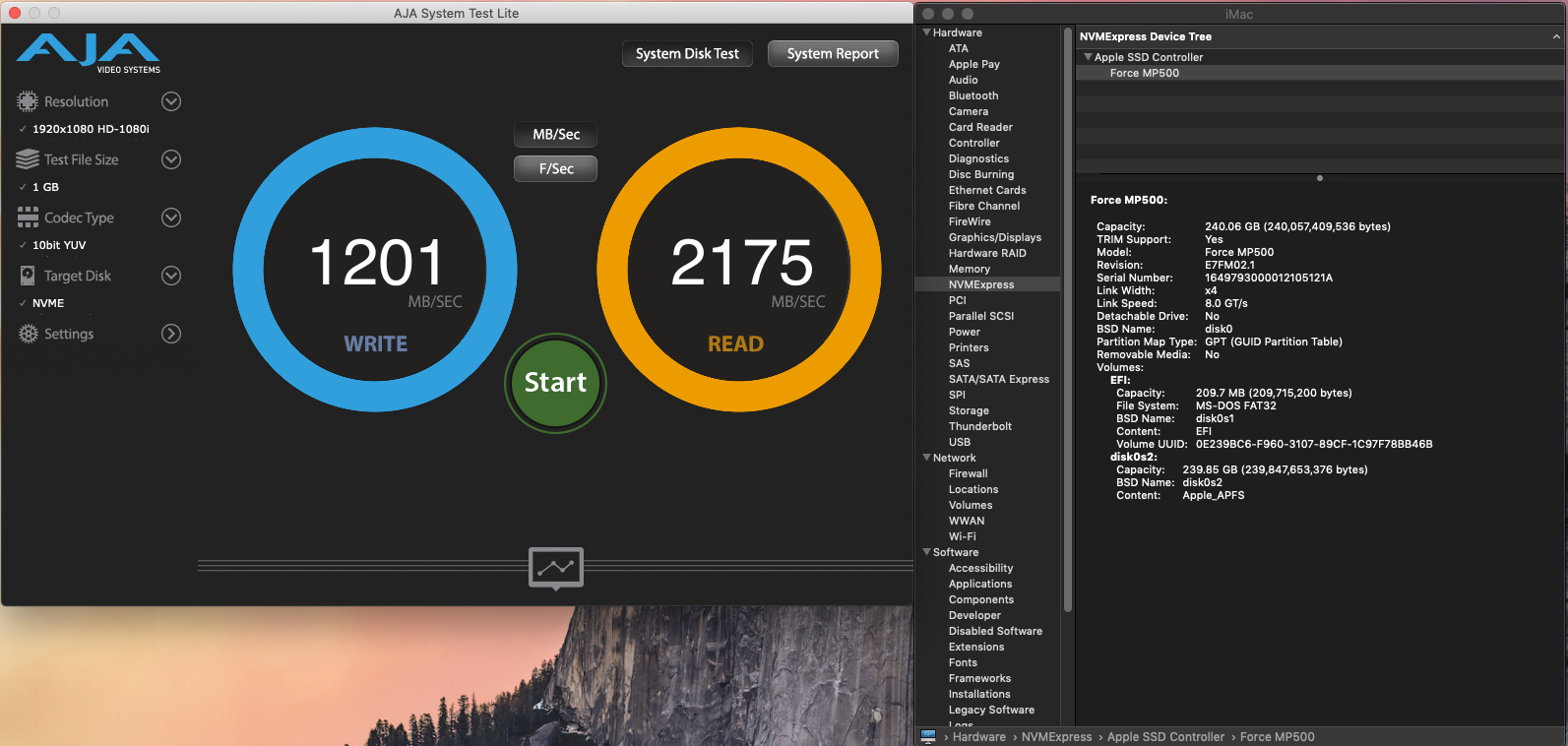

tikizondo94 Posted February 11, 2019 Share Posted February 11, 2019 1 hour ago, lahana1 said: hello corsair mp500 What is the read / write speed of NVME M.2? I have the same model as the read / write speed is very slow. Mine seems to be pretty snappy. I did have issues before when i had to many Drives hooked up. It seemed to slow my write speeds down to a solid 200mb sec. Also watch for thermal throttling with NVMe drives. Heat is not there friend. 1 Link to comment Share on other sites More sharing options...
