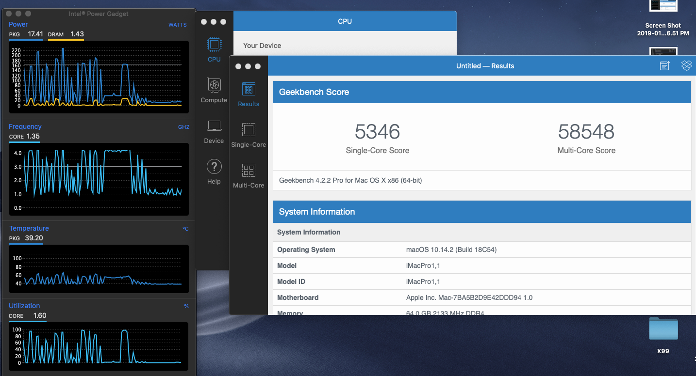

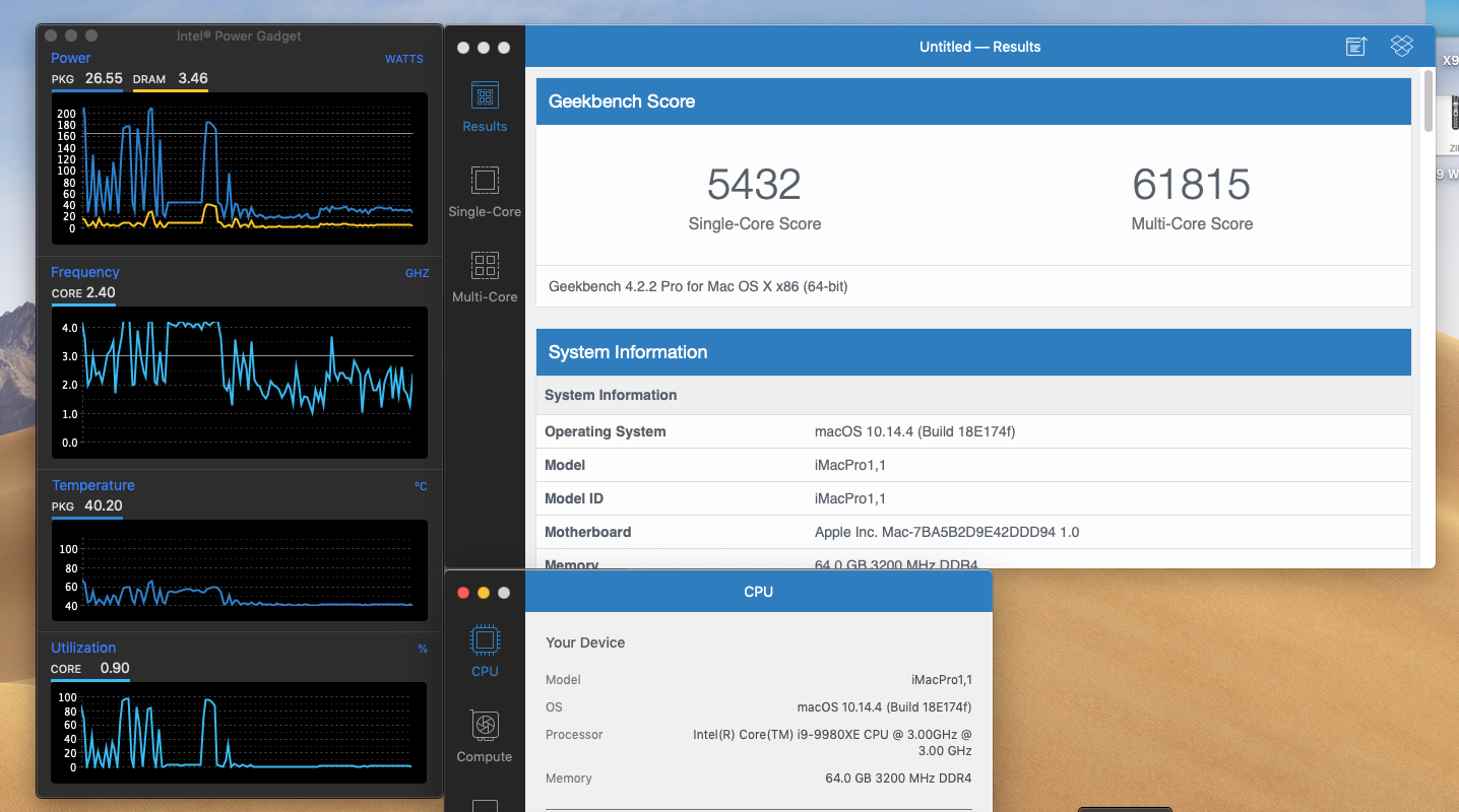

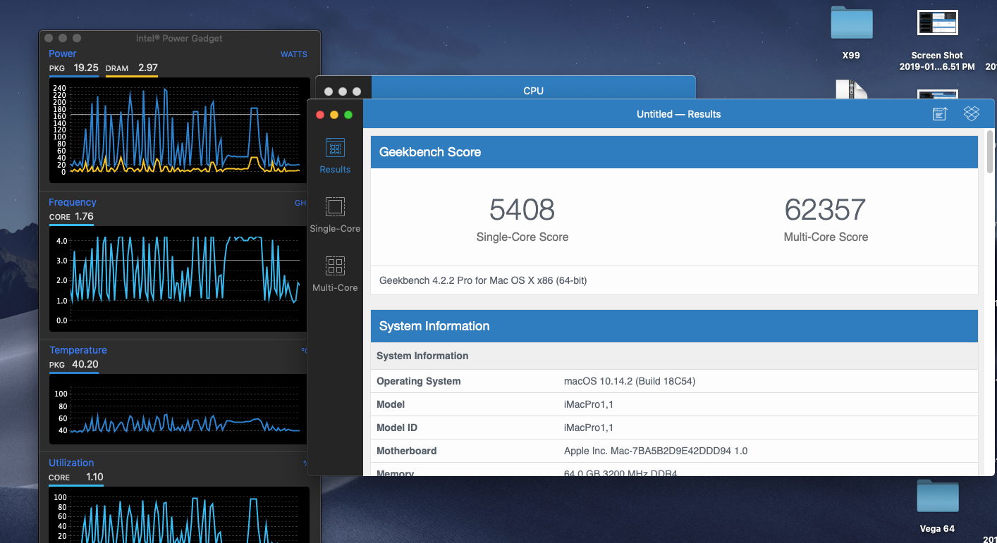

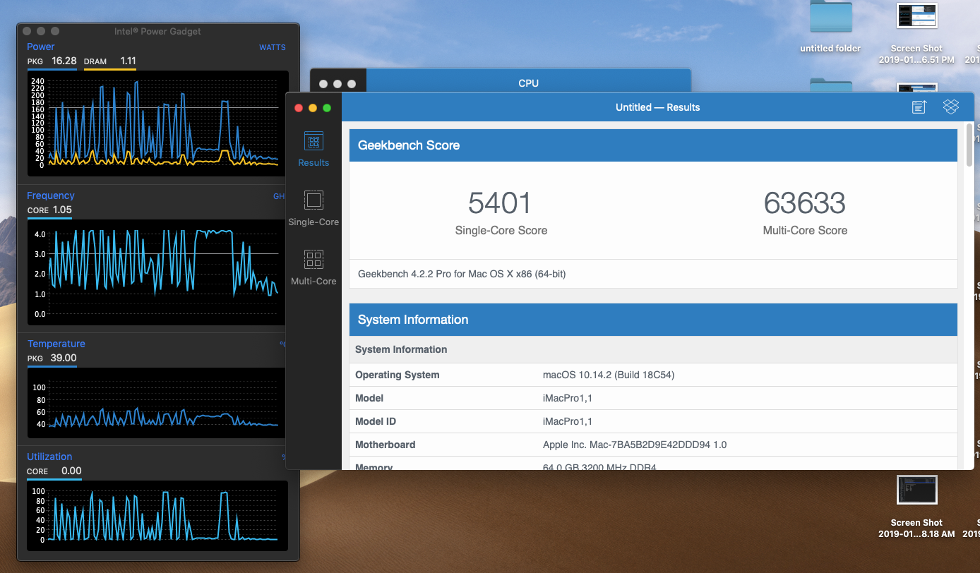

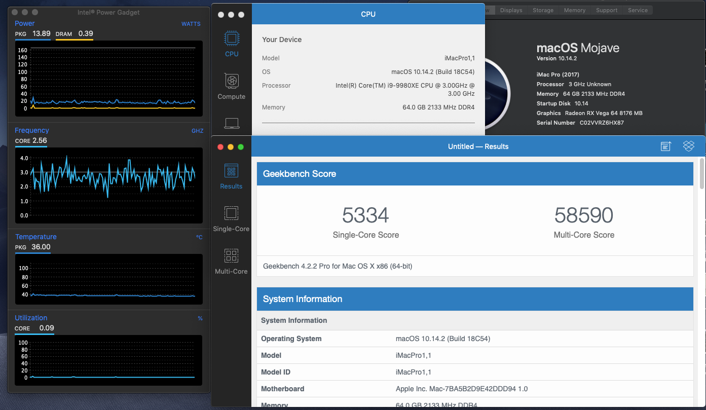

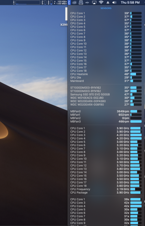

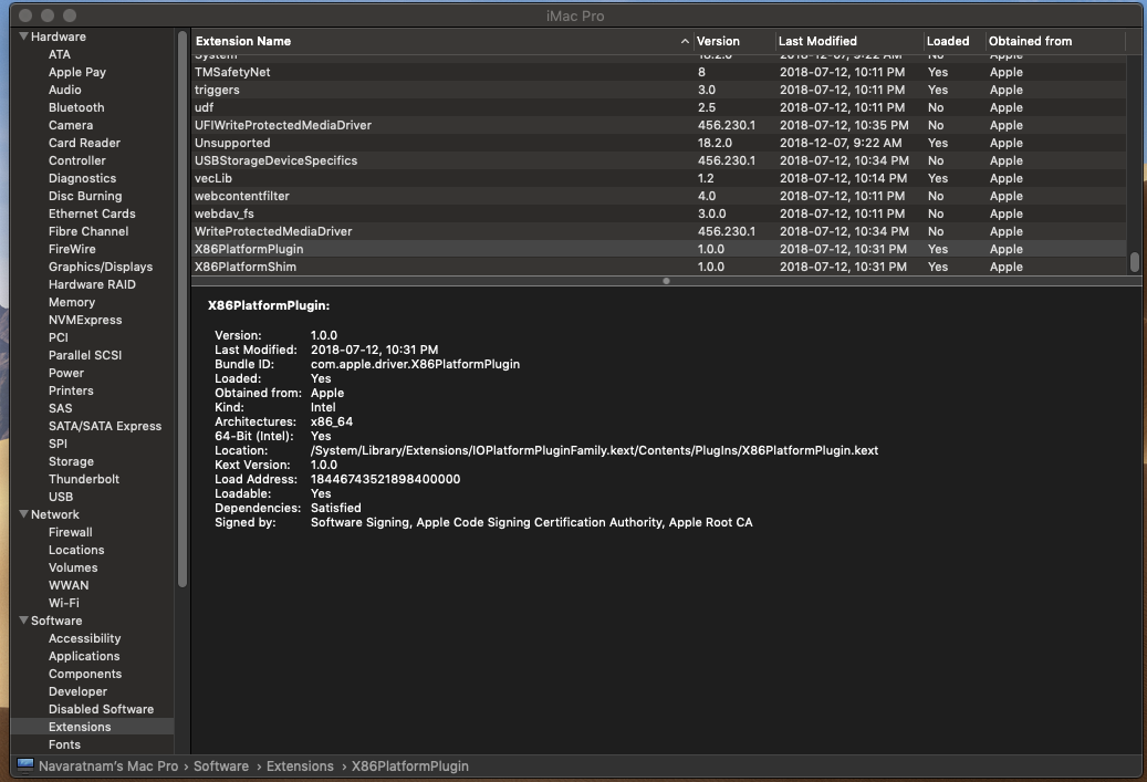

tyufhl Posted January 31, 2019 Share Posted January 31, 2019 59 minutes ago, nmano said: Last login: Thu Jan 31 01:15:49 on console Navaratnams-Mac-Pro-2:~ x58$ sysctl -n machdep.xcpm.mode 1 Navaratnams-Mac-Pro-2:~ x58$ I test now without FakecpuID set in bios profile 1 overclock 4.2GHz I need to get 10,000 more core score I disable all kernel patches. Thanks @PMheart you have loaded X86PlatformPlugin.kext? 1 Link to comment https://www.insanelymac.com/forum/topic/337357-pre-release-macos-mojave-10144/page/4/#findComment-2662155 Share on other sites More sharing options...
nmano Posted January 31, 2019 Share Posted January 31, 2019 4 hours ago, tyufhl said: you have loaded X86PlatformPlugin.kext? Yes I thick Plugin Type in ACPI in the Clover config. 1 Link to comment https://www.insanelymac.com/forum/topic/337357-pre-release-macos-mojave-10144/page/4/#findComment-2662199 Share on other sites More sharing options...
PMheart Posted January 31, 2019 Share Posted January 31, 2019 6 hours ago, nmano said: Last login: Thu Jan 31 01:15:49 on console Navaratnams-Mac-Pro-2:~ x58$ sysctl -n machdep.xcpm.mode 1 Navaratnams-Mac-Pro-2:~ x58$ I test now without FakecpuID set in bios profile 1 overclock 4.2GHz I need to get 10,000 more core score I disable all kernel patches. Thanks @PMheart If you get machdep.xcpm.mode = 1 without any kernel patch, then it proves what I said (that X299 is supported natively). Well, if the performance is somewhat low, try applying the "performance fix". 1 Link to comment https://www.insanelymac.com/forum/topic/337357-pre-release-macos-mojave-10144/page/4/#findComment-2662204 Share on other sites More sharing options...
nmano Posted January 31, 2019 Share Posted January 31, 2019 1 hour ago, PMheart said: If you get machdep.xcpm.mode = 1 without any kernel patch, then it proves what I said (that X299 is supported natively). Well, if the performance is somewhat low, try applying the "performance fix". I test performance fix patched same result. Thanks @PMheart Link to comment https://www.insanelymac.com/forum/topic/337357-pre-release-macos-mojave-10144/page/4/#findComment-2662210 Share on other sites More sharing options...
PMheart Posted February 1, 2019 Share Posted February 1, 2019 1 hour ago, nmano said: I test performance fix patched same result. Thanks @PMheart Please try the "old, long patch" (as we did before), the "old way" and "new way" (as I posted days ago) as well. Thanks a lot! 1 Link to comment https://www.insanelymac.com/forum/topic/337357-pre-release-macos-mojave-10144/page/4/#findComment-2662215 Share on other sites More sharing options...
nmano Posted February 1, 2019 Share Posted February 1, 2019 3 hours ago, PMheart said: Please try the "old, long patch" (as we did before), the "old way" and "new way" (as I posted days ago) as well. Thanks a lot! I tested long patched 10.14.2 same result I will test tomorrow 10.14.4 with long patch. Thanks. Link to comment https://www.insanelymac.com/forum/topic/337357-pre-release-macos-mojave-10144/page/4/#findComment-2662224 Share on other sites More sharing options...
PMheart Posted February 1, 2019 Share Posted February 1, 2019 3 hours ago, nmano said: I tested long patched 10.14.2 same result I will test tomorrow 10.14.4 with long patch. Thanks. Well, the "long patch" varies from time to time, are you sure that you are using the correct one? 1 Link to comment https://www.insanelymac.com/forum/topic/337357-pre-release-macos-mojave-10144/page/4/#findComment-2662235 Share on other sites More sharing options...
nmano Posted February 1, 2019 Share Posted February 1, 2019 7 hours ago, PMheart said: Well, the "long patch" varies from time to time, are you sure that you are using the correct one? I update 10.14.4 I test long patched same result. F C1E30848 63D389D0 48C1EA20 B9990100 000F3048 FF05926E 76004883 C4085B5D C30F1F00 R BB00FF00 004863D3 89D048C1 EA20B999 0100000F 3048FF05 93AE7600 4883C408 5B5DC390 1 Link to comment https://www.insanelymac.com/forum/topic/337357-pre-release-macos-mojave-10144/page/4/#findComment-2662273 Share on other sites More sharing options...
