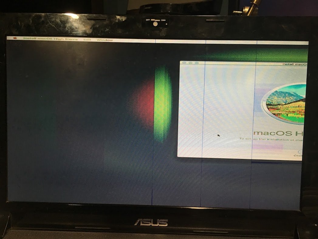

Mister3000 Posted January 6, 2019 Share Posted January 6, 2019 hi guys, Im hoping some one can help me out of this jam. maybe this is an easy fix but im lost. I've been running yosemite for years on my asus N53SV but i figured its time to upgrade.. and since i was told mojave its too much trouble im fine with going to High Sierra. my issue is this: I created a usb boot and grabbed a clover folder from a website that claimed everything worked out of the box. i was able to boot in to the setup screen, however my image looks all distorted. im guessing it has something to do with the fact that i replaced the panel on my laptop from a 720P to a 1080p display. i was able to solve this same issue when i was on yosemite by using a patched DSDT but if i use that same old patch DSDT then i get issues/conflicts like my internal keyboard and trackpad not working. This are my specs: ASUS N53SV HD3000 1080p i7 2670qm 512 GB SSD 8GB Ram maybe someone can point me in the right direction.. Im attaching aa picture in case someone has seen this issue before. Thanks Link to comment https://www.insanelymac.com/forum/topic/337119-high-sierra-on-asus-n53sv-laptop-sandy-bridge/ Share on other sites More sharing options...
Mister3000 Posted January 7, 2019 Author Share Posted January 7, 2019 waoh !! and just like that Herve' has gotten through yet another jam. thanks a lot man, you have been helping me since my first hackingtosh my old Dell D630 I did as you said. went on to clover configurator and enable DualLink and also on SMBIOS choose MBP8,2 and now i got full 1080p picture. Thanks again man, you are genius !! Link to comment https://www.insanelymac.com/forum/topic/337119-high-sierra-on-asus-n53sv-laptop-sandy-bridge/#findComment-2657665 Share on other sites More sharing options...

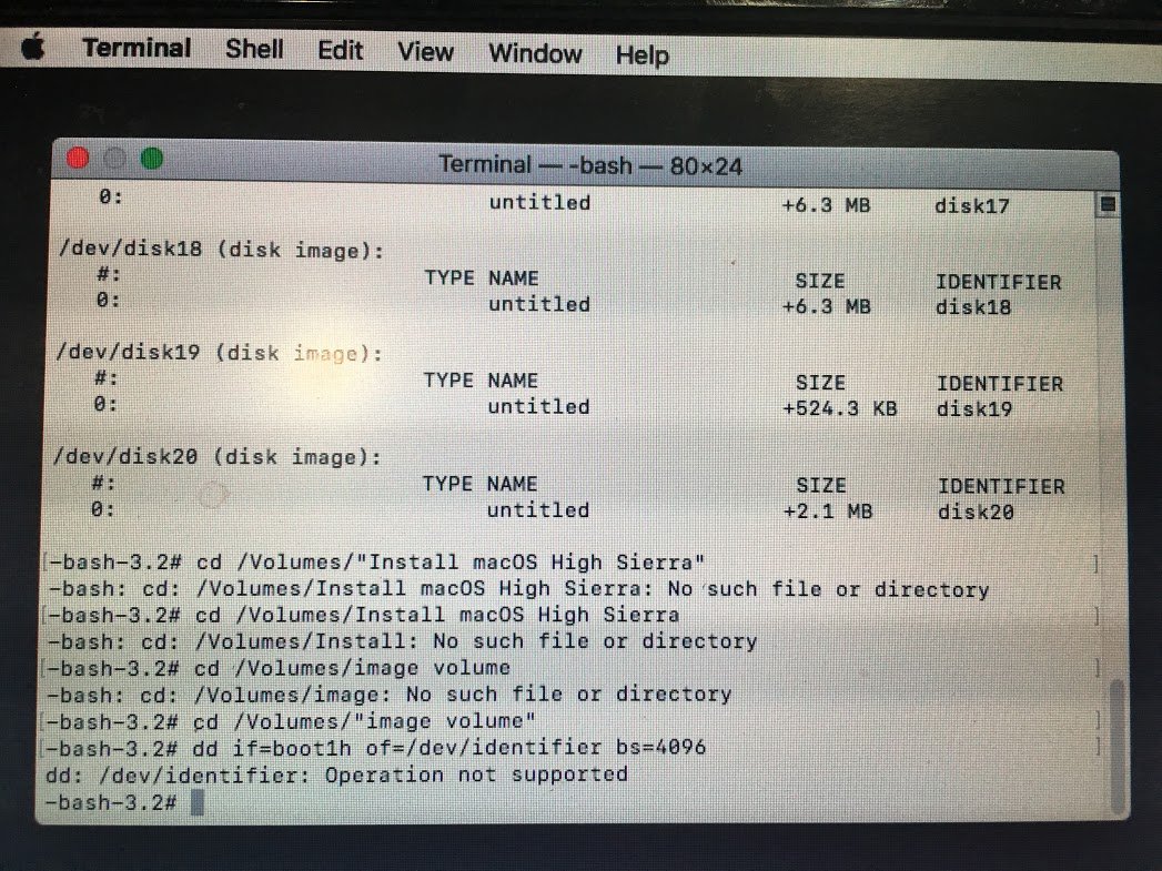

Mister3000 Posted January 7, 2019 Author Share Posted January 7, 2019 OK, Im back with yet another issue. i was able install high sierra. then installed clover on the SSD and replaced the clover folder with the one from my usb stick installer. but now when trying to boot from SSD i get boot0af: error tried following the guides in the internet to fix this problem and i get operation not supported. any ideas ? Link to comment https://www.insanelymac.com/forum/topic/337119-high-sierra-on-asus-n53sv-laptop-sandy-bridge/#findComment-2657777 Share on other sites More sharing options...
Mister3000 Posted January 7, 2019 Author Share Posted January 7, 2019 I just found my own mistake. i realized that I wrote “identifier” on the command instead of the disk number for my os installation. Link to comment https://www.insanelymac.com/forum/topic/337119-high-sierra-on-asus-n53sv-laptop-sandy-bridge/#findComment-2657801 Share on other sites More sharing options...
