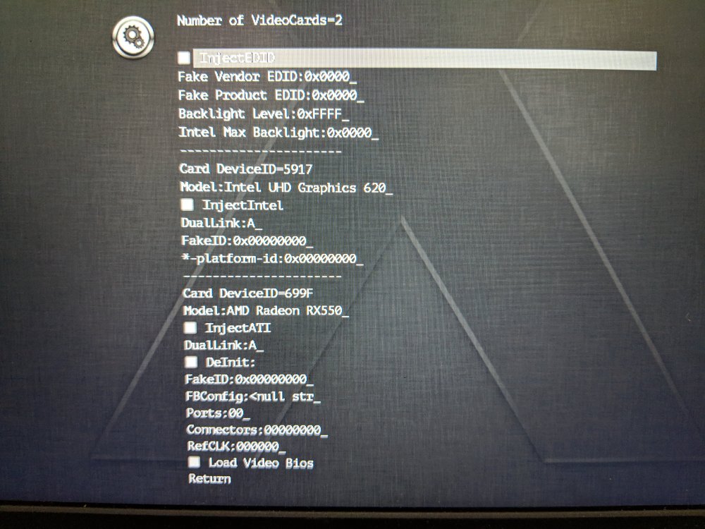

Ranjith Varatharajan Posted December 27, 2018 Share Posted December 27, 2018 Hi, I have installed a Hackintosh. I can see the AMD Graphics card in the clover boot option. but Its not showing in the system information. My System info -> Lenovo 330s 8th Gen Intel® Quad Core i5-8250U 8 GB Ram AMD Radeon 550 4GB I'm a noob in hackintoshing. Any leads would be appreciated. Thanks. Link to comment https://www.insanelymac.com/forum/topic/337037-amd-radeon-rx-550-not-working/ Share on other sites More sharing options...

Ranjith Varatharajan Posted December 28, 2018 Author Share Posted December 28, 2018 (edited) Ok, So I have formatted the laptop again to windows and checked with CPU-Z and My Graphic card is actually Radeon 540 4GB not Radeon RX 550. I still don't know how clover is recognizing the GPU as RX 550. Please let me know how to solve it. I'll try to install hackintosh again this evening. Edited December 28, 2018 by Ranjith Varatharajan Link to comment https://www.insanelymac.com/forum/topic/337037-amd-radeon-rx-550-not-working/#findComment-2656035 Share on other sites More sharing options...
Gigamaxx Posted December 28, 2018 Share Posted December 28, 2018 RX 550, 540 is actually Lexa architecture, not Polaris. However, the Hades Canyon NUC with Vega graphics has a similar setup but it has HBM2 and it has been somewhat supported/splved. The fix is in Clover/Devices/Properties using injection. Set Inject ATi=false, no fake ID just use this Clover configuration for testing. 1 Link to comment https://www.insanelymac.com/forum/topic/337037-amd-radeon-rx-550-not-working/#findComment-2656037 Share on other sites More sharing options...

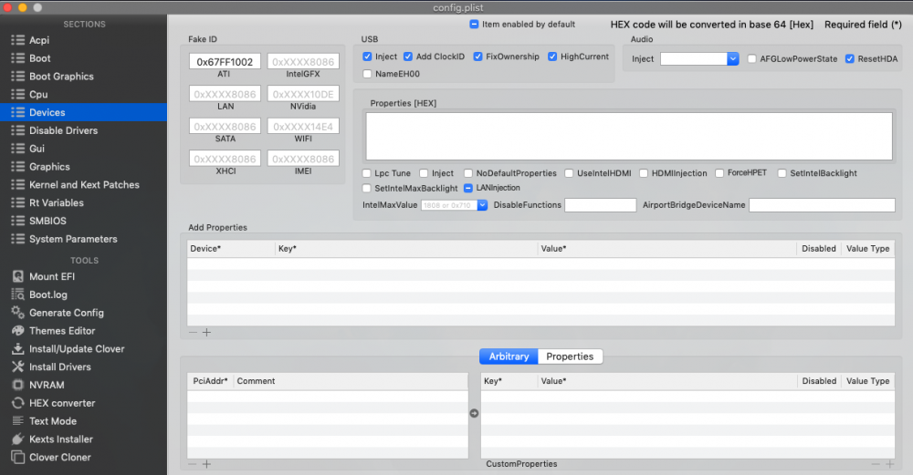

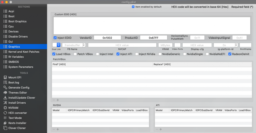

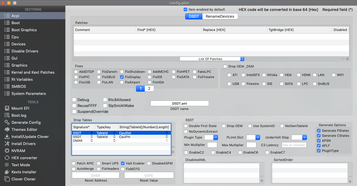

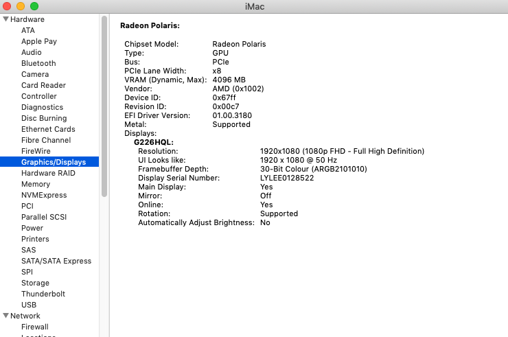

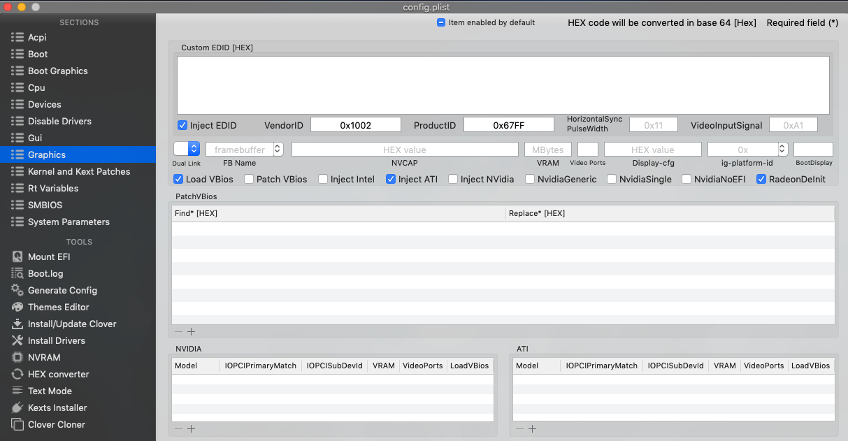

noserider Posted March 9, 2019 Share Posted March 9, 2019 My RX 550 works. Full acceleration QE. Metal enabled. Card is original device id 0x699f See attached images for config.plist configuration. Above : 10.14.3 Mojave ATI RX 550 2 Link to comment https://www.insanelymac.com/forum/topic/337037-amd-radeon-rx-550-not-working/#findComment-2666423 Share on other sites More sharing options...

noserider Posted March 17, 2019 Share Posted March 17, 2019 On 3/11/2019 at 9:42 PM, ITzTravelInTime said: @RehabMan did get the saphyre pulse to work, the problem is that the metal driver does not pick up the graphics card It picked up mine perfectly with the config.plist as described above (FixDisplay, Fake ID, Inject EDID, LoadVBIOS, RadeonDeInit, InjectATI to the values given) and worked well for a couple of weeks booting perfectly. Now, for some reason that I don't know, the display port is not recognized. Haven't upgraded anything. Happened from one day to the next. My card has two display ports, a HDMI and a DVI. I need to manually switch to the HDMI port, then I get a perfect picture. System boots perfect, but goes blank a little before finishing the boot and won't present an image on the monitor, whatever port is connected. If I boot with DVI, I need to manually switch cables to the HDMI port of the card and the display is perfect again. If I boot with HDMI cable connected, I have to manually switch to the DVI port of the card, display gives me a perfect resolution but purple screen. When I switch back to the card's HDMI port again, monitor is having a perfect display (resolution, metal, QE, all well) Again, it worked really well for some weeks. Had booted right into the correct screen resolution without purple color or need to switch cables. Anybody an idea ? Link to comment https://www.insanelymac.com/forum/topic/337037-amd-radeon-rx-550-not-working/#findComment-2667283 Share on other sites More sharing options...

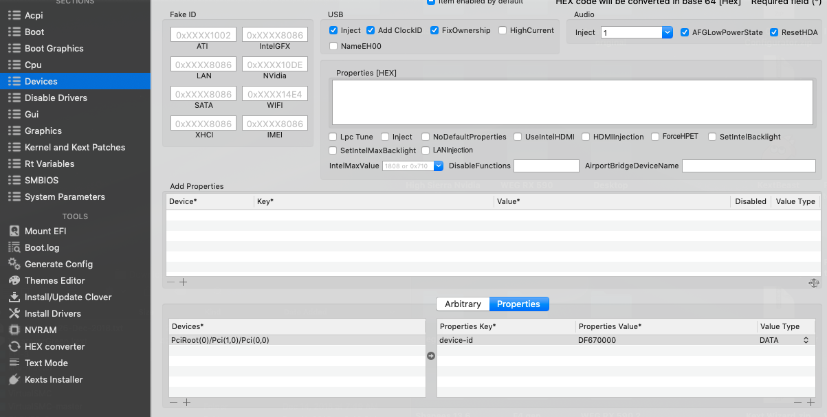

antimidas2007 Posted April 8, 2019 Share Posted April 8, 2019 this worked for my saphire pulse rx 550 4gb. occasional hiccups, but gonna keep messing with it Link to comment https://www.insanelymac.com/forum/topic/337037-amd-radeon-rx-550-not-working/#findComment-2669462 Share on other sites More sharing options...

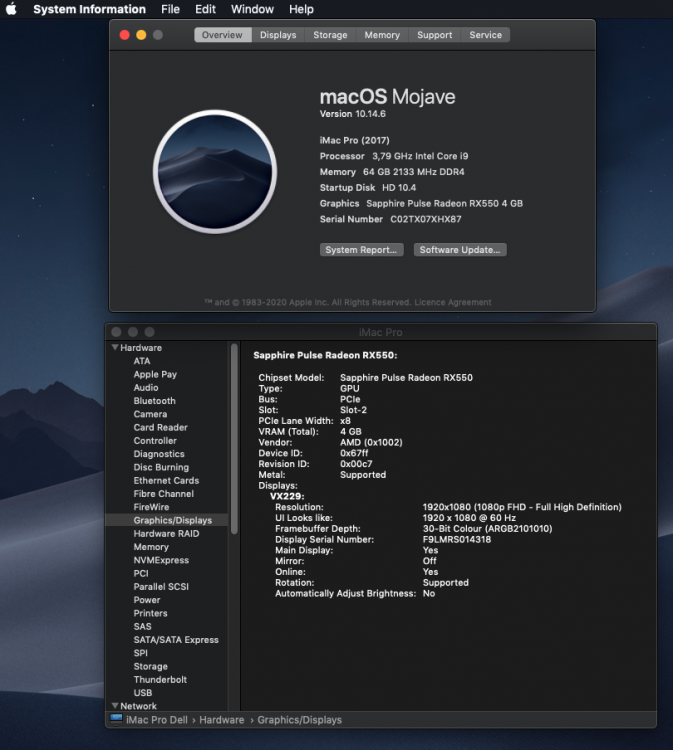

kahiser Posted April 23, 2020 Share Posted April 23, 2020 (edited) HI friends, I leave you with another method that I perform through DDTS, for a Radeon RX550, in my case 4gb in MOJABE, is valid for both GPUs and HDMI audio, simply change the ACPI values in your table. Data to be modified: PC_youdata BR_youdata SL_youdata There are NO extra settings to be made in CLOVER SSDT-DELL-5820-X299-RX550.aml.zip I hope you enjoy Edited April 23, 2020 by kahiser Link to comment https://www.insanelymac.com/forum/topic/337037-amd-radeon-rx-550-not-working/#findComment-2718883 Share on other sites More sharing options...
